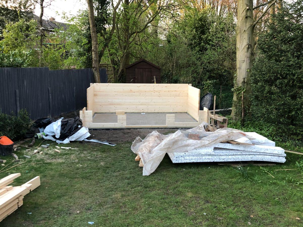

  20. Only really cheated the once. It was getting late and the last 2 rafters were a not fitting by a couple of mm so just took a couple of mm of the slots with the multitool. Fits like a wizards sleeve now. only really (expletive deleted)ed up installing the windows. There’s a massive gap above them. Buried in some obscure tuin blog with build tips it’s says I should have packed them up a bit. Simple enough to do but priority is to complete the roof first. Couple of small quality issues with the ironmongery. Hence the prop to keep the door closed. Only real concern is that 2 months on the patio (quite well covered) probably didn’t help. It’s gone together pretty well, straight and level, doors windows square etc but try as you might it was not possible to close all the gaps between logs so then were even. The cabin design with the big windows mean the front half has very little actual wall so it behaves in its own way. Fingers crossed that as it dries out in the summer it does so evenly and some of those gaps don’t widen further so it ends up looking like a pallet ? not all my own work, the wife helped a bit at the start and as it progressed I had very welcome help from a very tall (much needed) new acquaintance. Even the kids helped a bit in moving stuff closer to the build from their storage.

  23. This is pretty decent, 44mm logs. Roof slats are 18mm. Got double doors and 4 full height windows, alI double glazed (bumped the price up ?‍♂️) it’s nominally 14 x 10. couple of logs in the reject pile, need to fettle the joint as it’s too tight. Only 1 banana so far ,not sure how that one will work out. Have a plan.
