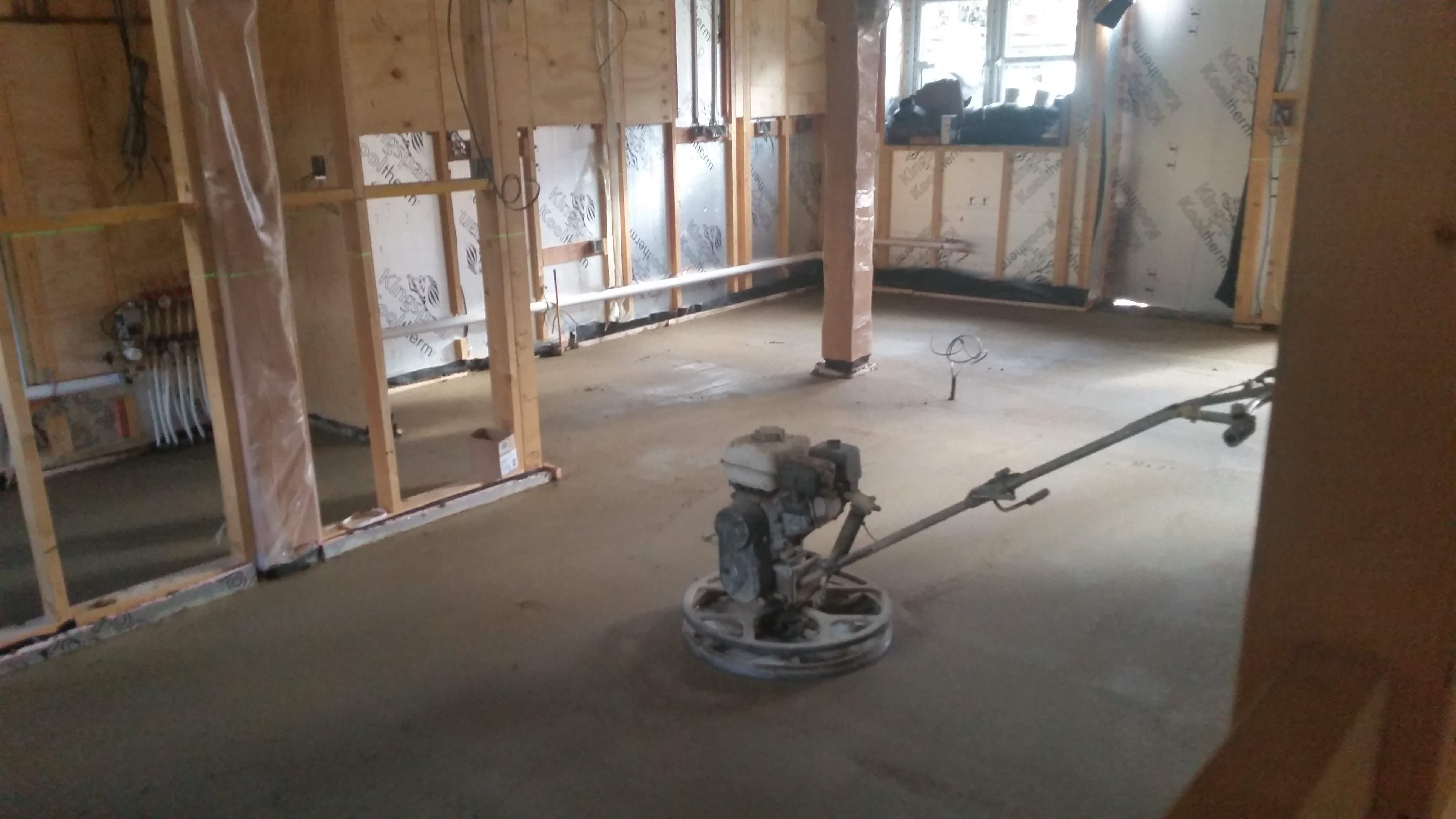

  18. Well the screed went in today....at last I took the Building Controllers advice and tied some wire mesh supports in doorways and across the crossovers where the UFH zones change ....and the screeders left a 4mm gap in these places as well ...just in case of cracking. Lovely job they did ....flat as a pancake !! all in all 6 hours and they were away Really nice lads and best of all a good price So..... a shameless plug for anyone wanting screeding doing in the Luton, Bedford or MK area's Give Ian a call at Alder Screed ! PS I took a few peoples advice in the end on the expansion joints ...and the BCO told me as the areas were not Overly large and due also to the open-plan kitchen that heat difference cracking would be limited (most likely none at all ) ...even without mesh and extra fibre in the mix....but if i DID put in lower expanders ...they would definitely need to be continued to the top ... and the wife hated the idea of all these rubber strips breaking it up...so that kind of sealed it ! So now i will wait 2 months at least before i can tile ....I have lots to be getting on with !! ...once i can get back in !! I have been reading a LOT on this Ditra 25 matting and flexible adhesive...and sadly (as its dear stuff) ..it looks like i will need to go for it.. unless their is a cheaper alternative ... Tiles going down are large porcelain (imitation riven slate) 600x400x10 ...so i dont fancy these boys tenting or cracking ..as they are not cheap either
  19. thanks for the advice. its quite open plan..so the only internal doors are wc..utility and lounge. . what do you suggest I ask the screeder to put in again...I take it it goes in all the depth of the screed ? and ofc I will have to cut it around for the ufh pipes as the entire floor is surrounded by insulation. .will this help to absorb movement...as ofc ot has play vertically

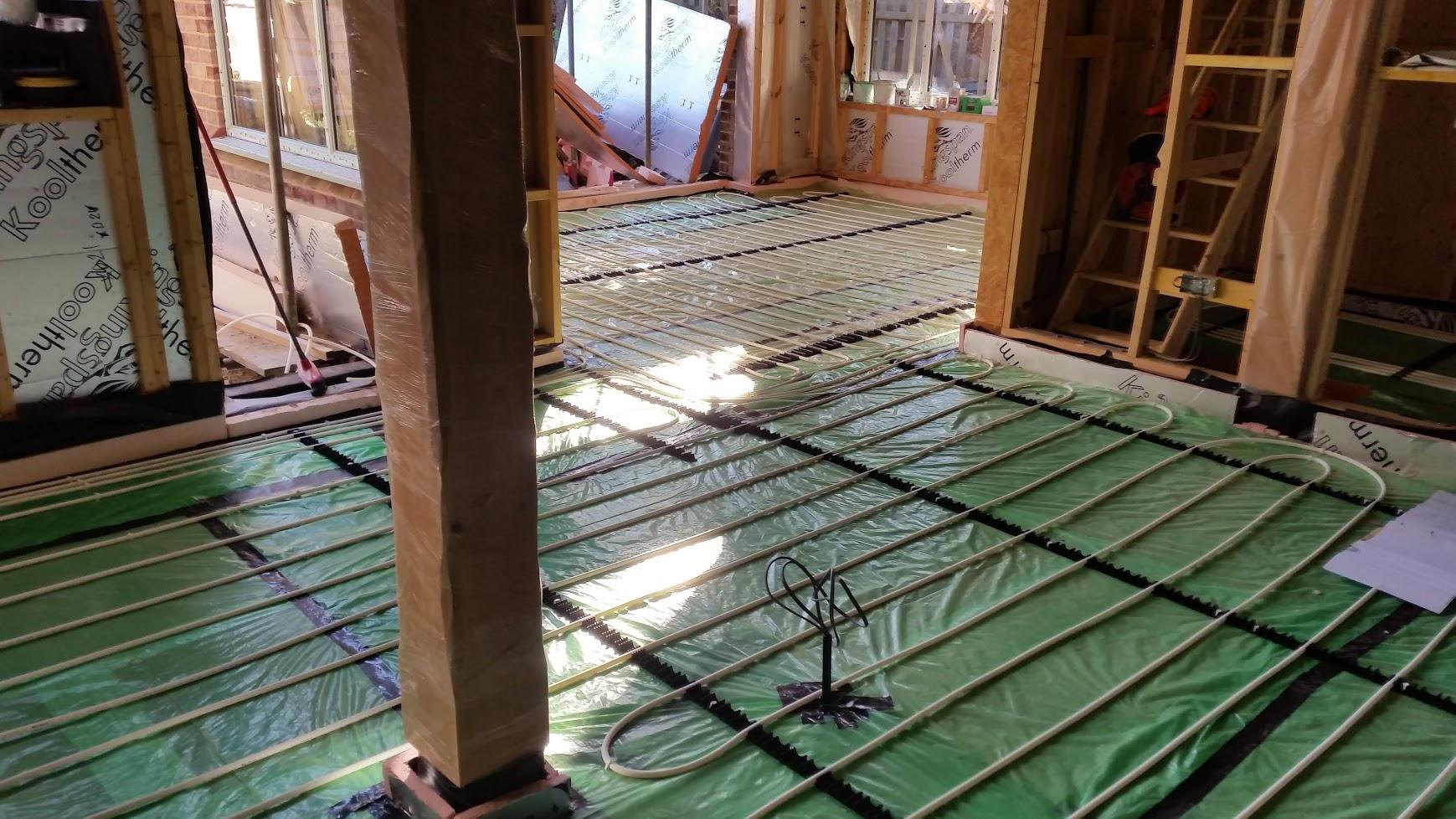

  20. Hi all, I have been offline for a month or so ...struggling to get the exterior of the house complete ... almost there ...will the weather catch up with me for 2018 ....sadly i think it might (sigh) But anyway we have been cracking along with the internal ....boarding upstairs is done and the electrics and plumbing are done on first fix ... I DPM-ed, vapoured and insulated the Beam and block and then finished with a slip sheets and last week the Plumbers installed the nu-heat UFH system and tested it ...all good so far! the screeders are coming wednesday and they are laying a grit sand and cement screed I have 16 tonnes of sharp and 80 bags of the grey stuff standing by !! But it has got me thinking about tiles ! ..well i KNOW the wife is looking at basically the ENTIRE downstairs tiled in large 300x400mm tiles that are 9mm thick ... Now ...I have had various advice ....stuff like use special grout use special adhesive use a separation or decoupling membrane dont tile for 2 months as it needs to dry as rooms are different zones it will CRACK at door openings and you need "gaps" Is there any truth to any of this ....and what can you advise PS Floor is Beam and Block with 1200 micron DPM, 500DPM Barrier/Slip, 90mm Kinspan TF Insulation with 60mm external and 25mm internal upstands and screed is set to be at 70/75mm PPSThose are temporary stairs (in case you are puzzled)..that is actually a solid wall the REAL stairs will run in from the hall

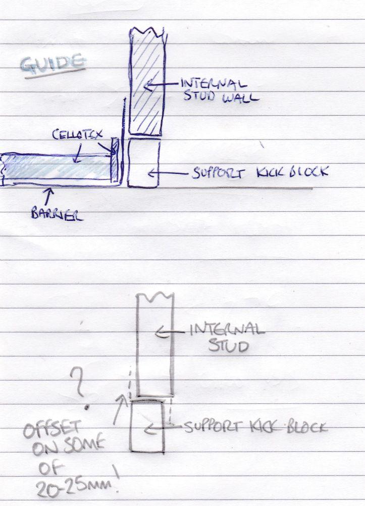

  22. Well ..the frame is spot on. But this involved a fair bit of "packing" on some of the kicker blocks. The problem here is the Beam and Block and the Kicker blocks ...nasty laying of the support blocks for walls, un-even bits of the concrete slurry at joints etc ...(sigh) - I must have used a barrow of concrete just filling in bits and gaps here and there and spent a few hours at least knocking bits off where it was too high with a bolster I am just glad the groundwork is behind us ...caused us the worst headache EVER I suppose to keep the floors essentially LEVEL ...I will just have to ask the screeder to top out to the shallowest at about 70mm thick... ..of course there will be areas then when the screed is an inch lower than the TF base (mainly at one external wall)...but ..what can we do

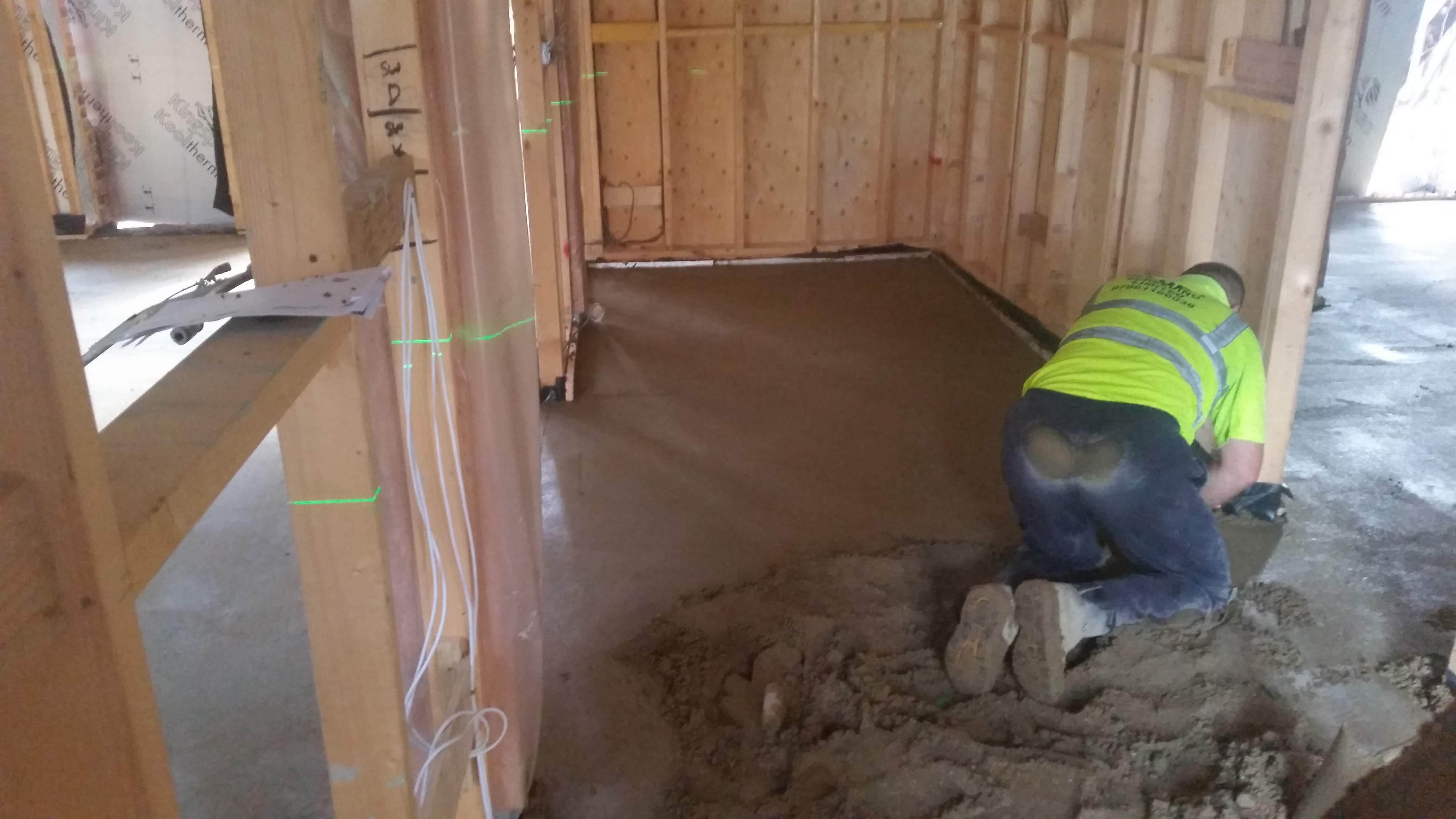

  23. Well thats another question ... If i measure around the rooms at various points the bottom of the the Timber panel to floor varies from around 150 to 175mm. the floor Insulation is 90mm ..So I am presuming the screed will go to the top of the block:? ...does it always? So that would mean that there would be between 60mm and 85mm depending on which wall ... ..to be fair most are OK ....but there is at least one side that is DEEPER. what is the norm please guys ....I take it the screed should NEVER be above the TF bottom?
  24. I discovered yesterday that some of the internal stud walls don't sit across the kick blocks evenly. Which is not a surprise as the guys that put them in were less than accurate ! The guide for laying the cellotex is helpful ...but how do i cope with the edges on these walls (see sketch) on one side i suppose i could just use 2 of the slim cellotex to pad it out to the correct frame level... ...but on the PROUD side ..If i put ANY insulation here ...it is going to push the skirting board out ....I am sure and I can see how the plasterer will be able to work up to it what would you guys do ? oh ..and some of these walls are supporting stuff ...I did THINK about taking a disc cutter to the blocks ...but it is probably not wise
