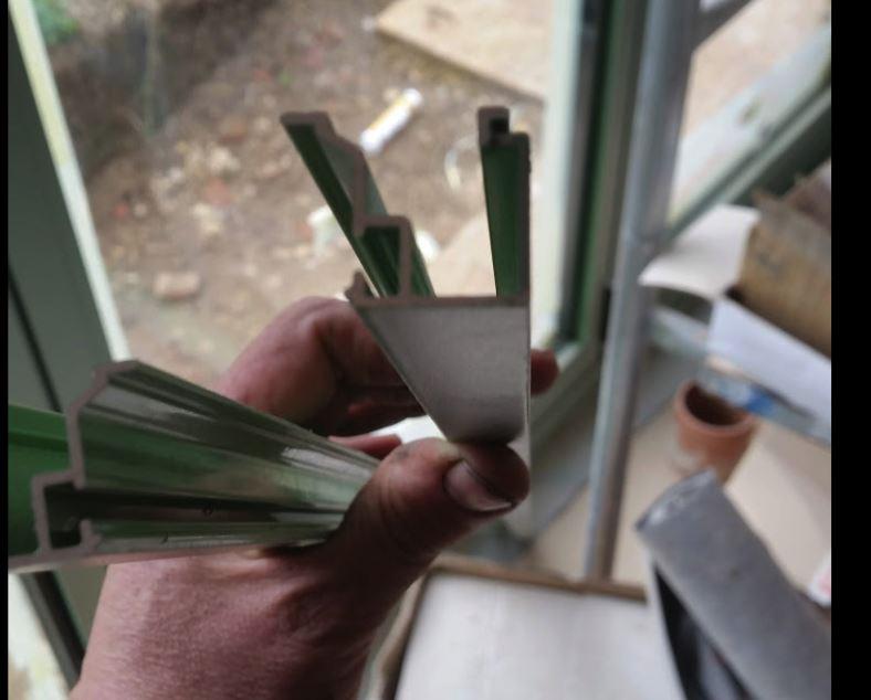

Evening All. Its along story ...so i will condense. Basically Window company was supplying some bi-folds to go with our chartwell green UPVC theirs was aluminium ...and they asked is for a RAL ....we told then couldnt they just match it and that said they worked off RAL etc etc anyway the net result of all this is that RAL 6021 looks NOTHING like chartwell green ...far far darker So we decided to have them sprayed ...as the "blame game" was going on forever .... A company came out and try as they might they did not have a tape that would stick to the internal rubber seal to mask it ... no problem they said ....we will pull it out ....its a wedge gasket 5 minutes later they handed me a bunch of varying lengths of rubber and said "keep them clean and pop them in once its all dry and unmasked! I had to hand it to them their paint colour was SPOT ON ...but ..... when i went to put the gaskets in 2 days later ...no way would they go...tried using thin tools ..plastic tools euro wedges everything ... any more pressure and the glass would break for sure. Now along came the joiner and he noticed that around the aluminium doors was a detachable profile ...and after a bit of a wiggle and waggle it came loose BINGO ! ...so off i went with silicone spray and a plastic scraper and squeezed it into the profile ...as i THOUGHT it should go ....but it doesn't LOOK right and when i try to clip the profile back on its like there is TOO MUCH rubber on the other side or something ..it must be in wrong So i am hoping someone can tell me how to proceed ..I have some pics of the detachable profile and a rough image of the gasket cross section PS as you look at the pic...the LONG corner of the profile is the bit that sits deep in and effectively under the glass edge...and the tall flattest section is the one that faces into the sun-room. I know the bead MUST go into that rectangle notch some way ...but how is the question What a palava !

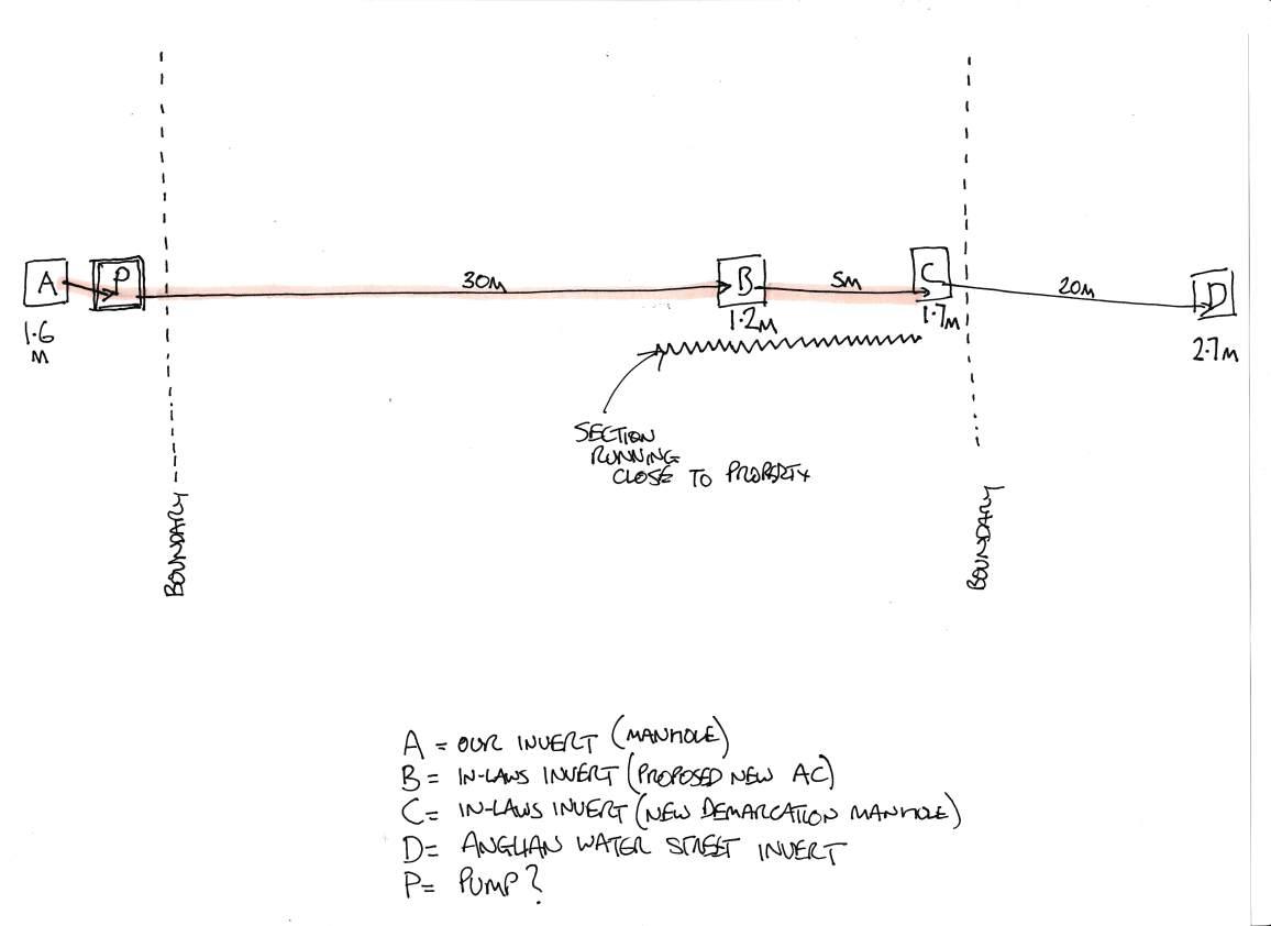

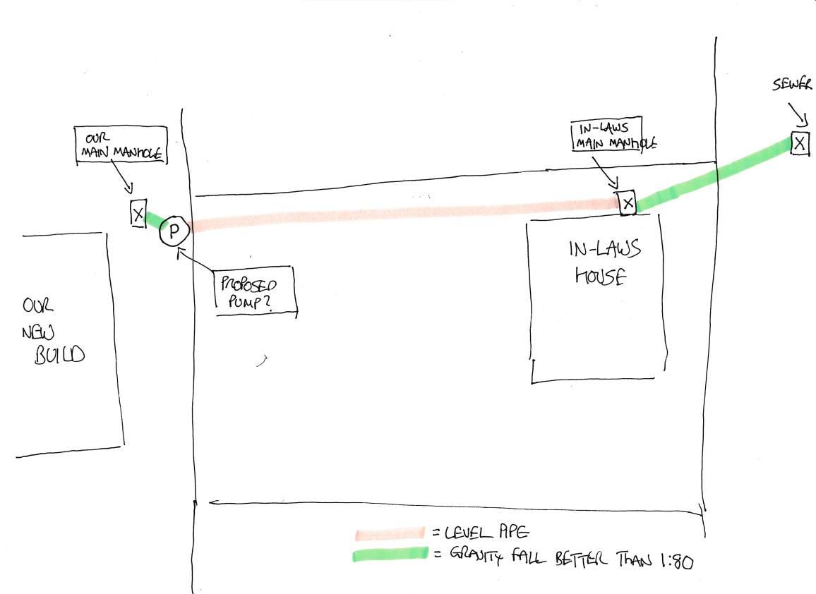

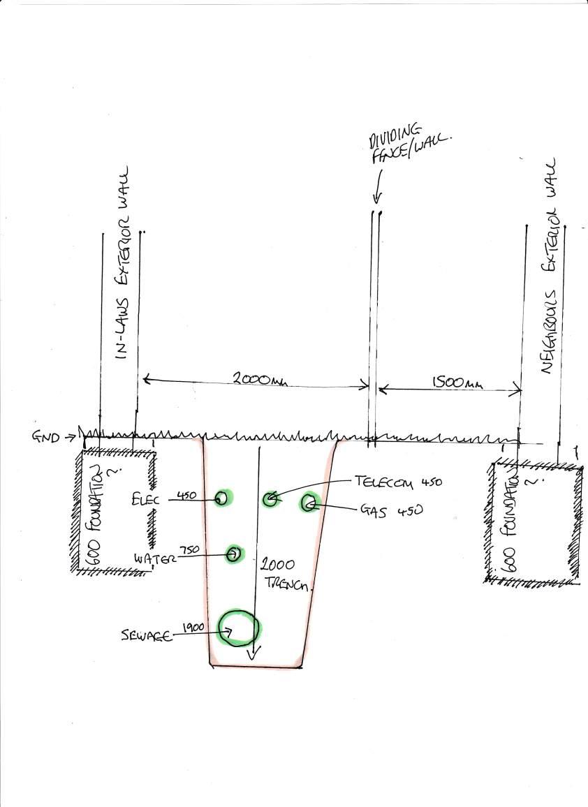

Yes ...and i think its what we have settled on after talking to Anglian Water contractors Basically on our side of the fence will be a 3in Single Pump (solid handling at 65%)with a 1000L tank, guide rails and Automatic Alarm the outlet will be at 500m below DPC it will feed into 90mm pipe and run 30 metres down the wall of our in-laws into a new manhole that they are installing and then gravity out to the main sewer a further 25m this will mean we can fall gradually to a trench that will only be a metre at MOST (if that) at the inlaws corner ..(which is well past the narrow between houses) I am getting prices of between £1500 and £2300 for this setup (almost identical) ..including all the fittings to take 2 x 4" waste feeds and am told i basically REPLACE the planned manhole wit this station ..and away we go! I cant work out why the costs vary a bit ....but i do know that a 50m roll of 90mm drainage pipe is lot of money anyone got any advice .... (or a coil of 90mm!)
Groundworkers were tools basically! and after stating the footings would be 1m of concrete changed his mind and set them for 600mm he said his 1m (included the trench block) which it didnt in my original plan ..needless to say we got into a big ruck and he demanded more dosh if we wanted 1m and so we had to settle at 600mm foundation pour Thing is the house now sits 400-600mm lower than planned and what was a LONG fall at 1:60 to get to the inlaws invert now means we are below their invert already buy about 200mm so we need to lower their run so we can feed into it so even with a shallow fall 1:80 tops we will be 1500mm down by the time we get to them 1:60 would leave us closer to 1800mm does that make sense ? We could easily run out at 1:60 to the road as the sewer is so bloody deep , but somewher along the line we havbe to 1. Fall a fair bit as the council will only allow a connection at invert level 2. Pick up the inlaws waste ...as if it wasn't for them ..none of this would be possible ...so i cant just sail past leaving them on a leaking cesspit

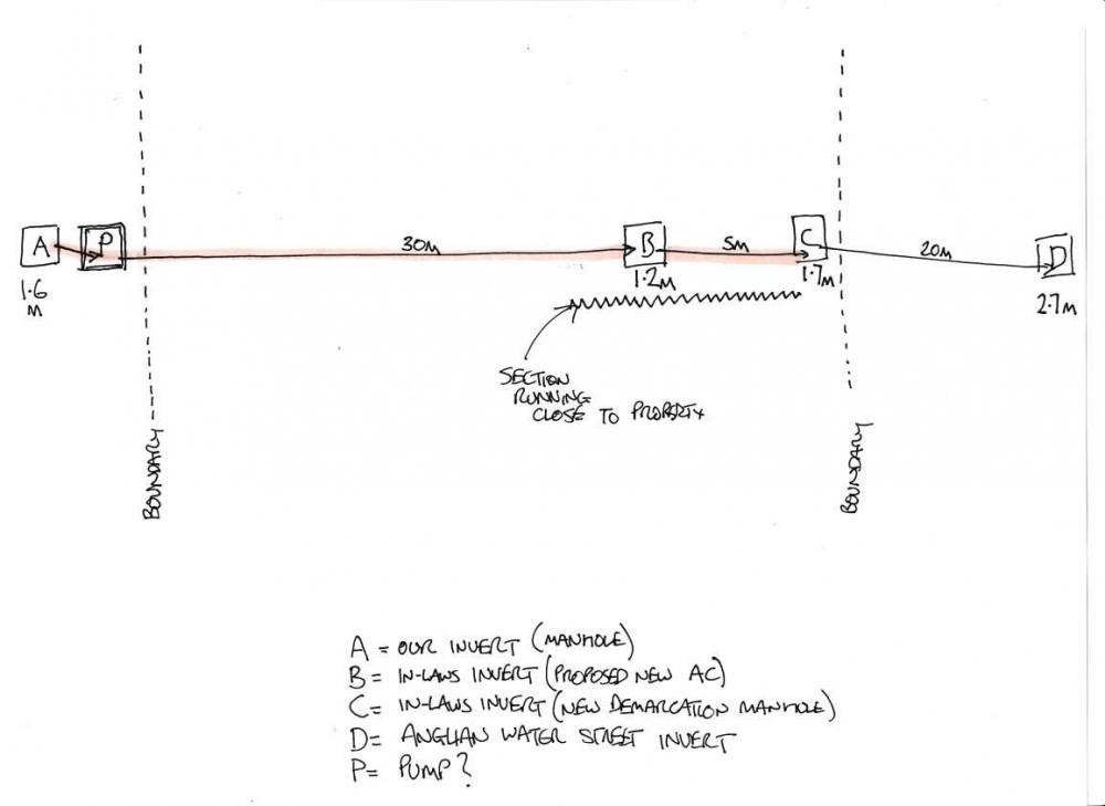

Well perhaps the workers that came (Anglian subcontractors) were doom and gloom, but sadly they put the willies up my father-in-law with all the talk of subsidence, underrmining, underpinning et al ! I drew it out roughly to scale below ...but as i have no experience in civil engineering, does it look like a chilean mining disaster waiting to happen ? I mustb admit when 3 irishmen are stood around a laser level repeating as a mantra "its deep, maybe too deep Pat" ..."oh its deep alright Mick, very deep" ..."what do you think Michael" ...."it's a deep bas*** alright boys" etc etc
hmmm. i see. well the inlaws are currently on a 40yr old cesspit in the rear garden ...so their current invert level isn't deep at all ...around 450mm down! whilst the main mahole in the road is 2.7 metres down ...but again the road surface is about 500mm lower than their land ...so in total the fall from theirs would be over 3M and the distance is about 25M from their invert to the main manhole ...so QUITE a fall !! the plan was to dig theirs deeper and i would originally connect to them and then fall out at a respectable 1:60 to the road. Regarding the under-pinning ...the team that came estimated for plan A ...(normal pipe run) to work with a decent fall when the trench had to go along our inlaws house it would be falling at between 1.5M and 2.0M deep and due to the space between their house and a neighbours garden wall (2M gap ..it would be TOO deep to be so CLOSE as the trench would be almost 500mm away from the in laws exterior wall which they estimated at 600mm foundation deep) and so would be BELOW them and potentially unsafe..if that makes sense attached pic should help the challenge is the highlighted line in regards to the zig-zag (section close to building) the things i CANNOT change are A - my invert D - Anglians invert we can "play" with anything else but where it gets close to the in-laws house, i don't really want to risk undermining, and we only have 2m gap to play with ..and at least ONCE i hear them talking about the "angle of repose" ... which as we know is always a bad phrase I am told
Houston ...we have a ... (well you know what we have) Basically the engineer working for Anglian water came out today and checked the falls. (If you know already ..i wont bore you ...but we are running all the services through our inlaws house to the road in front of their house as the road we have an entrance on the services are "unadopted" ....long story .....but) ...anyway. Due to the distance of around 45m from main sewer to our invert ...we have to fall TOO far.. ...and it would be a smidge under 2m deep along the house which is too close for comfort ...without underpinning which is financially a non starter ..so someone suggested a pump ...! ...sounds good ... But of course we are ALSO picking up our inlaws waste when we run out to the mains sewer ...as that was part of the deal (they are currently on an old and dilapidated rear garden cesspit) So my question (which even the waste company couldn't answer) is ... Will my pump a the proposed location effectively SHOVE the waste out to the sewer when it HAS to pass through our inlaws manhole as well ? any Pump Gurus online ? see attached for a handy pic

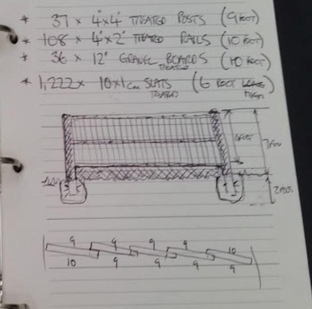

Hi all, Hope you having a good Crimbo ...so far! I have started thinking about my fence ....I am clearing the site and will be getting a mini-digger in just to smooth it about and also dig the soakaway and other BIG holes! But now all the trees are bare it is really exposed to the road and the wife has asked me how much it will cost to do ...I am dreading all those bloody holes ...but there you go . currently it is a mixture of council Post and rail ...along road side about 200 foot of it ....which i wont be moving just erecting within it. The remainder of the side is mostly facing my inlaws and the back of the neighbours gardens and is composed of mainly rotting waney lap panels and in some cases ...no fence at all , i have had to chicken wire it to keep the dog in So the plan is to erect a closeboard fence on post and rail to match the 30 foot that was erected by a neighbour 2 years ago and is good looking and solid I have only ever done Concrete and Panel ...so I am hoping I got my calcs right...its about 350 foot all around excluding gate and good bit and i was told Post and rail is normally 10 foot spans ..So i come up with (the attached) To match the good fence there it needs to be 7 foot ..SO I have allowed for this...Down here I have noticed Southerners refer to "gravel boards" While us up north call them "base panels" ...I am sure they are the same I plan top treat the 2 foot of the post in he ground with roofing bitumen to over ground level and also drive several 6" nail into it before concrete (I used to see my old dad do this ...and his fences seemed to stand forever ...so I will copy it!) Wherever i look to buy the wood seems to suggest the following 1. Feather boards (shaped like a wedge) .....but the good ones in place are 10x1 cm planks (lapping 1cm) ...so should i not copy them ? 2. Also the rails I am quoted seem to be cut diagonally ..I have never seen this ...I would normally "presume" they were 4x2 ..stronger? 3. Some timber place told me I would need to put a rebated capping along the top ...presumable to help water drip off ...the current solid fence doesn't have this...its more money again ....but is it worth it ? Any advice of clarification from anyone that knows better is appreciated
