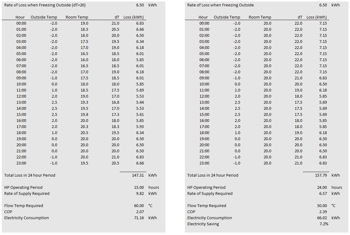

@Hogboon, I've put together an hour-by-hour energy model based on 6.5kW heat loss as per the other thread and a hypothetical cold day with two operating scenarios: The first, on the left, assumes the heat pump is run between 7am and 10pm - 15 hours. The second, on the right, assumes the heat pump is run 24x7. The house loses heat to the outside whether it's being heated or not. The model shows that that allowing the house to cool overnight (by not running the heat pump) reduces the overall daily energy requirement of the house as would be expected. In this example on this made-up day it would need 147kWh. Substantially all of that energy - 147kWh - has to to come from the heat pump. Because the heat pump is being asked to provide 147kW with only 15 hours of run time, the radiator surface temperature must be increased from 50° to 60° to provide an extra 50% output to nearly 10kW (15 hours x 10kW = 150kWh), instead of the 6.5kW the system was designed and sized to provide. So, to have the house warm with only 15 hours run-time will need bigger radiators or a higher flow temperature. Compare that to a steady-state 20°C target. Over the same 24 hours, very obviously the overall heat demand is higher, in this case 158kWh for the 24-hour period. This is where things get interesting. If the heat supply was a gas boiler then of course it will be cheaper to heat it for 15 hours. It will use less energy and cost less. However, the heat-pump muddies this because it will harvest less energy from outside when supplying higher temperatures. The ratio between electrical supply and heat provided to the heating system is the COP. A COP of 3 would show that 3kW of heat are delivered to the water in the radiator circuit with 1kW of electrical input. The other 2kW are recovered by cooling the air outside. Because of the shortened operating time of 15 hours, the radiator temperature must be increased by 10°C. This reduces the COP, all else being equal. The datasheet for my particular product shows a reduction from 2.39 to 2.07 at -3°. Therefore, the amount of electricity required is actually more when operating the shorter heating period than just leaving it on 24 hours, in case about 7% more electricity to heat the house for 15 hours compared to heating it for 24. TL;DR: 15 hours is not enough time to heat your home with the radiators you have. Mid-season this can be achieved by increasing the flow temperatures to compensate but this will ultimately cost you more to run than leaving the system running 24x7. Run the heat pump 24x7 or change the radiators to achieve 50% more output. -
