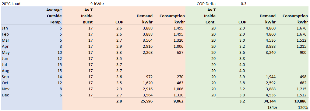

So I did a 'fag packet' calc, based on observed performance so far. Continuous heating looks to increase thermal load by 35% but would increase cost by 20% if the COP improved by 0.3. Lots of assumptions here and doesn't account for sunshine...
