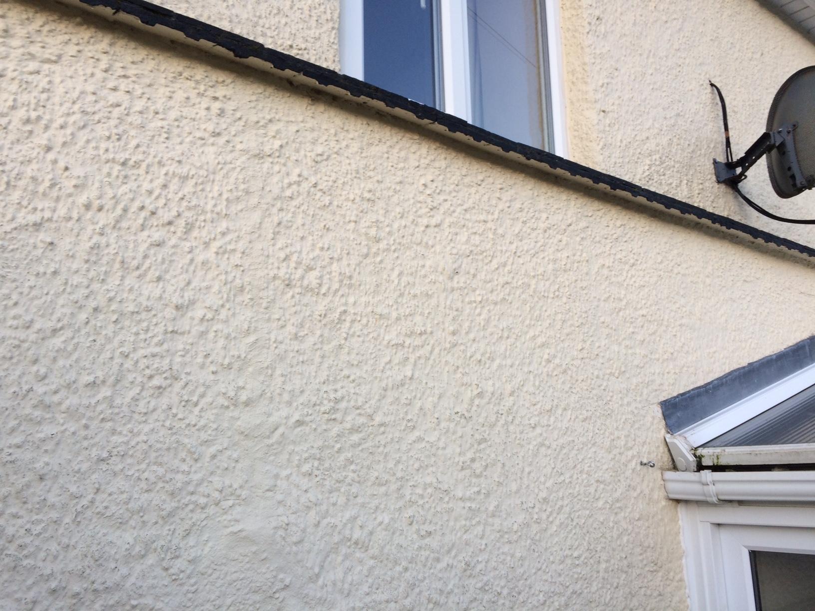

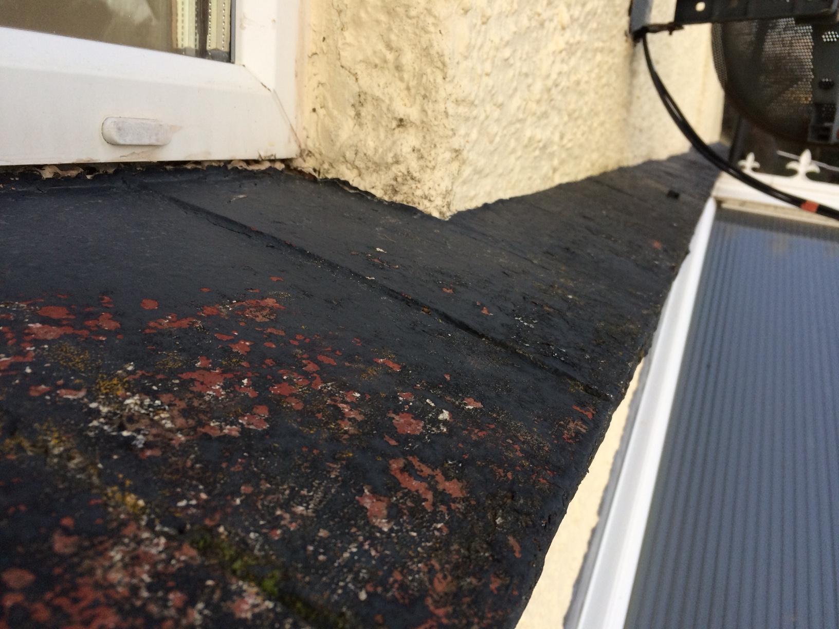

Thank you so much. Not sure I completely understand the diagram..sorry, but let me see if I can get this right.....I see the flashing bit. Does that sit on top of the standing seam? with vented filler in between seams. Then beneath the zinc is vapour control on a bed of ply? Batten on top of the rafter where the bottom arrow shows airflow coming up? I've attached a pdf diagram what one installer has recommended.Zink roof detail.pdf Roughly how high/tall does that upstand/abutment flashing have to be? There is a complication. This in an old cob barn than many many years ago had a second story added. There is a line of tiles that are also provide for a window sill and a separation between two different thicknesses of wall. So we'll have to come under that, but not sure how the flashing can be worked in with the tile. And what BC might have to say about it. 2 x pictures included. Cheers Graeme
Hi, We are getting conflicting advice so any thoughts that might help us get through this very much appreciated. We are building a 4m deep x11m long single story extension on the back of our house, mono-pitched roof joined to the exiting house. Due to the lay of the land and upper story windows we are limited for height at the back/house side (3m) and still want to achieve a fall above 5 degrees. There are two questions this raises. 1. One installer recommended a vented or cold roof zinc installation (something to do with moisture trapped during installation of the zinc) where as our design/architect guy recommended a warm roof i.e. unvented. Has anyone got views on which is better and/or any advantages of each? 2. If we were to go down the vented route. I have been unable to see how the back/house side of the venting would work and upstand for that matter. I have seen venting details on roof ridges. Has anyone got any experience of how that might work? Again any help much appreciated. Thanks Graeme Extension 26-01-21 - Drive side view.tif
