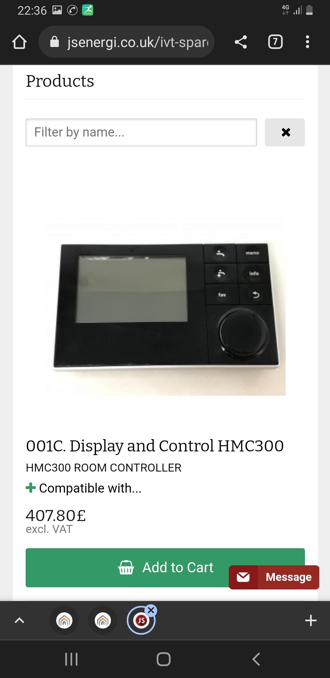

  6. Thanks for finding them, they sell the controller and box that signals it aswell, twice what I paid for the ashp but all in will be ok . Don't know how I didn't find them before, doh! Wow the price of parts for this brand..... compressor £1200 ...eek

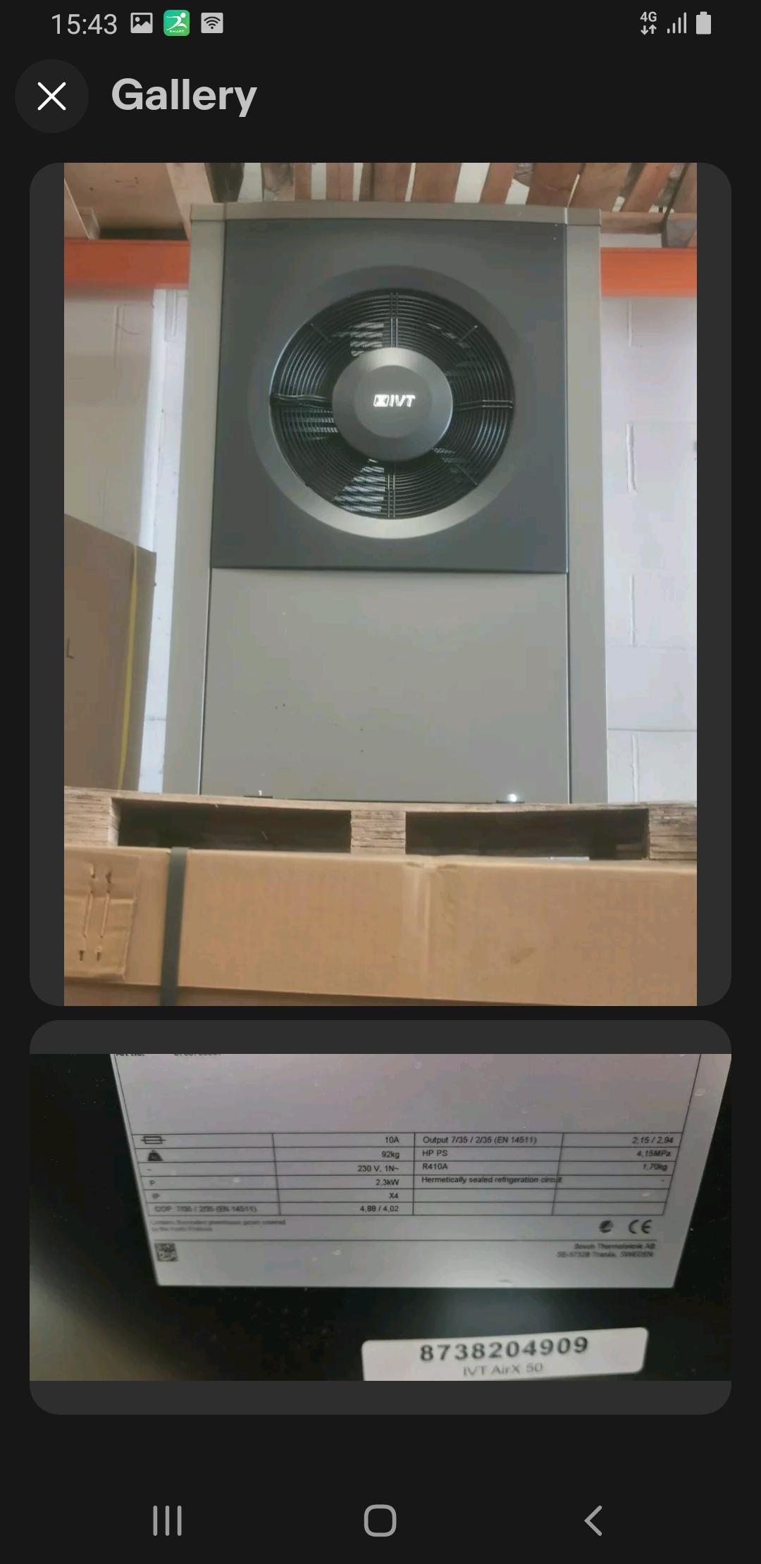

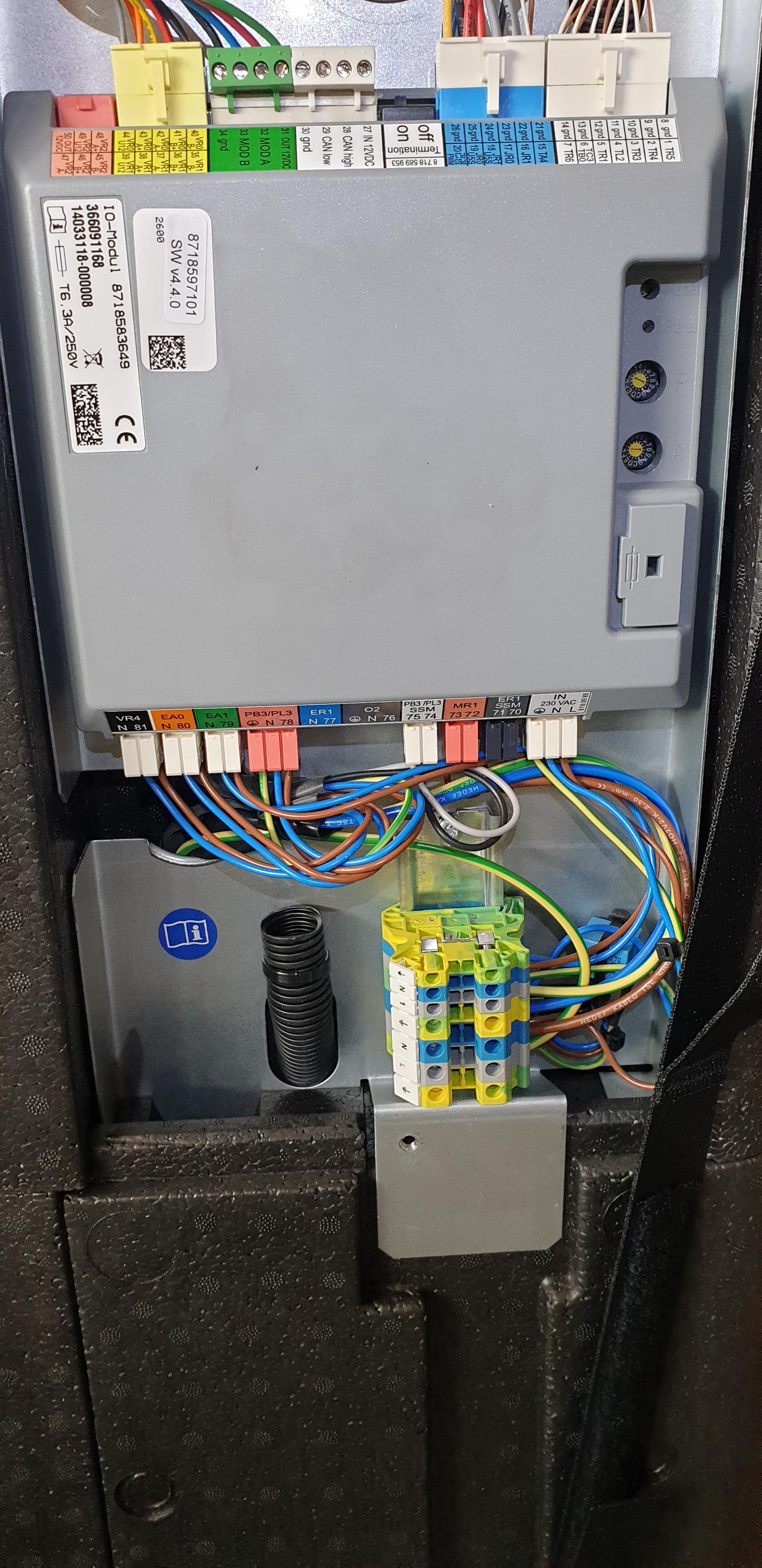

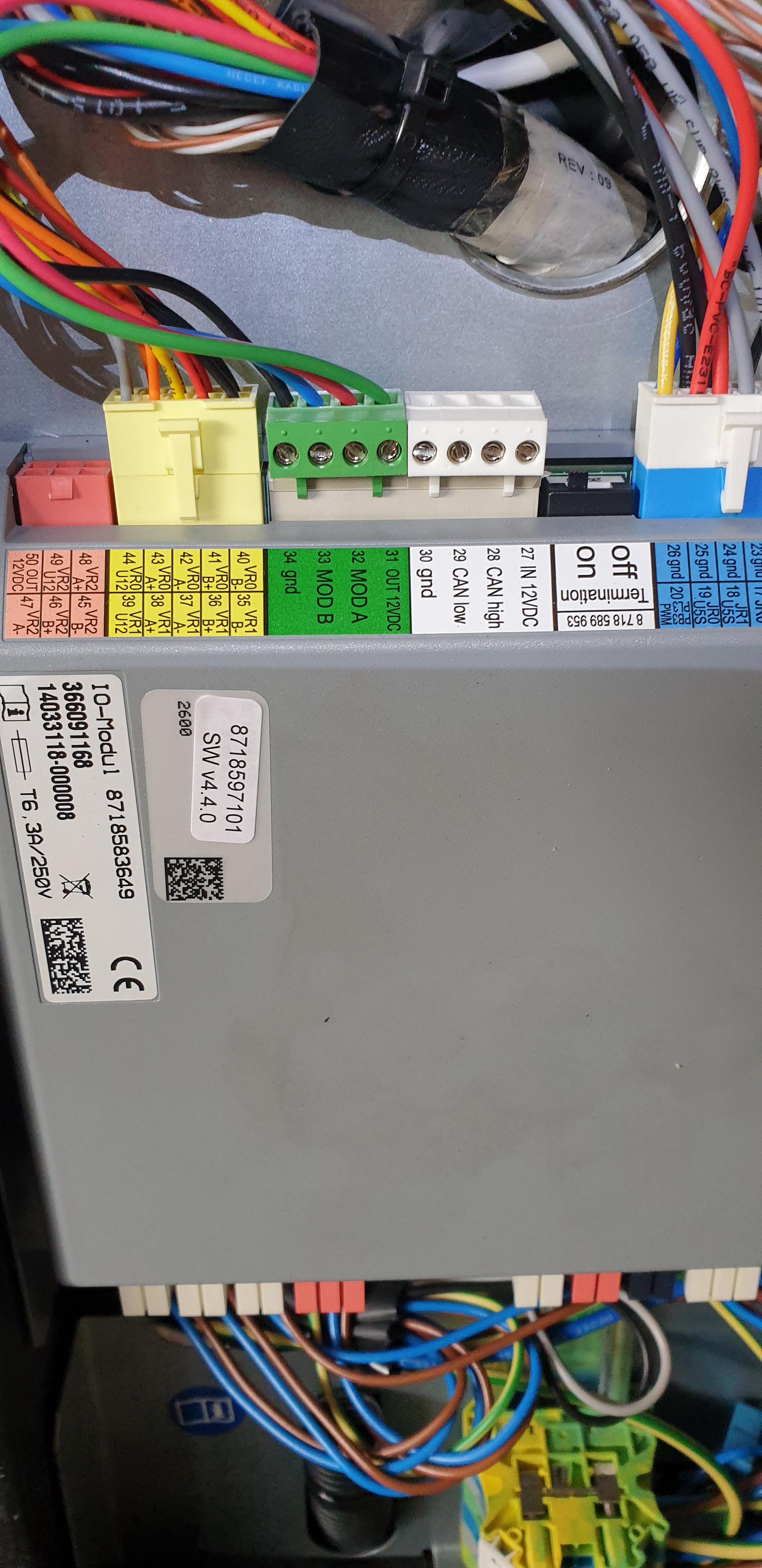

  9. Hi all, long term bhf stalker here , been self building a house for sooo long, its now an embarrassment. Made lots of errors along the way and the latest by purchasing an ashp from eBay. Its a new ivt airx 50, 5 kw, I think bosch bought ivt and now their branded as bosch, they are still sold as buderus as well in Europe . Would be a bargain but the thing is it came without a controller, usually found in the internal split system part called 'airbox '. That would have the rego 2000 controller in it and a pump ect but all these products became discontinued last year by UK distributors alto energy. I have tried emailing around with no luck to find a controller and looked at some aftermarket ones on aliexpress. Seem a shame not use the ashp as the quality looks great, the specs competitive and it was very cheap. Any ideas what I can use to control it , Ideally with cooling option ? I'll put some pics of the connections for reference as would be great to see one of my rash purchases paying off with some help !
