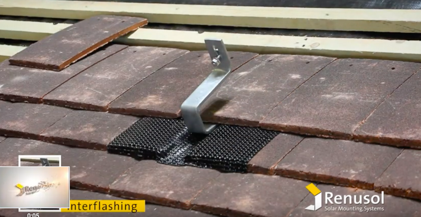

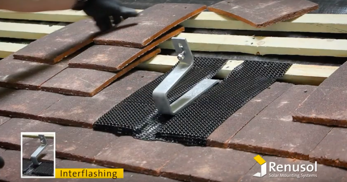

Pablo68's Achievements

  3. Thanks very much for your replies guys. Wakaflex looks ideal and I've decided to use it. Regrading corrosion, the Renusol information sheet only states that corrosion is an issue if the installation is with 10 miles of the coast.
