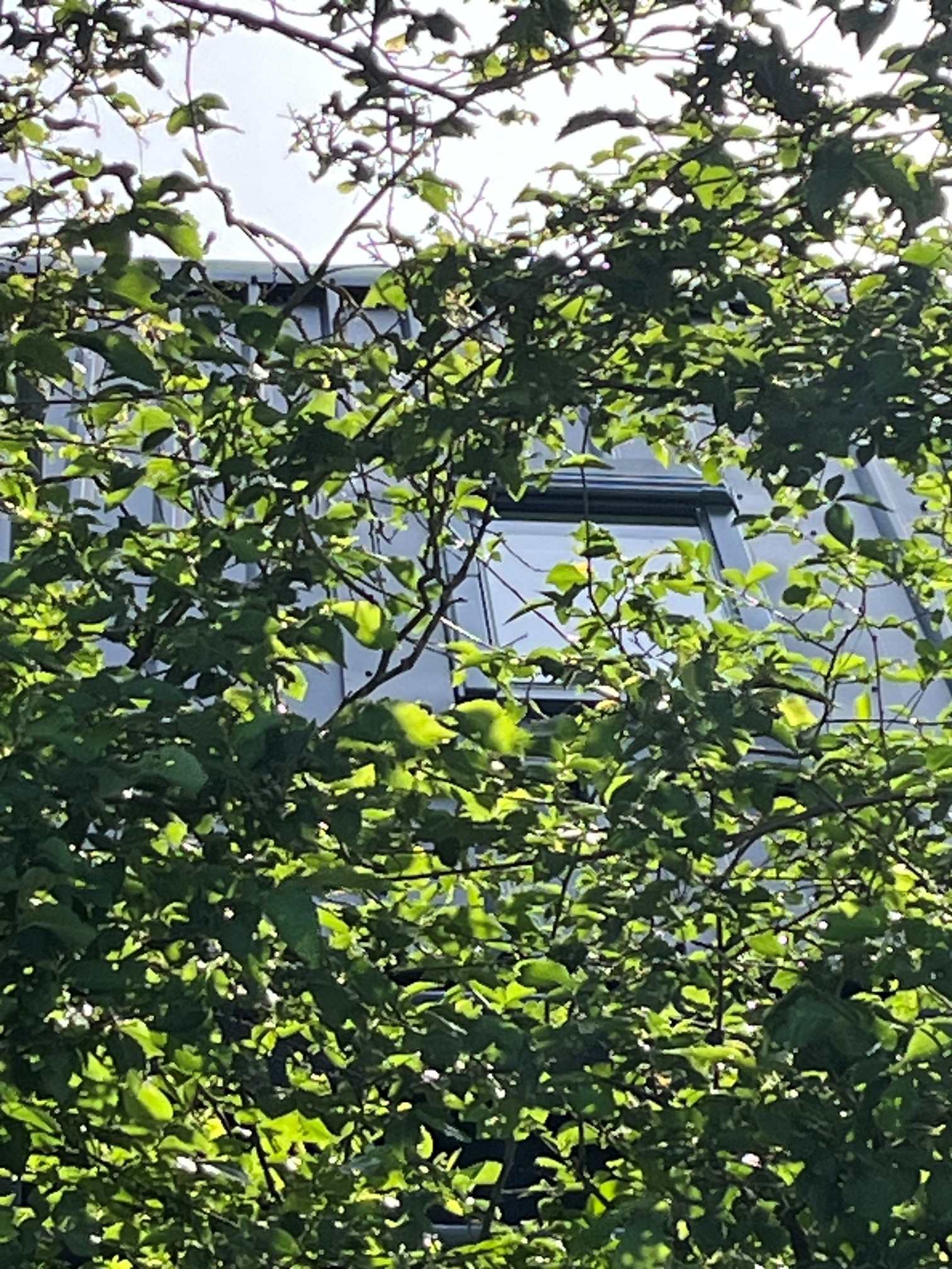

I saw this on a nice looking new-build-in-progress at the weekend. This was the best image I could get. The border around the roof light doesn't look like standard Velux detail? Actually, a much cleaner design? Also, what kind of roof is that?
Is this normal on Velux?
Alan Ambrose replied to Great_scot_selfbuild's topic in Skylights & Roof Windows
I think it's fairly normal - the Velux kits are all a bit nonsense IMO. Vast quantities of bits of ally with tabs that you're meant to bend back / self-adhesive flashing strips that are somehow meant to be watertight and UV-tolerant for the duration / dodgy pictogram instructions. -
