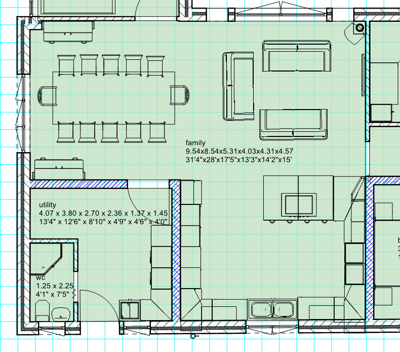

  1. not built at all so can move, the only reason I put it there was because the other side of wall B is my kitchen, because of cabinets I didn't want the door on that wall, but I thought I would like the door close to the kitchen, but guess 600mm is going to make much difference, the other side of Wall A is the dining area

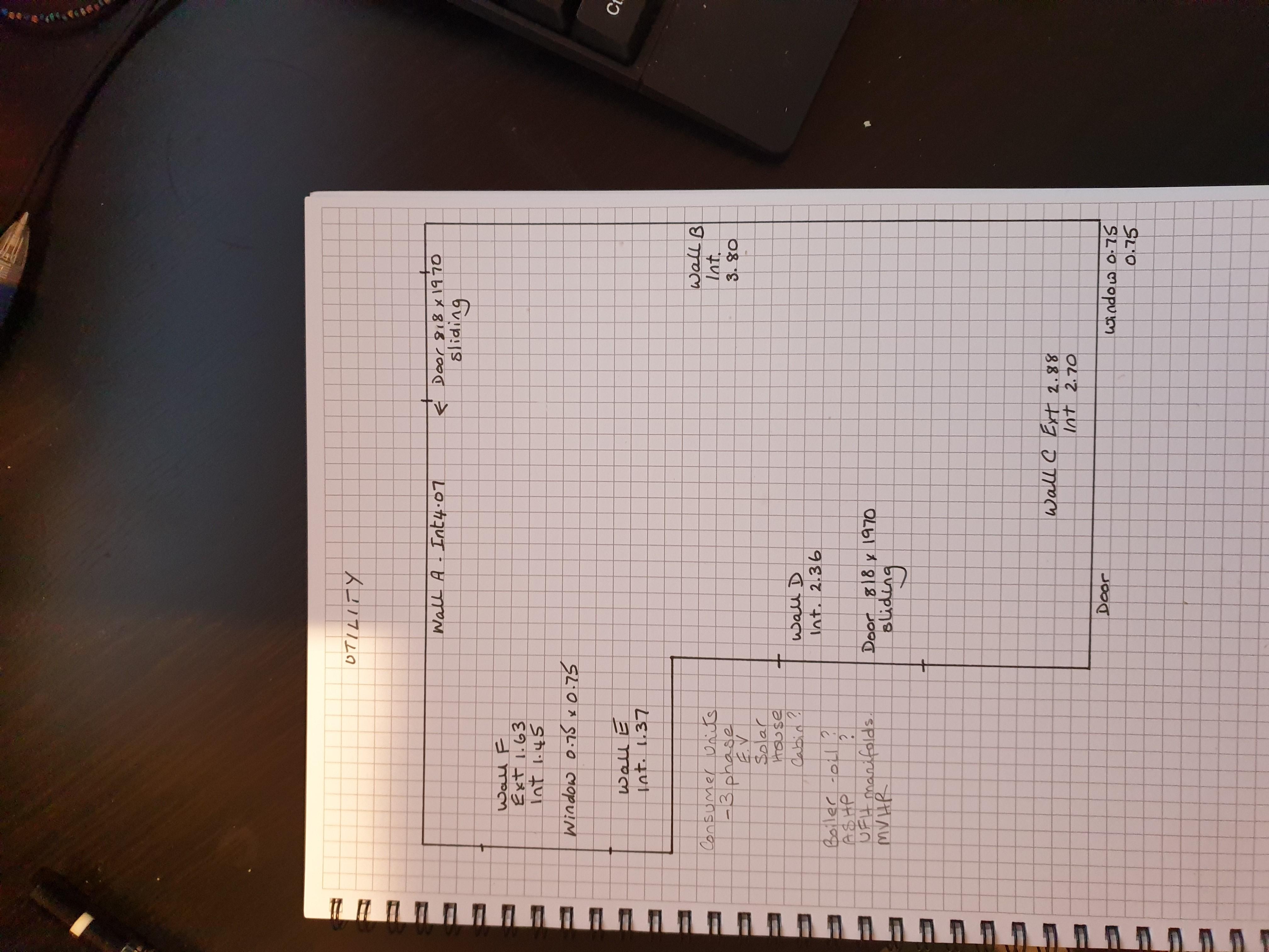

  2. I'm just trying to work out the layout of my utility room. I need multiple consumer units, boiler (probably), ASHP, UFH manifolds, MVHR, washing machine, tumble dryer, storage, sink, freezer. I just need an idea of how big all these things are physically and if anyone has any idea on the best way to layout the room. See this hand drawn plan below.
