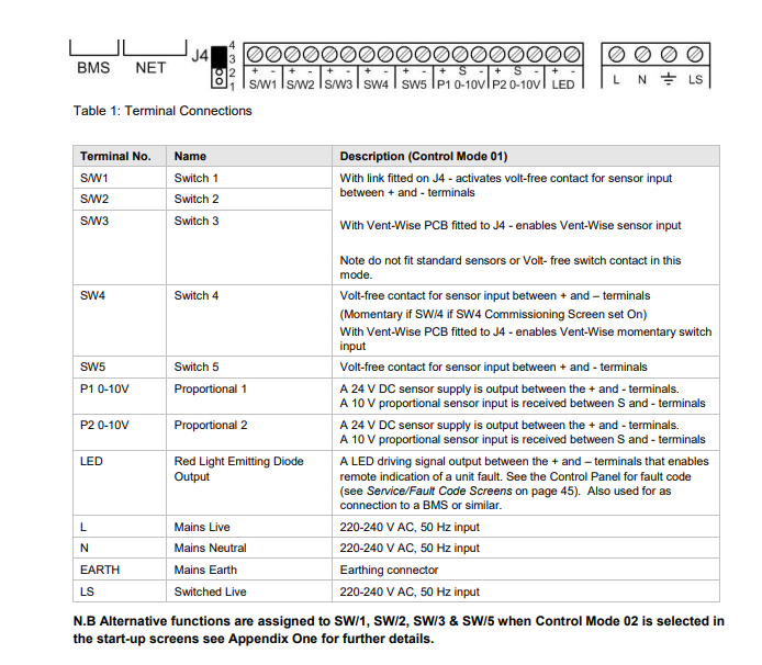

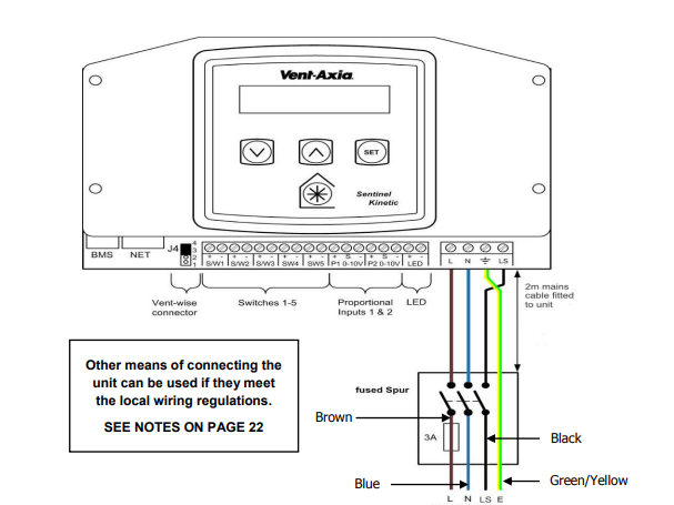

Our installer said we could have one of the main controllers (with digital readouts) per room as long as we wired 4 core. He supplied the controller's, we installed the 4 core.... Now 6 months later vent axia confirmed it can't be done!! And a rocker switch off 2 core (as you've suggested) is all we can have. Why can't professional expert installers just do their job right first time. Grrr -

We have a Vent Axia MVHR installed, and we have 3 x boost switches for the bathrooms to manually boost if (after your poo!). The MVHR was installed several months ago, and will be commissioned in a few weeks time. The MVHR installer is shrugging off the boost switch connections as he only ever installs the master one which comes with a Rj11 type connector & claims he isn't an electrician. Pisses me off this, but he won't budge. As a result my electrician needs to pick up the slack. However, my electrician is scratching his head a bit on the wiring for it, with the attached diagrams being all that is offered in the manual. Each boost switch needs 4 core cable, which is routed back to the MVHR. However, on the MVHR unit there is only 2 terminals per switch. Can anyone shed any light on this please? Boost switch: https://www.tradesparky.com/ecommerce/downloadasset?productAssetId=571966 Vent Axia Manual: https://www.vent-axia.com/sites/default/files/439817_ad.pdf Thanks!

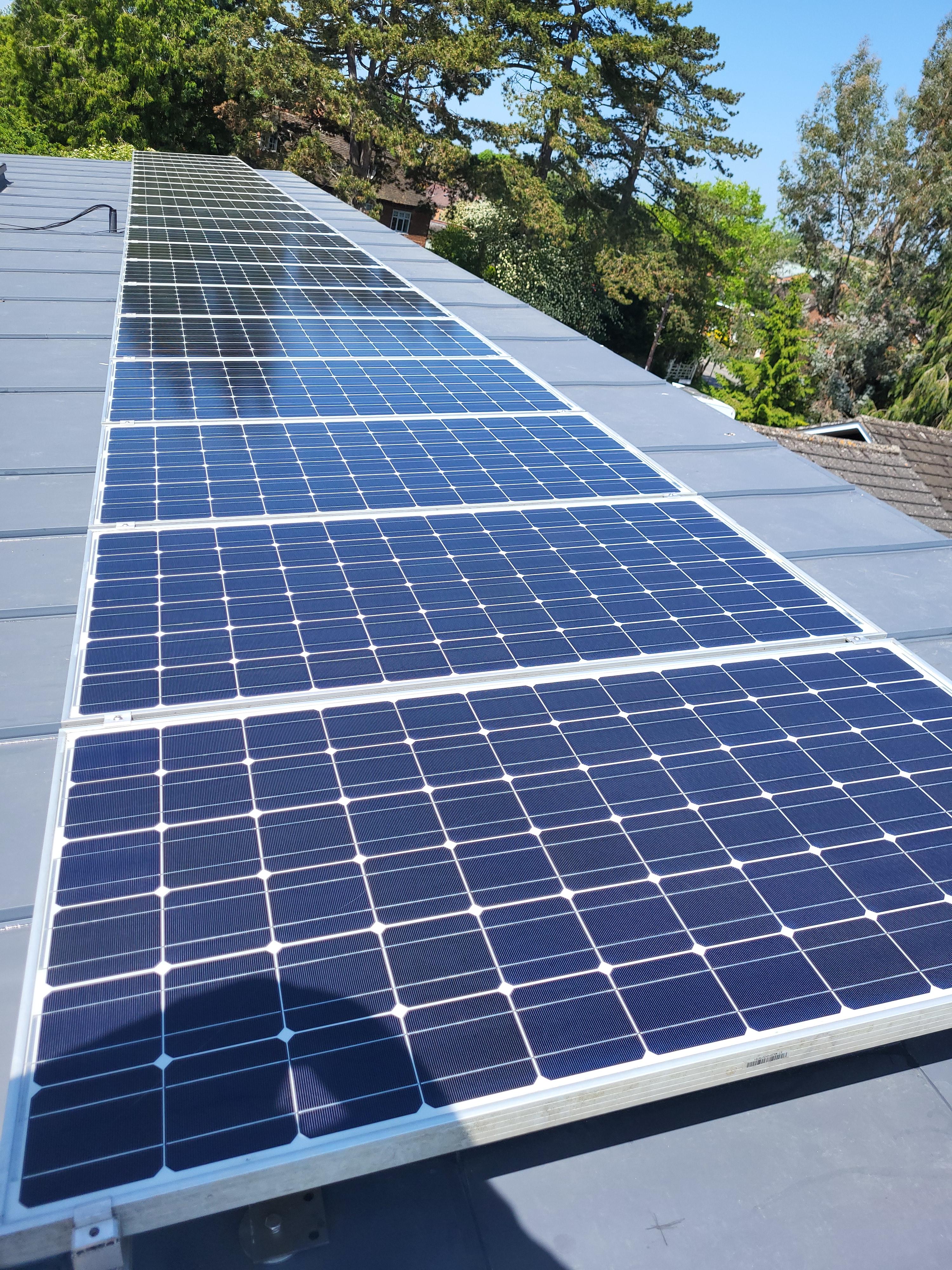

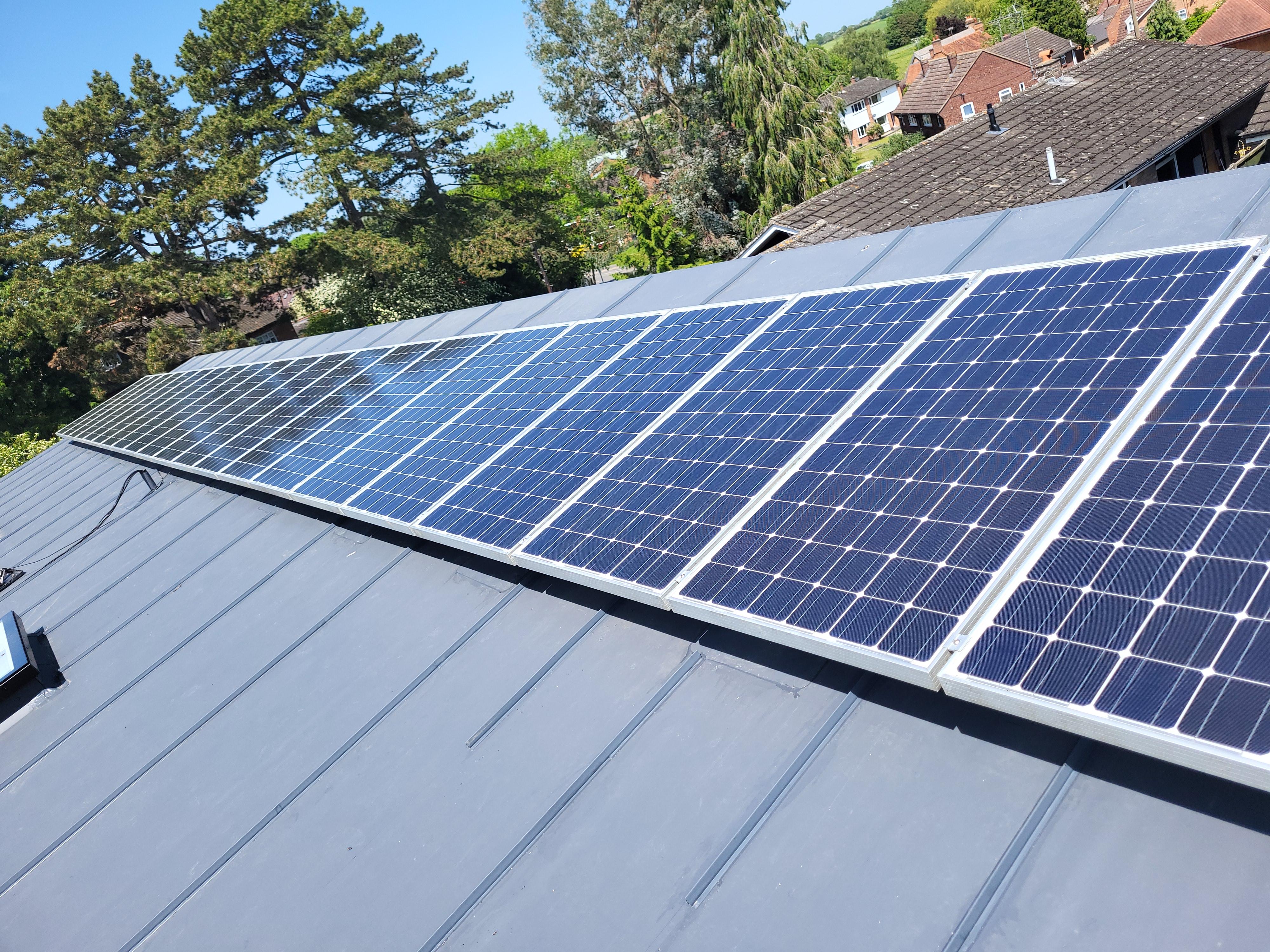

Bah, humbug can I not have integrated p.v.with trocal?
Andeh replied to CalvinHobbes's topic in Photovoltaics (PV)
We have the on roof system, it works OK but is noticable in how far it sits off the roof. We do have an old frame that was designed to sit under tiles bolted to the trocal feet which really spaces it off the roof a lot. One to sort when we replace the solar panels in future. We can't replace solar panels due to original feed in tariff we are trying to maintain. -
