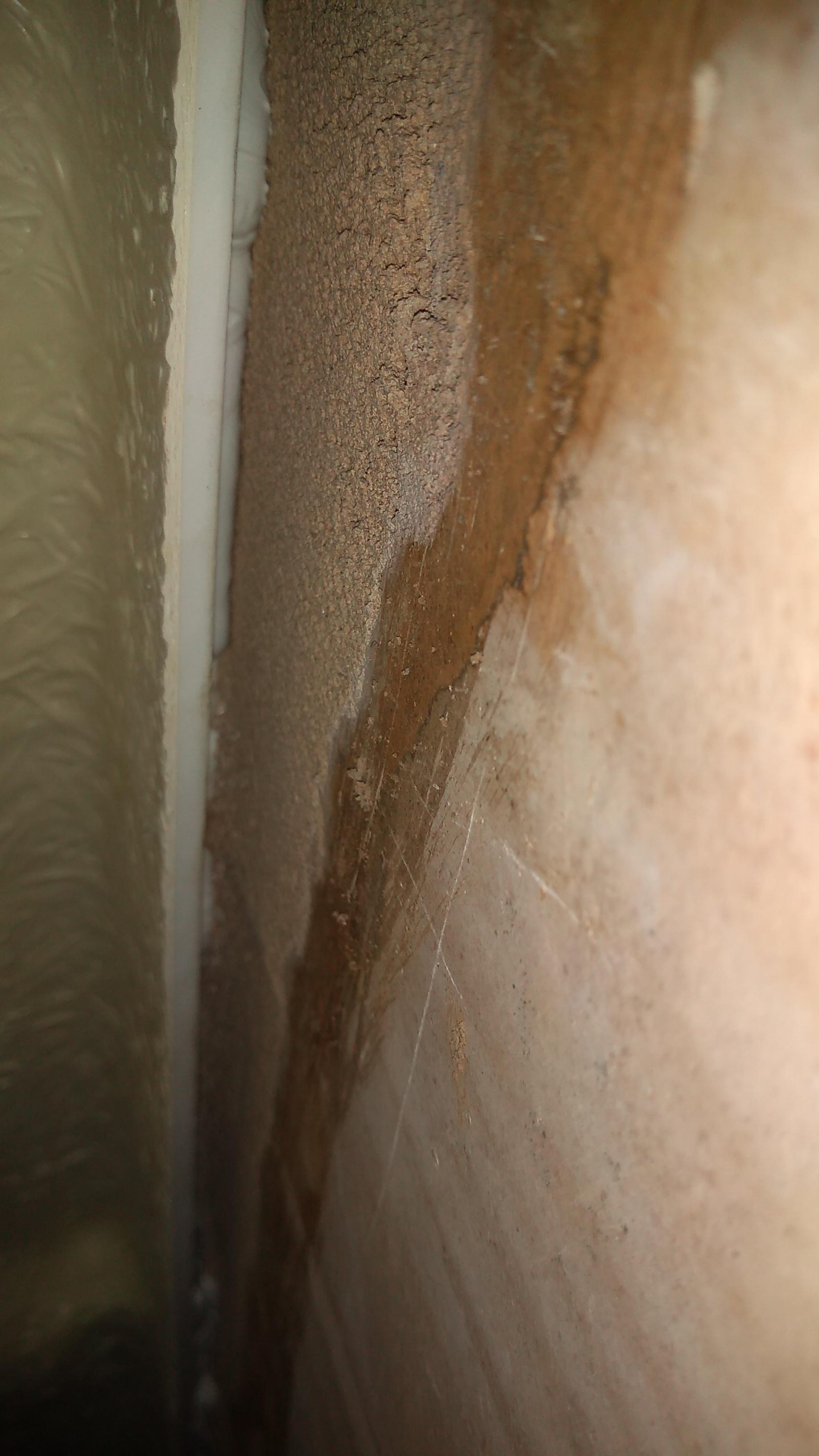

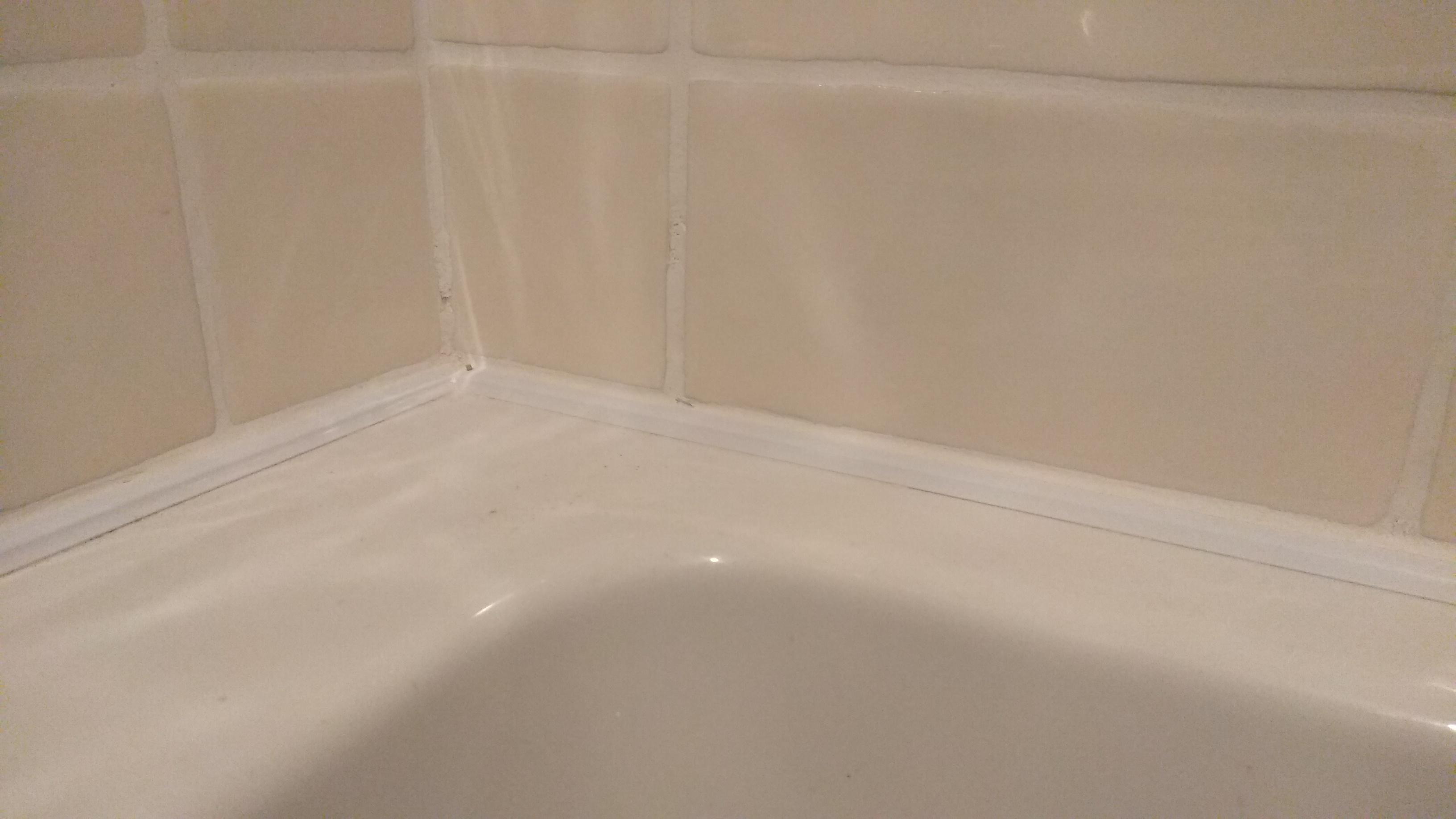

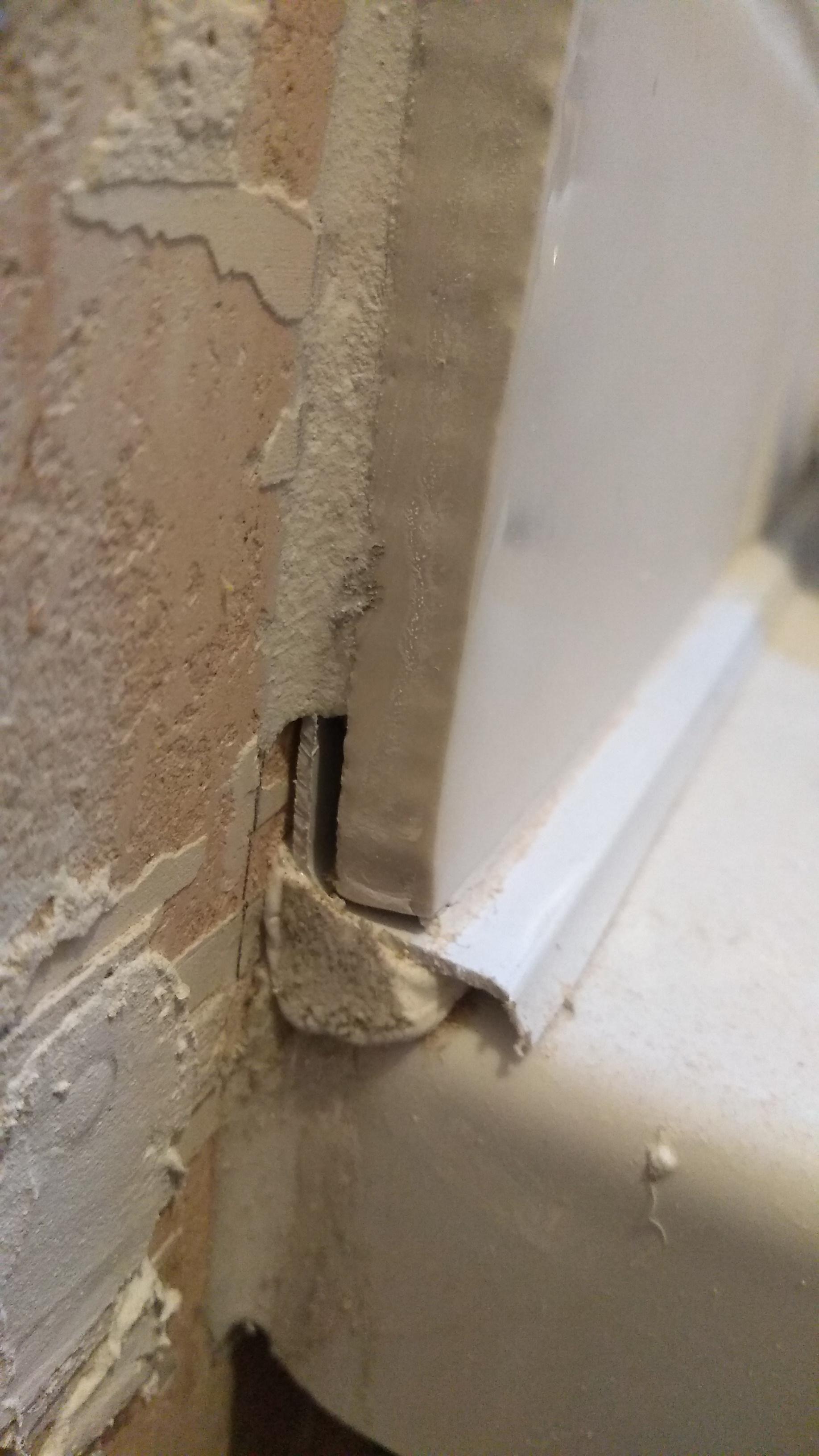

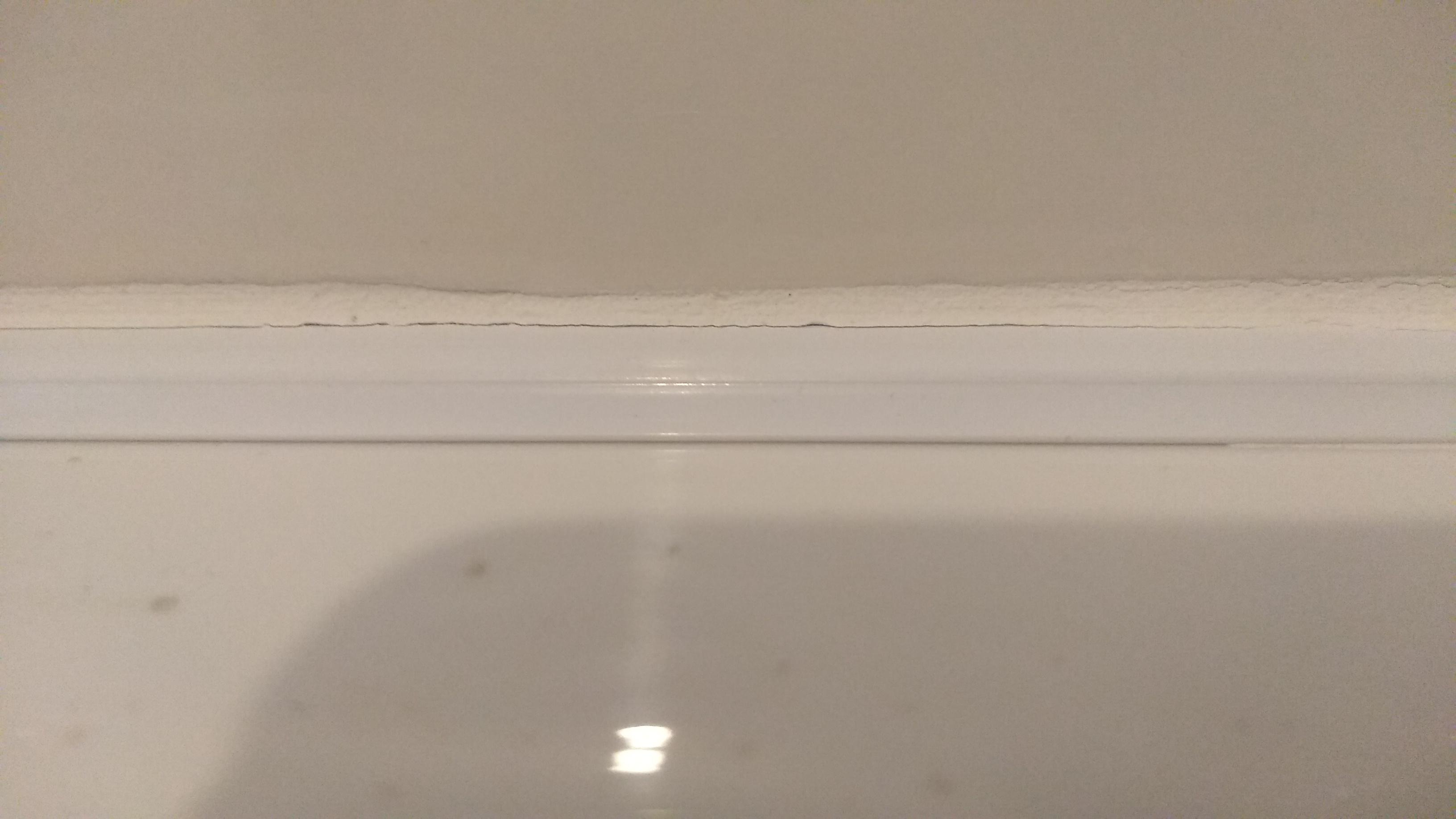

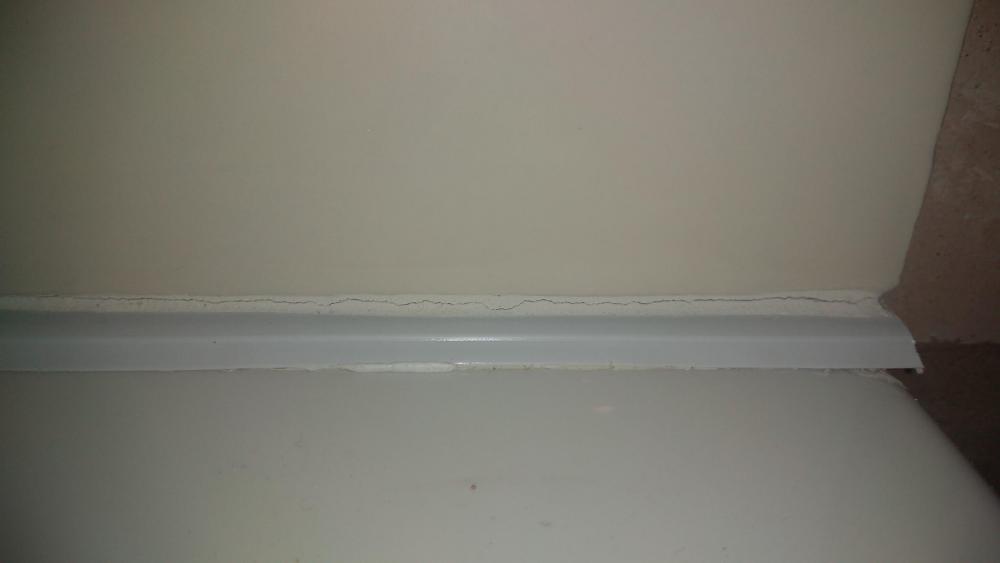

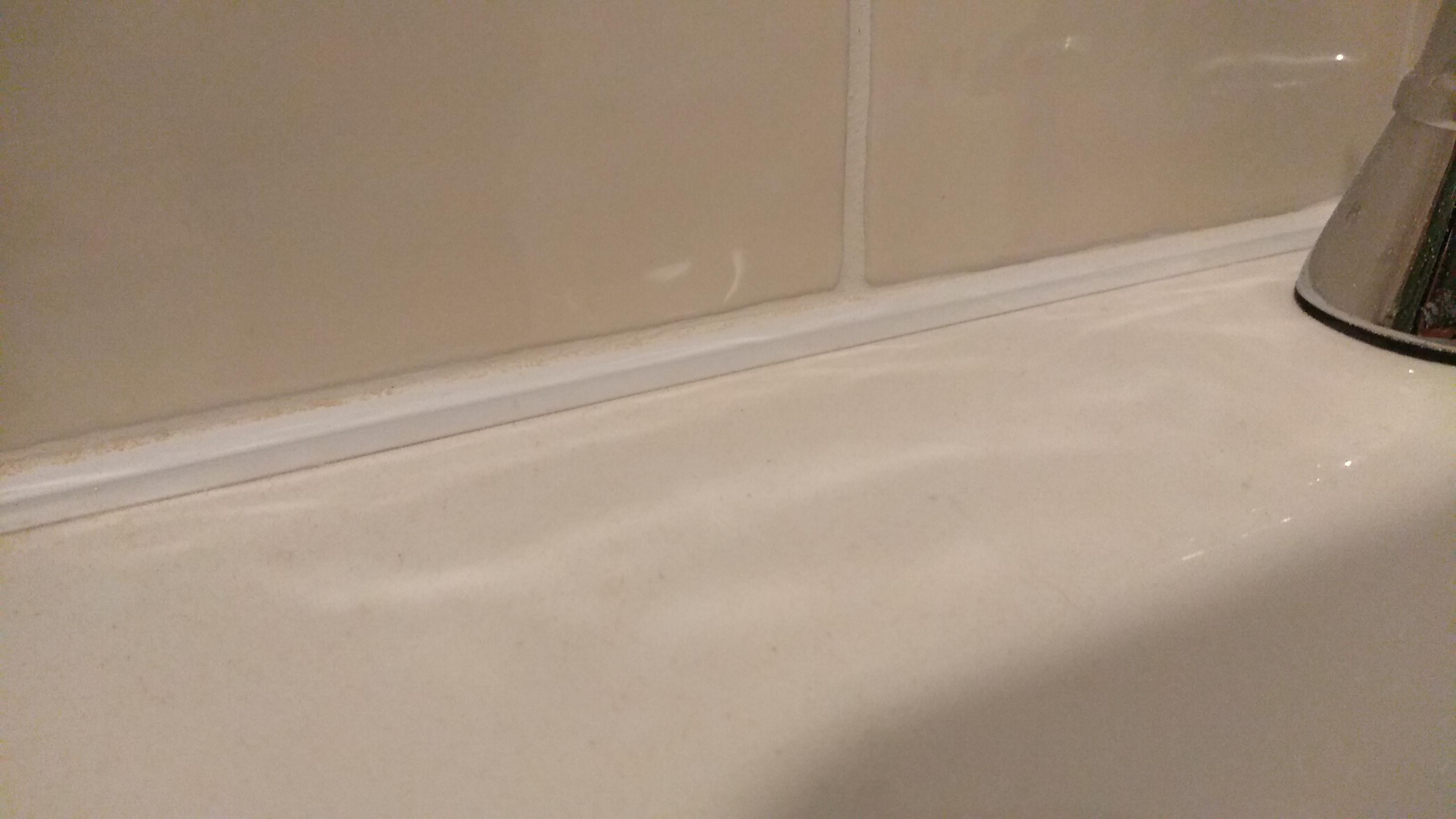

Thanks @Onoff - appreciate the run through. Unfortunately, I have since found out the exact trim that was used: https://www.tilerite.co.uk/bath-trims/overtile-trim/bbs621/ It's an overtile trim ***facepalm*** And it says "WARNING - avoid silicone contact with trim flex" ***double facepalm*** So really, the decision to use it is going from bad to worse. Perhaps using at all was a bad decision. But if it had to be used, why he didn't use the undertile version I've no idea. Probably because it was a few quid more! The other thing I've realised is that where the gap between wall and bath is widest, here: Should water get under the trim lip, I think it will actually end up in a spot that is lower than the bath edge (where I've marked red), and so won't work it's way out so well. Grrrr!
Don't mean to be a pain, but if anyone has any further thoughts on any of this, that would be a massive help. I'm going to need to discuss all this with the plumber/tiler next week and the more I understand what has been done vs what should have been done, the better (as well as what needs to be done to put it right!). Cheers.

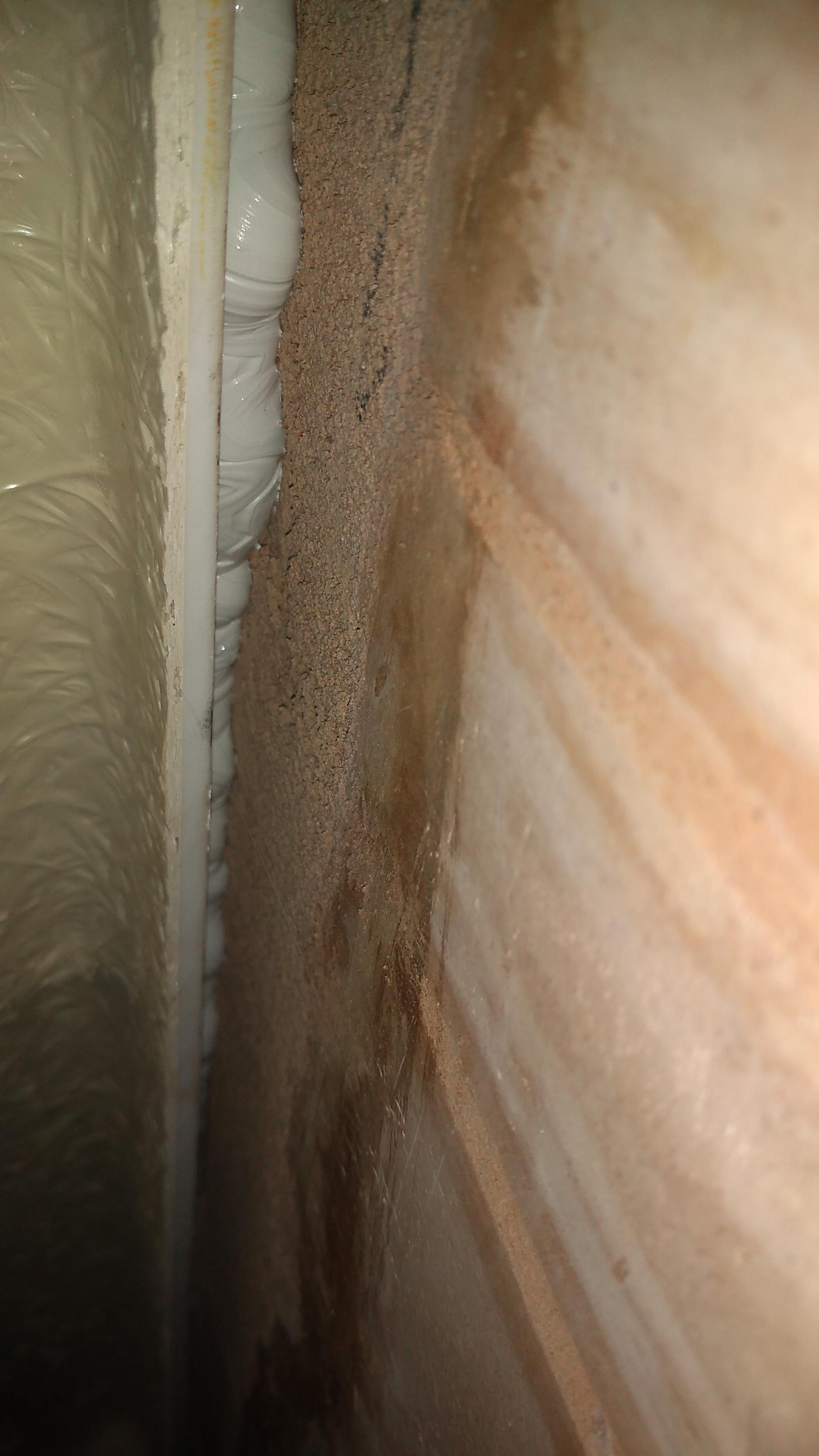

Hi all I've been away at work and so haven't been able to do anything to the bath yet. I have had time to read a bit more about it though... The verdict I've reached through reading is that siliconing onto the grout wouldn't be a good. Firstly it would be far better for the silicone to go INTO the gap that the grout is currently in. It would make for a much better longer lasting seal. Secondly, and maybe more importantly, the silicone is there to accommodate future movement whilst keeping things water tight. Having both grout and silicone bridging a gap isn't good from the movement point of view. With that in mind I'm wondering whether I'll need to bite the bullet and remove the grout before applying the silicone. Just to be clear, I'm referring to where the bottom tiles meet the trim, but also to the vertical sections where two walls meet; which have also only been grouted. Any thoughts? Thanks a million EDIT: I say this with hesitation, but I guess there is another more drastic option... Remove the bottom row of tiles, and the plastic trim, and half start again. Or totally start again - but not sure how easy removing the copious amounts of silicone between bath and wall would be. Obviously I'd rather avoid doing any of that, so if it's going too far then great. But if it needs that level of re-doing to be a decent watertight job, then I might as well face up to it now!

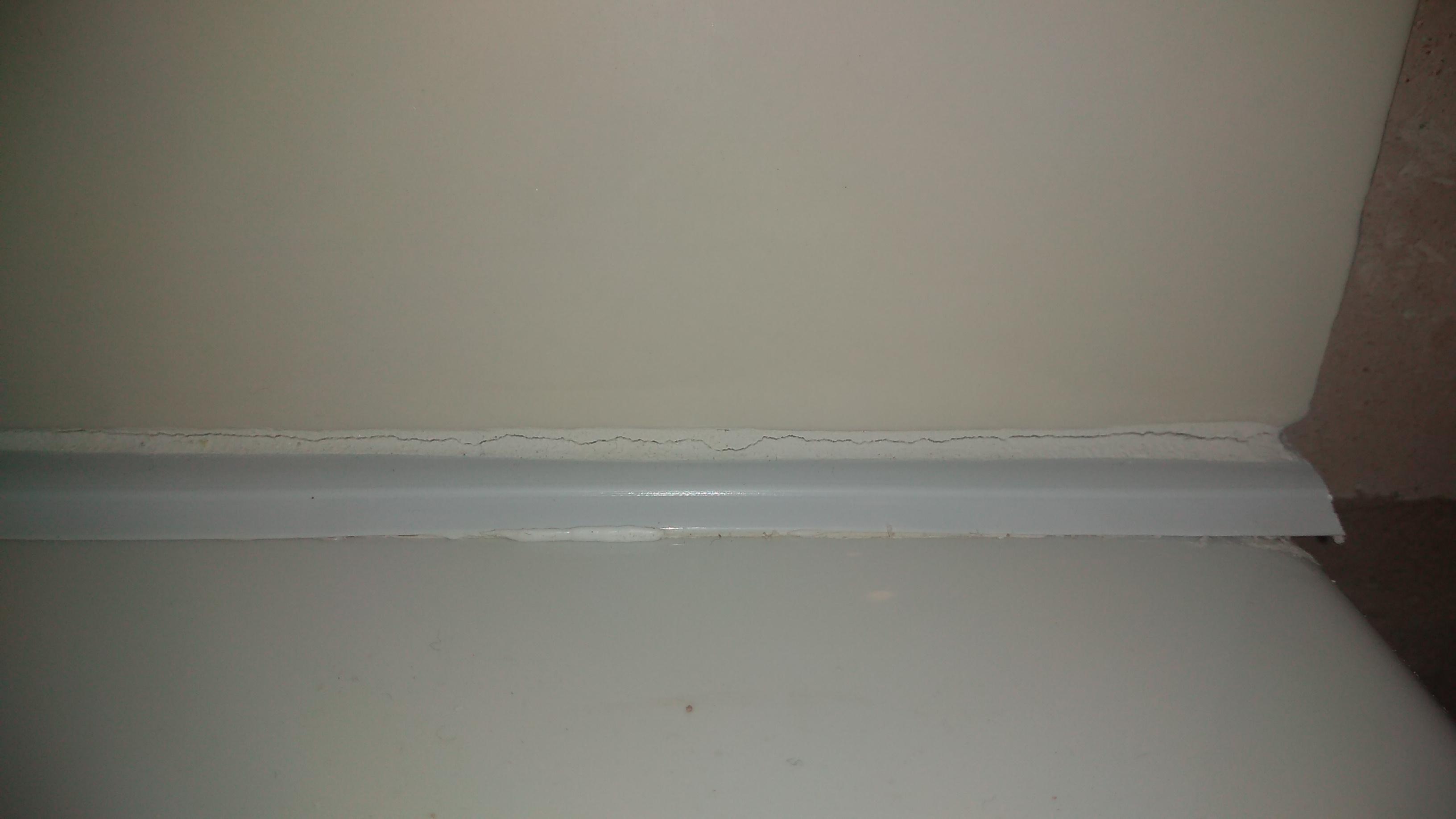

Happy new year everyone. Appreciate all the detailed guides as to how it should be done properly, and only wish my plumber/tiler was of the same mindset! The bath was definitely empty when they siliconed and later grouted. We've only used the bath once so far and there are some cracked in the grout to trim line. I'll put some pics below. Another point of interest, should there be batons or anything around the wall to give the bath extra support? There are four small plastic wall brackets that came with the bath. He used three of those. And of course the legs/feet. But that's it for support. Maybe that's enough? RE: Fugi kit. Cheers for pointing that out and for the link. I've watched a few videos and it does look handy. My only reservation is how well it will or won't work when the two surfaces don't form a right angle. Usually bath lips are sloped inward to the bath. Likewise where the back of sink meets the wall. Would the kits work in these situations. Most if not all of the videos show folk using the Fuji on an artifical demo set up (with two boards at a right angle), or in the wall to countertop join, which again is a right angle. Thanks, I'll do that then as they haven't. Thanks for pointing it out. but just to check, is it ok to silicone over the grout? Cheers all
Thanks for the replies. So seems a score draw at the moment as to whether it's a good or bad job/choice of materials. I know he didn't fill the bath when he siliconed, so that's not good. But he did use a lot of silicone to fill the wall to bath gap before the tiler came, albeit with the bath empty. I think I can handle the discolouration, just about, though I'd obviously much rather not have it and if there were other ways to do the job I wished they'd have discussed them with me first. I tend to question most things, but with this they seemed confident and so I was happy to take their word that it was the best solution. But want I want to be sure of is that the seal will be good and that it's water tight. Either as it is now, or after further silicone is added if needed. I'll post some more photos below. The first two show where the tiles and trim meet the wall at the end of the bath. That shows better how the tiles sit on the trim. and the type of trim profile that was used, which may give a better clue as to what it is. Photos 3 and 4 show the silicone from beneath the bath - at the head end (applied before the tiler came), and photos 5 and 6 show the same at the tap end. Any further thoughts most welcomed and thanks for the help so far

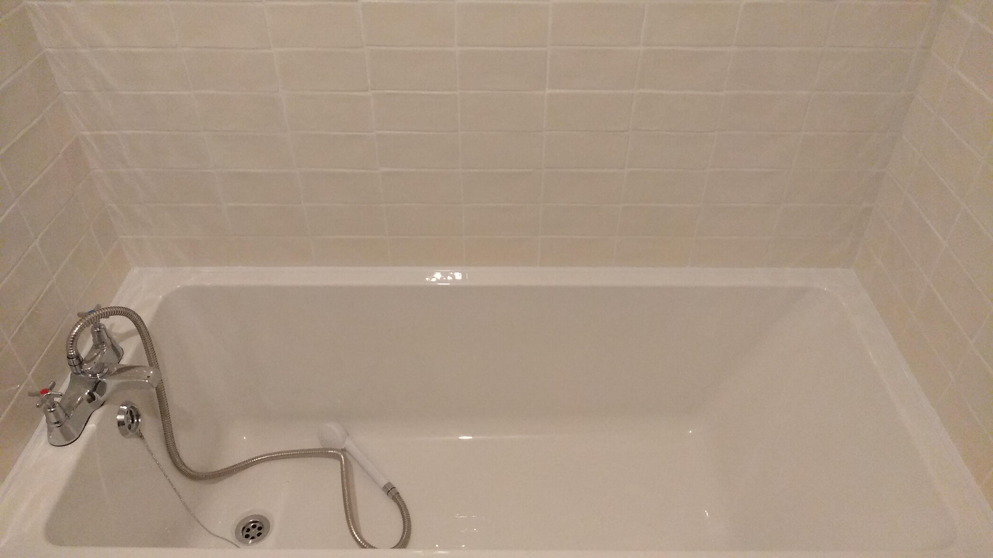

Hi all We recently had a new bath installed. It is surrounded by walls on three sides, and it turned out that one of the walls wasn't square leaving a larger gap. So when it came to tiling, the tiler said it would be best to have a tile trim, the type you put into place before tiling and then tile onto. The bath was siliconed before the tile trim, then the trim was added and then the tiles... The plumber said he would come back to add more silicone as a final step. But when he came back (he had other work to finish as well) he changed his mind and said the silicone wasn't needed. I asked whether water would get under the trim but he said it wouldn't be a problem. Just wanted to check in with you guys whether you think he is right, or whether it needs sealing? Many thanks and hope you've all had a good Christmas. Cheers
