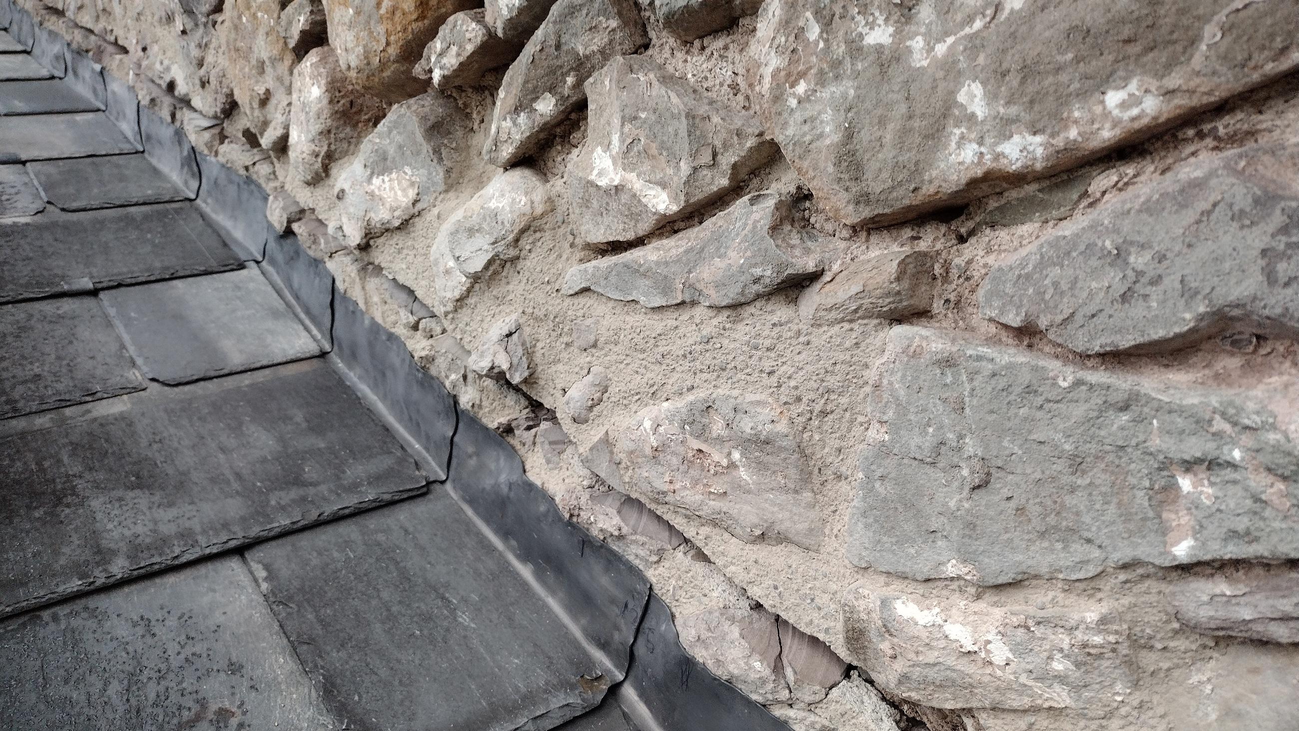

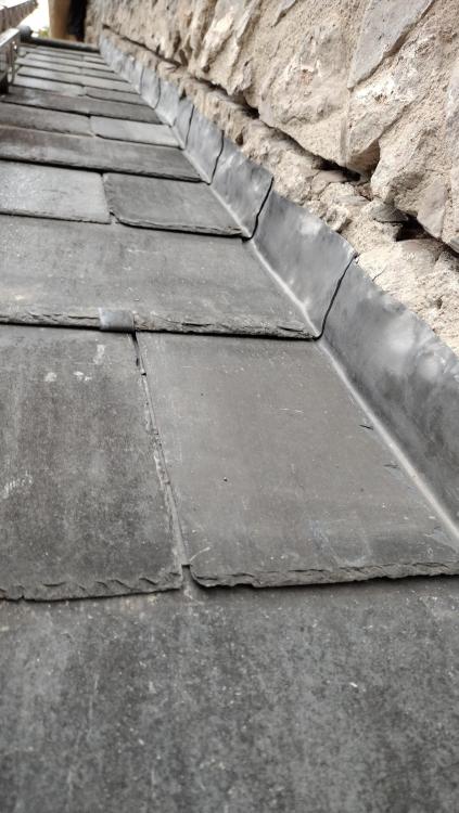

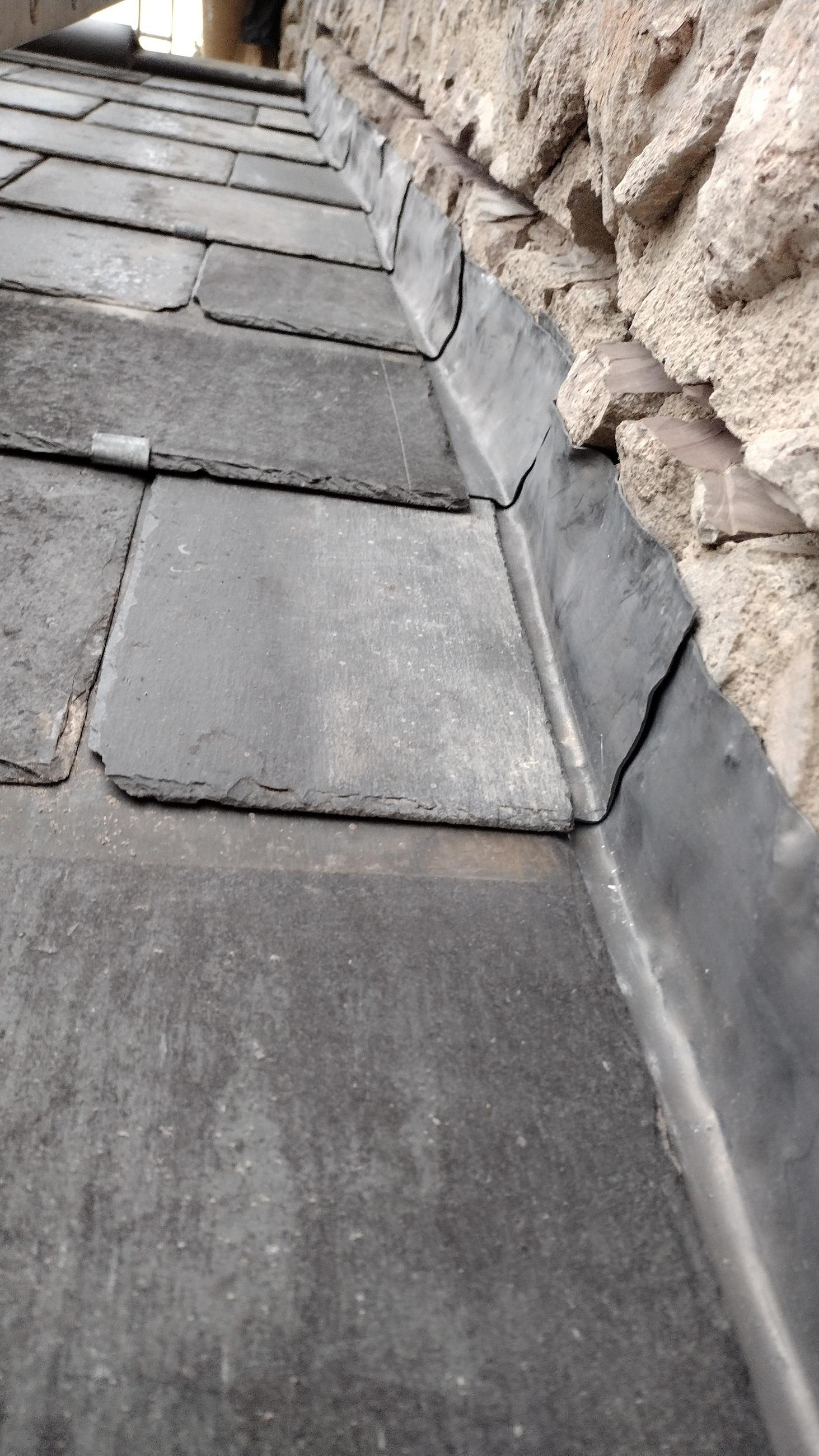

  4. Thanks @Gus Potter Here's some photos as promised.

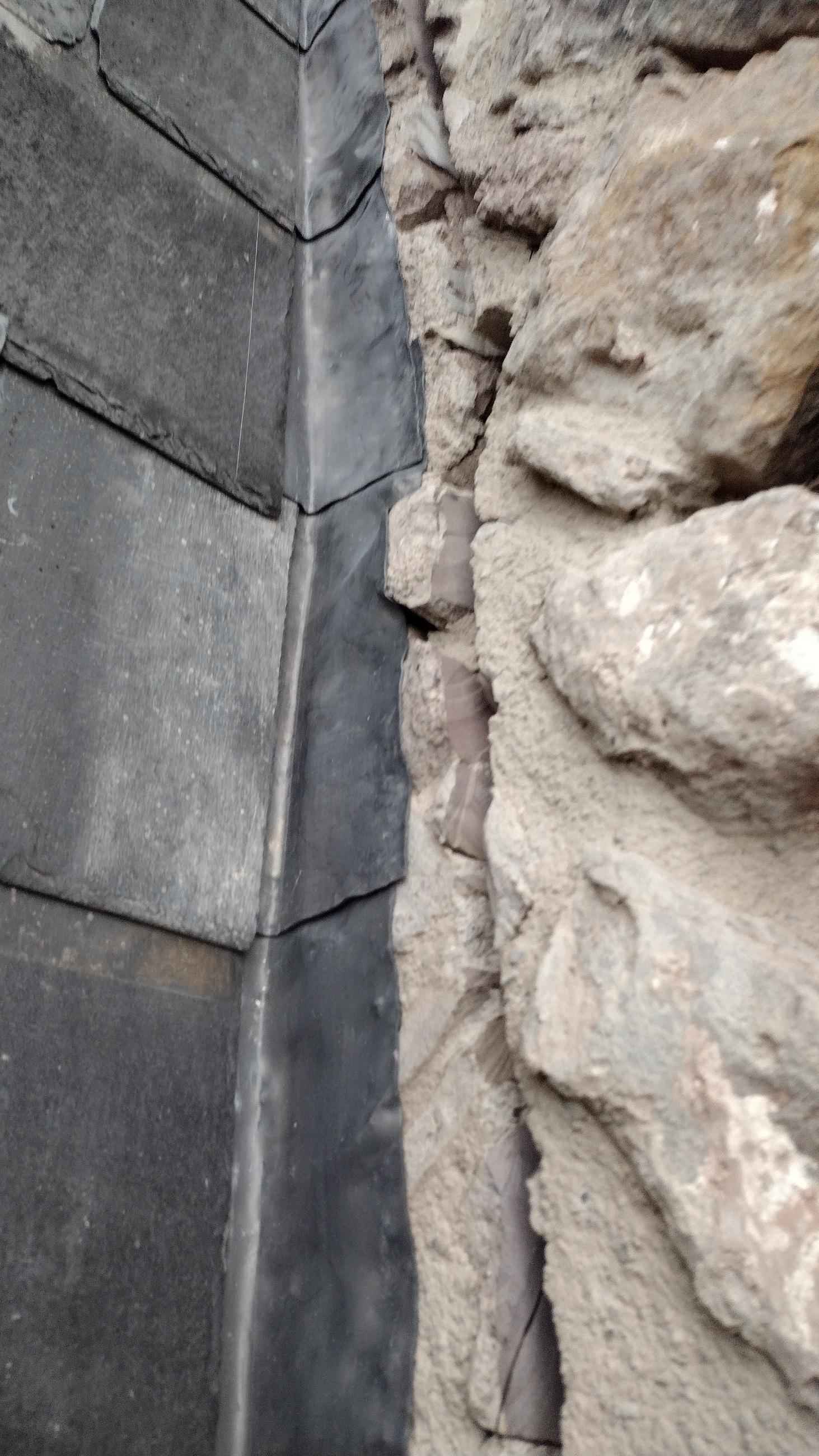

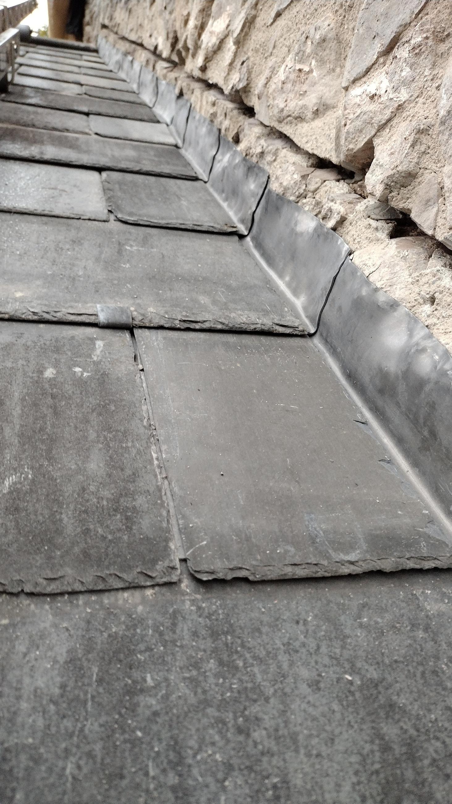

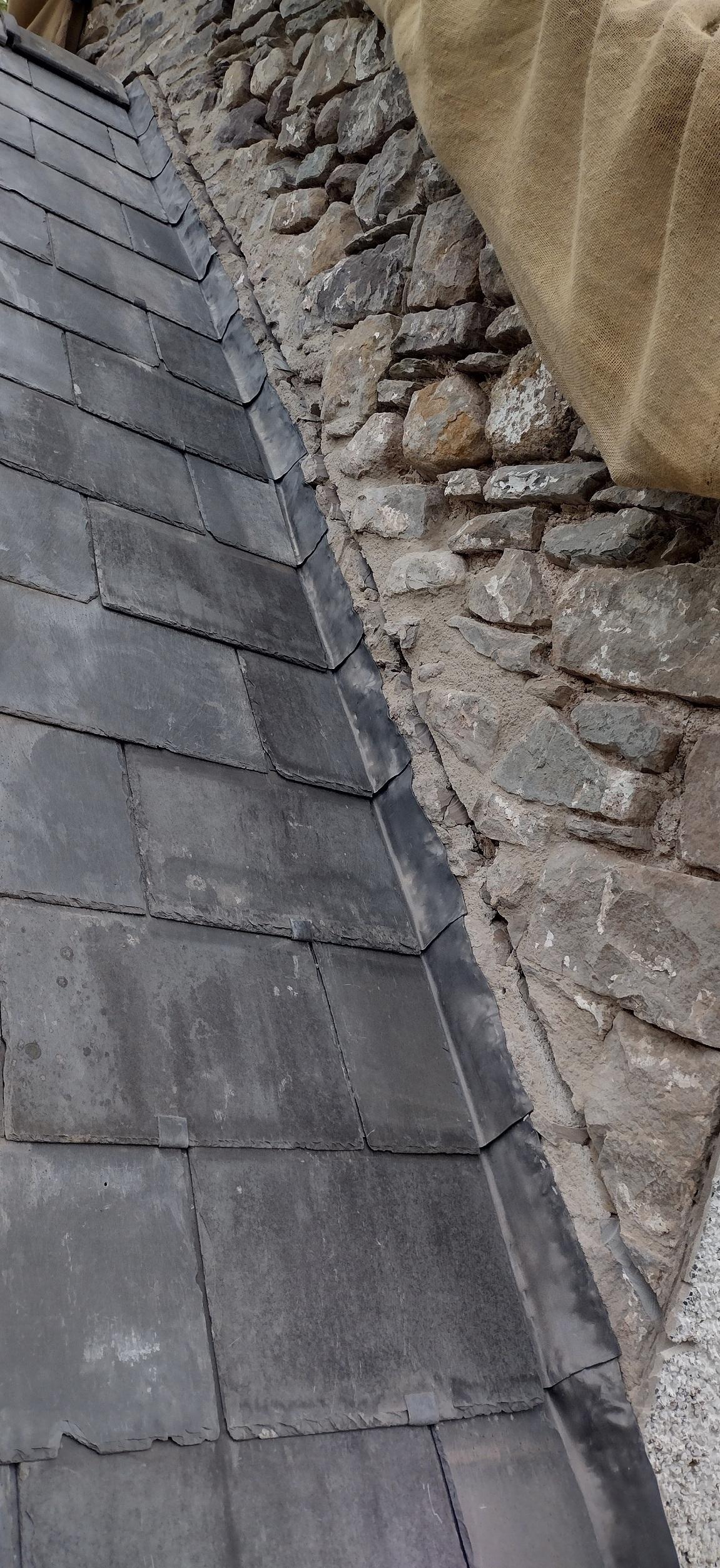

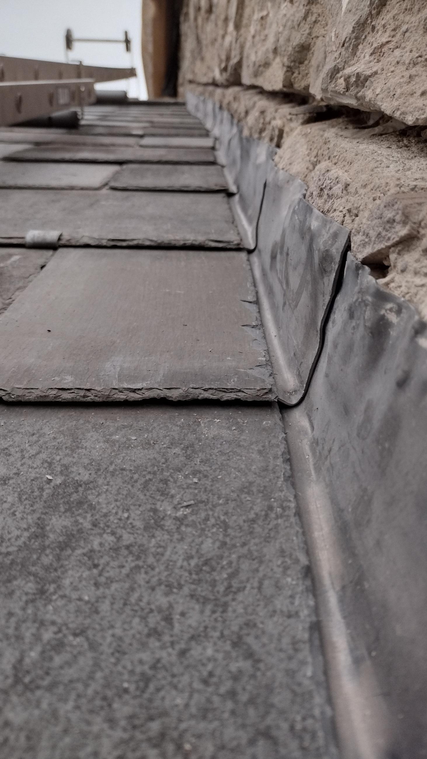

  5. Hi all I've finished installed soakers to my slate roof at a wall abutment, and I've cut the chase above ready for the flashing. The chase isn't mega straight, especially the bottom line This is mostly due to bits of stone and mortar falling away. And partly lack of skill On top of that, the vertical bit of wall that will be behind the flashing undulates and is anything but flat. I've dressed the soaker upstands tight to the wall. Should I do the same with the flashing or does it not need to be dressed so tightly? Also, I was planning to keep the bottom of the flashing about 10mm above the slates. The upstand would then be around 115mm, with 35mm tucked into the chase. Where the chase is lower than 115mm, does it matter? IE - with the lead at 115mm upstand, but the bottom line of the chase only 100mm, there will be a small void behind the lead. Is that ok as is? Or should I look to pack it somehow? I hope this all makes sense! It's been a long day. I'll try and add some photos shortly. Any advice much appreciated. Many thanks

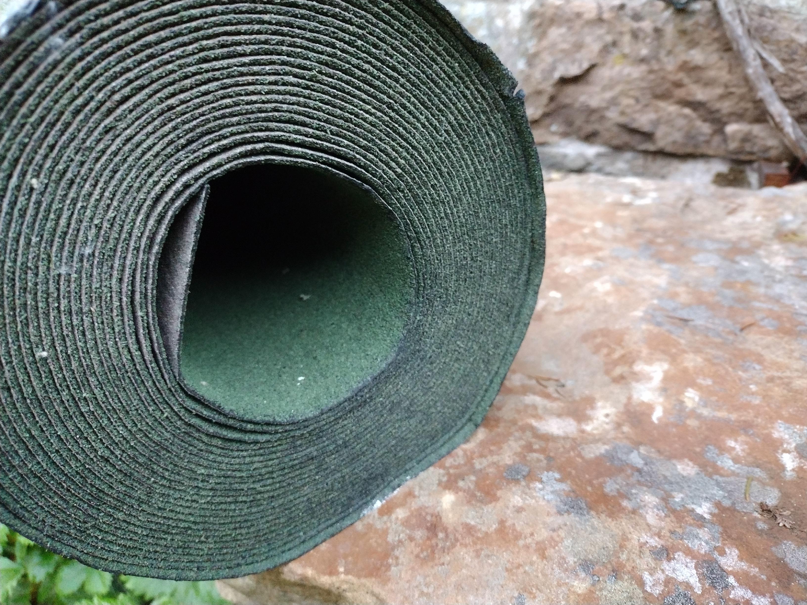

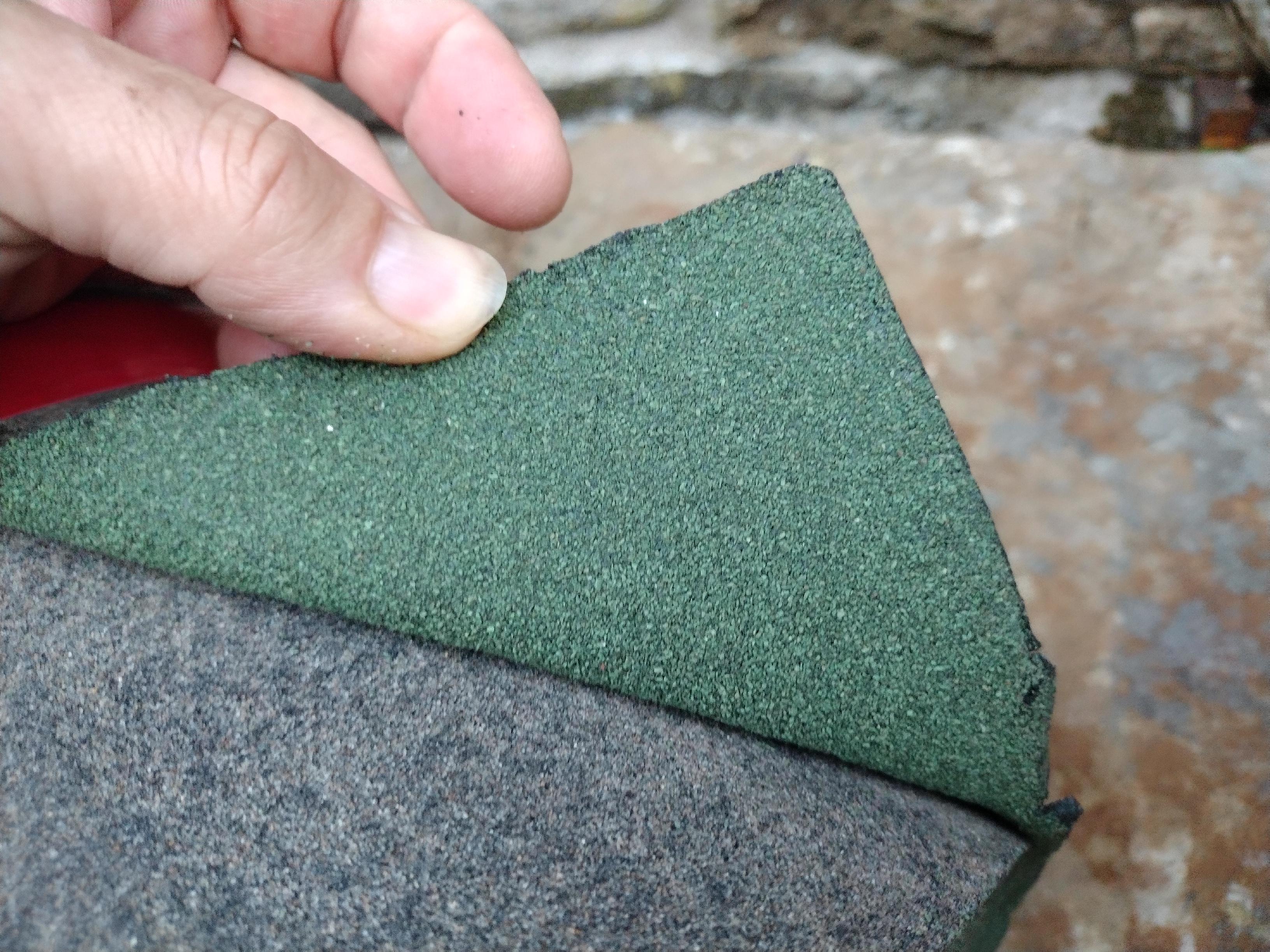

  13. At a risk of getting chucked of the forum for over posting, I'm back again! Delivery for my roof job came while I was at work. Home now and just looking at it and the 1f felt they've delivered is unmarked and green. Don't know if I'm over worrying, but wanted to check it's 1f and I've not been palmed off with shed felt. It's not like any 1f I've seen before, but I've only ever come across it on existing buildings and so don't know if it has changed over the years. It is very heavy and quite sticky, if that helps. Would rather know now than later whether it's wrong! Many thanks

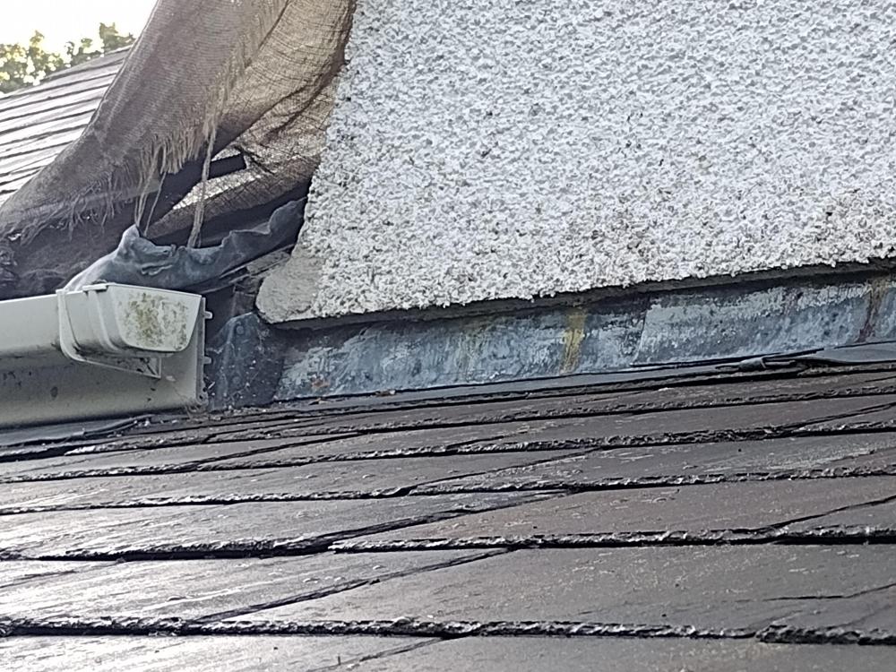

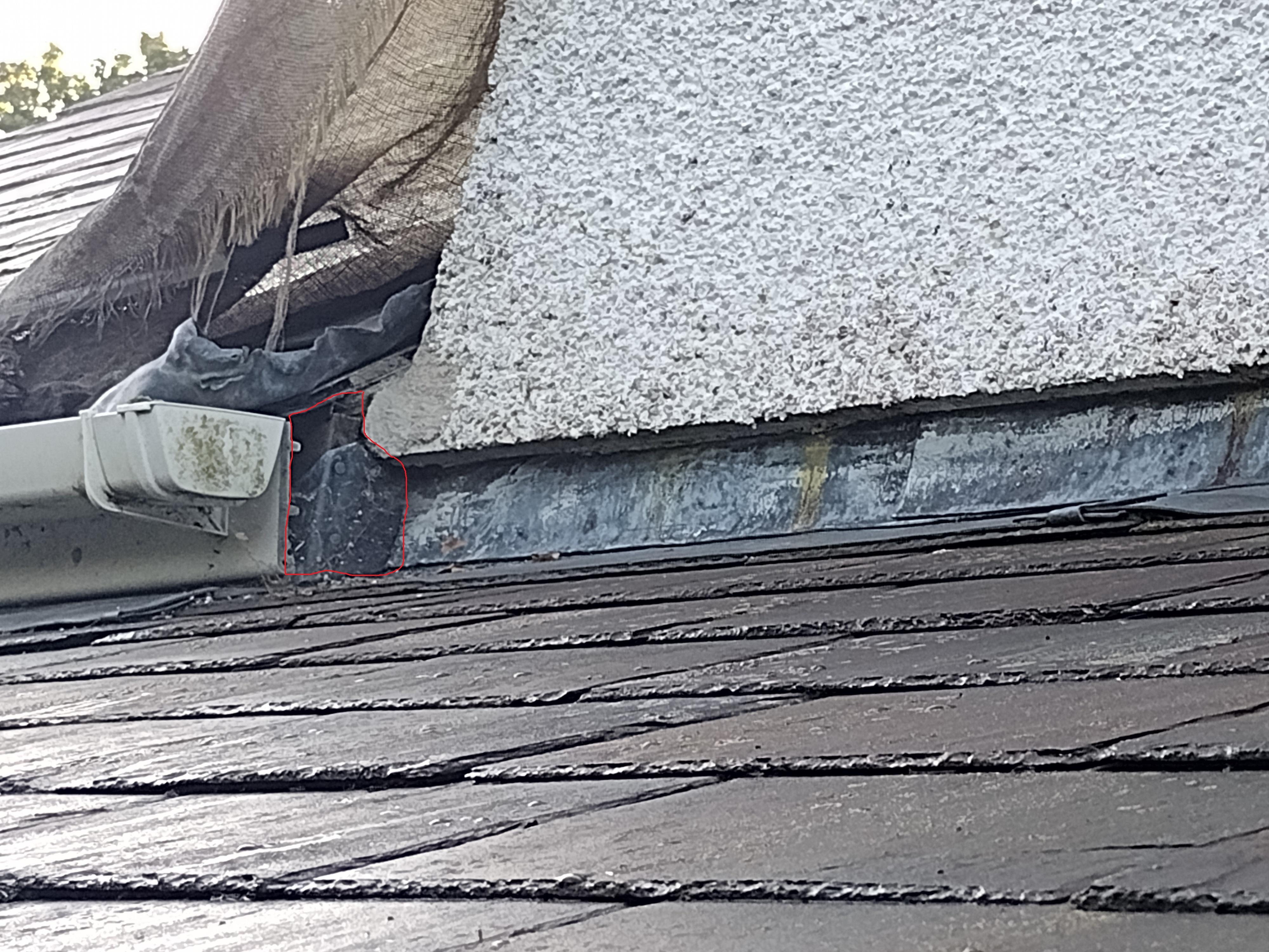

  14. What about the section below the slates, marked in red on the photo? Would you get the relevant uPVC piece and fit to cover? Or use some lead to cover? Ta

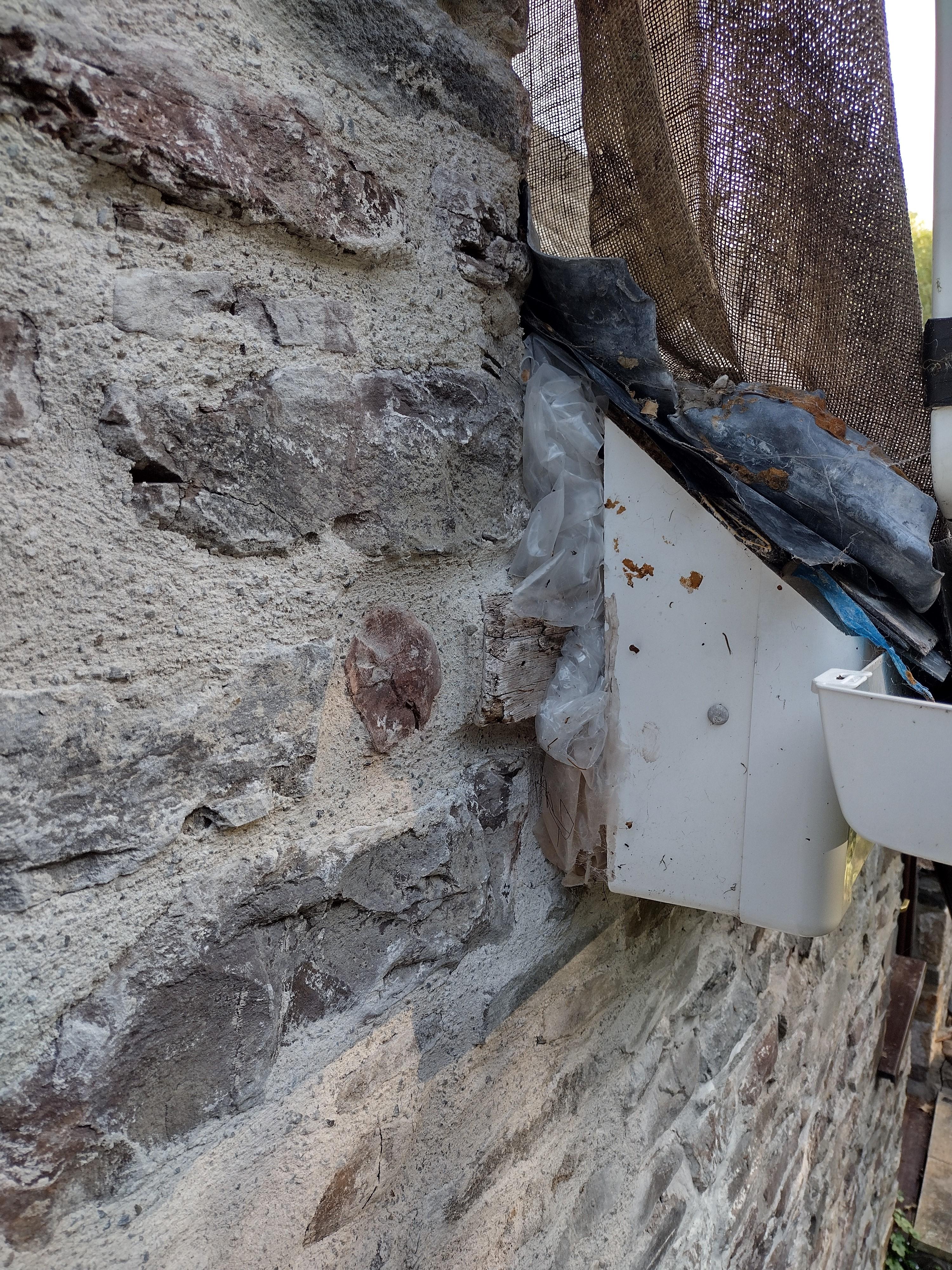

  16. Many thanks for the reply. From what you've said, I think you've got it right. But it's more the sides I'm not sure about. Maybe I didn't explain things clearly? So I've got some photos... Ignore the plastic, turned up lead, hessian, etc. Hopefully can still get an idea of what's going on even with that cr@p in the way! Cheers
