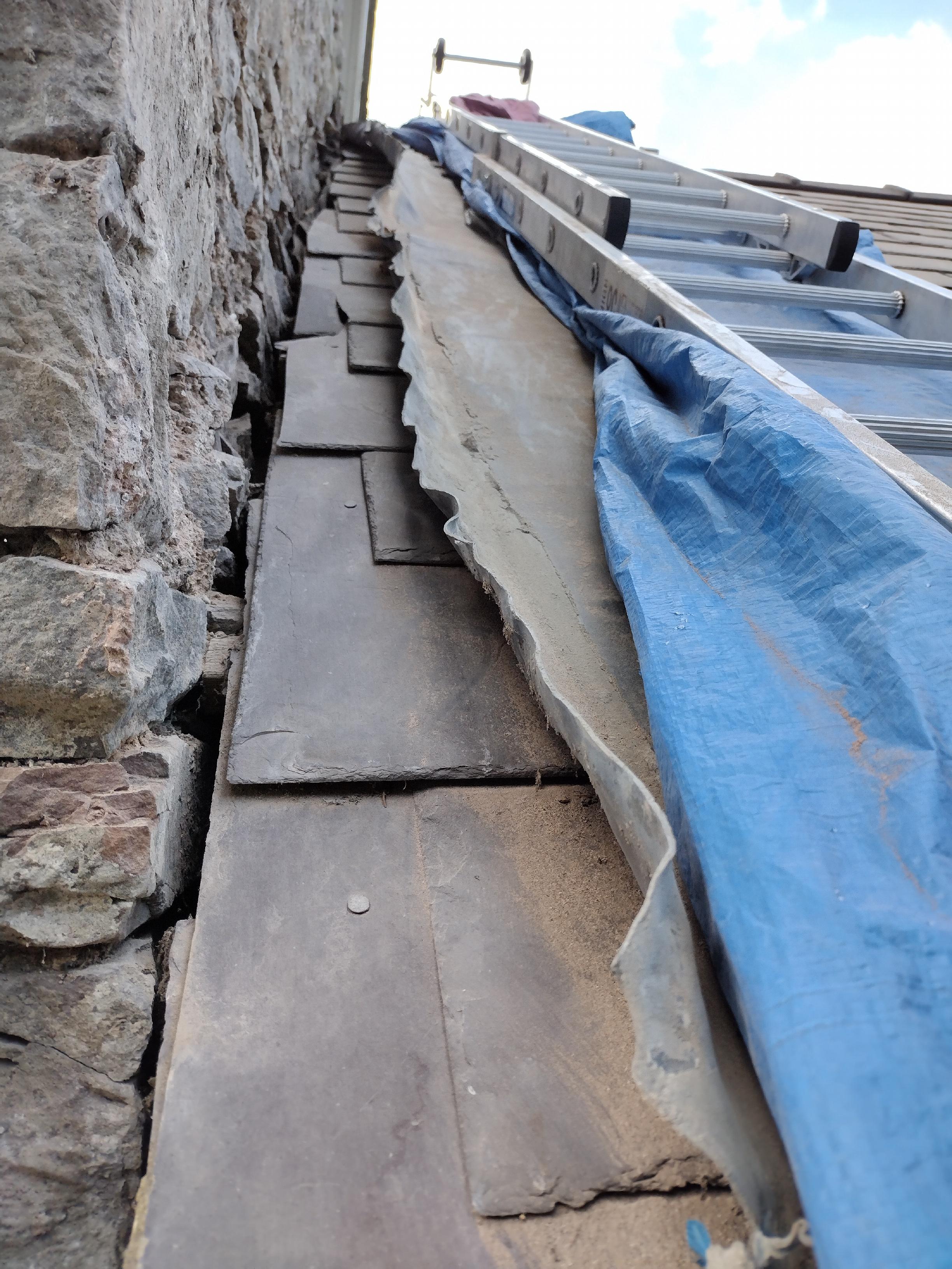

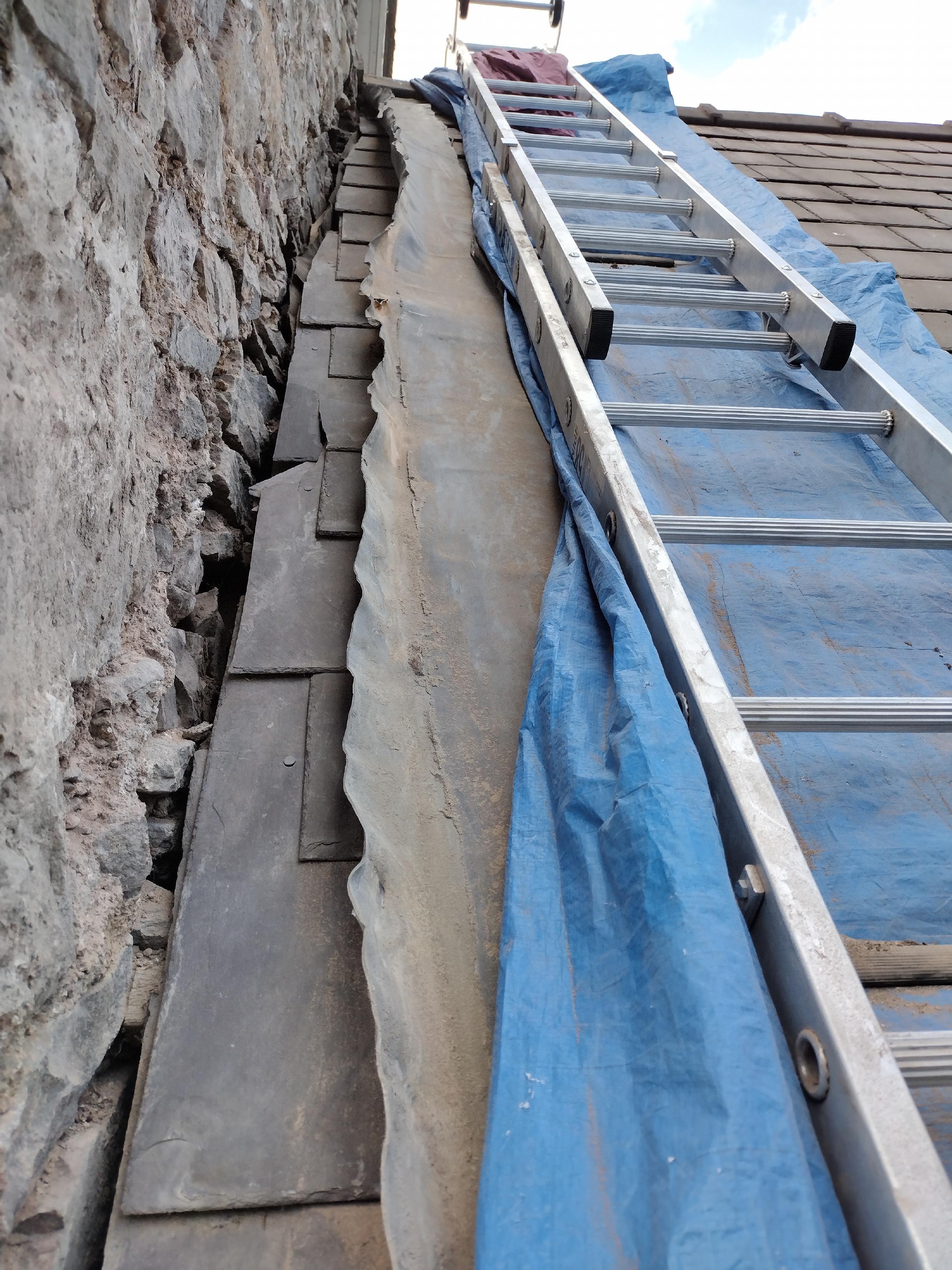

  15. Another question if I may please.... Do you think the removed lead in the photos would be suitable for the flashing? It's 240mm and Code 4 (I think), but a bit chewed up on one side from where I removed it from the cement fillet. It's also a but curved and bent. I can get a better photo of the lead if that would help assess? My thinking was to have the soakers done in new Code 3 - as suggested - and re-use this if possible. But if not I'll get new for the flashing too and stop being so tight

  17. @makie - do you mind if I just clarify, seeing as you responded before I posted photos... Now that you can see the job, do you think it would still be ok for the soakers to tuck long lengths of lead in beneath those slates? Most likely without removing or lifting any of them? And just to add, for the soakers he'll be re-using the lead you can see in the photos. Many thanks

  19. Thanks, but just to be clear, for the soakers in his proposed install it wouldn't be showing. It's more than he would b putting in long lengths of lead underneath all the slates. True that there would be flashing visible, but he's got 150mm for that. So with 100mm or so up the wall, there'd barely be any on the slates. Not to mention that due to the lay of the land that part of the roof isn't all too visible anyhow. Ta
  20. This is all I've got at the moment, but here's a couple of photos showing what's there....
  21. To be honest, I think he is planning to try to save time and money. RE the soakers, from what you guys have said, and having watched more videos - taking slates off, cutting individual soakers, and putting them in piece by piece and slate by slate, will be a lot slower and more work than not removing any slates, sliding in a couple of long lengths of lead beneath them, and calling it a day at that. I should have added that the wall is an old stone wall. Not only is it not flat faced, but it doesn't run a straight line either Iit curves a bit). So stepped flashing is not an option. Thanks again for the help.
