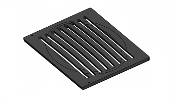

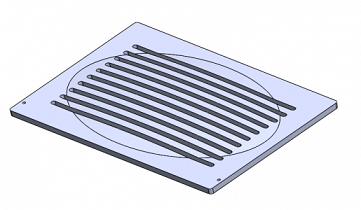

  19. Hi Sorry to return so soon with another wood stove question... This time it's about multi-fuel (MF) vs wood only (WO) stoves. From the reading I've done, there seems to be mixed opinions on whether a WO stove performs better than a MF stove, when burning wood only. Open Grate. One of our shortlist stoves is the ACR Earlswood III and Astwood II. Both are MF and have grates with permanently open slots. See: The stoves tick a lot of boxes for us, but the grate puts us off. The manufacturer has said that it won't affect performance, so long as there's a good bed of ashes. But logic and the opinions of some on the net would perhaps suggest otherwise. "Hybrid". I used the term "Hybrid" in the title to refer to stoves like the Clearviews and Woodwarm Fireviews (others too I'm sure), which have riddling grates which can be put into a closed position and provide a flat bed. But there's still gaps between the bars so it's not a truly solid bed. And whilst the primary air can be closed (at least I know it can on the Woodwarm), I'm not sure if that totally prevents air getting through. A Woodwarm Fireview Eco is a contender. Wood Only. Another contender is the Dik Geurts Ivar 5. True wood only burner with vermiculite bricks on the bottom. Any thoughts on the three types and how relevant or important the grate/base situation is for wood only, would be most appreciated. And just to add, I've read that a bonus of the MF and Hybrids is that the Primary Air coming in beneath the grate can be very helpful getting the fire going. Yet on the other hand, a WO without the grate and ashpan means a larger firebox. Over to you guys! Many thanks
  20. Thanks for all the additional replies, much appreciated. I think once we've decided on our stove (new thread coming up to help with that), I'll speak to the manufacturers about distances to non-combustibles, risk of plaster cracking, minimum distances for good airflow, etc. And I'll discuss it with the installer as well. I'm hoping we won't have to do anything. But if we do I guess my favoured option would be to fix some thin fire rated board to the walls around the stove, and paint them in the same colour as the walls to help disguise them. If that's not sufficient, then perhaps remove the plaster in the necessary areas, get the walls back to brick/block, and then replaster with Vitcas type stuff *OR* use the thin fire rated board, fixed directly to the brick/block. Thanks again
  21. That's why I've made the thread - to try and find out what is a good distance to avoid these things. Not least of all because one installer has said 100mm is ample whilst another has said 400mm. I only made the "Non-combustibles don't combust" comment in response to the point about invalidating a potential insurance claim if the proximity to the wall caused a fire. Just thinking about other options... Aside from the heatshields you can get with some stoves, and the Vitcas type plaster you can apply to the walls instead of gypsum, is there any type of THIN fireboard which you can add to the plastered wall WITHOUT an airgap? Something I could then paint in to be the same colour as the rest of the room and therefore barely noticeable? If so, what's the thinnest available and does anyone have any info or links please? The only thing of this ilk I'm aware of requires an airgap between it and the wall, but hoping there's other options... Many thanks
  22. But that's with regards combustibles. Non-combustibles don't combust! We're lucky in that there's no nearby combustibles. And anyhow, it will be installed and signed off by a HETAS registered fitter.
