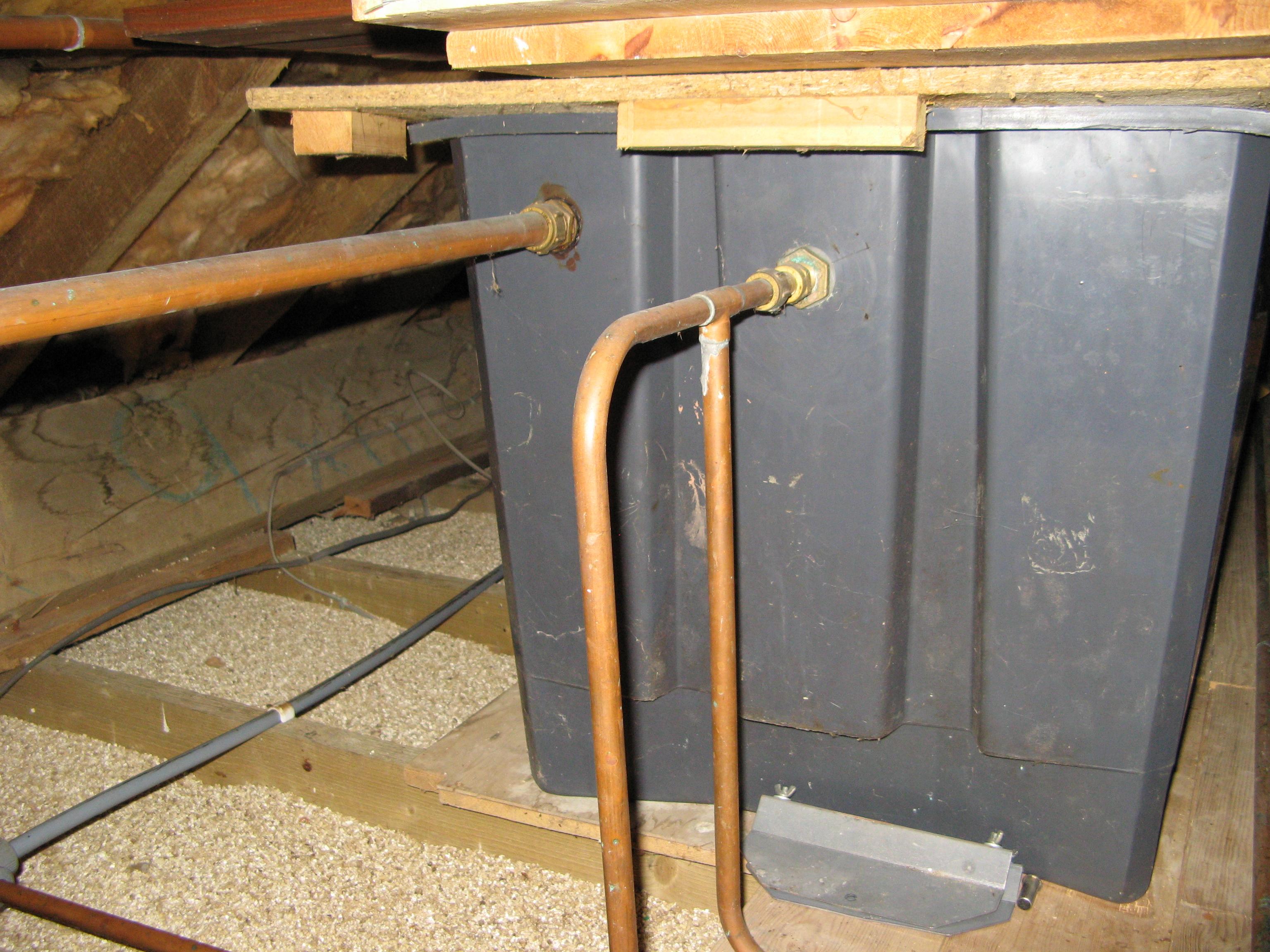

Hi all I think I'm going to stick with OPTION1 and go for the least intervention and cheapest approach seeing as it's always possible we'll have to get a new heating system at some point in the future anyhow. - Lid. I think I'll see if I can get a new decent fitting lid, although not sure how likely that is. Do lids tend to be "unipart"? If not I'll make one as suggested, but where might I find suitable plastic sheet? - Insulation. I'll get a jacket too. A quick look shows standard types tend to be for a 50 gallon tank, whereas mine is 60. But I'm sure I can hunt something down if they exist. - Cleaning. Think I'll drop some Milton in to be on the safe side. I was thinking also that while the tank is empty I'll give it a scrub and clean, perhaps with a spray or two of anti-this-and-that spray. - Overflow. Someone on another forum pointed out that the overflow should be below the ball valve. Do you think it needs changing? If so, will that involve a whole new overflow, new hole in wall, etc? - Vent pipe. They also pointed out that the vent pipe needs shortening. Will that be as simple as cutting a little off? Thanks everyone and have a great week. -

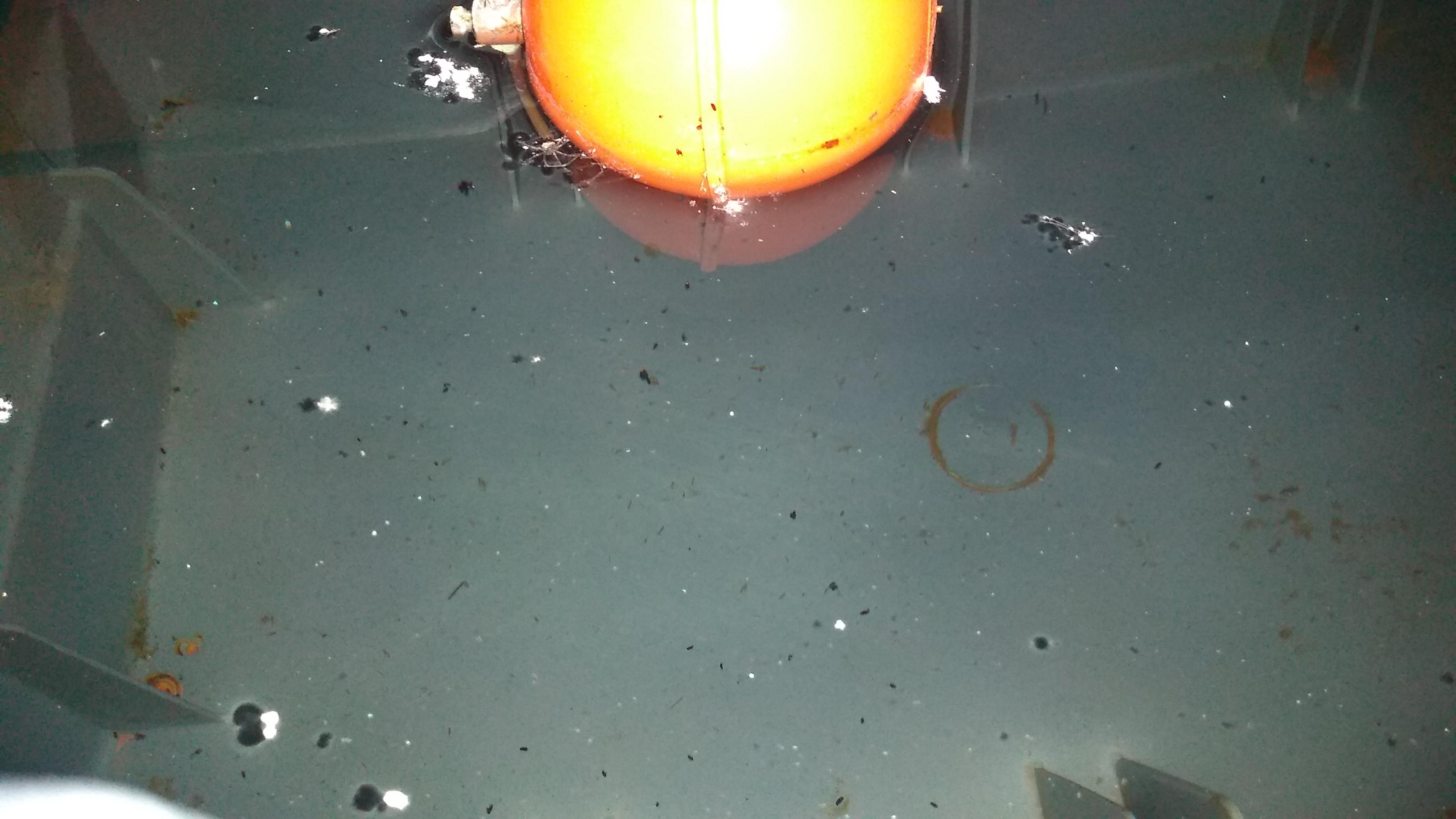

Well, good to hear that it at least looks clean. Taste test next... I've just baled some out and made my partner a glass of squash using it. I'll she if she notices anything untoward On a different note, but seeing as we're talking about the tank now, when we get the plumbing work done and the system is drained, I need to have the tank disconnected so that I can change the boards underneath. I'm now wondering what my best option is. Would any plumbers mind giving a rough idea of prices/price differences on the following, to help me decide.... OPTION1 - plumber disconnect pipework to tank, and F+E tank. I will then do the board replacement work. Plumber reconnect all pipework with the tanks in the same places. OPTION2 - plumber disconnect pipework to tank, and F+E tank. I will then do the board replacement work but build a higher platform for the tank for better gravity pressure. Plumber to extend current pipework for new cold water tank position (F+E wold remain in the same place) and reconnect. OPTION3 - as per Option 2, but fit a new tank instead of the re-using the old one (with proper lid, and an insulating jacket, plus the ball valve isn't looking great). Thank you so much -

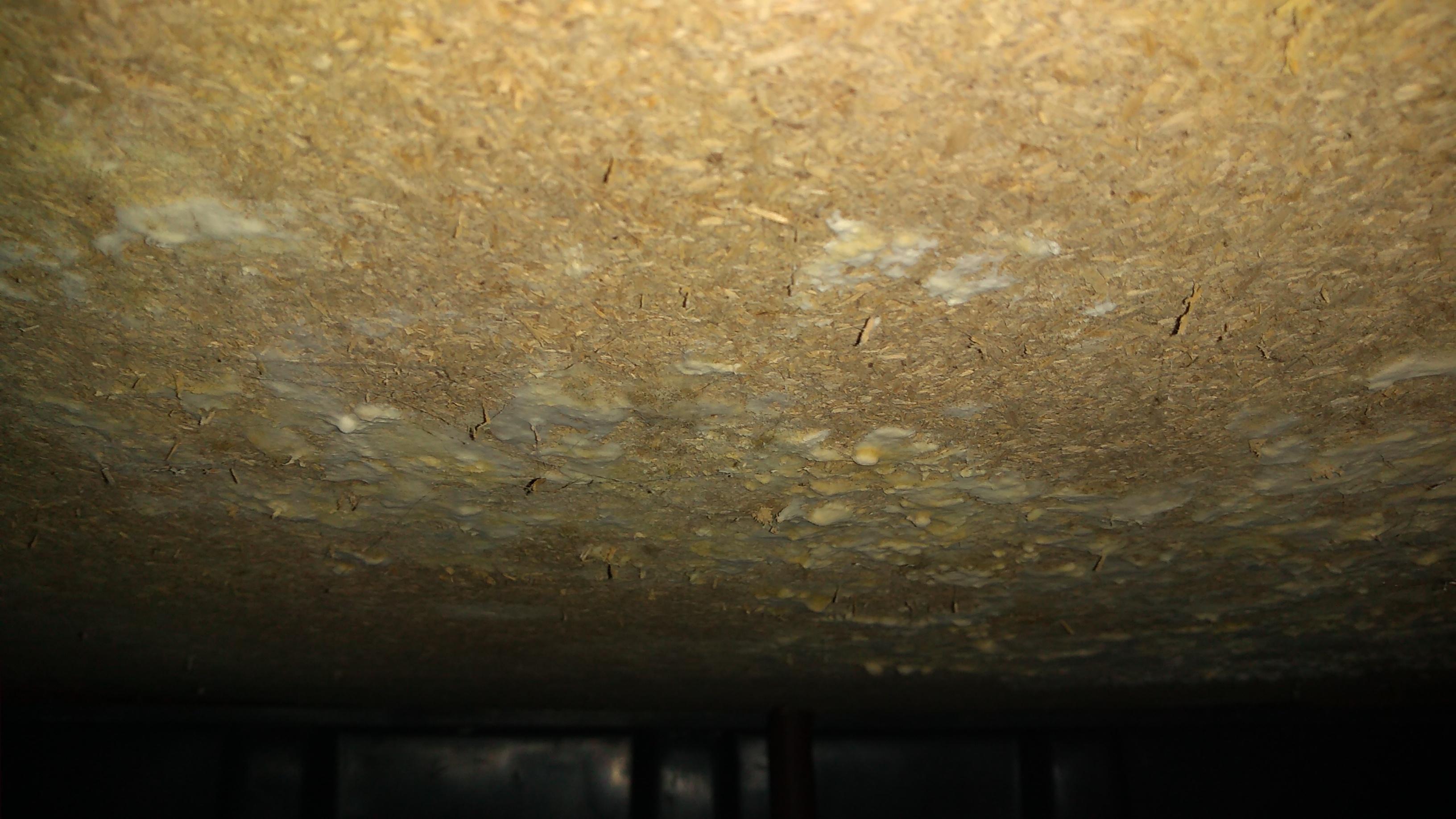

Took a look at the inside of the tank just now, and whilst there I thought I'd take some photos so those with a more experienced eye could say how it looks in the scheme of things. I appreciate not all nasties are visible to the eye though! We've got vermiculite insulation so I think that's what the white floating bits are. The underside of the "lid" has a coating of white mouldy stuff, so I took a snap of that too. Thanks to you all for taking the time to help with your replies. -

Hi all For various reasons, we haven't used the hot water system in our house for a couple of years. It's a vented system with a tank in the loft. I want to try it out now but wonder whether there could be any potential problems from Legionella or anything else potentially nasty? I don't know whether the fact that the water has never been heated over the time means it is not a breeding ground for anything dodgy? And if there is a potential for nastiness, will heating the water in the cylinder make it all safe again? Or is the best option to run off enough water so that both the tank in the loft and the cylinder have fresh water in them (I'd rather avoid that but if it needs to happen then so be it). Many thanks

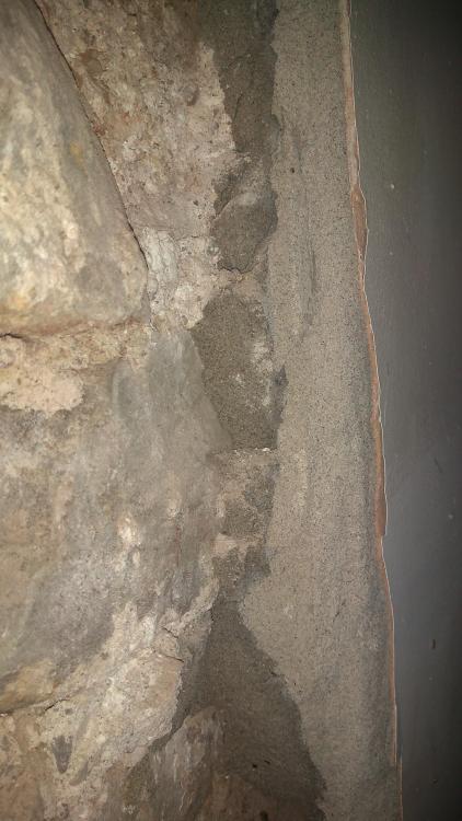

Thanks @markc A few folk on another forum seemed to think I should be more hesitant and think twice about removing the render. But I've since had someone come round to take a look... He said he thought all looked well, that I should continue, and that removing concrete render and re pointing in lime was a good thing for the fabric of the building. I think I'll therefore continue, but any other thoughts in the meantime from forum members are welcome. Have a great weekend everyone.

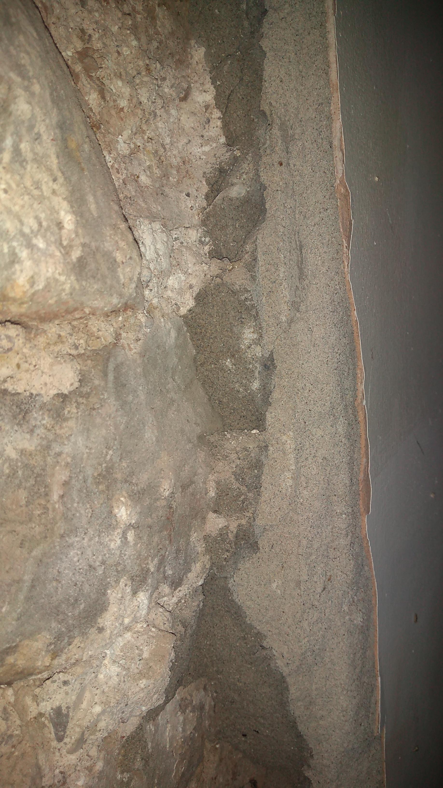

Thanks @markc Yep, I'm aware of asbestos and had a lot tested for it, but clued up might be pushing it! It seems there are two layers of the mortar, which shows up in the middle photo rather well cos of the flash. So I'm thinking it was base coat of mortar, second coat (scratch coat), followed by the plaster skim as you suggest. Sandblasting I think would be a bit on the heavy duty side and I'd prefer to DIY it if I can. Will look into compressor/needle gun. What about one of those wire brush things attached to a drill? Could that be effective or too abrasive? More generally, could removing it cause any problems? Sorry for the potentially stupid question, but could there be anything structural about it seeing as it is so thick? The floor joists go into that wall, and they're already undersized. Could removing it (will be doing the same in the room below) weaken the joists by removing an inch or two of support? Thanks a million.
Thanks for the quick reply. Tbh, I'm not certain. The thin front layer is pinkish, and the thick backing is grey. To my untrained eye is seems like sand/cement with thin plaster finish. There's no fibrous material and I wouldn't say it is lighter than it looks. The sack fulls I've been removing are plenty heavy enough We had quite a lot of things tested for asbestos when we moved in, but the walls weren't one of them. If memory serves, I think I looked into it at the time and was told it was not worth testing. I've adding some photos showing a close up of the plaster/ and sand/cement(?). I've done some with the flash on and some with it off. Thanks again
Hi all I'm making a start on removing the thick plaster, etc on the internal walls of the old part of my house. I can't be certain, but I think it would have been applied in the mid-1970s. It's really thick in places - up to 50mm/2 inches. I'm hoping to clean the stonework up afterwards and re-point (with lime) if needed. Prefer the natural look, and love the history of the place. Prefer a cold bedroom too before anyone mentions insulation ;) While working the hammer and chisel, questions have been coming up in my head... - I'm curious as to why the "scratch coat" (is that the right term?) would have been put on so thick? - Can anyone tell whether it is basic sand and cement or something else? - Might it have had some kind of damp proofing element? - Are there any downsides to removing it (I appreciate something will need to be done where the ceiling meets the wall)? - Any tips on how to clean up the front of the stonework easily? At the moment I'm just using a wire brush, but hoping for a less labour intensive and more effective solution! Any comments most appreciated. Cheers

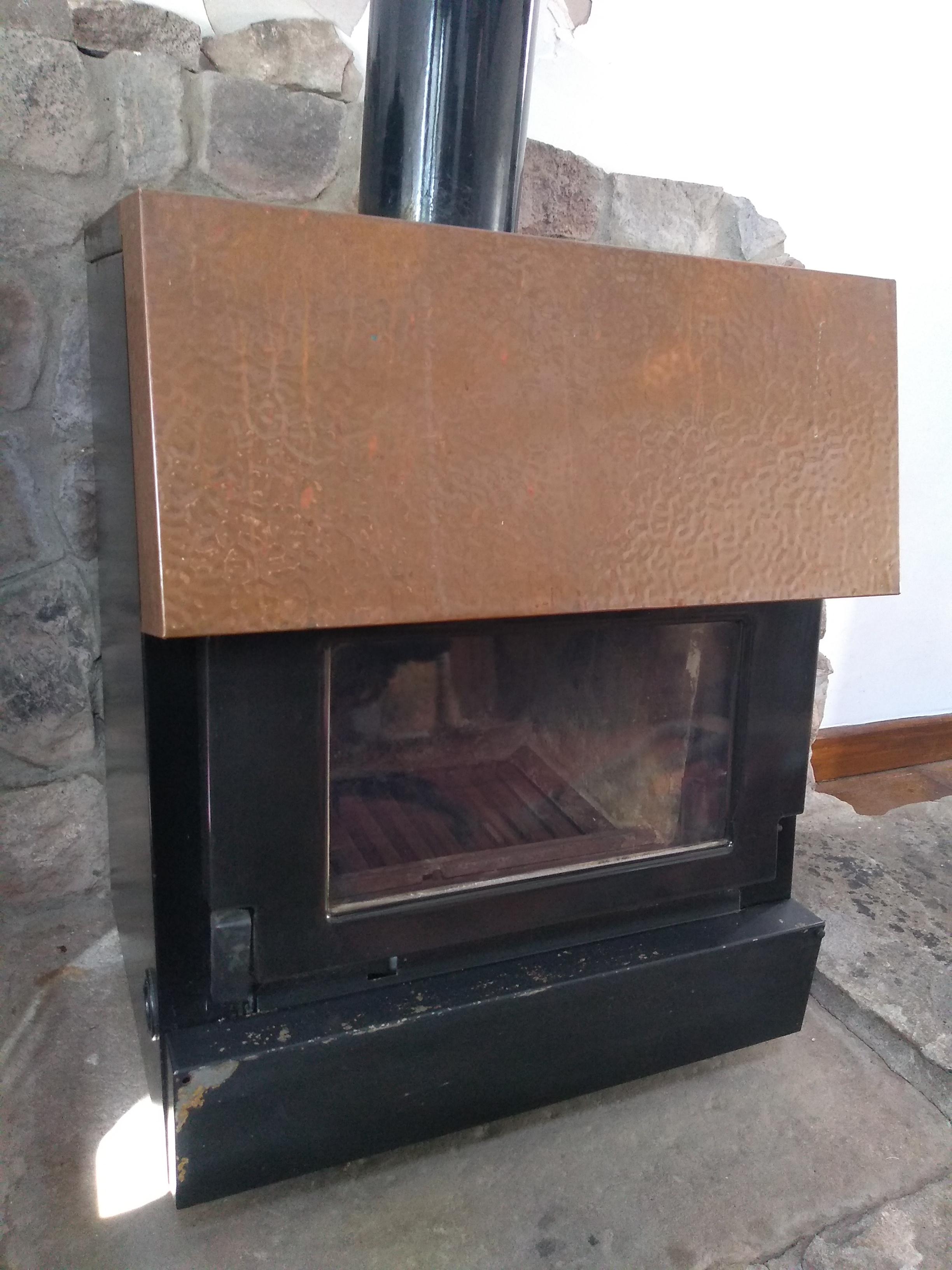

Hi all I'm removing this old stove from the house and would like to know a bit more about it. Has anyone seen one before? Anyone got any idea what model it is, or any other info about? I presume it's just a burner, but it does have a bit of what looks like gadgetry in the bottom section. So not sure if there's more to it... Photos below and more available. Many thanks
