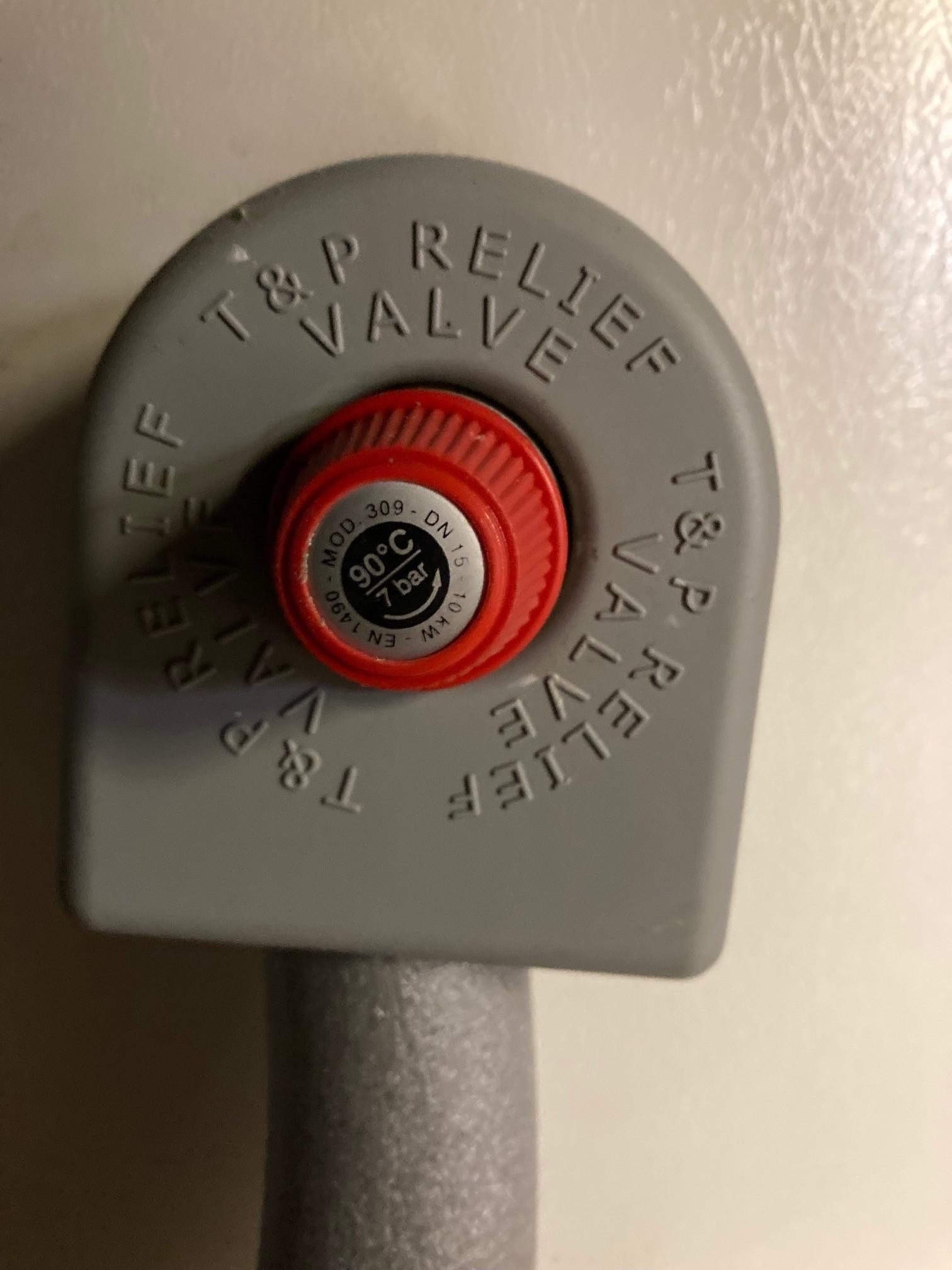

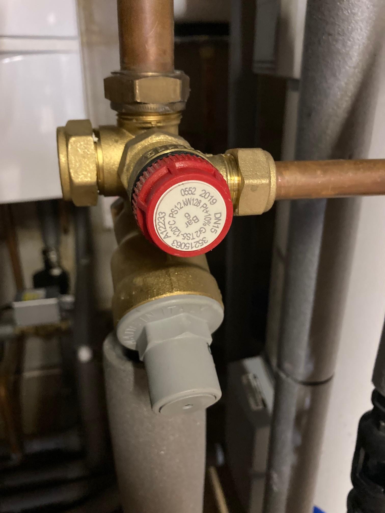

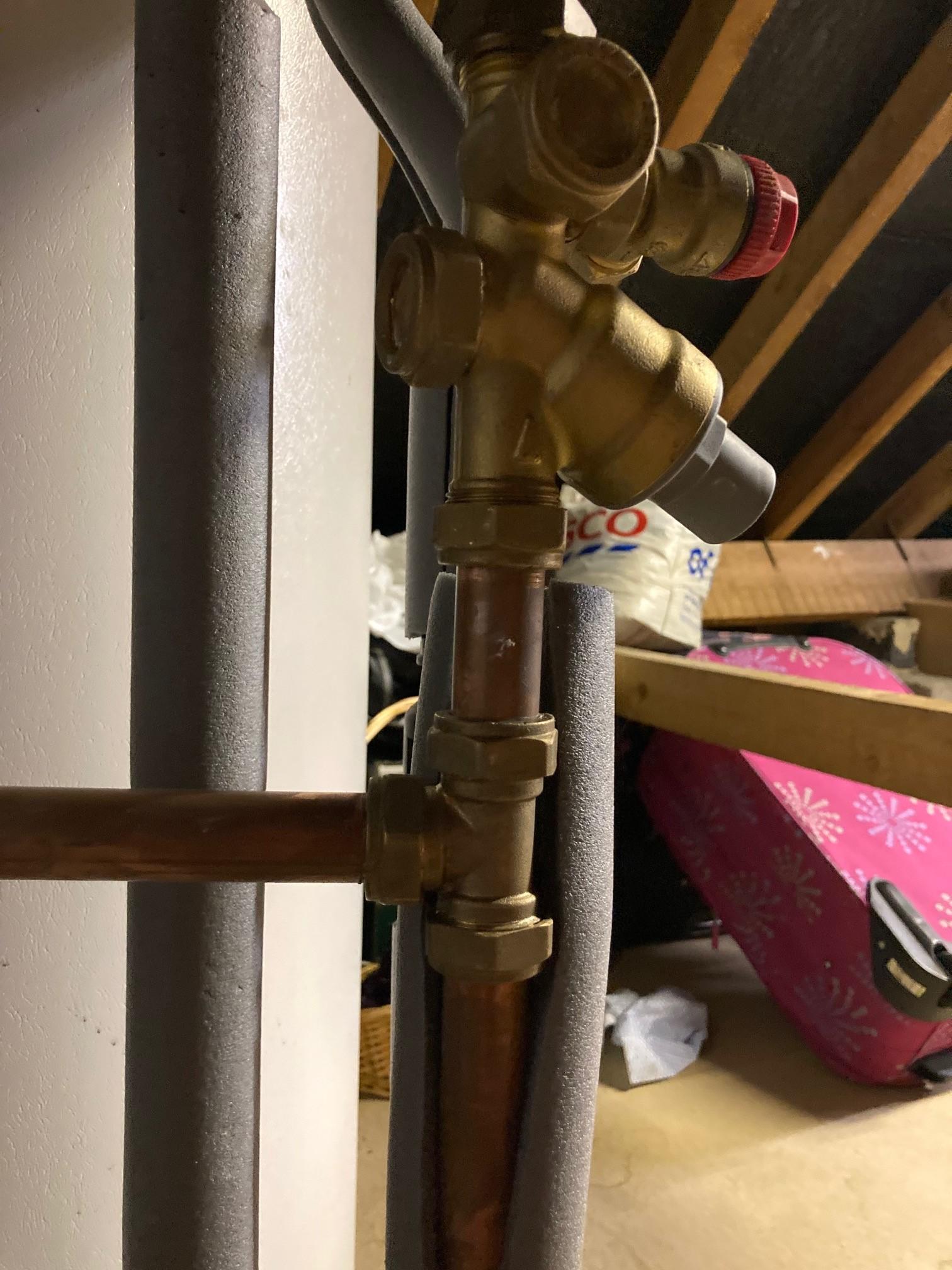

  1. For completeness... I've added some pictures of the replacement TRV which I believe is wrong spec... Was originally 10 bar; now 7. I guess arguably this makes the cylinder safer but must be a reason they use a 10 bar. In addition I've taken a photo of the take off for the 18L white expansion vessel which is just below the PRV. Also taken a picture of the replacement PRV which again i'm not convinced is correct specification.

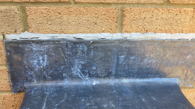

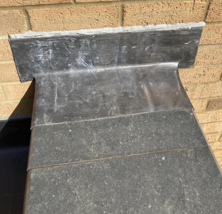

  15. Thanks... Like I say... otherwise a fairly neat job. Here is a picture showing the gaps a little better. If it is OK to squeeze some more sealant in the gaps without pulling it out then that should be easy enough.
  16. Noted. Thanks Mark.
