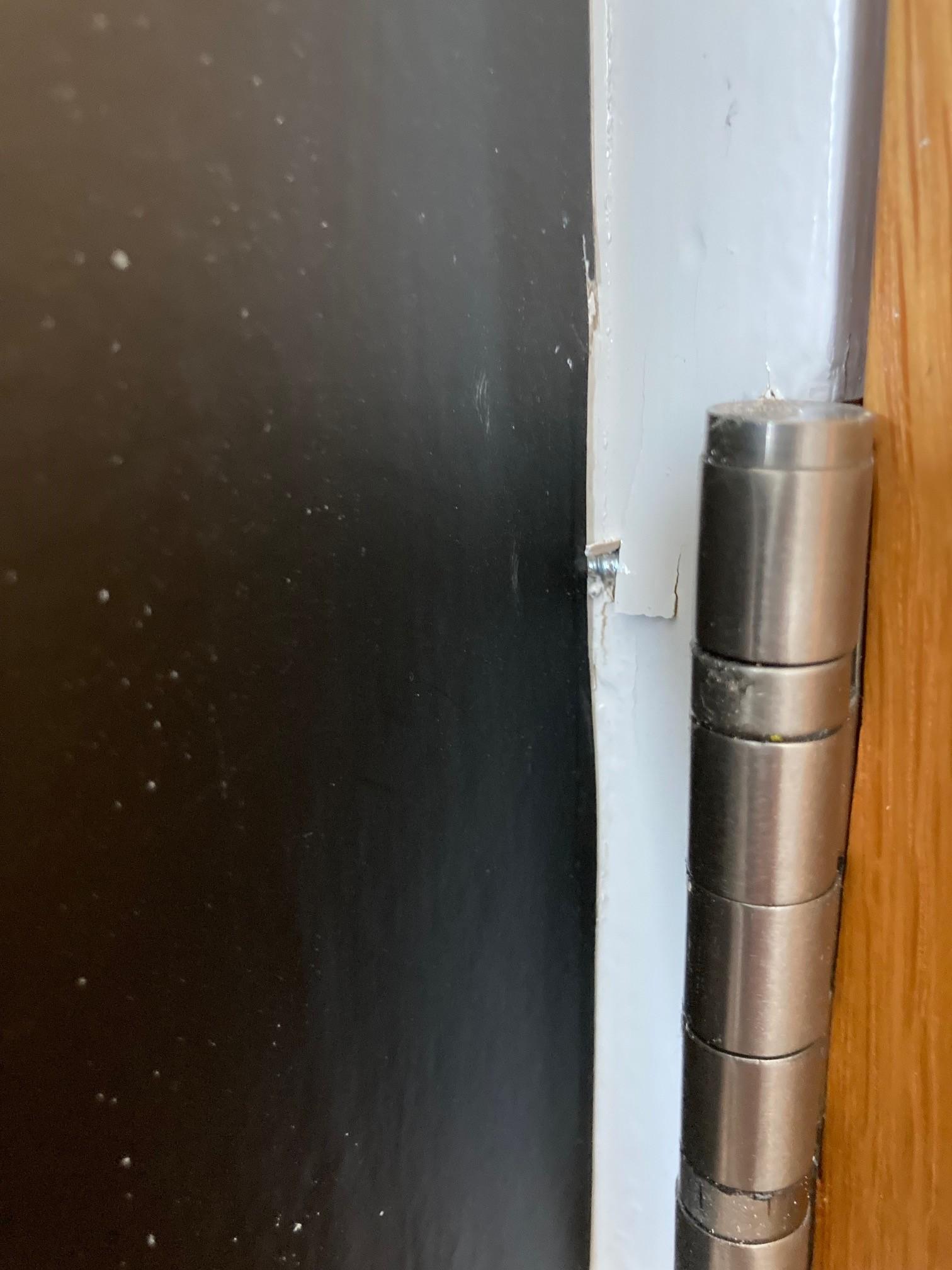

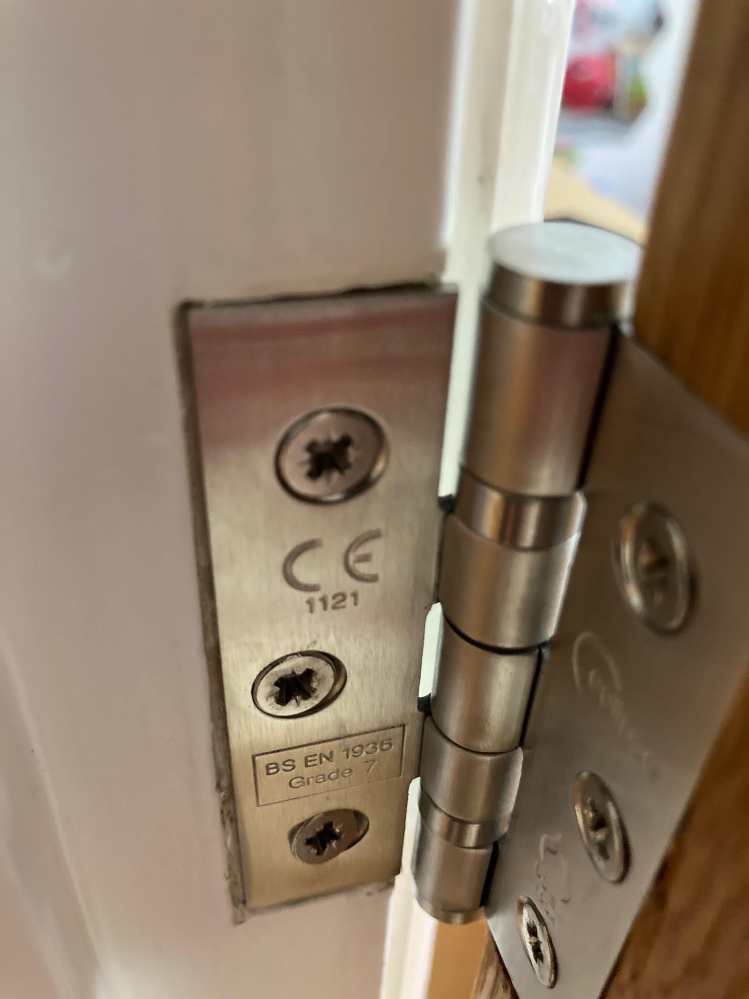

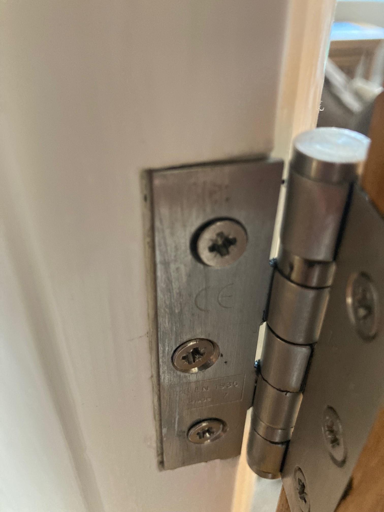

  14. Hi, I had a decorator do our hallway a couple of months back and unfortunately a lot of areas of caulking between the skirting and floor have cracked. There was caulking in place previously which had also cracked in a similar way. I understand there will be some movement / flex at play here. Is there a product / technique that can avoid this cracking? I am not minded to contact the decorator regarding this as frankly I wouldn't be using him again owing to the amount of paint splatter (tiny little dots of paint) I keep finding on the floor and having to painstakingly remove. Any tips greatly appreciated.

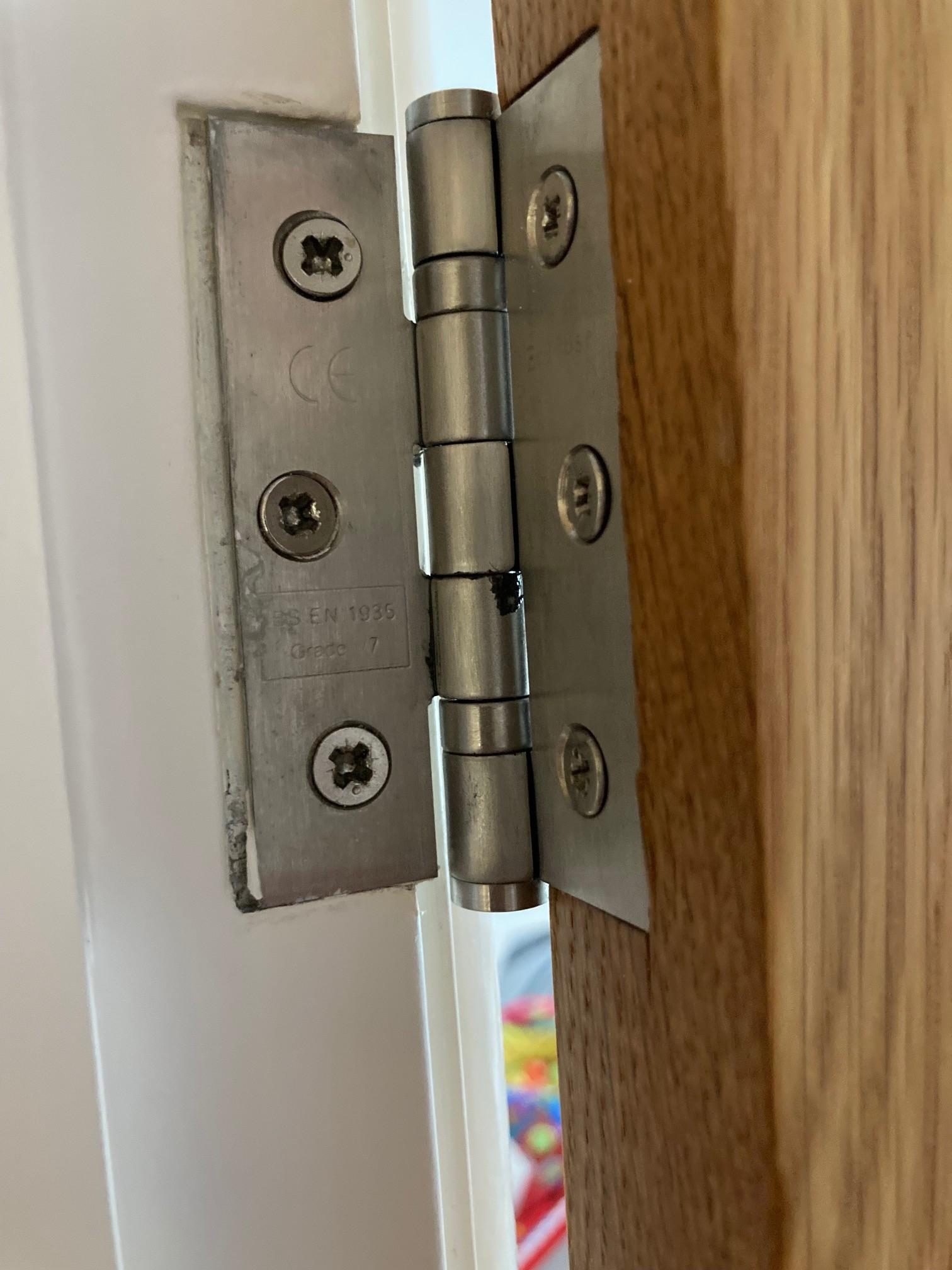

  16. These have only had a couple of coats of paint... These are new frames as part of the refurbishment 10-12 years ago... They just sit very tight. I suspect whoever hung them didn't follow your practice Joe.

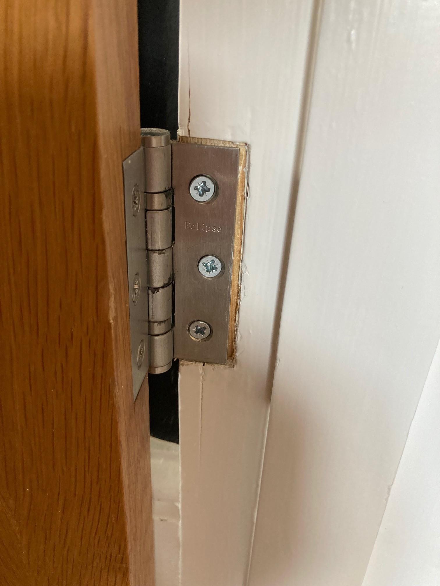

  17. That would be fine... I figured this is the way it should be done rather than drilling at angles to get some bite into fresh timber.
  18. These are original doors that needed adjustment. I take the point that the stops could do with moving. If that is the only option then I'll take the hit on decorating as and when.

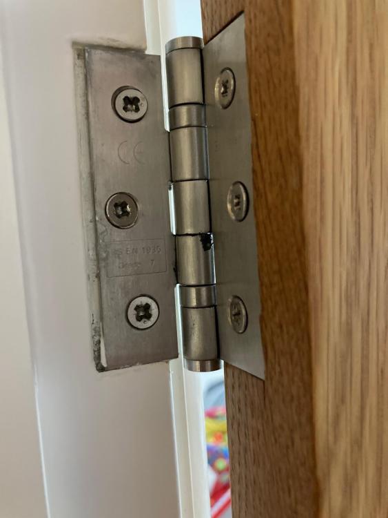

  21. Hi Folks, Coming back to an issue posted on an old thread I had a carpenter recommended to me and had them take look... They adjusted the hinge positioning to move the doors away from stops as they were rubbing / catching on the hinge side when closed. This has now been rectified but I am not convinced (I am a layman) of the method. The screws for the hinges are now at angles which I know will be to get bite into fresh timber. But is this the usual approach? Wouldn't one use dowels etc? On one door surround it has even caused the wood to split with the screw coming out of the timber.
