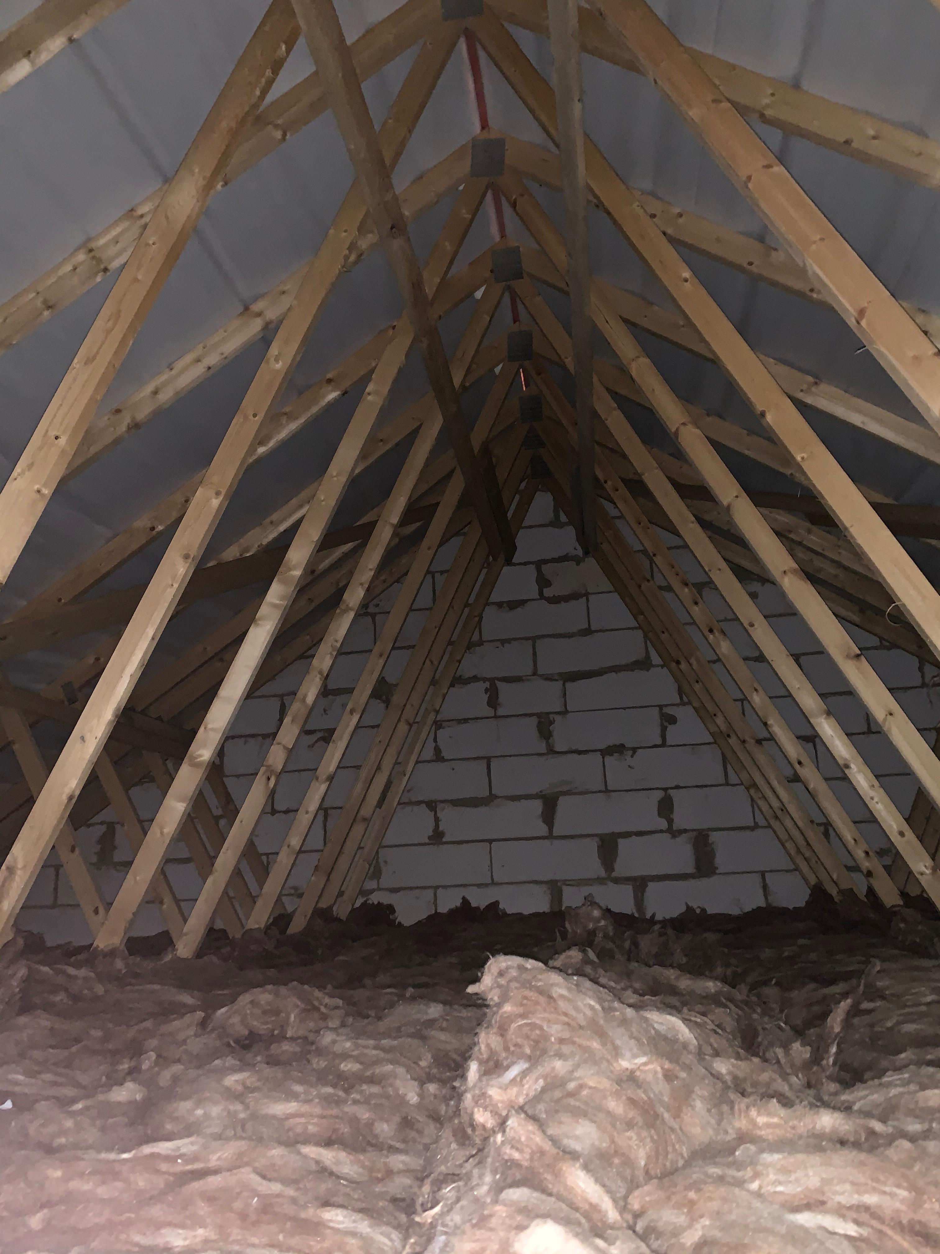

Before I start I’d like a little advice, going to help my sister board her loft out for extra storage space.Here is a picture of her loft I wonder if we could utilise the rafters running down each side by fixing runners to them at a height above insulation and span across and board out just supporting centre all the way down. I know there is those loft storage stilts,not sure how easy these are to use or if worth using any advice would be much appreciated. Regards. James
