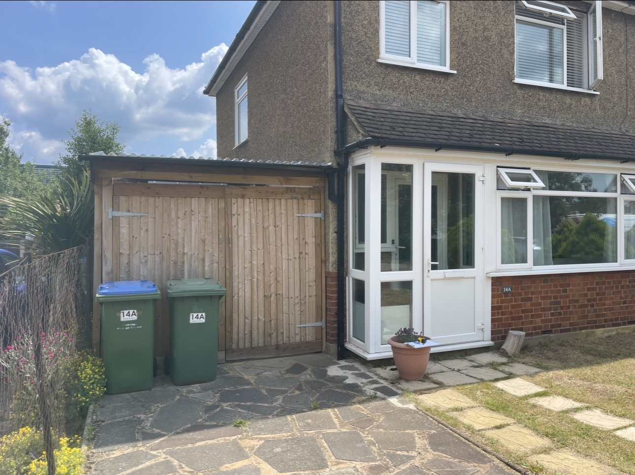

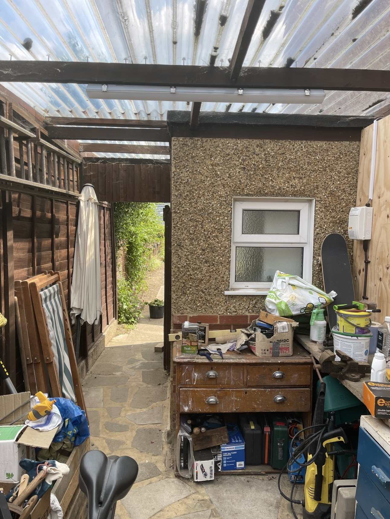

  1. @chriz1 Erect something like this either attached to the house (but open at the front and rear) or keep it detached from the house and enclose it.

  8. As the bottom of the opening will be above 1.7m, it doesn’t need to be fixed shut or obscured. And there should be no reason why the LPA cannot treat it as a NMA. I’d like to see their reasons for thinking otherwise.

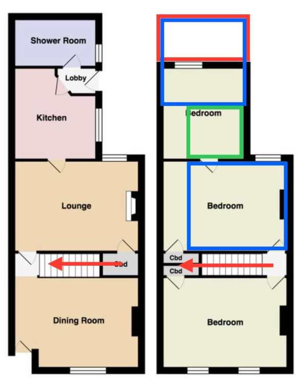

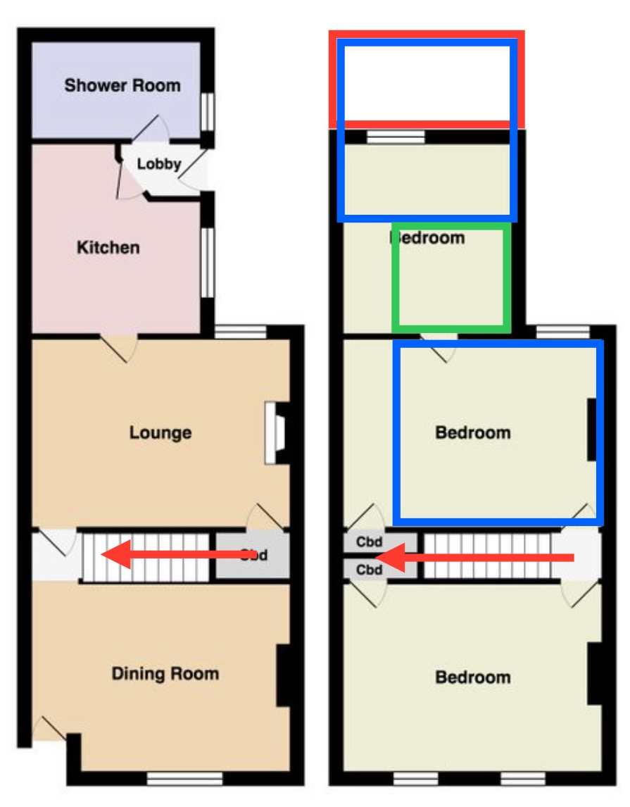

  10. @NFA Yomz With a loft conversion, you’d have to factor in the additional BR requirements, e.g. fire doors, sprinkler/mist system, etc… One of the Bedrooms would also need to reduce in depth to accommodate the new landing and stair. Assume you have the headroom for a loft conversion too?
  11. How about a first floor rear extension (shown in red). Turn the rear part of the first floor into a Bedroom with a rear window. Provide a Bathroom shown in green with a side window. Slightly reduce the middle Bedroom following the introduction of a corridor. Then you’d need to turn the stair around so the landing is against the party wall side.

  13. No such thing in Planning or Building Regulation terms. How are you going to explain this “temporary” building to Planning and Building Control when they carry out their visit and inspections for the main house? This could go massively against you and you don’t want to be on the back foot with the Council from the outset. But ultimately, it’s your choice.
  14. Both. Why are you not going to build to BR’s and/or how can you avoid it?
