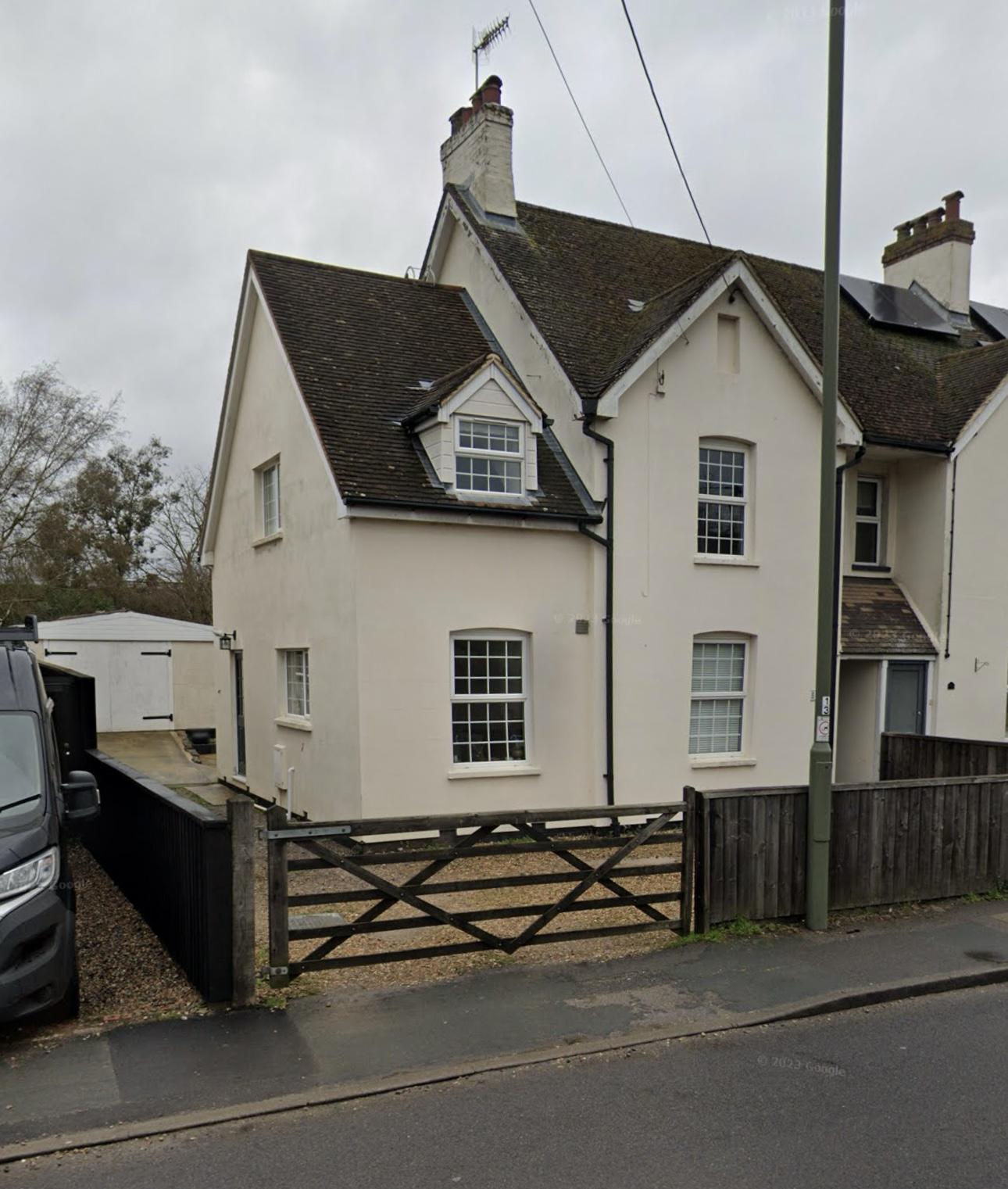

The proposals do look very imposing, especially the proposed two storey element in relation to the existing two storey element. It kind of gives off the look of a pair of semi’s. As a general rule of thumb, LPA’s support two storey side extensions which are half the width of the original. It’s all about keeping it sub-ordinate. You want 4m and they’ve asked for 2.5m. Why not meet half way? The roof could be lowered so the front window would be more like a dormer. The room it serves wouldn’t lose out too much. Those alternations alone should be welcomed. -
