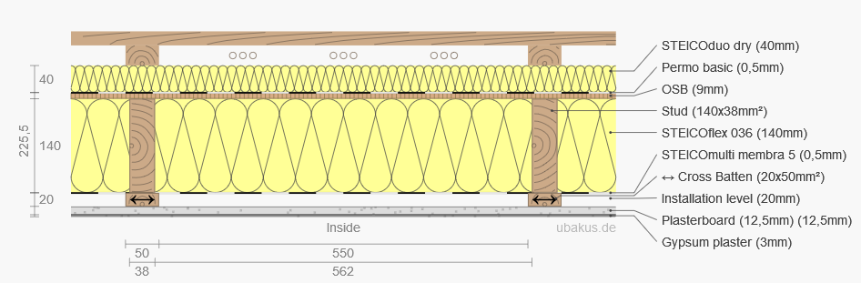

Yes screws into Studs. Makeup from outside to in Timber cladding Batten Counter Batten Insulation (60mm not 40 as below) breather membrane OSB3 Stud. Makeup diagram below, although the sizes and products are wrong, it gives you an idea. -
HI Guys, Im fitting 60mm steico woodfibre boards to the outside of the TF. These will be secured in place as per the manufactureres instructions with counter battens (38x50) and the cladding will go onto the horizontal batten also 38x50. Instructions say to use 6*180 screws, but im concerned these will lead to cold bridging? Although they will be buried in a batten and then covered with another batten. Would something like the following be suitable? https://www.aboutroofing.com/insulation-fixing-6-0mm-x-180mm-countersunk-pozi-woodscrews-box-of-100.html Thoughts? Paul

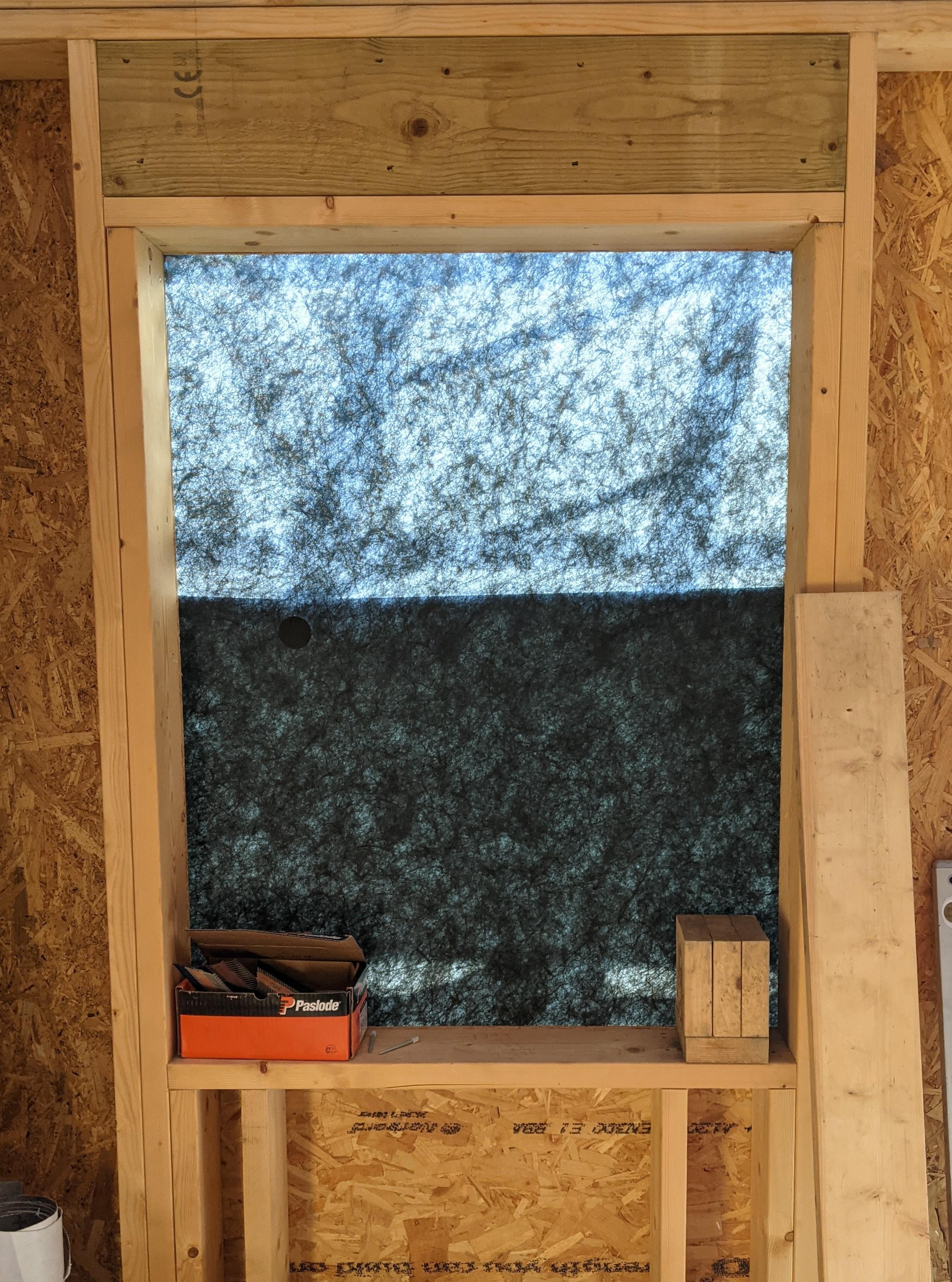

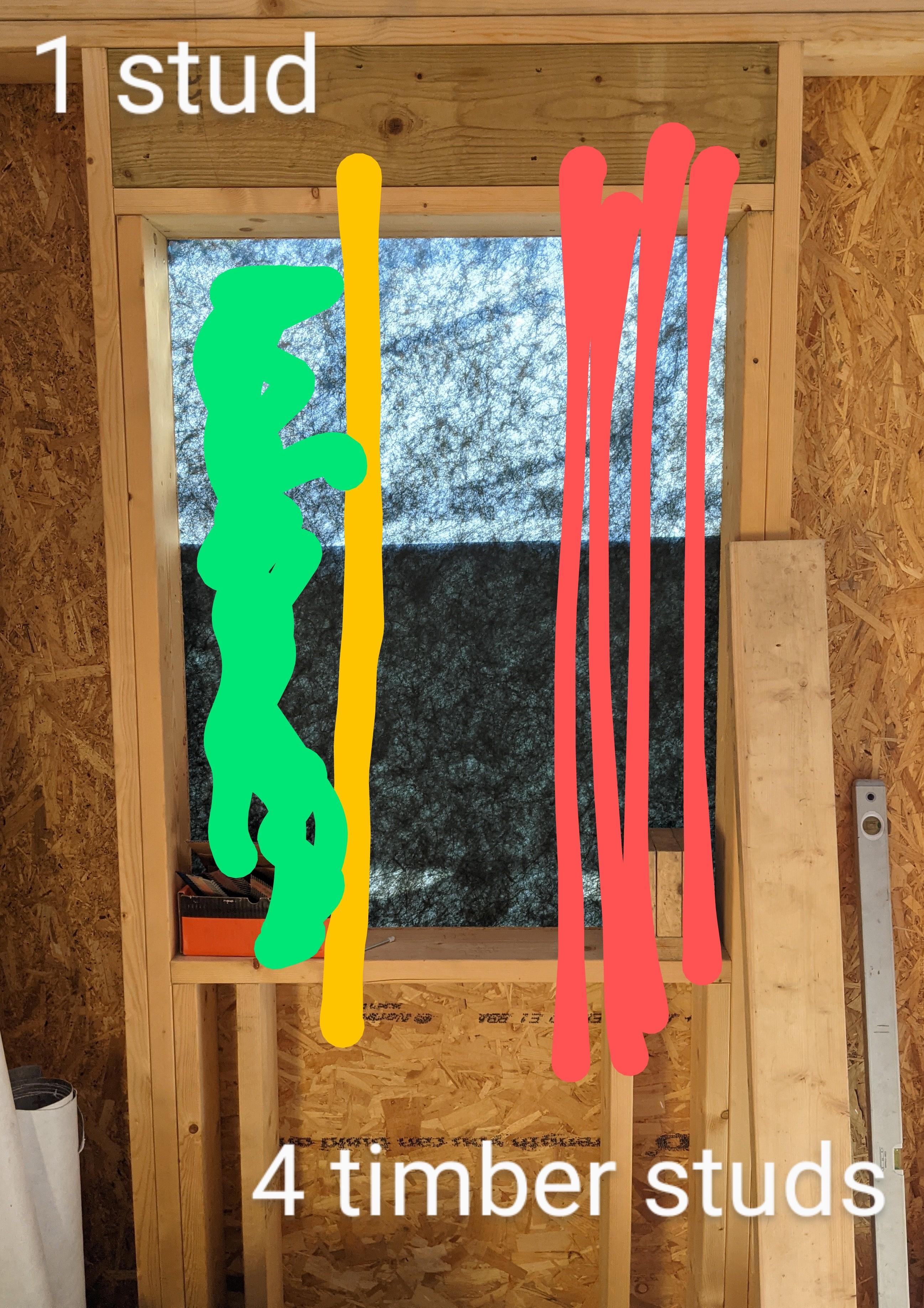

Cheers guys, yes we have been through quite a few quotes and this company has met all our requirements. I think one of the issues at the moment is they are all so busy, that customer service has gone out the window a bit, ive been into one local (well known) supplier 3 times and been told someone will ring you later today and not heard anything, its got to the point where I just want to order now and these guys can deliver. Plus the window next to it 2m away is 1200 wide and 2400 high so there no issue making this one a bit smaller ? The manufacturer has said the issue is with the opener, its only rated to 750, and they have had issues going bigger in the past, although the frame manufacturer says they can goto 800, which is a bit odd, but its not the end of the world, I just want the windows on site now ? The windows are aluminium, using the flush Altitherm 800 profile and double glazed. Ive got another thread on this forum about installing them (had no response to that so I presume im on track.), if anyone knows of any well priced aluminium flush windows who its worth getting a quote from, drop me a DM. I will go with the 1 stud as suggested. Will be ordering this week. -
To be able to fit an egress window our supplier can only go upto 750 width, so I need to make the 900 aperture in our timber frame smaller. The quickest way to do this is just put in 4 stud (140*40) timbers 2 on either side of the opening. But I was wondering would it be better to put in one stud 750 mm from one edge and create a little void filled with insulation? Obviously we will also put osb3 and membrane on the outside.

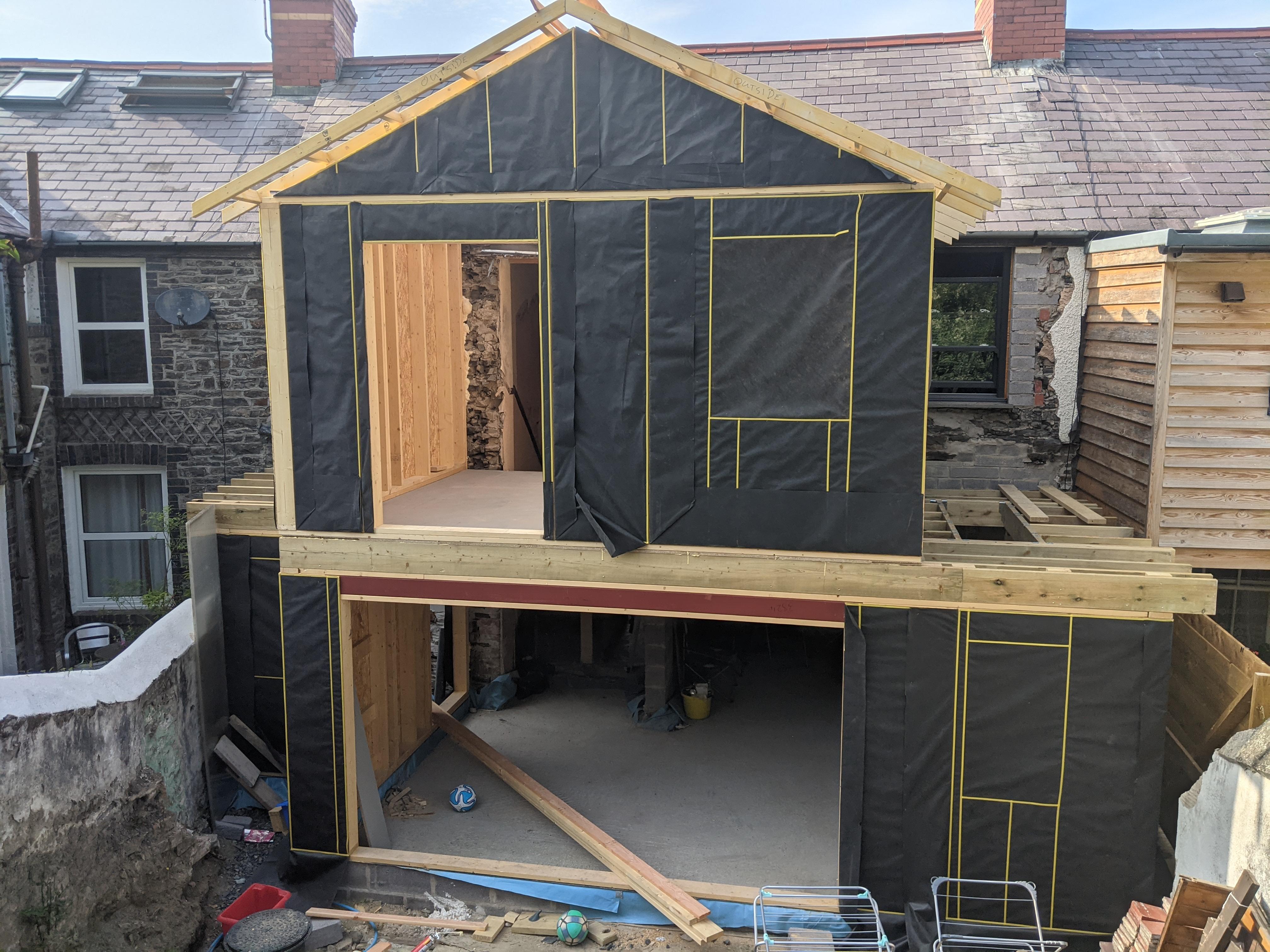

HI, We have just had our timber frame kit erected after a very very long and stressful wait. Although this is only the start of the project really. The kit turned up on a lorry and has been erected. it is literally just the kit with 140mm stud, 10mm osb and a black breather membrane on the outside. See photos. I have A LOT of questions about timber frames but thats for another thread. My original plan was to insulate the panels with sheepswool/thermafleece, and then across the inside of the walls with a batten and more wool. On the outside its batten and counter batten on top of the breather and then vertical timber cladding. But I wonderred if there is a product that I could potentially put on the outside of the breather membrane too, maybe a wood fibre board like pavtex so I could eliminate all cold spots/bridges and protect the inside from the hot southerly sun. Maybe sometihng that I could place either between the battens, or instead of the battens and then fix the counter battens above the insulation. Ive heard of insulation on the outside, but from the research I have done this is always against the OSB and then the breather membrane on the outside. I dont really want to risk taking off/damaging whats there. Hope that makes sense. Paul

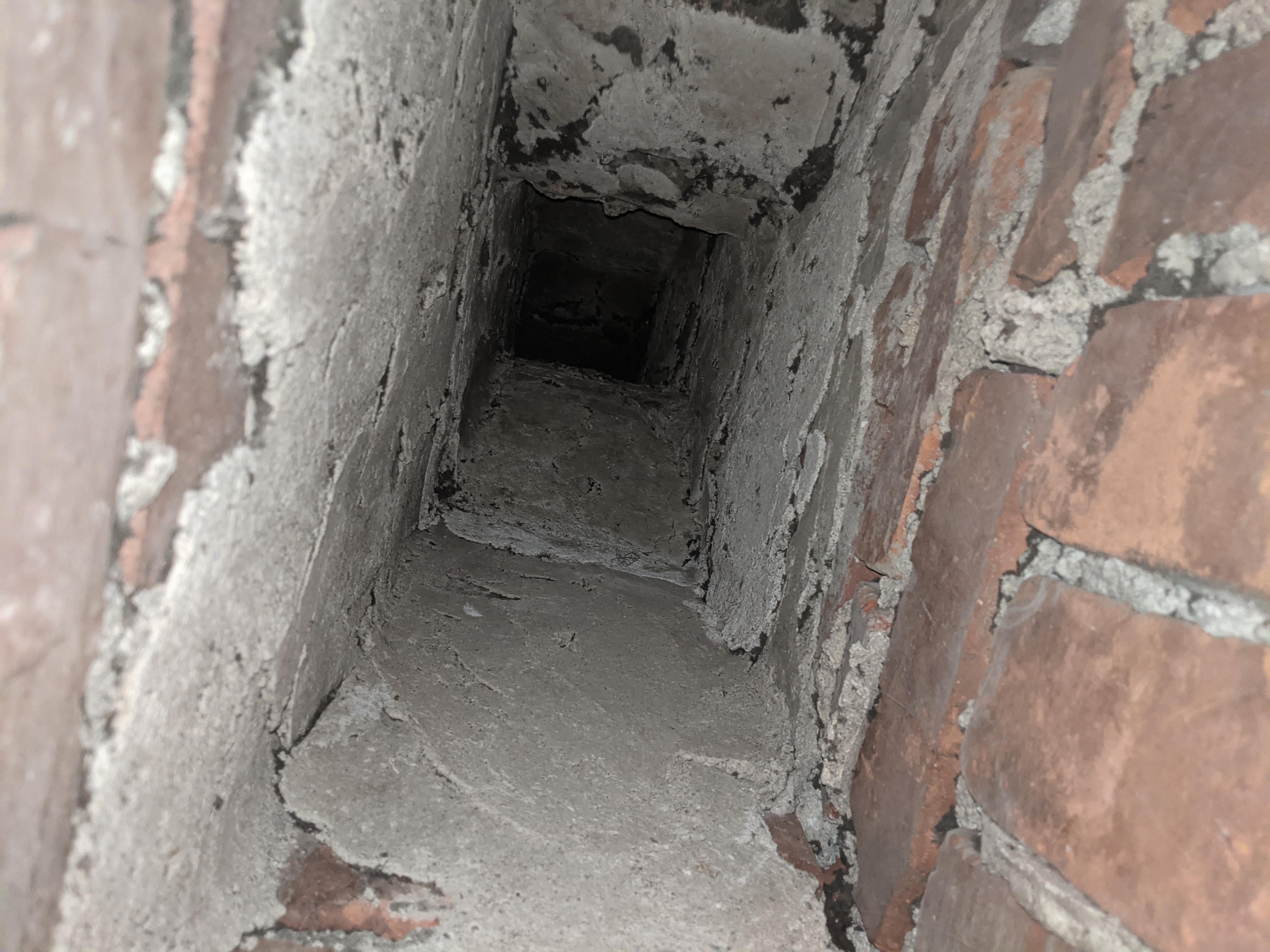

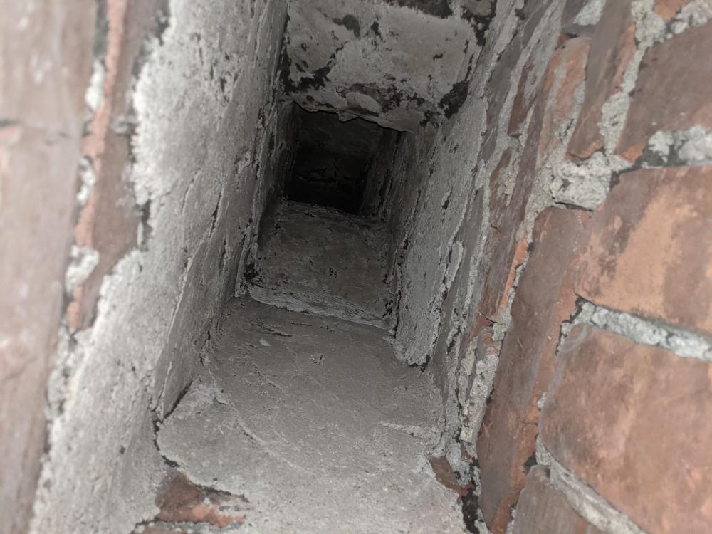

Indeed, there is a bit of soot in it, but not a lot. Its in what is now the upstairs bathroom, but in the past must have been a bedroom. When I pulled up the flooring the original tiles were still there too, they were very basic though. Interesting, I have been wondering about using the Chimney flues to run the pipework through but not sure if its viable. Not sure I trust they are air tight enough all round to just use room ducts. I did wonder if I could use them for the incoming and outgoing air sources for a mvhr though. At the moment all our quotes are coming in at around 6k for MVHR and with such an old and draughty house its not worth it, but I think it will be in the future as we slowly seal everything up. But nows the time to run in the ducting and no one seems interested in a two stage approach. Its just one of many nightmares I have going on at the moment where im not sure what to do and where to spend the money ? Thanks for al the tips/advice guys. I might try photographing all the chimney flues eventually (we have 8). Paul

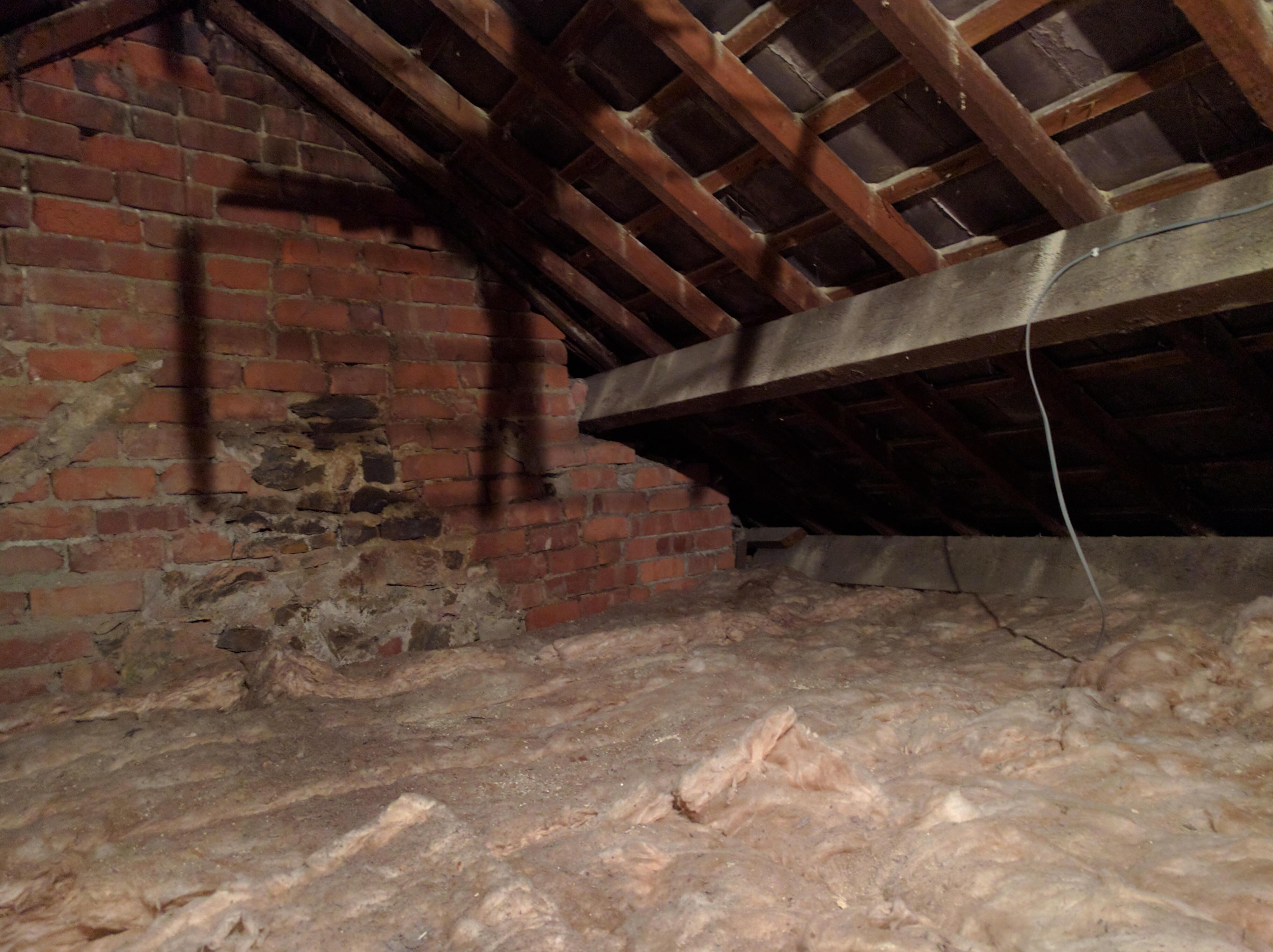

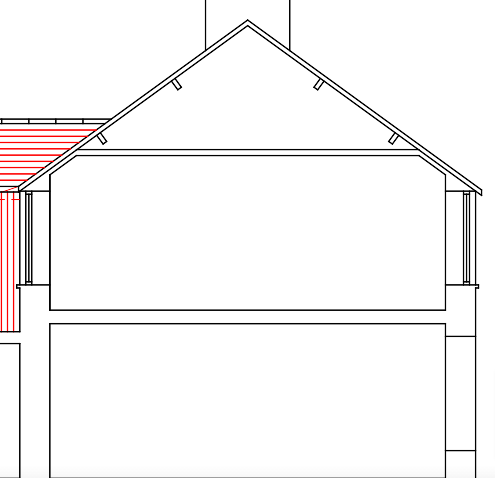

Hi Temp, Sorry for taking so long to come back to you and for the detailed answer. Yes I think we will need to cut the purlin to do the work and It was around this and supporting the new floor where my concerns were. Im trying to get a feel for what work would be required if we do this before I speak to a SE. I dont want to shell out hundreds just to find out its impossible or way out of realistic budget, but it might be the only way forward. Thanks again, all the other points I had already considered and we think its a possible go, but I want to find out more before pulling the trigger ? Paul -

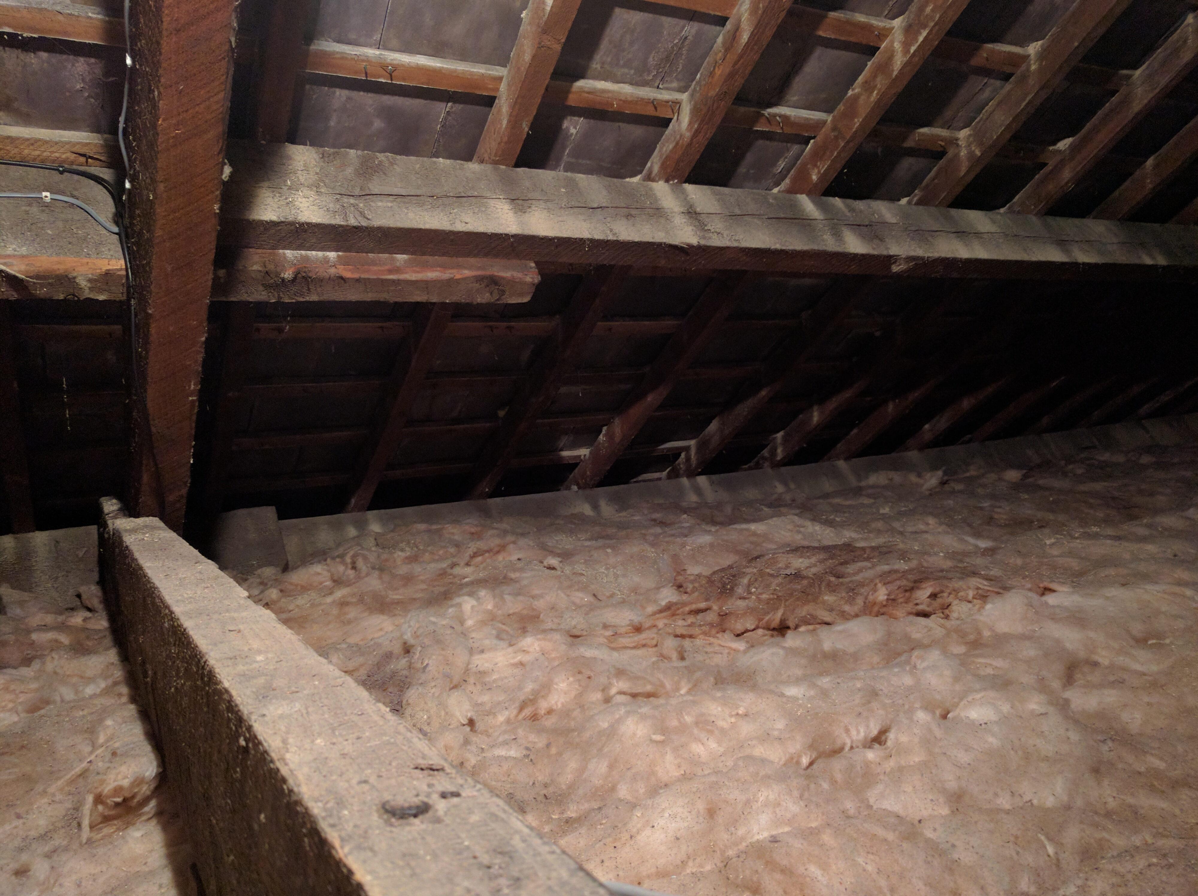

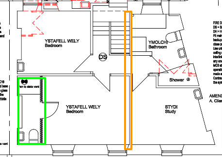

Hello, as part of ongoing extension/refurbishment of the house, we are considering opening up the bedroom ceiling into the loft and having a mezzanine style opening level above an ensuite at the end of the bedroom. We would then look at putting in one of those velux rooflight balconies. However this is still very much at the planning stage, and before we get as far as paying for structural engineers etc, I would like to get an idea of the type of works that might be required and if our roof lends itself to this type of work without a lot of alteration. The house is a 1907 Edwardian terrace, There are 4 wooden beams running the length of the roof, which hold up the rafters. The roof does appear in the bedroom below, so I know the 'floor' of the mezzanine would be lower than the existing ceiling. The wooden beams run from a brick wall at either end and are supported about a third of the way across with an a frame of sorts. This would not be in the area we would open up, it appears to be over the wall between the two front bedrooms. As always a picture is better than words so I have added some photos to explain. Mezzanine area marked with green box, A frame marked in orange. This is just to get an idea of feasability at this stage so any and all opinions excepted.
Thanks Tony thats interesting, when you say you insulate them, is that internally inside the chimney or just on the breast walls in the rooms? I was wondering exactly the same thing, if we put an elephants foot on the top to stop water getting in but its still able to breathe, but then seal them up at teh room level there is still space for the moisture to evaporate if any ever got in. I like the idea of venting into the loft space. I did also wonder if you could vent your MVHR out through a chimney, if we install on its going to go into the old fireplace in the utility room anyway. Not sure if thats been done or not.

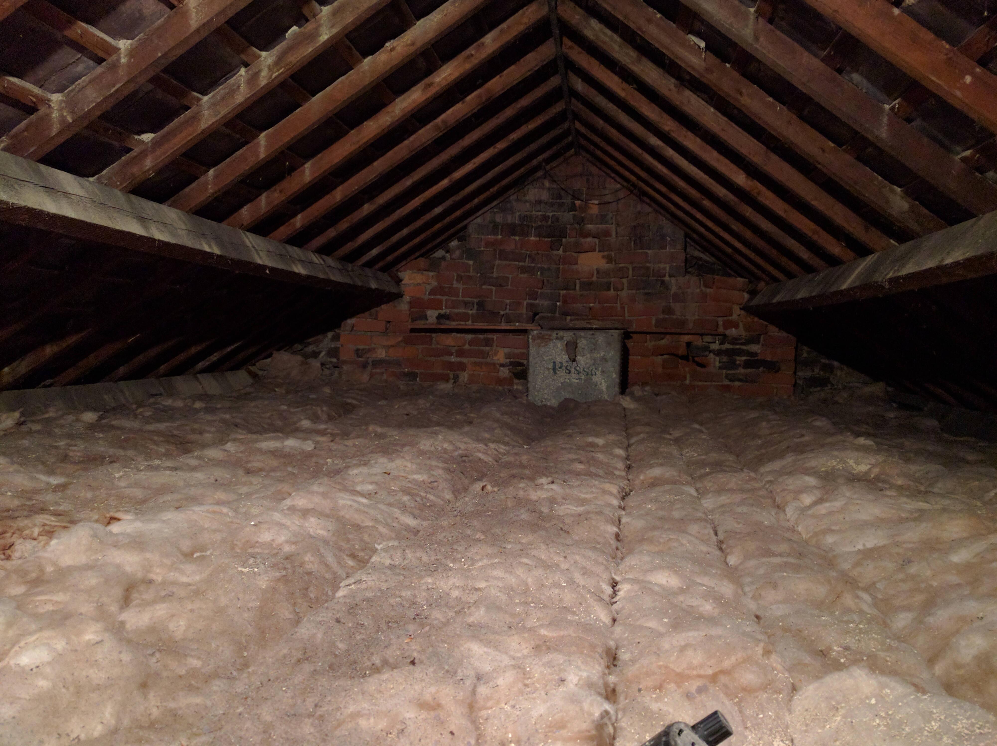

We are renovating and extending our Edwardian terrace which has 8 chimneys, 4 on either side. Pretty much every room has either a fireplace, or an air brick and two are completely blocked up (which is a bit worrying). We are looking at installing an MVHR unit, but I cant reconcile this with the need to let the chimneys breath or at least have airflow. Im sure we are not the first people to look at making an old property watertight and what damage maybe done to chimneys if we cap them, and if we do at which end? The extension is a timber frame and airtight structure, and as we are working through the house we are slowly incorporating a much more airtight structure to the property, with decent fitting doors/windows etc. Internal insulation and externally the stone walls will be repointed with lime to let them breathe outwards. Has anyone come across anyone who has capped chimneys or sealed them up and has some years under the belt with no damage inside the chimneys? Im sure blocking them at both ends could cause damp/condensation with temperature fluctuations. Many thanks for reading. Paul
