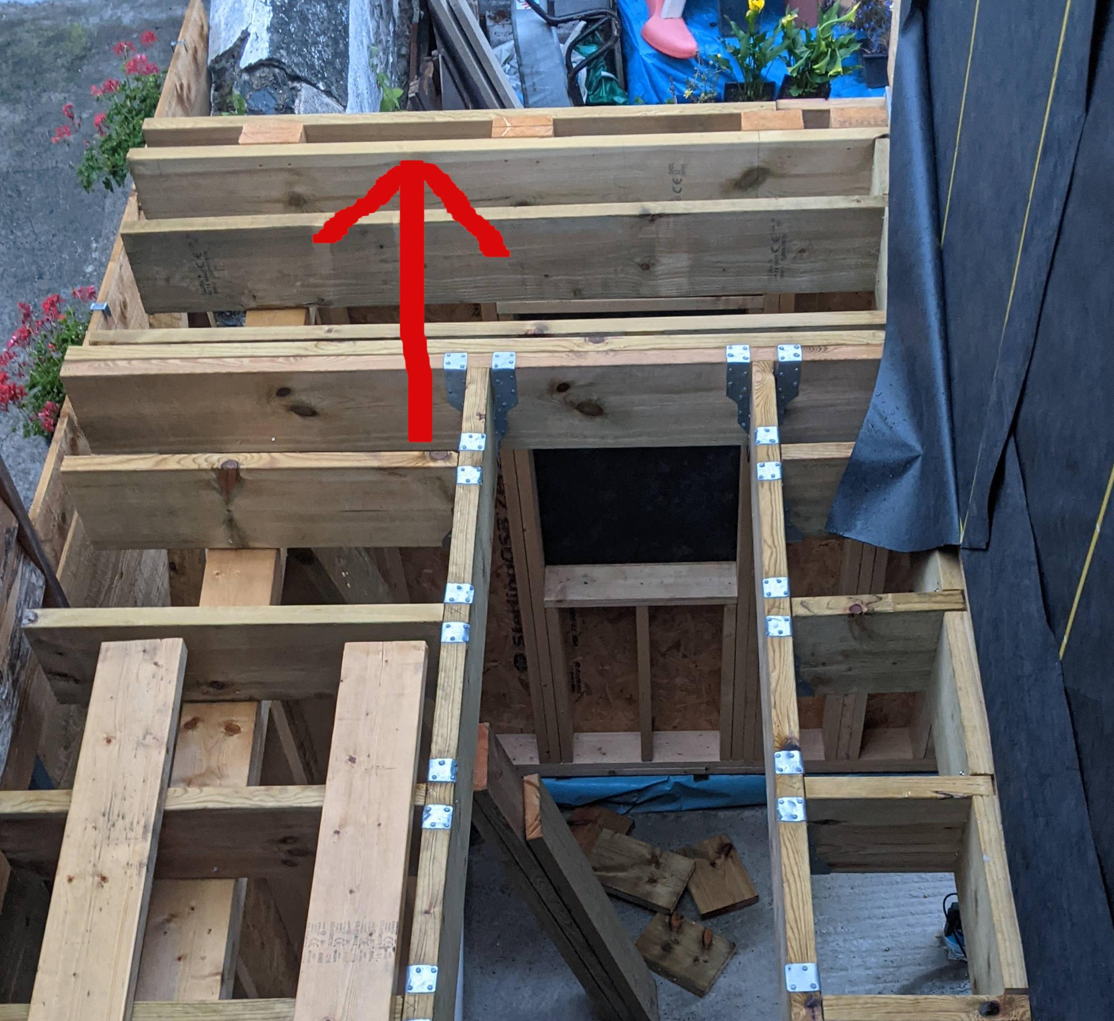

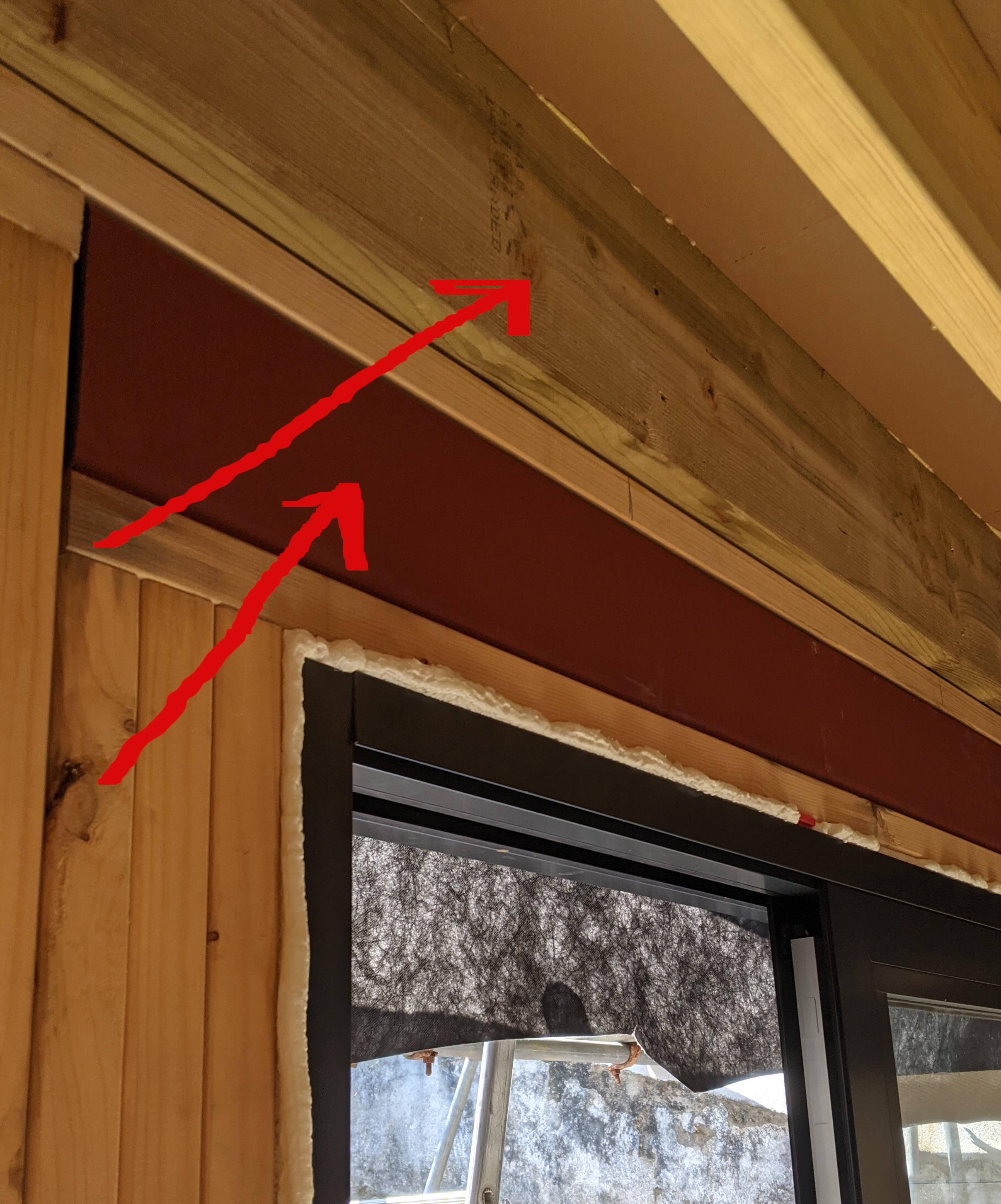

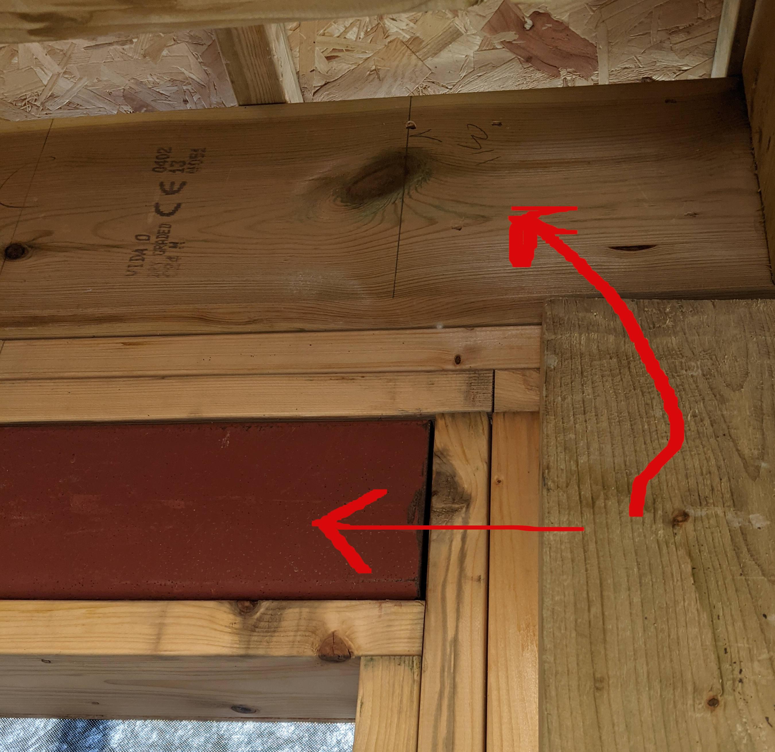

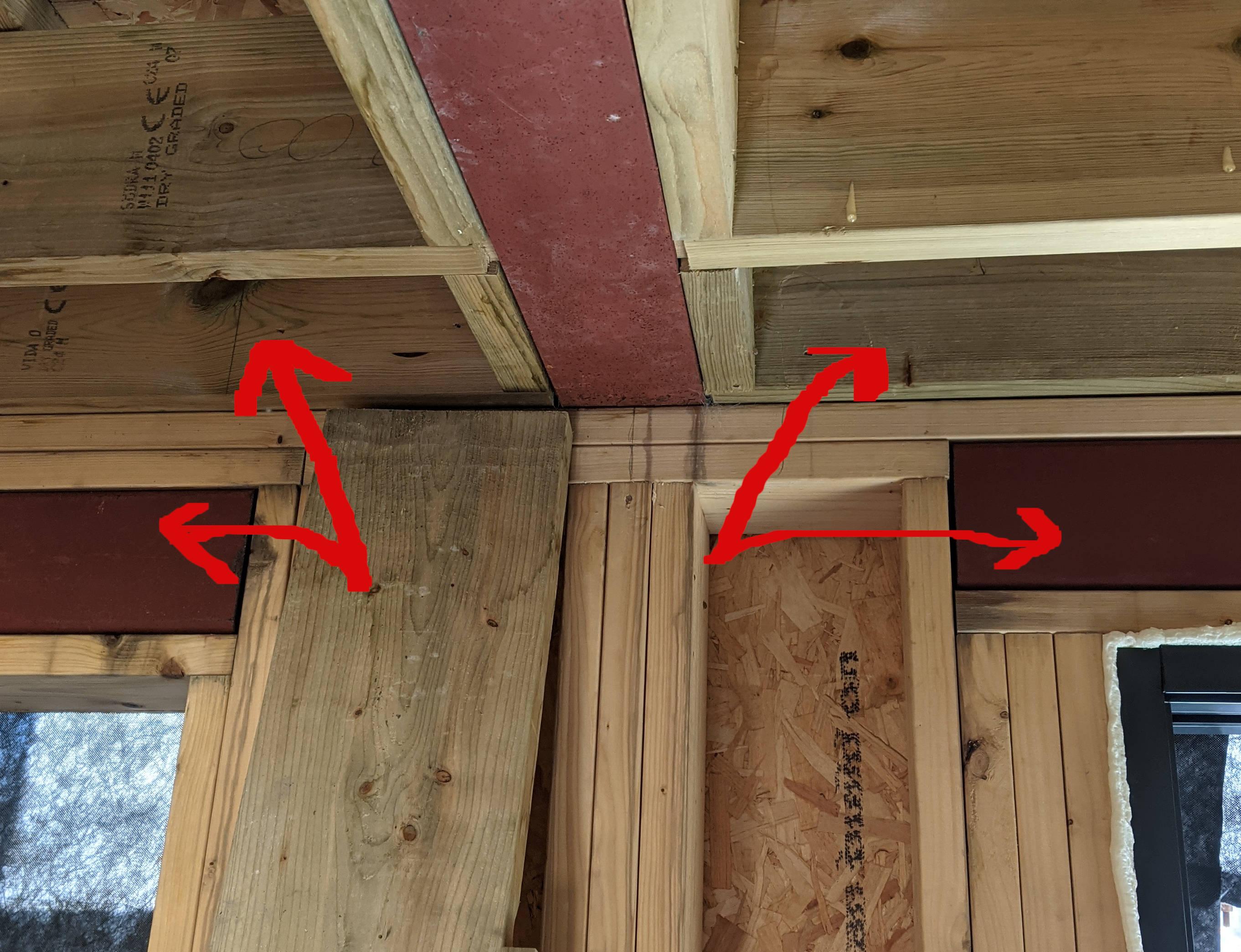

unforseen cavities/cold bridges in timber frame help
hotnuts21 replied to hotnuts21's topic in Heat Insulation
I think, and I need to research this more, there is some tape that I can put on the bottom of the joists, I can then run the VB up the wall and along the bottom of the joists sticking to this double sided tape, when I install the plasterboard it screws through the tape/vb and self seals the hole, but I need to look into it more, as its only a small area, it means I could also run it up into the skylight well too which is pretty big on a warm roof! -
Yep the flat roof has Alutrix600 vapour barrier on the deck, its the bit between the bottom of the joists and the bottom of the deck I was never sure about, whether we cut it round the joists and tape it to the desk of the flat roof. (warm roof buildup on top of the joists). Sounds like I might be onto something -
HI AliG, yes that was my worry with the Steel and one of the main reasons I posted on here. I did wonder if just putting insulation on the inside of the timber upto the flat roof would suffice, especially as i have some left over 150mm celotex. I can bring this right down to ceiling and seal all around it with illbruck FM330 air seal foam, I could also run the vapour barrier across the bottom of the joists as well as up the walls. I may well have to loose some space inside the room and insulate on the inside of those beams, we are using sheeps wool elsewhere so might use 50mm thick of that in a plasterboard box along the beam, else i may end up with cold spots on the walls. Its all more work and cost 😞 -
This may be a silly question but is there a particular expanding foam I should use? One that maybe has better insulation values or expands a lot to ensure I fill the entire length of the beams? -
As they say a picture tells a thousand words, so I have attached some photos. I was scrolling through some pics of my warm flat roof build and realised that the end of the building has two uprights timbers which are effectively a cavity now as they are blocked from inside/outside and now the top. Im wondering if I should drill a hole one of these timbers and fill it with expanding foam?? Although they are in line with the roof/floor joist timbers, they will I presume cause a bit of an effect to the heat loss of the building? Also above all the doors and windows the erectors uses square metal box section for the lintels instead of timbers (Prob cheaper at the time) and so therefore again another cause for panic for heat loss and cold bridging. The outside of the TF shell is getting a 60mm thick woodfibre insulation, and I could insulate with PIR the inside of the timber headers (if thats what they are called) but I cant insulate the steel lintels on the inside as thats the plasterboard level. Could I also drill small holes along the steel and fill with expanding foam too? Thoughts?

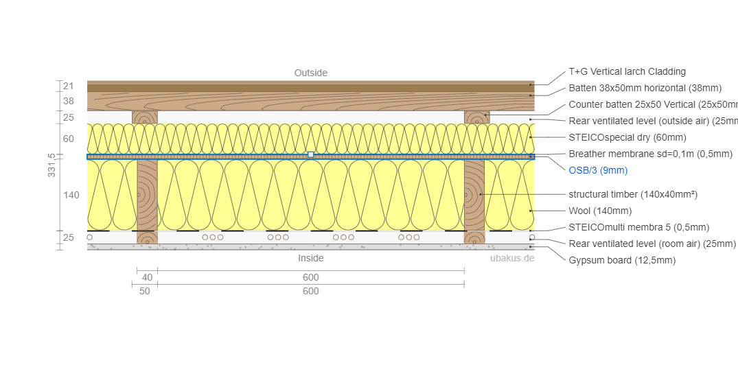

Yes, as above you need an OSB or similar racking board. In these types of makes up it typically goes on the inside as per mike wye. However it is breathable (although the least breathable of everything in the build up). We decided to add the external wood fibre board as an after thought, so the timber frame was already up and traditional with it on the outside. It is the point of failure/most likely to get damp/moist, but I spoke to Steico technical support and quite a few others all of who said it was fine to do it the way I did the risk was the condensation analysis, but providing we put a good Vapour barrier on the inside of the wall, it will be fine. Which kinda blows my mind because im using OSB for my flat roofs!! -
