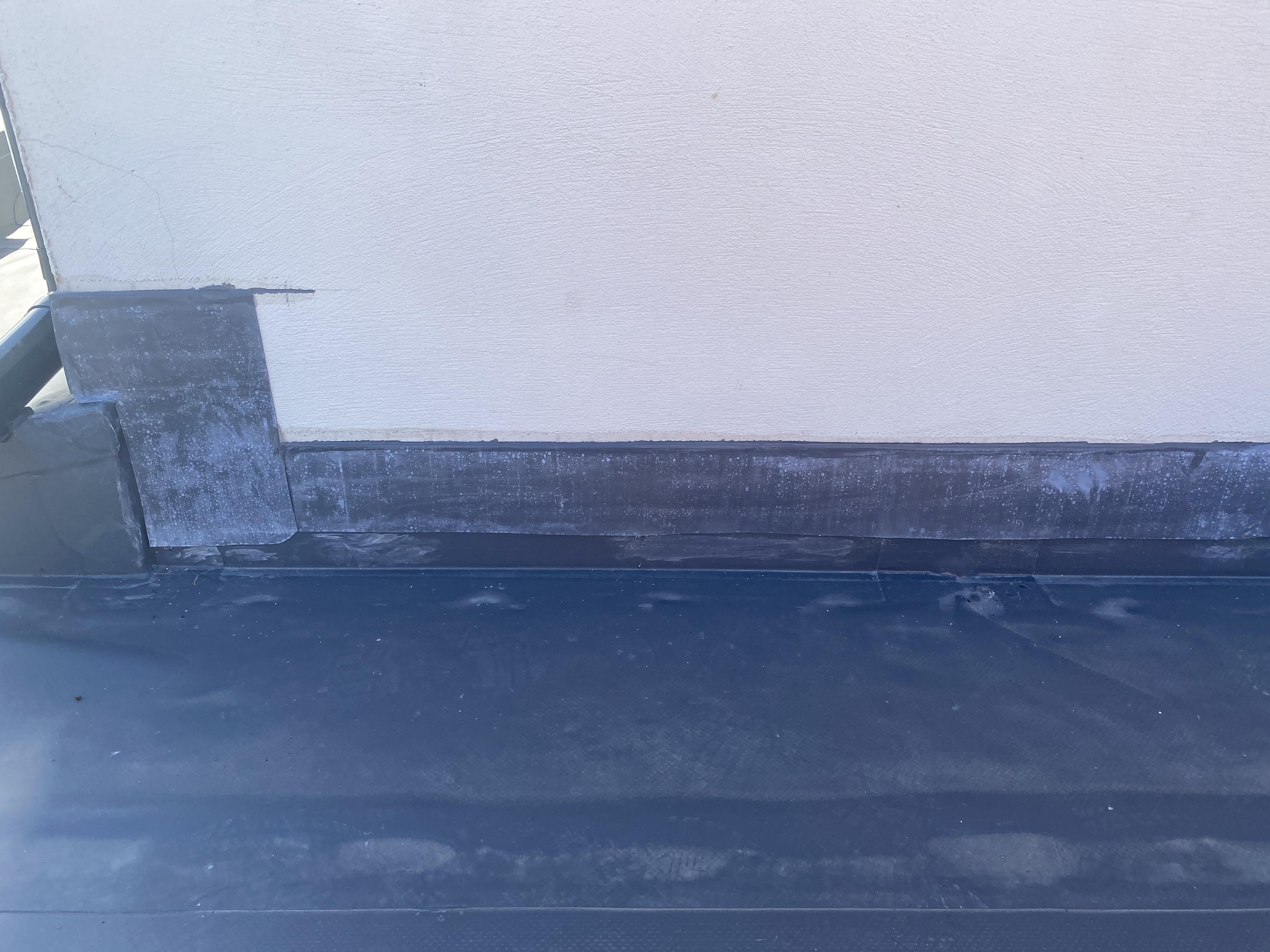

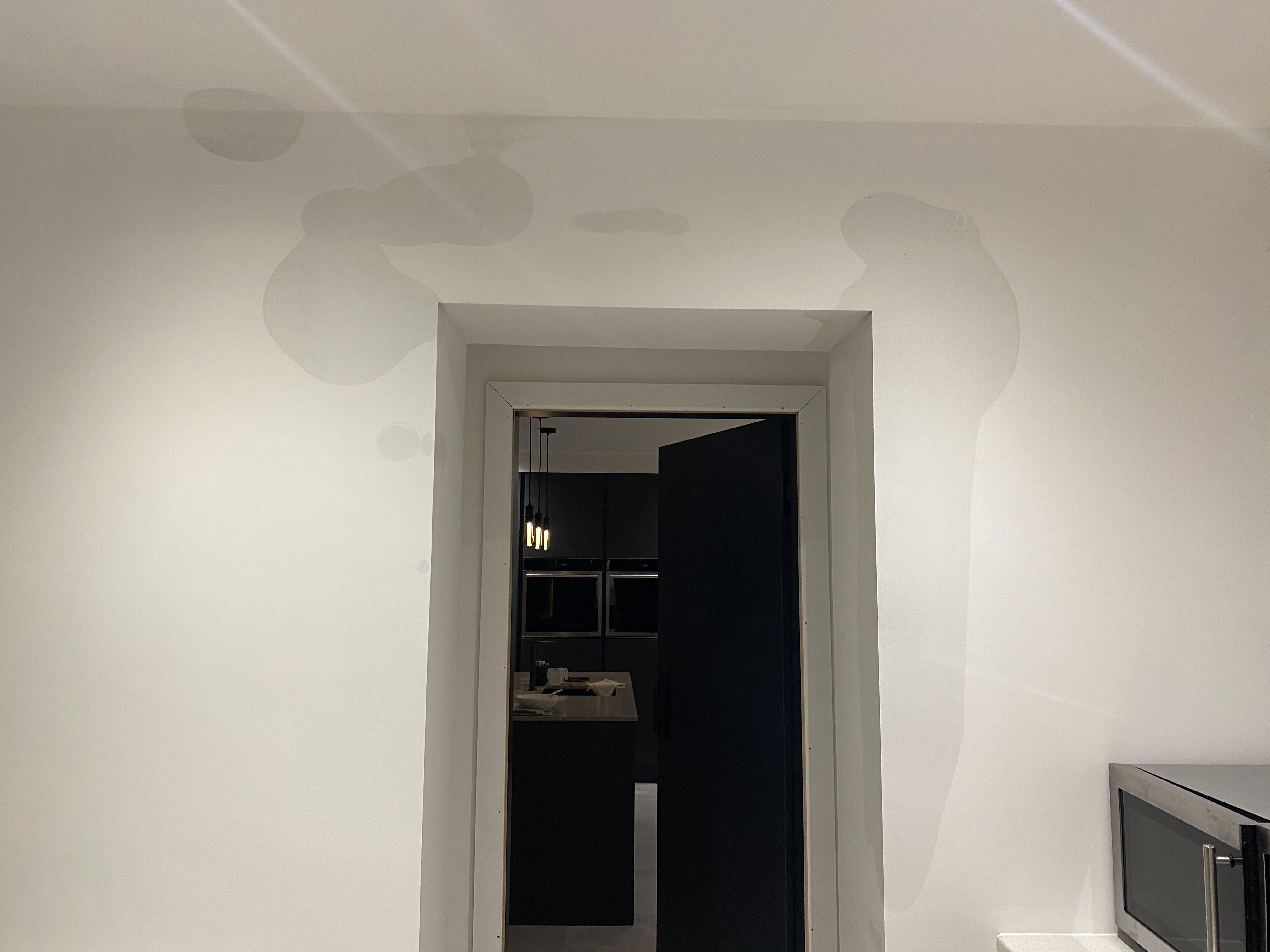

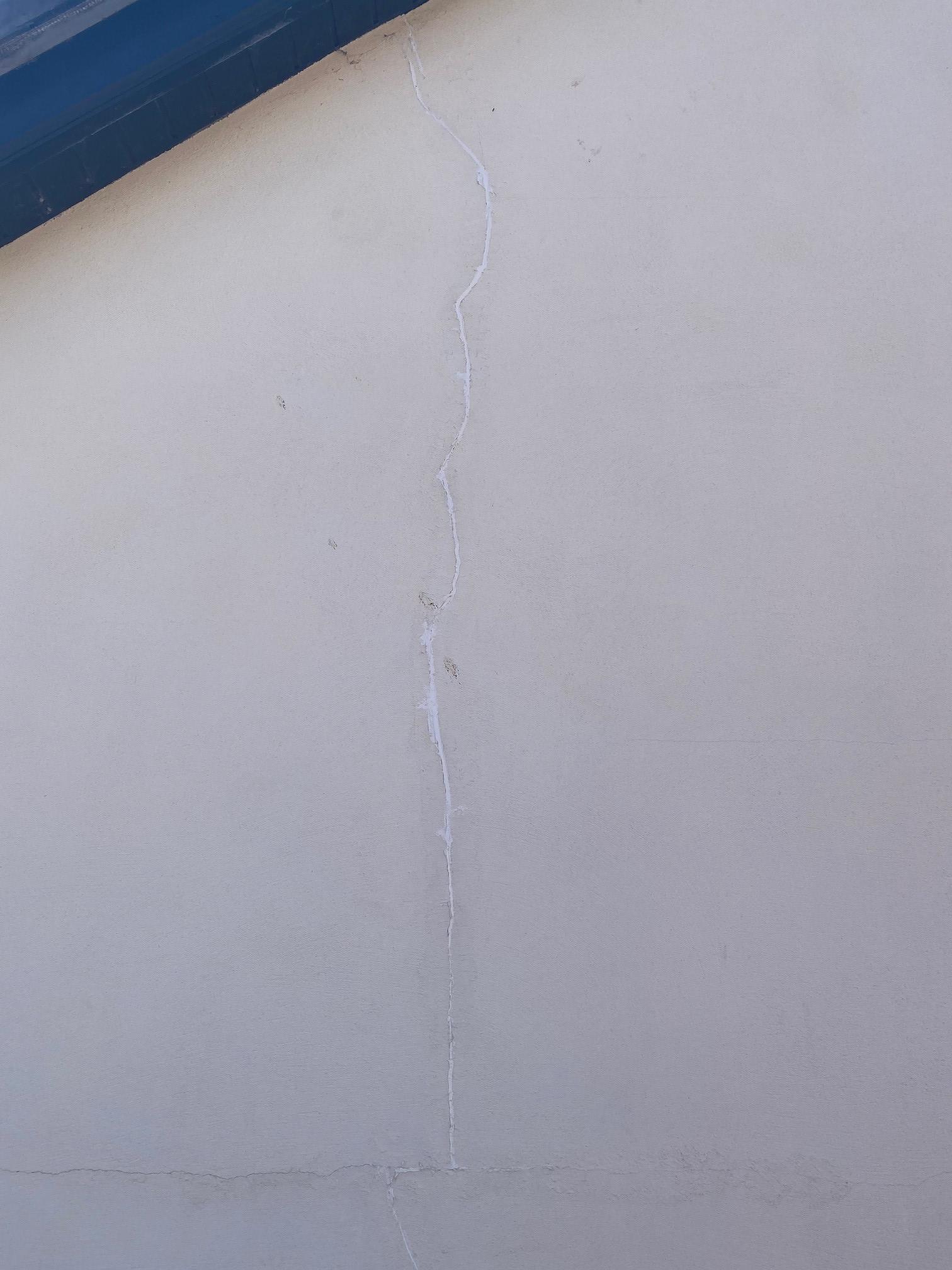

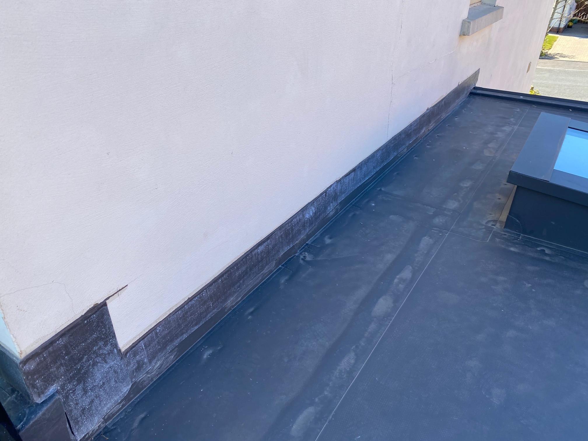

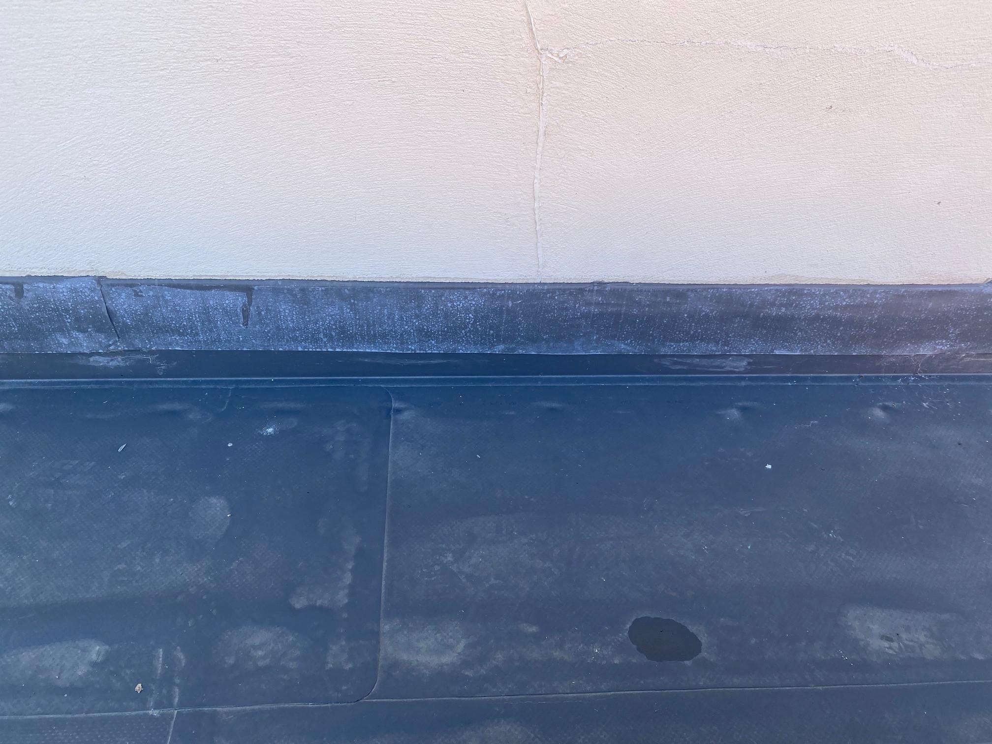

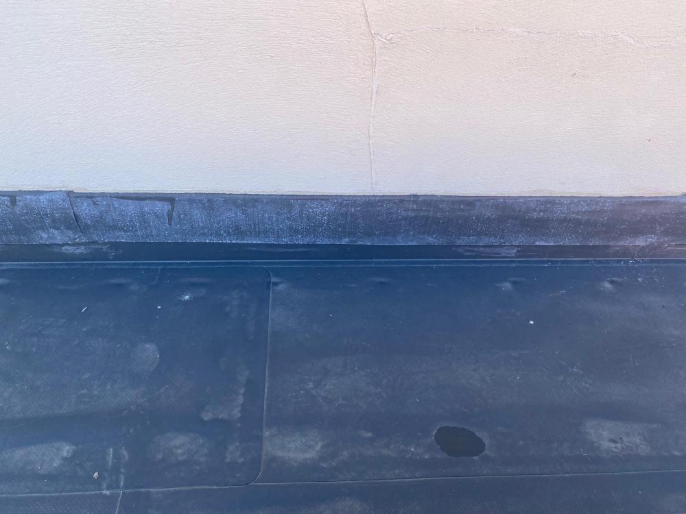

Member (3/5)

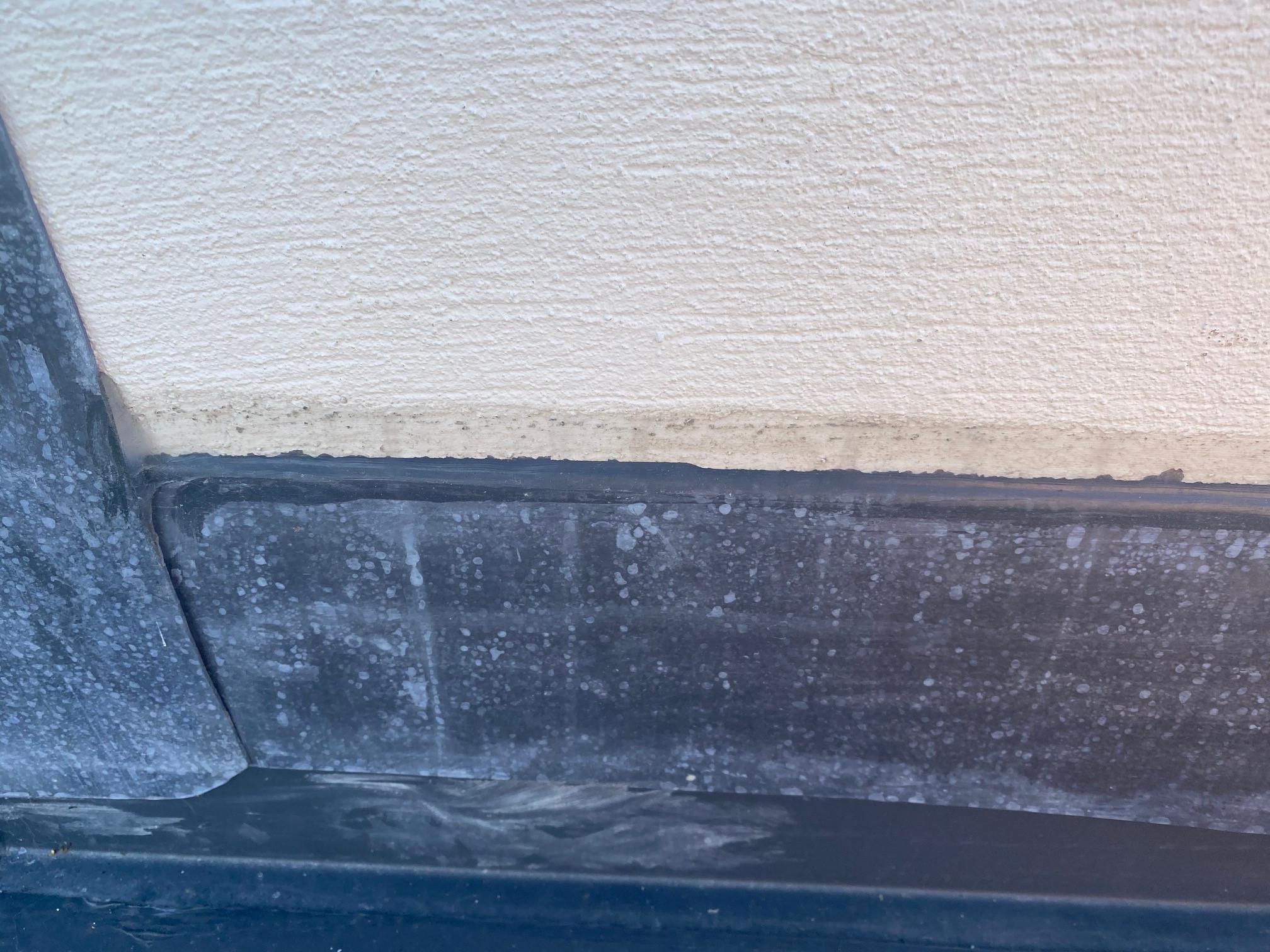

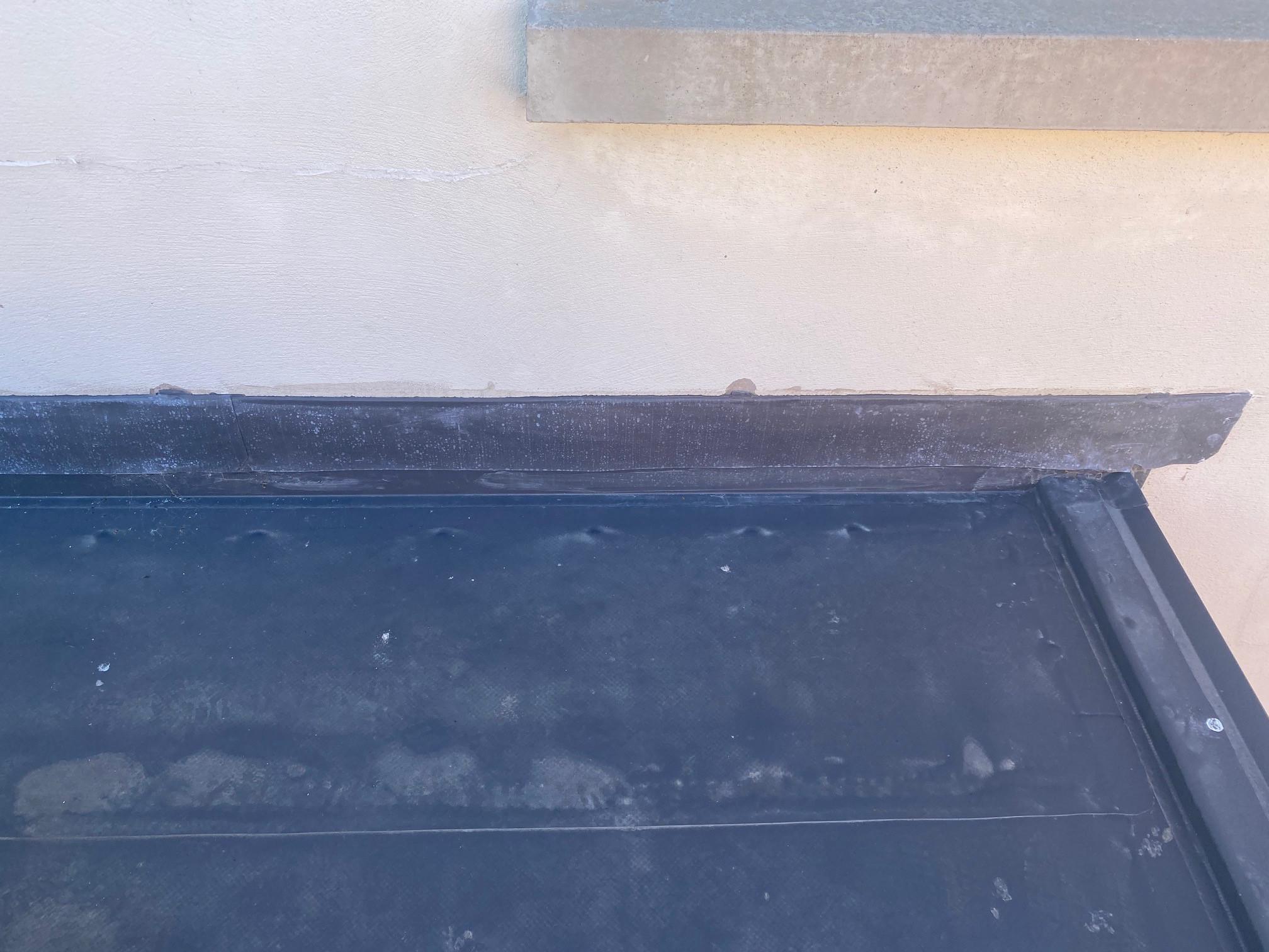

  3. Just checked the BC drawings and it clearly states “install proprietary cavity tray to existing cavity” So looks like a conversation with the builder it is then.
  4. Thanks for all the replies, its very much appreciated. If it’s the general consensus that a retrofit cavity wall tray is needed how to I approach this with the builder? Is this a detail he should have picked up on or that the architect should have specified on the BC drawings? Relationship is good with the builder and don’t want to get into a blame game just want an amicable solution for all parties to get the issue fixed.
  5. It was plaster straight onto the old render no battens or plaster board. As for how quickly it appears I’d say definitely within a hour or so and not days but it has to be an almighty lashing on the gable wall which unfortunately we haven’t had in a while. Has taken me 2 months to even get a plasterer to come out and look at the job as the guy that plastered our extension is tied up for the foreseeable doing 14 apartments.
  6. thanks for the quick replies gents and close up (just looks a bead of silicone has been run along where they chased the wall) and wide photo attached. Doesn't look like a tray has been installed if my understanding of them is right, the lead was just chased into the wall by the looks of it

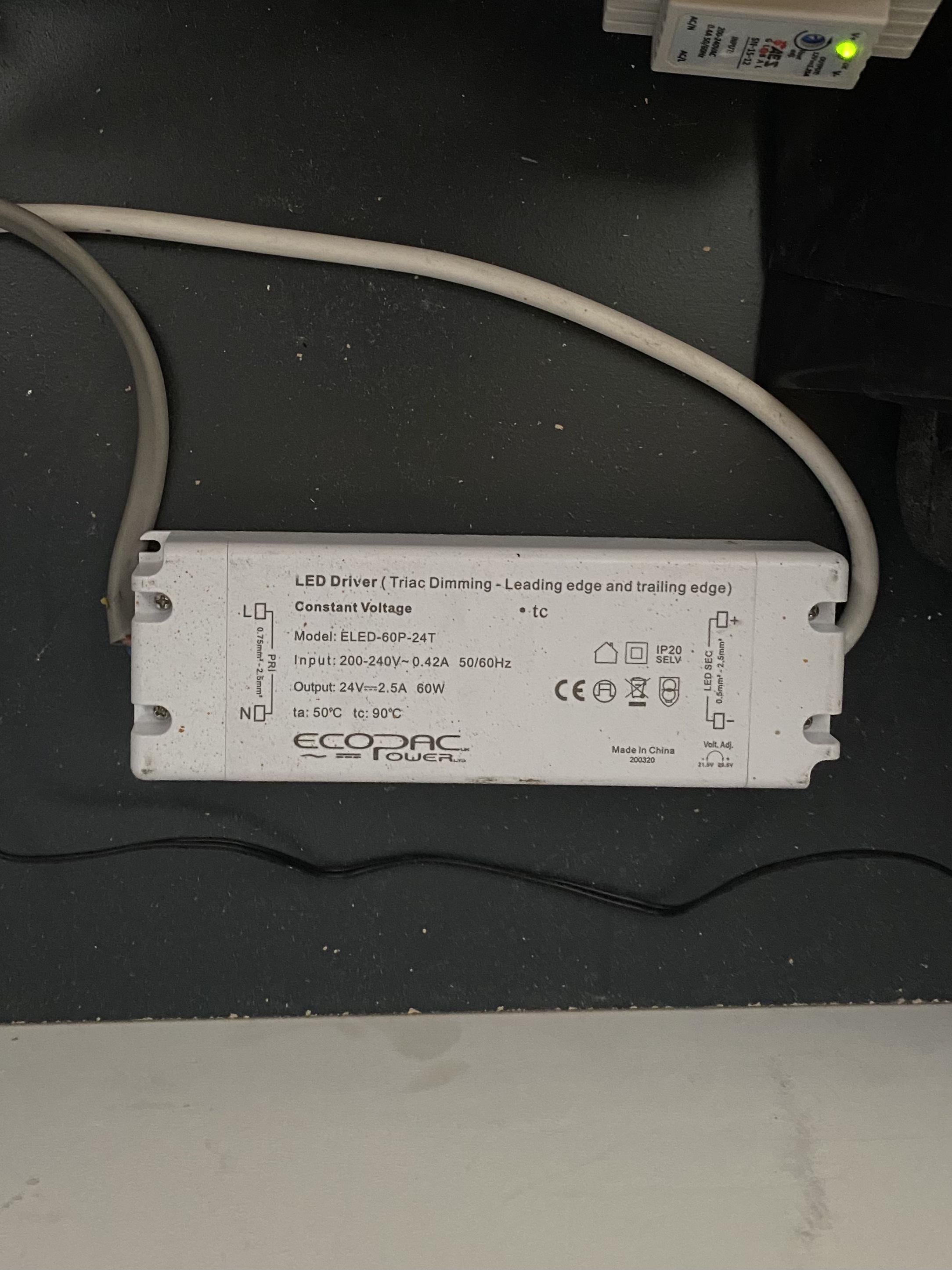

  9. This is how mine has been set up and these guys https://www.led-lighthouse.co.uk advised on what was needed and is all working well. 1st pic dimmable driver connected to circuit 2nd pic plaster in profile with 4 meter led strip dimmer switch controls it with varilight vpro modules
