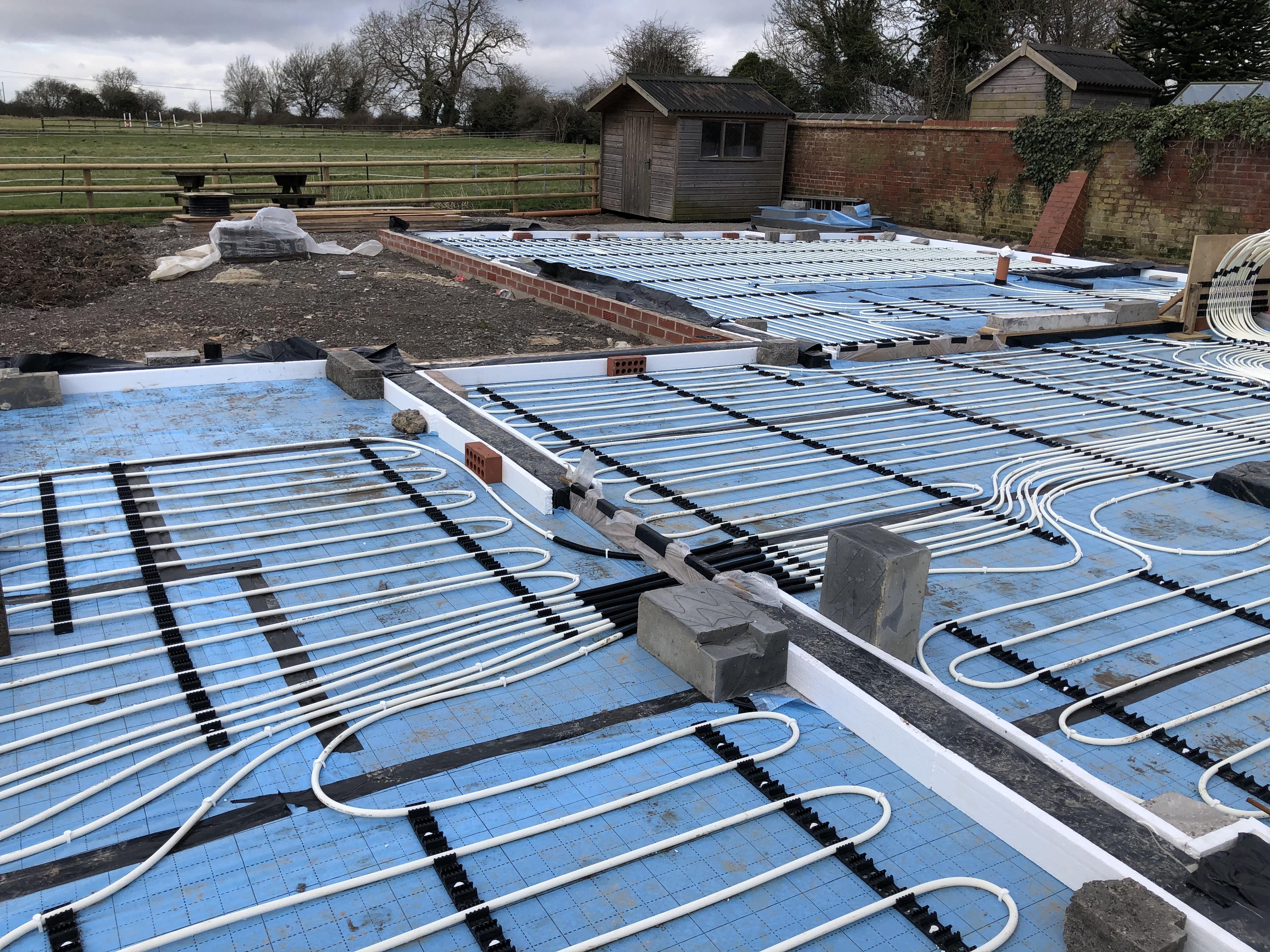

Included beams and all the insulation - this depends on what U value you want to achieve. The dpm is between the first layer of insulation (ie the t shaped pieces between the beams) and the second layer of insulation, then brought up to dpc level at the slpper walls and around the perimeter. The mesh in the concrete is because this is the main structural slab. Lynx provide the specification - I think there are alternatives if you look at their literature.
It was about £40/sqm to supply for the graphite enhanced EPS (150mm between the beams, 135mm above with grid attached for heating pipes) , infill blocks, perimeter insulation. We had it fitted by them (just the beams and the infill blocks) which they did in a day and brought their own crane, cost about £1k extra. The 135mm was supplied because we have heating pipes and therefore need a reinforced concrete topping of 90mm (minimum is 75mm above any pipes) I am probably misremembering - it would have been 150mm of Kingspan.

It wasn't cheap but you can get more of the cheaper insulation in this way. So if I had gone for standard beam and block floor, I would have had to use something like 225mm Kingspan to achieve a U value of 0.12 - would cost several thousand over this area. It was interesting to work with - builder hadn't come across it before - and was a problem when the blocks started blowing away in one of the storms! Also this way round the finished slab will be in place before the frame goes up. So will be perfectly dry by the time the floor finishes go in. The mesh is just to make it easier to clip the pipes to, and when taped stops the concrete falling into any cracks. No need for a polythene separating layer as with Kingspan as concrete doesn't react to EPS. We are having a warranty (Protek) - no issues with this.

We have just installed an insulated beam floor - our's was by Lynx Precast. All went very well. The build up was 150mm beams with T shaped blocks between, dpm, 135mm EPS on top - this was supplied with a polythene sheet glued to the top to make it easier to clip the u/floor heating pipes to it, 30mm EPS to perimeter, 90mm reinforced concrete slab to be poured to dpc level as soon as there are 48 hours without rain forecast. The EPS is graphite enhanced so that we are getting a U value of 0.12.

EPS is actually waterproof - so dpm not always needed -
