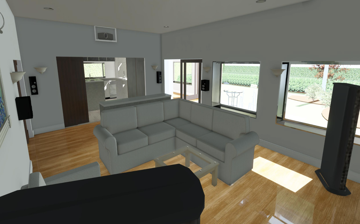

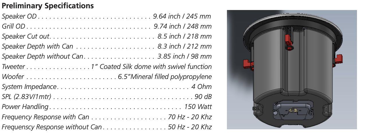

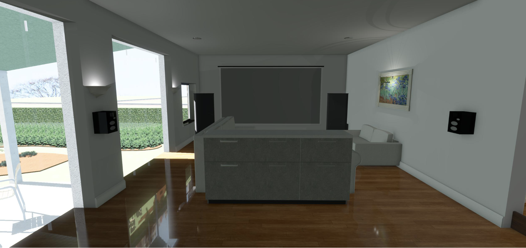

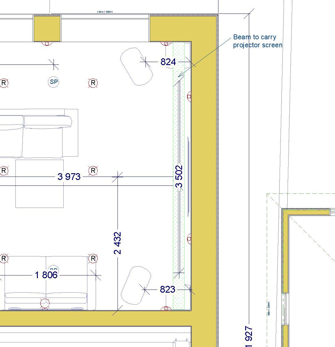

3m50 4m Yep, see the image in my original post. Big speakers - this: is pretty accurate, a 350m, subwoofers tucked behind speakers. (rears not pictured) - it's a full 7.2.4 atmos sy I have 2 13.5" 1000W subs. Not pictured but they're there, it's a full 7.2.4 atmos system. Anything specific you have in mind? How would you design the ceiling for this? Which layers, how thick?

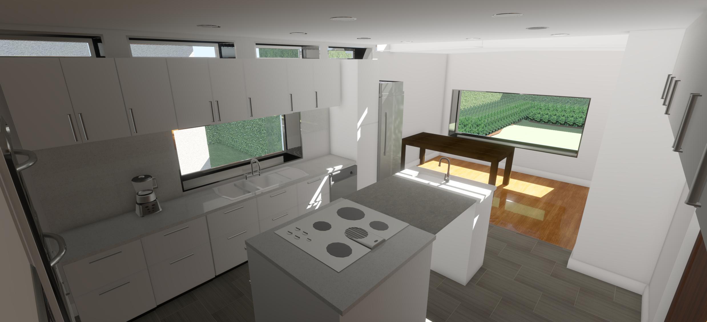

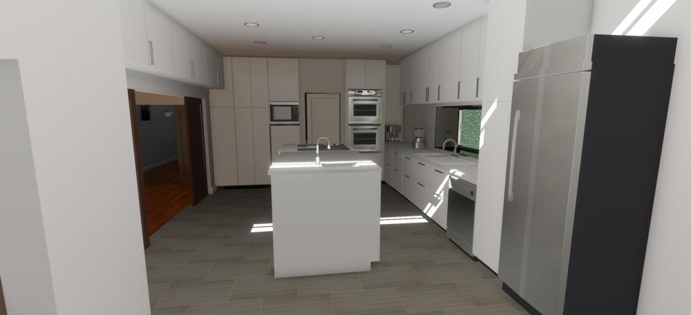

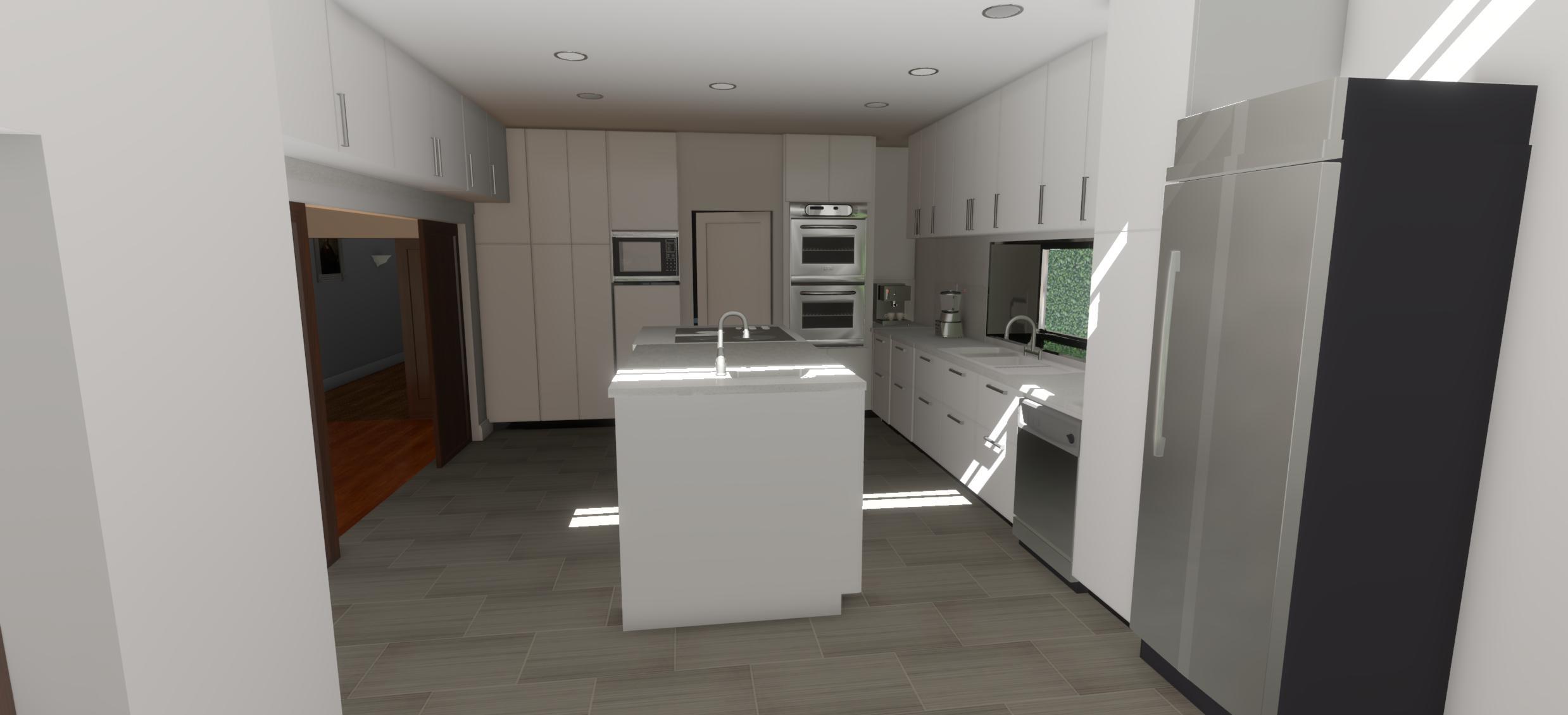

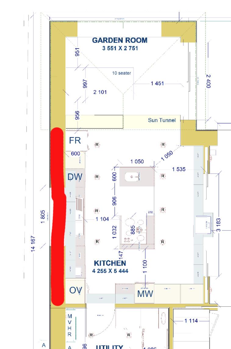

Ah yes, the render is my own on Chief Architect X12, but I didn't pay a lot of attention to lighting settings. But my architect - quite capable as far as we can tell - produced the same design, so she at least didn't consider the setup a 'disaster'. Thanks - perhaps the point here is more about 'expectations' - what is reasonable to expect for a house. My wife is adamant about having a "bright home" but does that mean a glass conservatory with 5 high yield airconditioners..... Maybe my real question is: "How can you make sure a house feels bright everywhere, all the time", noting that even if irrational, humans tend to equate electric lights as a "negative" in this context. Will this design *feel* dark? -

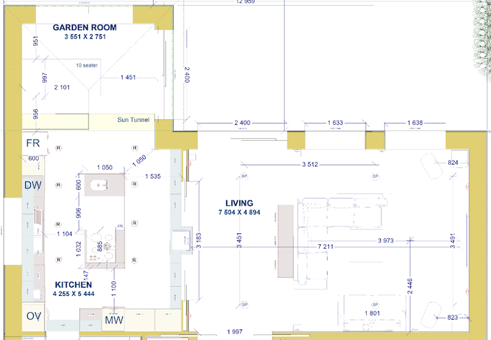

Any suggestions where to find a light modeller? ? I assume you mean some program, not 'a person', I don't think mine (chief architect) has it, so I'd be happy to quickly throw together a copy of my house into e.g. Sketchup if that has it? As we're all aware every layout is a compromise somewhere.. but can you be more specific? Of course swapping kitchen with garden room will fix it! But then our dining is dark. Or we could remove 'garden room' and squeeze everything into the main space, but then everything is cramped. Punching a light tunnel straight through to the roof might improve things but would it even fix it? Etc. -
Take a look at our Kitchen - as you can see it has only one external window, which is facing a hedge at 1m (so we might even leave it out). Both Living and Garden room are very bright as you can imagine, and we already figured we'd put a sun tunnel right next to the kitchen too. But using 3D renders the kitchen looks pretty dark: This render is supposed to be around 1pm. What gives? Is this a limitation of rendering? Or will we have to simply resort to turning on the lights? Or are there other options, is the design fundamentally flawed somehow?

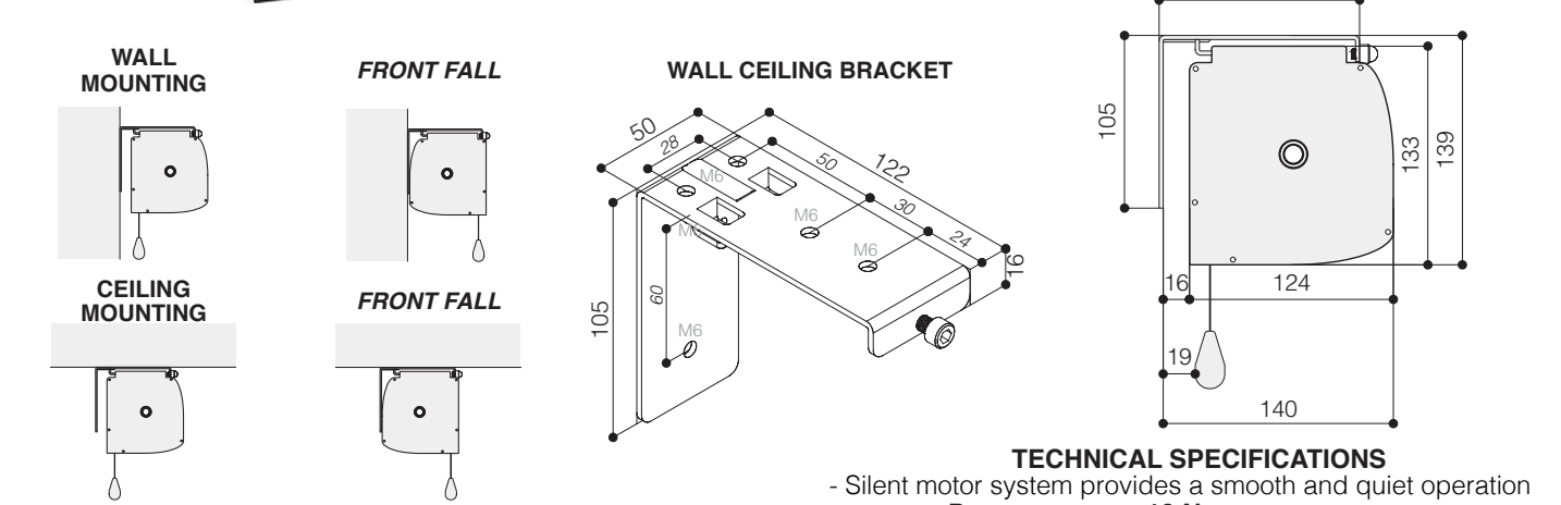

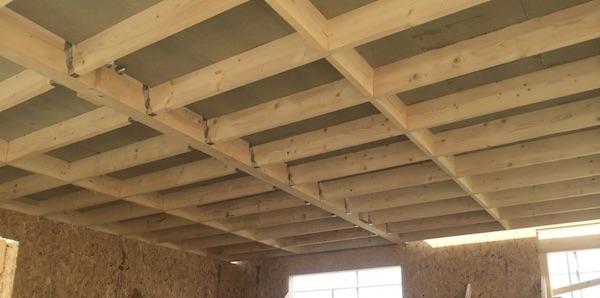

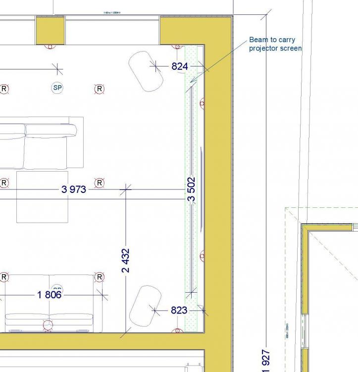

TL;DR: how would you design a noise-insulating ceiling that can carry a recessed projection screen and speakers? Ideally would love to see an actual design of a ceiling - which layers did you use, thicknesses? Longer: Building a house from scratch. Timberframe. Passivhaus-ish insulation levels. Underfloor heating. Above the cinemaliving, there are bathrooms and bedrooms. Sadly I know very little about how a timberframe ceiling looks, and how much space for 'equipment' there is. Projector screen: Spec sheet for projection screen: https://www.jp-uk.co.uk/media/product_pdfs/major-tensioned-datasheet.pdf - The cassette+bracket is 139mm but I'd like the 'dangling part' to be recessed as well, if I can. Not sure if it fully retracts so I should probably aim for 150mm - A wooden beam to screw the screen into is ideal? Needs to carry 36kg with 4 brackets, 4 screws per bracket, and of course needs to be in a spot where projector screen would be! Like so: - Do you guys think I could use "wall mounting" setup and screw it to the side of a beam? What should I tell my architect/builder/TimberFrameCompany? Just a randon pic, but the joists seem to be as deep as the beams so no way to fit a screen cassette to the side of a beam, just directly under it? Or? Spec sheet for in-ceiling speakers: https://mksound.com/wp-content/uploads/2019/04/IC95_intro_A4_rev3_feb20195b15d.pdf - MK IC95 - IC95 In-Wall/In-Ceiling - the can (pictured) seems to be 212mm: They can probably partially fit between joists? Any thoughts much appreciated...

A quick update - as you might've seen before, I like to use the free(ish) tool Focusky since you can tell a story, or let people browse around the design by themselves. For our Architect and Neighbours I've prepared the following: http://focusky.com/uqqn/nldz It contrasts the architect's latest design and my own updates, and there's a bunch of renders A flythrough is here: https://drive.google.com/open?id=1VePB0LlI72zITLYDAQEPcUYv5Jkwdsem (the player seems wonky, but you can download the file to view it) Just the floorplans attached.
