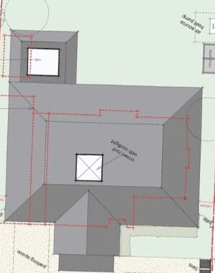

  15. Thanks joth! Yeah MVHR and even one of those inline cooling kits would be top of mind here. Anything noisy and anything that would need some ducting towards the surface. OK, I think you're on the same page around the position of the thing. I guess it might be helpful to get an idea of how tall these things are (to know where to let my windowsill start..) I liked the idea of mounting it on a side wall above my head (so thats at 3m then.. ) but the problem is that the neighbour's garage is only 2m tall which means he will have a view of the thing. To be fair, the only side window there is a stair so maybe not a big problem for him.. The viesmann unit looks interesting.. although I am struggling to imagine (maybe I shouldn't..) why they call it attractive - rule 34 I guess.

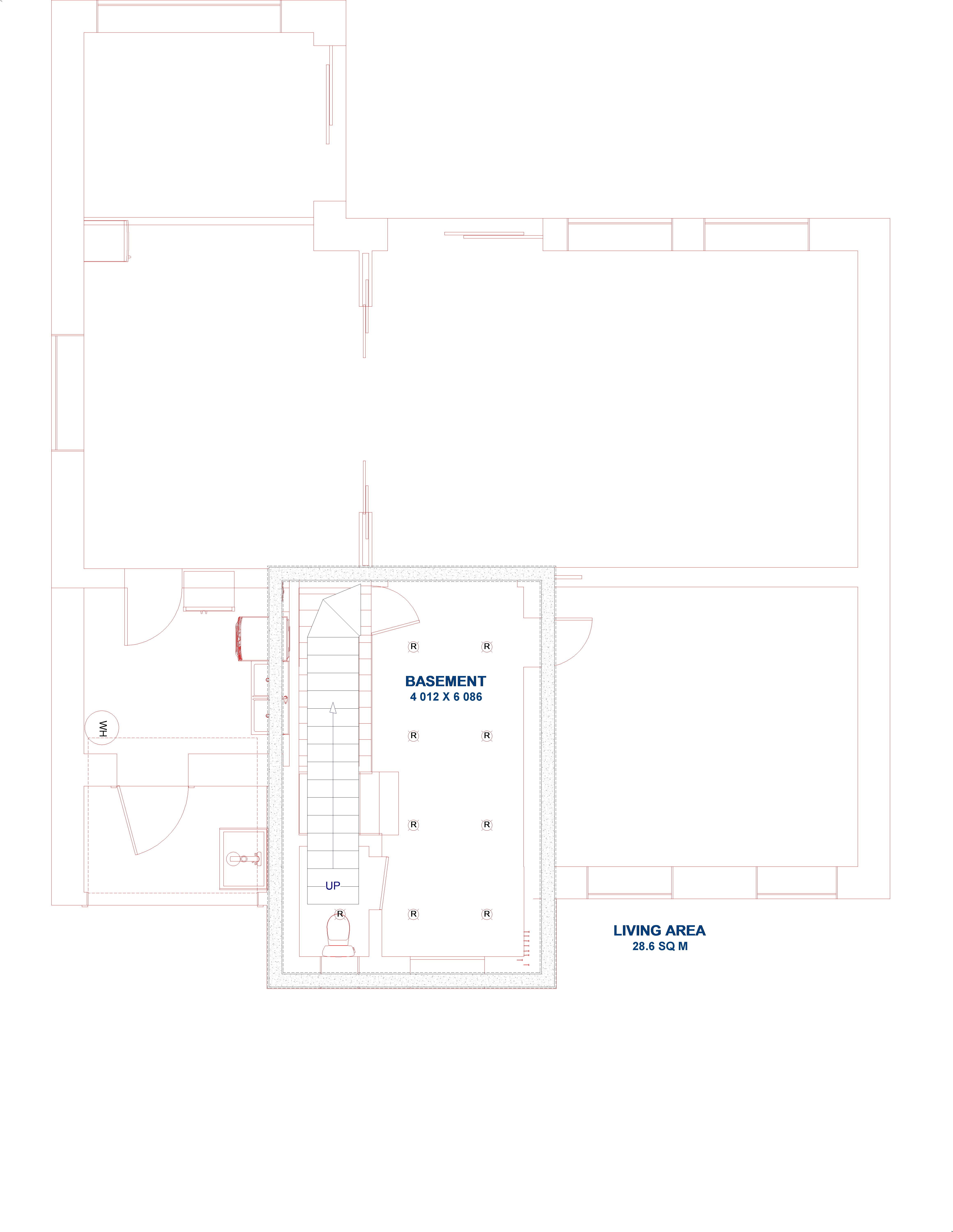

  16. As can be seen from this basement floorplan, IF (bit of an if..) we build a basement, it will likely be right below the hall of our house (the front door is right above, the rear of the house is top) In that case, where should one exit things like vents etc? My hunch is that somewhere near the "L" of "Living Area" - bottom right is the most obvious, since it is a direct shot straight up to ground floor. Benefits would be: + Noise of ASHP would be furthest away from neighbours + Shortest distance for refrigerant lines to run + ASHP would not be hit by sun at any time of the day. But.. - it's close-ish (6m) from the street. - Putting it in a slightly sheltered corner might reduce efficiency? The alternative spot is to the left of the house, next to the garage perhaps. + Noise far away from our own living + Neighbour garage is right next to it, so should muffle sound for them + Fairly little direct sun, only at 10am-ish for a little while. + Perhaps a bit more draughty than location 1, hard to say, straight walk front to back, but no space forward (hedge) or back (wall) And negatives - Blocks the walk to the back somewhat - Longer line to the aforementioned basement What do you guys think? Where to put an ASHP? FWIW our architect provisionally has put the ASHP somewhere halfway in the garden (little white box top right) does that make sense? Other floorplans etc here

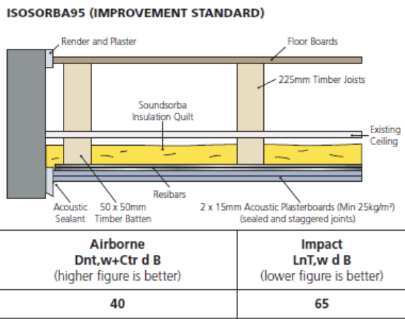

  24. @Reiver looking fwd to your comments. I did find this: Seems like they're suspending a ceiling..
  25. ah, no idea yet! I'm happy to be advised, but as it stands just whatever works? Perhaps the 'passivhausness' would dictate something.. Right! Well I was thinking about that, while I'm sure my wife would want a white ceiling, nothing stopping me from putting some clever-but-white material there. That said, at some point audio-deadened rooms feel weird. Cool for perfect audio perhaps, but for day to day living your mind expects a certain level of echo? Looking forward to your proposed ceiling sandwich suggestion. First a layer of porous cheese like material, then a spread of PVC.. maybe some fiberglass for that crunchy bite..
