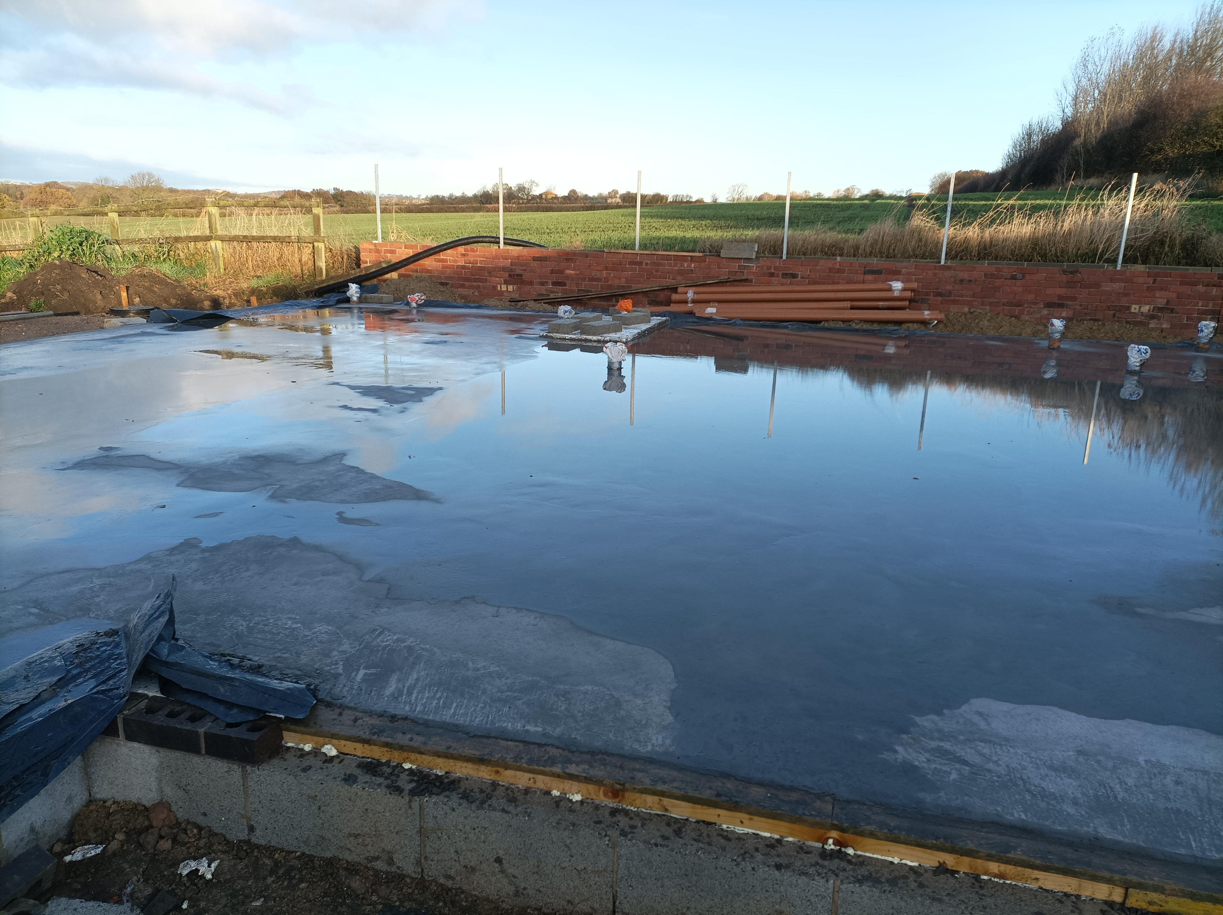

Im not unhappy with the slab although I just assumed standard practice tolerances were tighter. I was an engineer and found 2 previous building conversions difficult...having to throw tape and level and rely on eye. Now Knackered with heart failure I decided to leave it to a builder and just organise materials for my final resting place.
2'' slush on it today and melt completely filled the unfilled outside of footings trench...they had been left open for drainage later next week (brickie/ builders idea). Shit happens, just always happens to me!. luckily had an old vortex pump in the container to pump it out.
SE and architect never specified tolerance, the concrete guys had a datum to work to and guy floating the finish asked what floor finish I was having which I told him to just cover me for every type and get it as flat and level as possible. A rough check seems to be that the level falls about 8mm across 14.6m of floor with the puddled areas less than 2mm low and one spot has a slight ridge of 3/4mm and about 1m long...but I think this would be under a kitchen cupboard later.
One of the best views in the area... only trouble is the 35miles of open view to Saddleworth and Derbyshire peaks which the wind loves. The shower recess is 2m x 1m
Just had concrete finished floor slab laid yesterday which was power floated...How flat and level is flat and level? rained this morning before I had a look and there is a lot of ponding and high spots.
