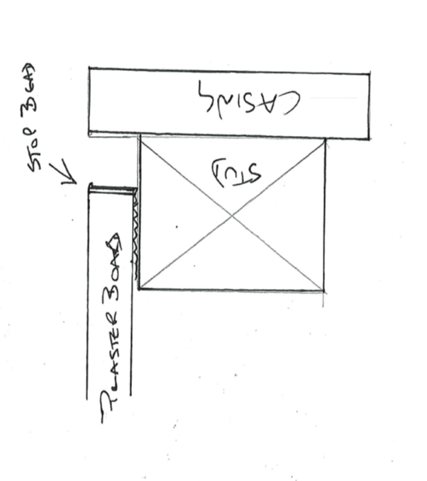

How to finish around door casing without architrave
SlivenClod replied to Pete's topic in Doors & Door Frames
Have you thought of creating a shadow line? I would be worried that the plaster would start to fail with the movement of the door in your sketch. I have seen it done like this - and I am planning using this to do away with architraves -
