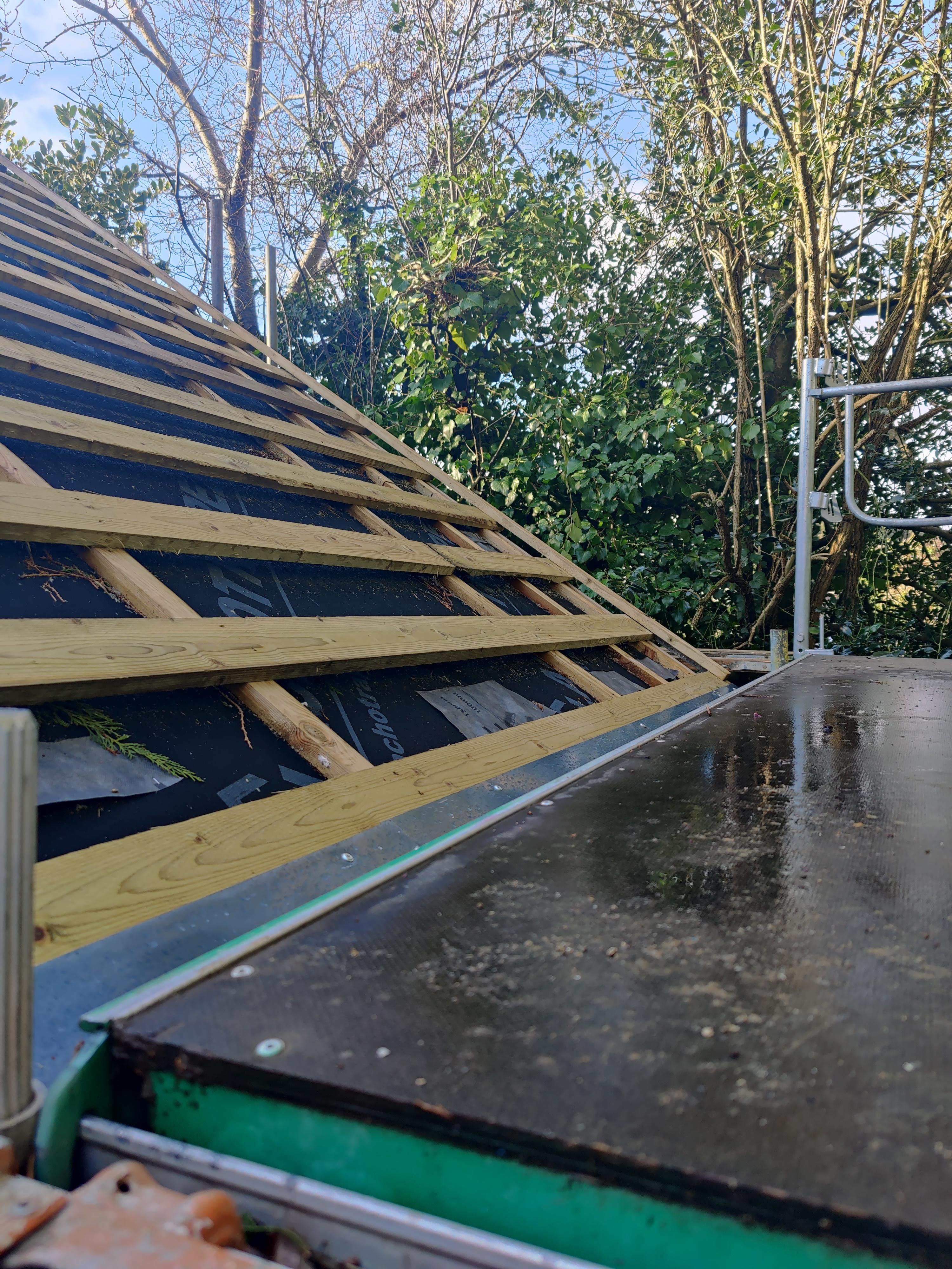

Standing Seam Roof
Patrick commented on Patrick's blog entry in Timber Portal Frame - but stick built
Too low for what purpose. Apologies for my lack of understanding but there is cladding going on the entire dormer and a window cill integrated flashing on the bottom. How would you imagine water getting into these sections. There are several ways to approach a metal roof , it all depends on the setup and rest of the building . Thanks for the good advise but the detailing is spot on 👍 -

Standing Seam Roof
Sorry to disagree there. The detailing on the sides of the Standing Seam is correct. No weather can get in there. Flashing is an option but it doesnt look as good, better to form the flashing from Panels . -
