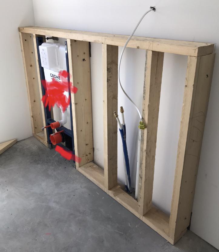

Thanks all. A simple fix really…. Ye might not agree with it.. drilling a few holes in cement board and sprayed expansion foam into it. Has hardened it up substantially. -

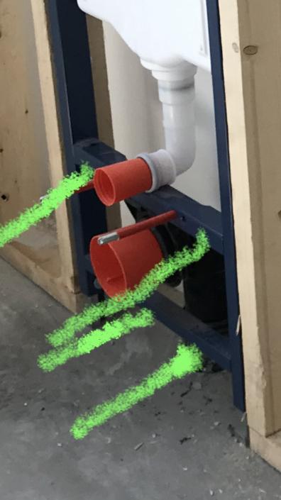

Thanks Nick. See again unedited version of what carpenter did before cement board went on . Metal frame flush with timber studs. Can he screw the cement board tight to the metal frame using a metal screw and tighten it around the pan bolts that way?. See green lines below . I still don’t see how the carpenter could have put in anymore horizontal studs between the toilet frame metal uprights with the cistern In the way etc!. am I understanding u right in that the area around the bolts in where the compression will occur when the plumbers tightens the pan to the wall and if the cement board is flexible there, it will crack… what about 12 inches above that near the cistern…no compression, so no issue? One last question please…what is the order in relation to the work here…tiler tiles the wall and tiles into that white box( the flusher )?. Plumber then takes off the white box after tiling and fits the flush plate. I just worry the plumber will blame the chipper for some issue with the flush plate in the future?. thanks Thanks -

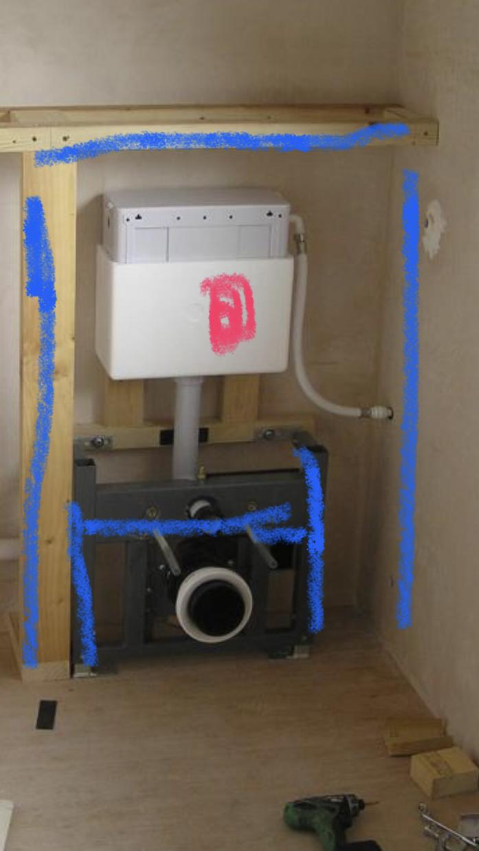

Thank for that. I see the same question here really. I presume u fixed the board along the blue lines and perhaps fixed it into the horizontal metal bracket . What is backing the cement board at the location shown red approximately? -

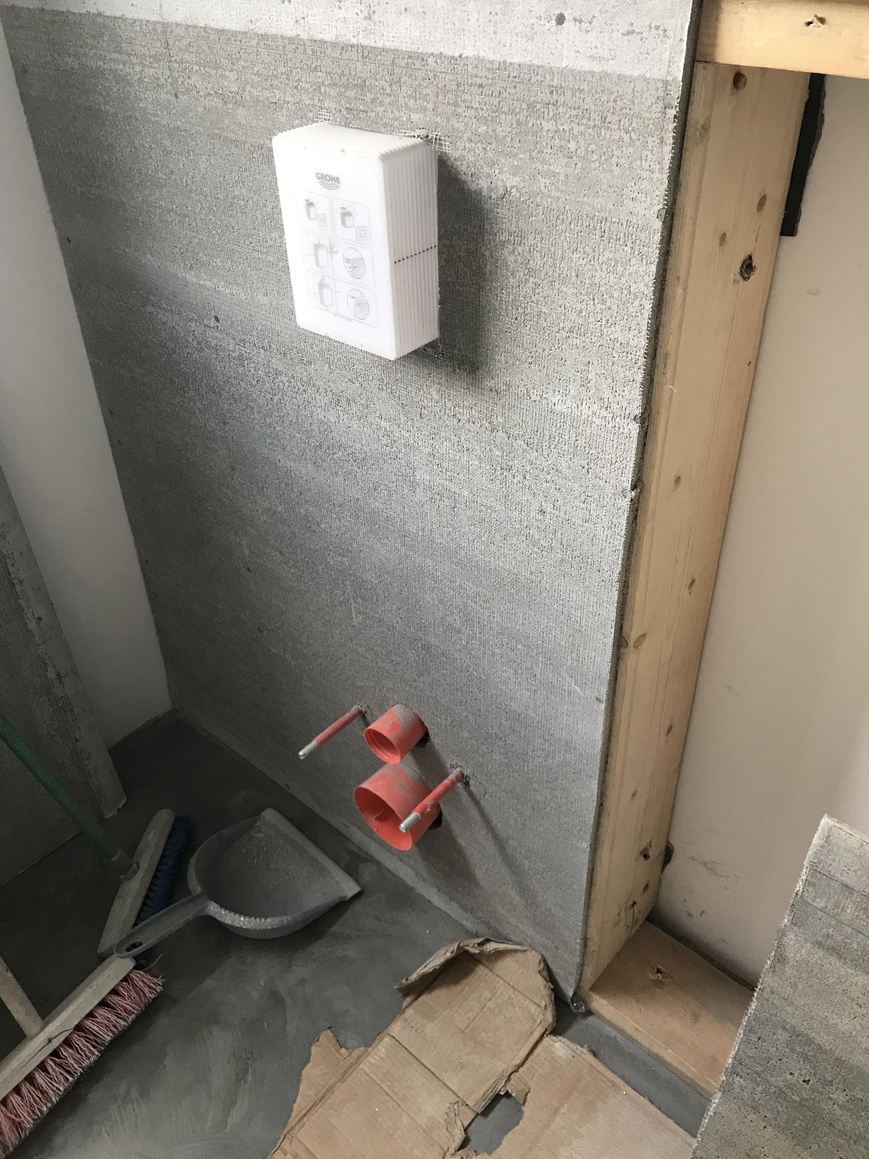

Can the wall hung toilet afford to lose another 12mm of bolt length?? -

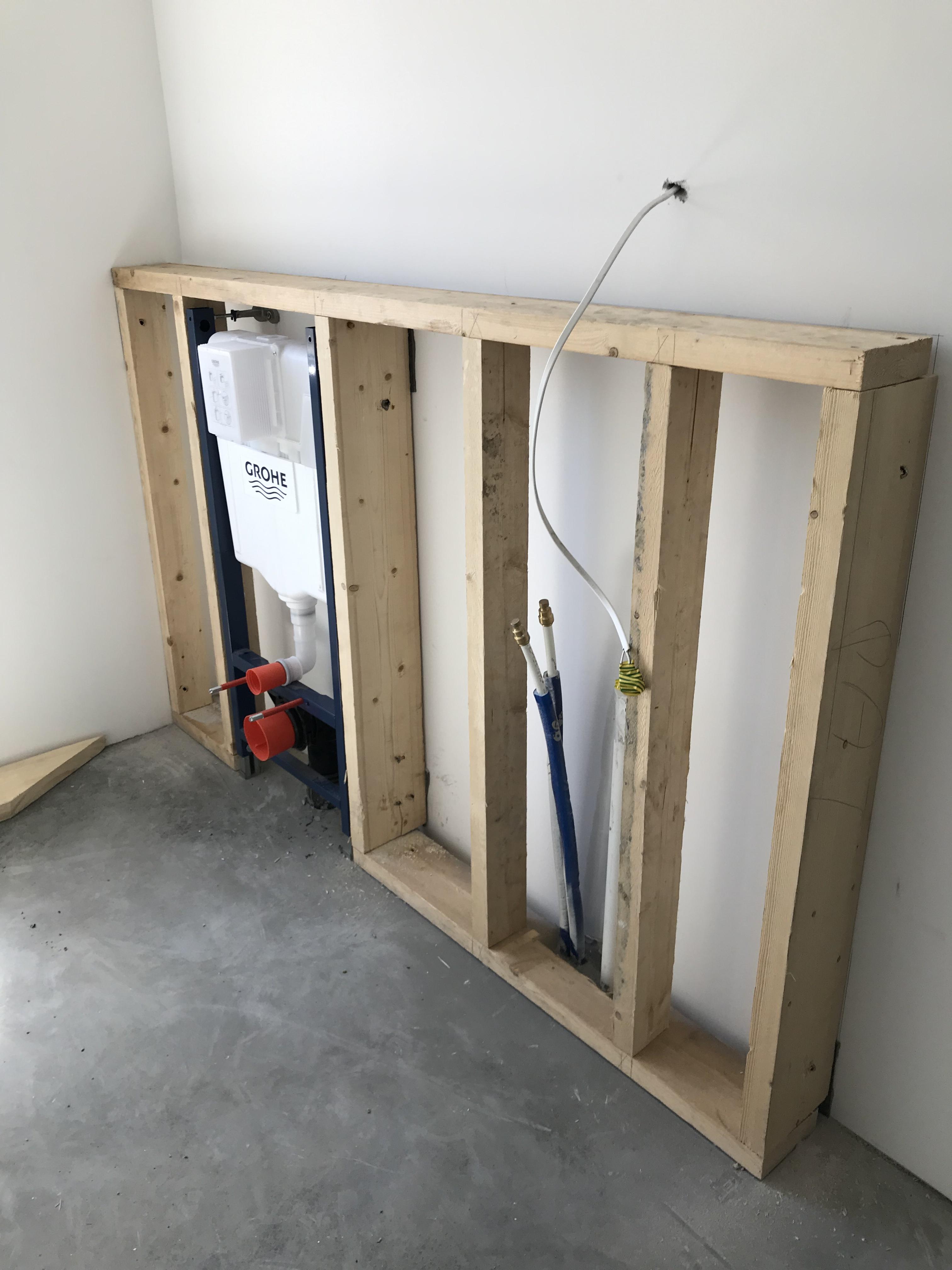

Toilet frame fixed to block wall.timber frame screwed to wall. It’s the fact that the spacing between the timber studs is wider due to the cistern and toilet frame and the cement board pushes in when pushed -

Hi. I am installing 2 Grohe wall hung toilets in my new build. Plumbers installed toilet frames first . Then carpenter built frames around toilet frame. Carpenter put 12mm cement board onto frame .Tiler is in now and he is saying that the area shown (roughly) in red is flexing a bit much. The rest of the cement board is fine and not flexing. The reason is that the distance between the vertical timbers either side of the toilet frame is maybe 100mm wider but also there is no room for a cross timber because of the cistern and pipes etc. carpenter is like ‘ what do you expect me to do?’. help appreciated please…
