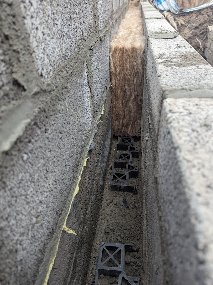

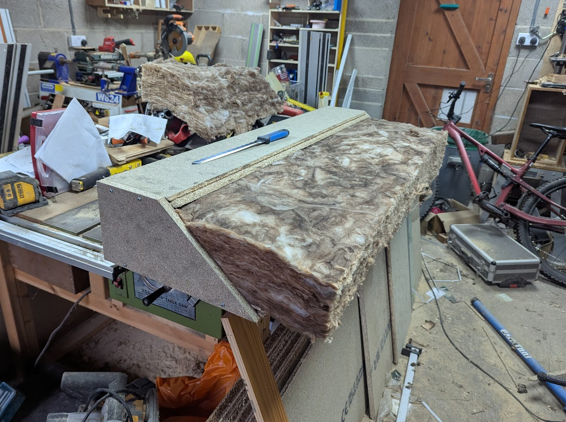

I came up with a solution for this today. I bought a couple of packs of these driveway grids https://www.wickes.co.uk/Wickes-Ground-Grid-Base---100-x-100cm/p/236266? which are 250x250 and come in a pack of 4. They cut really easily with a track saw, so I've cut them into roughly 120mm wide strips. Should do the job nicely. -

Would you expect the batts to stay in with friction alone? In one section there's enough cavity below floor insulation level to have a gap, but too low for there to be any ties to sit the batts on. I'm tempted to buy some little plastic plant pots or something to put in the bottom of the cavity for the batts to sit on. For the other section of wall, the batts need to go pretty much right down to the base of the cavity. Does it make sense to stand them off the bottom 25mm or so, so that they could drain if water did get in, and so they can't wick moisture up from sitting on damp concrete? Again, are there products to use here? I looked on Knauf's website which seems to have no technical advice. -

In practise how low should mineral wool go within the cavity - right down to the base or would you stand it off the bottom of the cavity somehow? -
