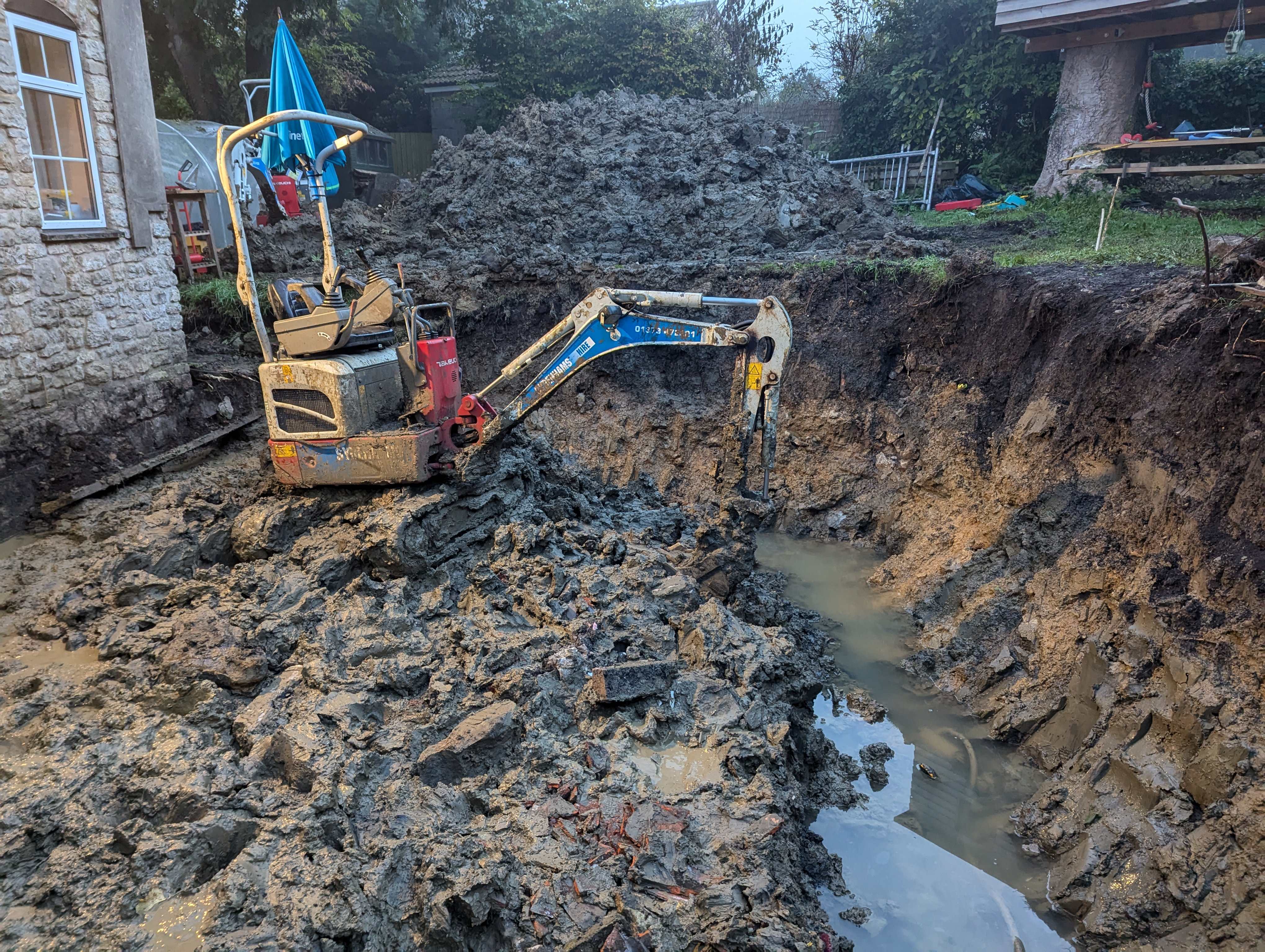

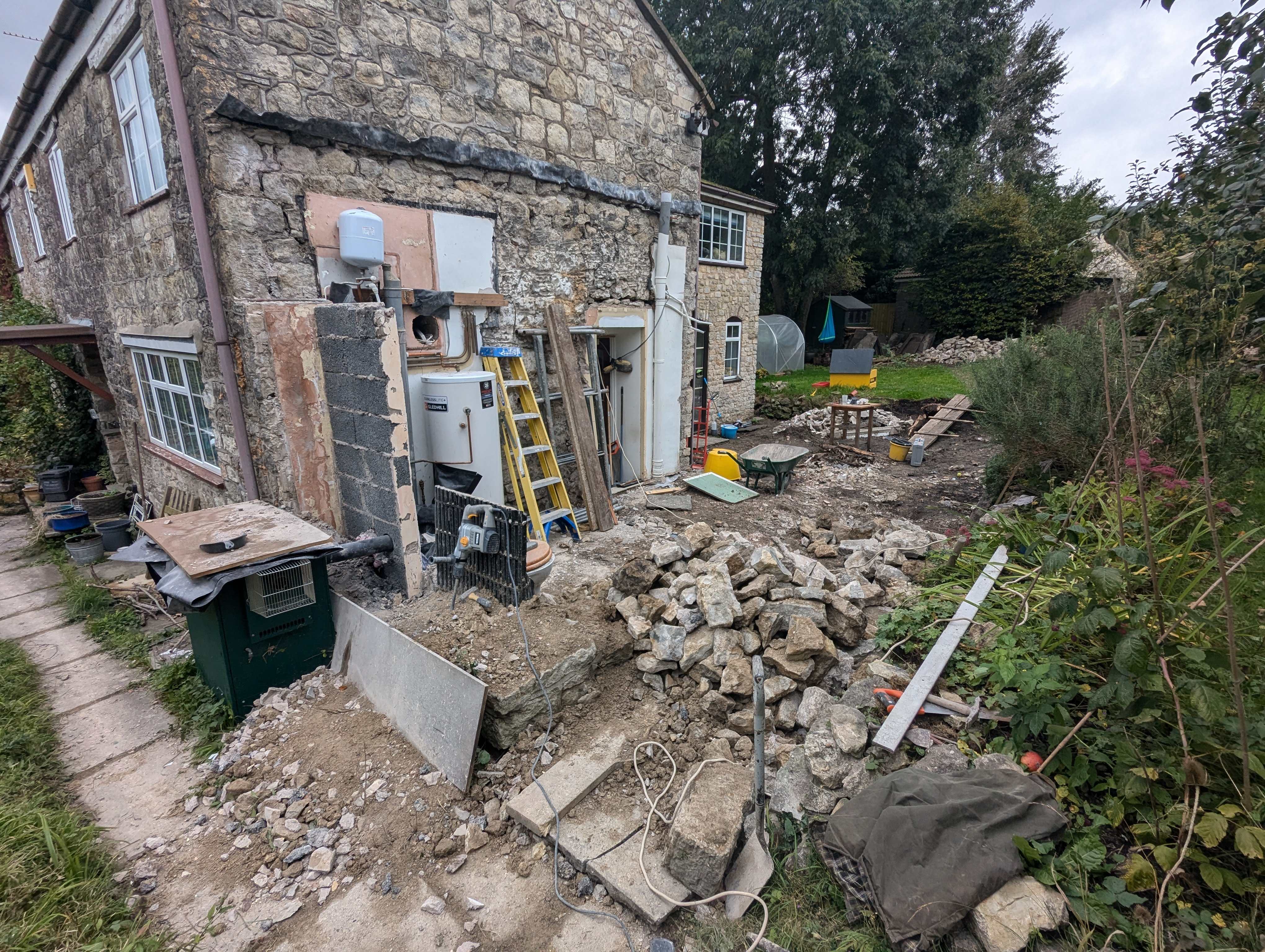

  1. Here's a couple of pictures showing the height of the chaos and where we're at now which is a lot more civilised. For a few weeks it felt like we were recreating a WW1 trench.

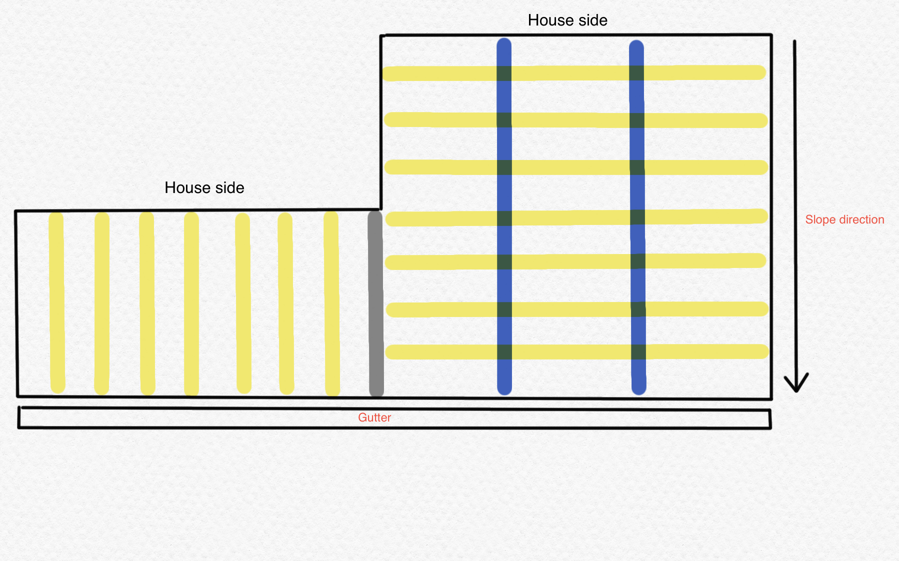

  18. This makes sense but the problem is that the joists will be going the wrong direction relative to the slope of the roof (see crappy drawing below). (Grey is an internal block wall, blue is structural steels and yellow is joists). I was expecting the OSB to go above the joists, firring strips to go on top creating the slope away from the house, then another deck for PIR to sit on. Re your point about VCL, I assumed I would be connecting this into a VCL behind the plasterboard inside the inner skin of the block wall. If it's above the OSB (under the PIR) how am I creating a barrier to moisture at the sides of the roof? Is there a detail somewhere that would help? On this point the builder wasn't planning on having a parapet. I'm indifferent but they seem quite popular with warm rooves from what I've seen. Are there merits or disadvantages of parapets? Good point re the compression of PIR and pedestals. I've emailed a supplier to get their feedback, but I assume that OSB over PIR will distribute load enough to allow us to use the pedestals.
  19. We're speccing a new warm roof for our ground floor extension/roof terrace. Builder wanted to just insulate above the firring strips, but ideally I'd like to do 150mm PIR above and 80mm PIR between the joists. The builder pointed out that there would be a void between the 150mm and the deck because of the firring strips which isn't desirable. Should I just put the 150mm on top and leave between the joists? Seems a waste given we have 200mm joists and don't need much of that for services. Buildup would be: Tiles on pedestals EPDM membrane 150mm PIR 18mm OSB Firring strips 18mm OSB 200mm joists with 80mm PIR pushed up against the deck VCL Plasterboard
