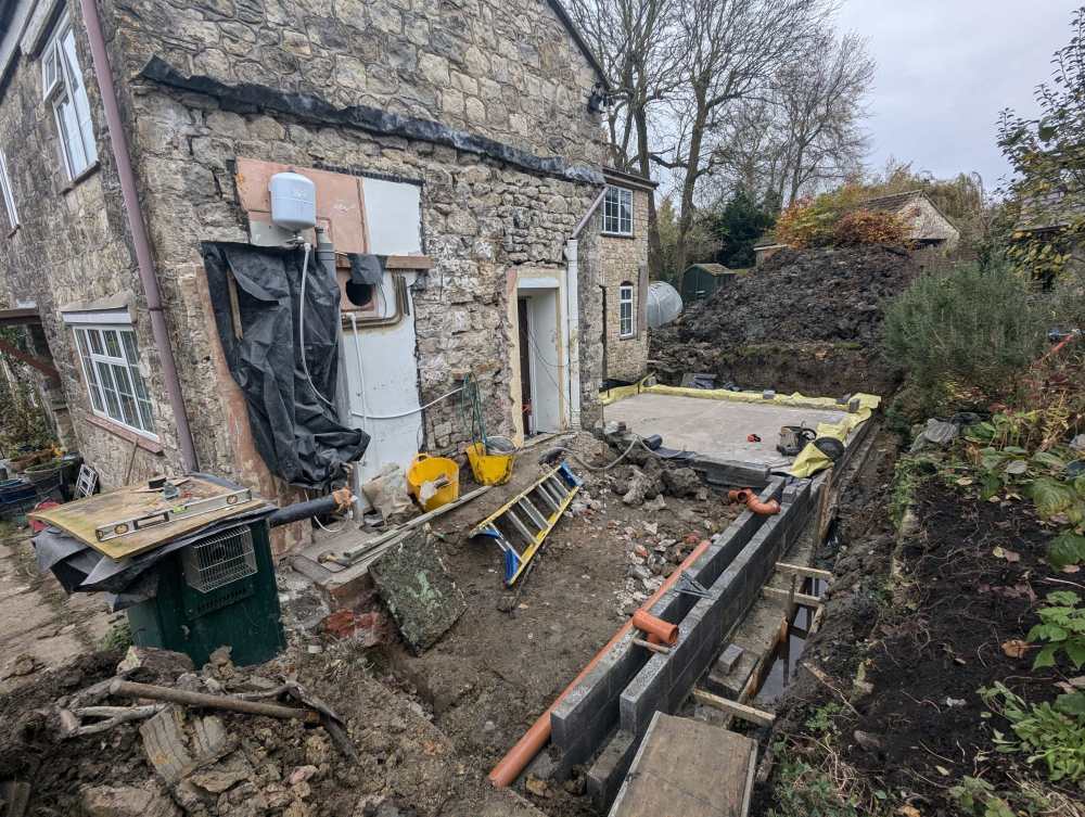

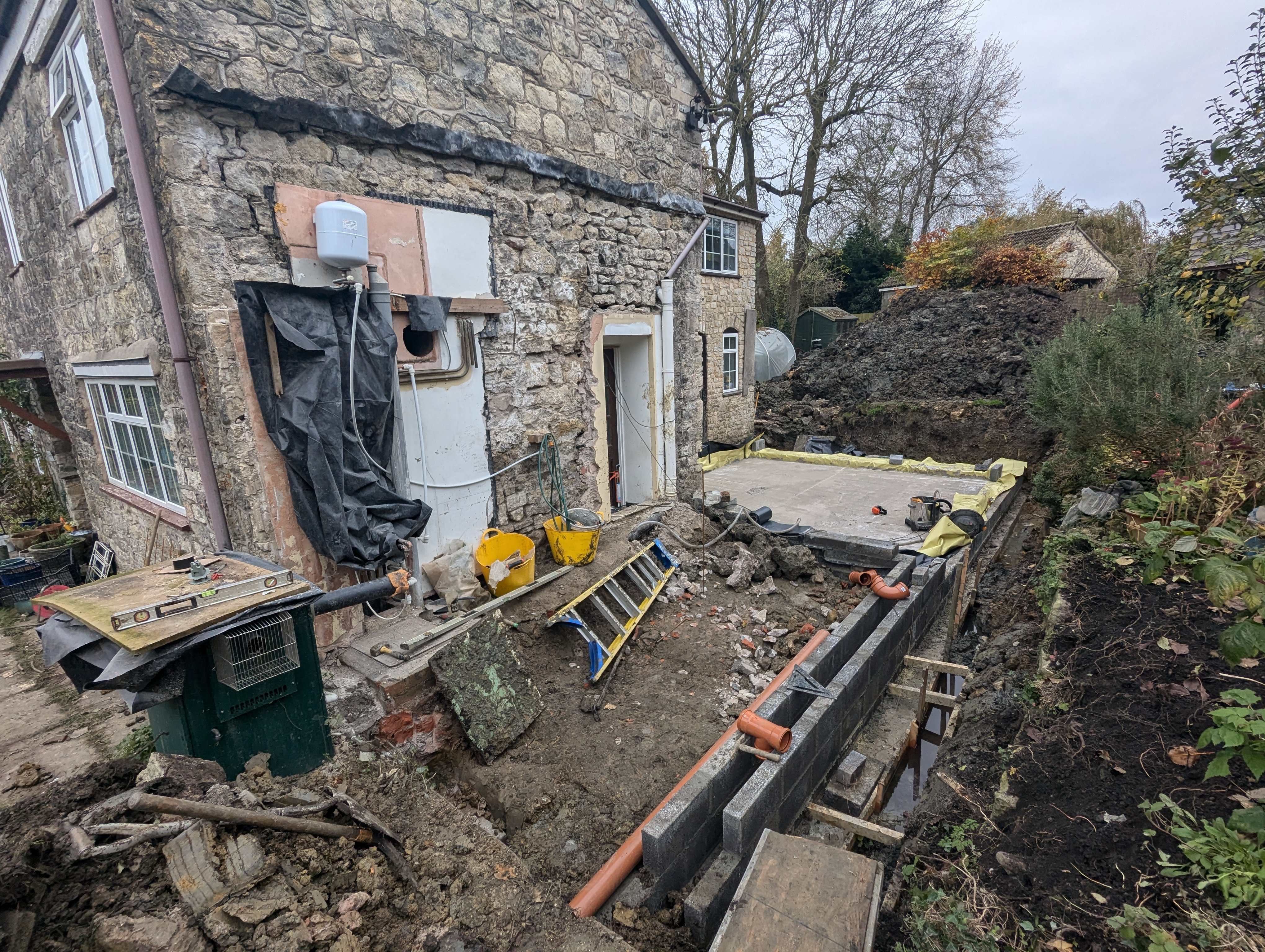

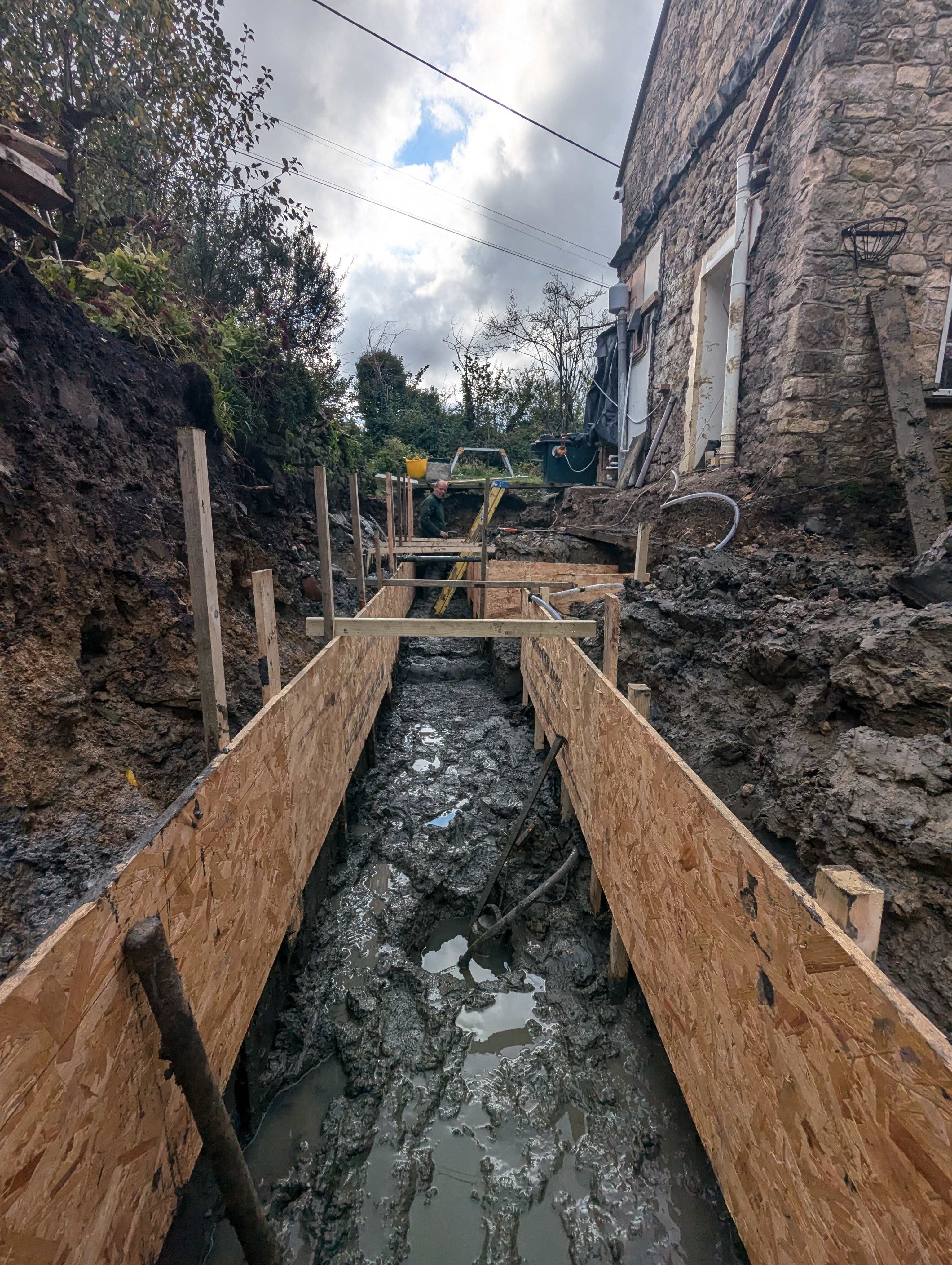

  22. Plenty of sympathy here - we have been battling with went trenches too, albeit on a smaller scale (35m2 extension). Foundations that were going to be 500mm thick ended up 900mm in places due to having to keep taking the top layer of clay off as it got soft and soggy. Our OSB shuttering held up OK, but was a bit too close for comfort in places and wouldn't have been sufficient on a bigger project. Our biggest issue was that we can't get a digger into the bottom of the trenches, so a lot of horrible digging and excavating by hand. The thing that helped in the end was having a pump sat in a small sump running on a timer rather than on the float so that the water didn't get above the top of the sump regularly. This helped us get it under control while finishing the digging, then got BCO approval the day before the pour. Groundworks are hard, depressing (literal) money pits, but once you're through this bit and are standing on clean concrete it will feel worth it. Agree with Iceverge about keeping the builder on side. From his perspective he may feel that if he makes a mistake in an email then he may be held to it. Try if you can to talk it through somewhere that isn't on site and take your time. This part is stressful for all involved and if the builder is otherwise someone you trust will do a good job then it's worth trying to get through it. Here's a picture of our trench prior to foundations in solidarity.
