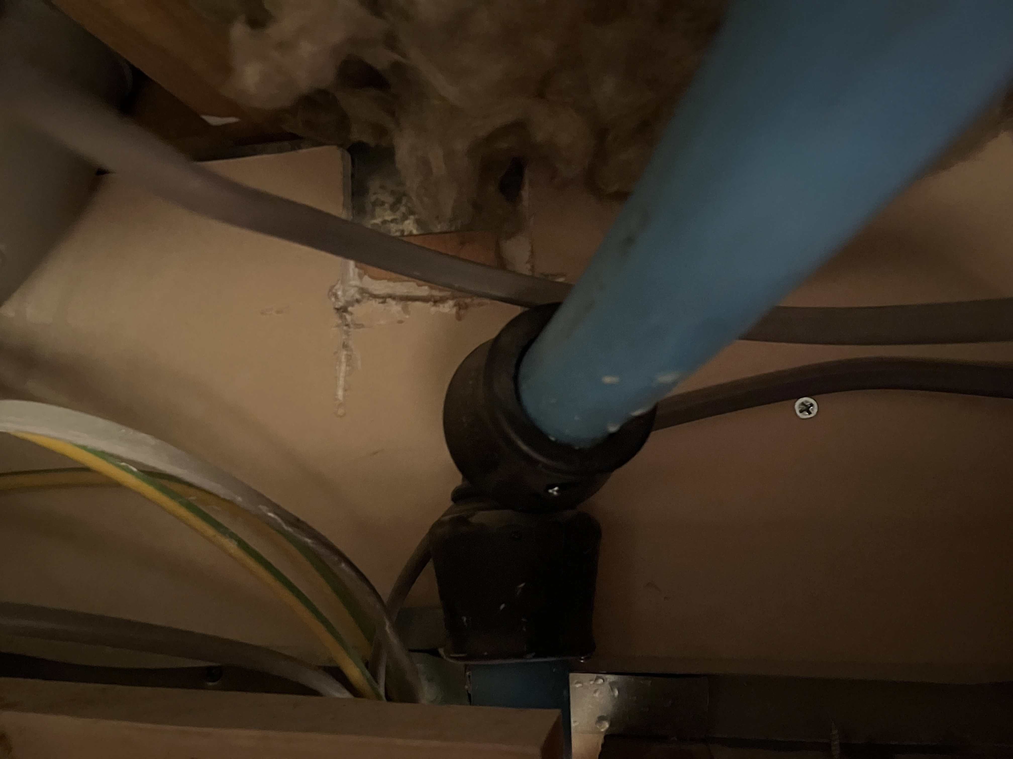

Video showing a bit more of what’s in the ceiling IMG_8617.mov .

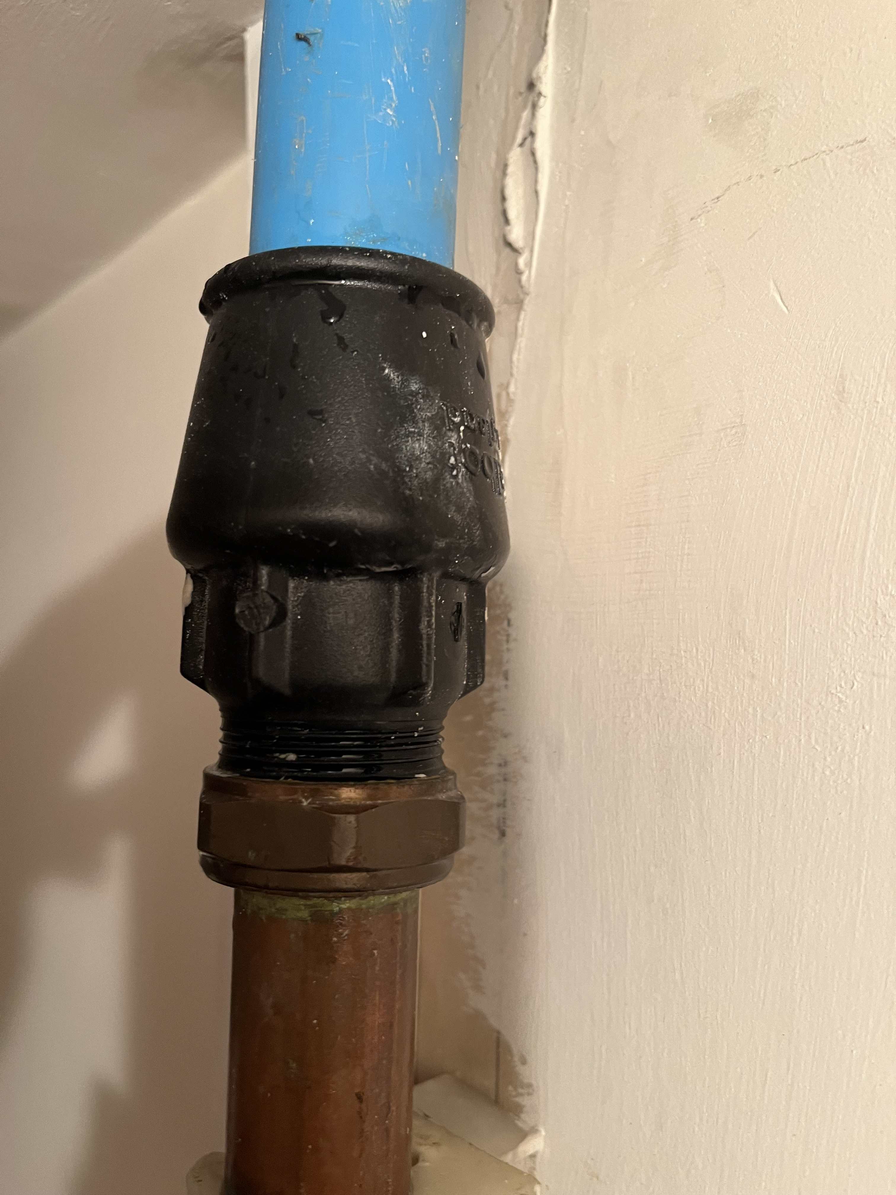

Appreciate that, it's why I'm not rushing to do it and asking lots of questions, it's not leaking right now so I can afford to take my time. I think it's approachable in my situation because: 1. There is a ball valve isolator about 10m away from my front door that I know works because I used it yesterday when the fitting was leaking. I can use that for isolation and it's close enough that I can reach it in a hurry if something goes wrong. 2. I am at home most of the time and wouldn't be leaving any new change unattended. Feel free to tell me I'm crazy. I'm not sure it is. I can't see a plasson option for a 90 elbow MDPE->copper so I'd have to take the copper above the plasterboard, 90 there and then convert to MDPE with a straight coupling, while stiff the MDPE pipe still has a bit of flex in it. I'll attach a video showing the space available. IMG_8615.mov If I have to cut the MDPE pipe back anyway from the elbow and attach a straight coupler there then it's the same number of fittings either way. The prices on the pipestock website for the right tools are low enough that the right tools isn't a barrier. Given the access available I think I'd prefer to use a ratcheting plastic pipe cutter than a hacksaw (feel I'd make a right mess of the pipe with a hacksaw). That all sounds fine. I'm home most of the time anyway so this isn't a problem.

Right so Plasson it is. Plasson Compression or Push fit? For the elbow: https://www.pipestock.com/plasson/pushfit-fittings/plpf-elbow-90 (350107 - 32mm push-fit) https://www.pipestock.com/plasson/compression-fittings/plmf-elbow-90 (352354 - 32mm compression) For the copper connection: https://www.pipestock.com/plasson/pushfit-fittings/coupling-pe-x-copper (350068 - 32mm to 28mm push fit) https://www.pipestock.com/plasson/compression-fittings/adaptor-male-bsp (352288 - 32mm to 1 1/4"/28mm compression) Plus 32mm pipe liners x 3: https://www.pipestock.com/pipe-liners The order process recommended a Boa Strap Wrench as well for the compression fittings. This will be my first time doing something like this so a few more questions: 1. Will I need to/should I be prepared to trim the ends off these MDPE pipes to get a good end? 2. If so, I assume I need pipe cutters. Deburring tool? Probably try and find a short length of pipe as well as a straight connector as there isn't much slack anywhere. 3. If using compression to the copper side, do I need PTFE/thread sealant? New olive? 4. If using push-fit, should I plan to cut the pipe and make a new fresh end? So pipe cutters and wire wool? 5. No pipe liner required for the copper end if using push-fit, right? 5. Anything else I'm not thinking of?
😆 I am the leaseholder. Would dearly like not to be but stuck here until the cladding issue on this building is fixed (even then flats in London are not in high demand right now so I'm likely stuck here for a while). So what should I do? This is the second time this fitting has leaked after tank maintenance. Trust it, despite it being very loose (even after pushing back on as best I could with the access)? Replace with same fitting? Or something else?
FWIW these fittings are approx 20 years old. Google suggests a known failure of them is o-rings failing due to age (15-20 years).
Looks like the existing are Talbot: https://www.plumbingforless.co.uk/plumbing/atplas-talbot-mdpe-fittings/talbot-elbows/talbot-pushfit-90-degree-elbow-32mm-e2784
Certainly once the pressure was off and I felt the pipe it was possible to push the fittings on by another inch with zero resistance. Pipe was completely free to move. When the pressure was turned back it pushed the fitting back out with some force as I was trying to hold it tight. Shouldn't the joint seem stiff/tight even with no pressure? Just had a look on the Plasson site, nothing that matches these fittings on there (at first glance). I meant compression MDPE like this, in case that wasn't clear: https://www.pipestock.com/mdpe/mdpe-pipe-fittings/mdpe-elbow-90
My flat is fed from a 32mm OD (25mm ID???) MDPE pipe. Today the water maintenance company were here to disinfect the tank on the roof and as part of that isolated the supply. When the supply came back on the right angle MDPE fitting in my ceiling started letting a lot of water out of it. Seems like the fitting loses its seal when the pressure is off and then is at risk of blowing off the pipe when the pressure comes back. Managed to isolate at the meter and with extra hands reintroduced pressure while holding the fitting in place and now pressure is back on with no leaks. However, my confidence in these fittings is now shot and I want to replace them. I assume I need to get compression type fittings. Should I favour any specific brand? Any gotchas I should look out for?
