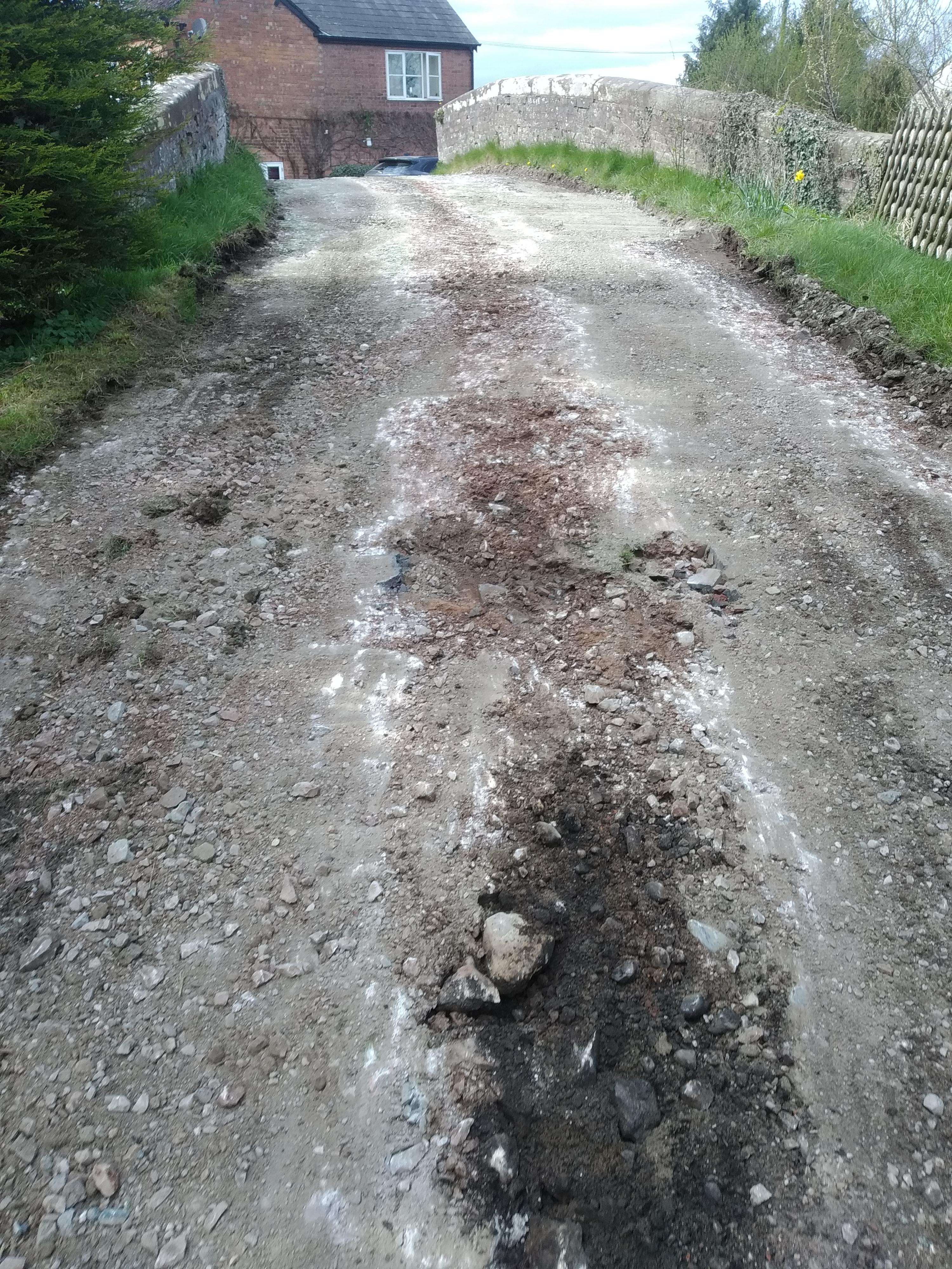

  2. That's a bit of a contentious issue. Technically 5 tonne as we had to have a very expensive heritage assessment done on it and that's what is in all paperwork. I say it technically is as I daily watch agricultural, excavation and other vehicles and farm machinery going to the farm daily that far exceeds 5 tonnes using the bridge despite them having alternative field access and no one bats an eyelid. Neighbours advise they have reported the farm to CRT numerous times being concerned about the weight restrictions (imo it's more likely the noise that bothers them as there are some houses on the lane that are probably sick to the back teeth of them rattling past their window down the narrow lane) and no one has bothered to come back to them. Until it collapses they probably won't do anything! Width, I'm not sure I'd have to measure it.
  3. I can't see this working as where the house is they would have to get to the bridge first which is quite narrow. There is only us and a farm after the bridge and I do think the farm have alternative access but they tend to use the bridge for tractors as the farm fields are notoriously wet. And communicating with CRT - forget it. They are the most awkward, impossible people to deal with.
