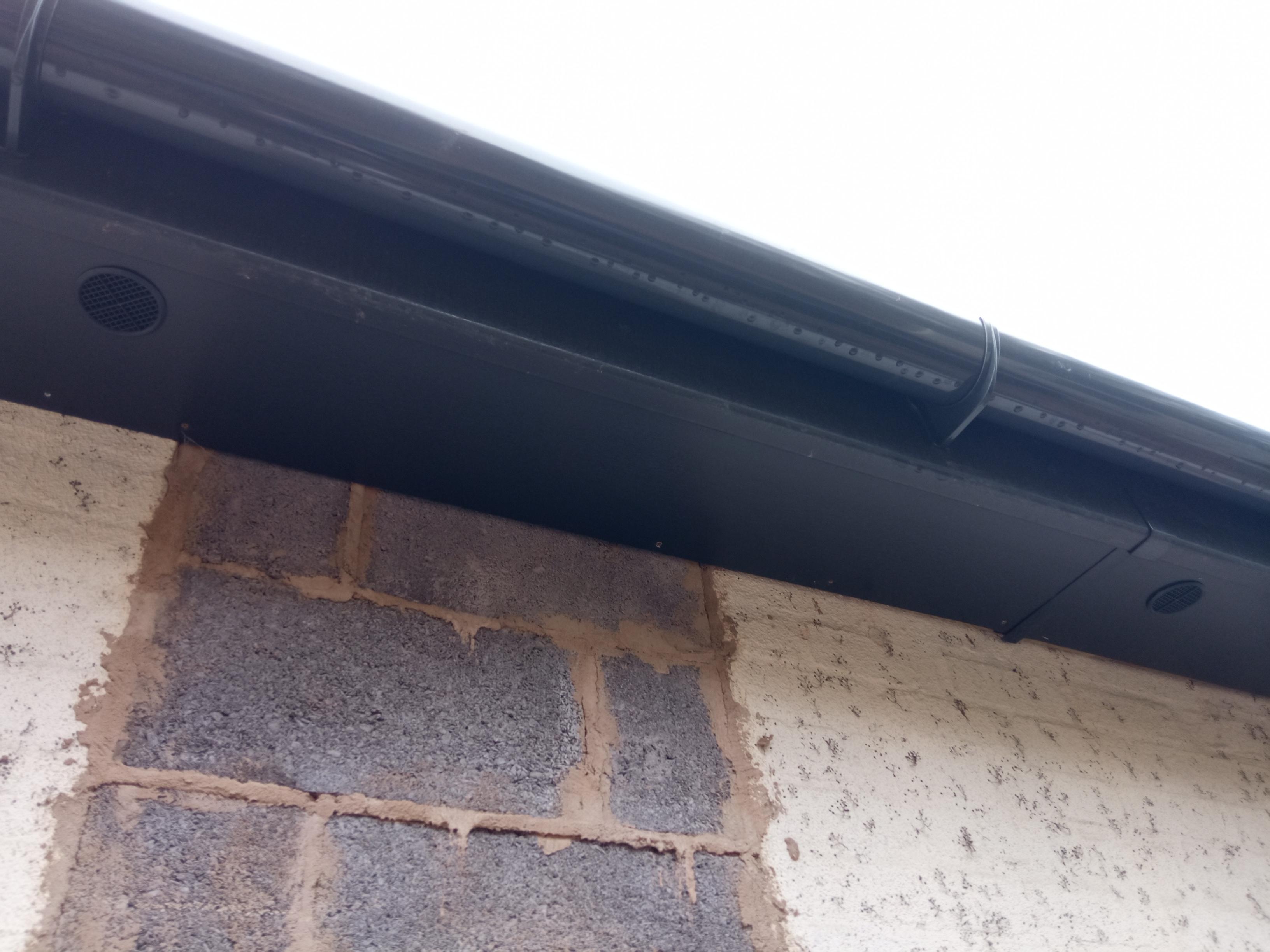

Query on if this is right - Loft Insulation
canalsiderenovation replied to canalsiderenovation's topic in Heat Insulation
Yes sorry they are literally all around the bungalow on the pitched (not on the flat roof part) we now have about 25 of them all evenly spaced. It's not 60cm thought it's more like 120cm. -
So we raised this with the builder and some of these vent things were put in the fascias pretty much a couple of days after this post. Not seen anyone since due to Covid and I've just been up the loft and it's pretty much the same as it was in the first pic with condensation, so around a week ago? Should these have had some impact by now? -

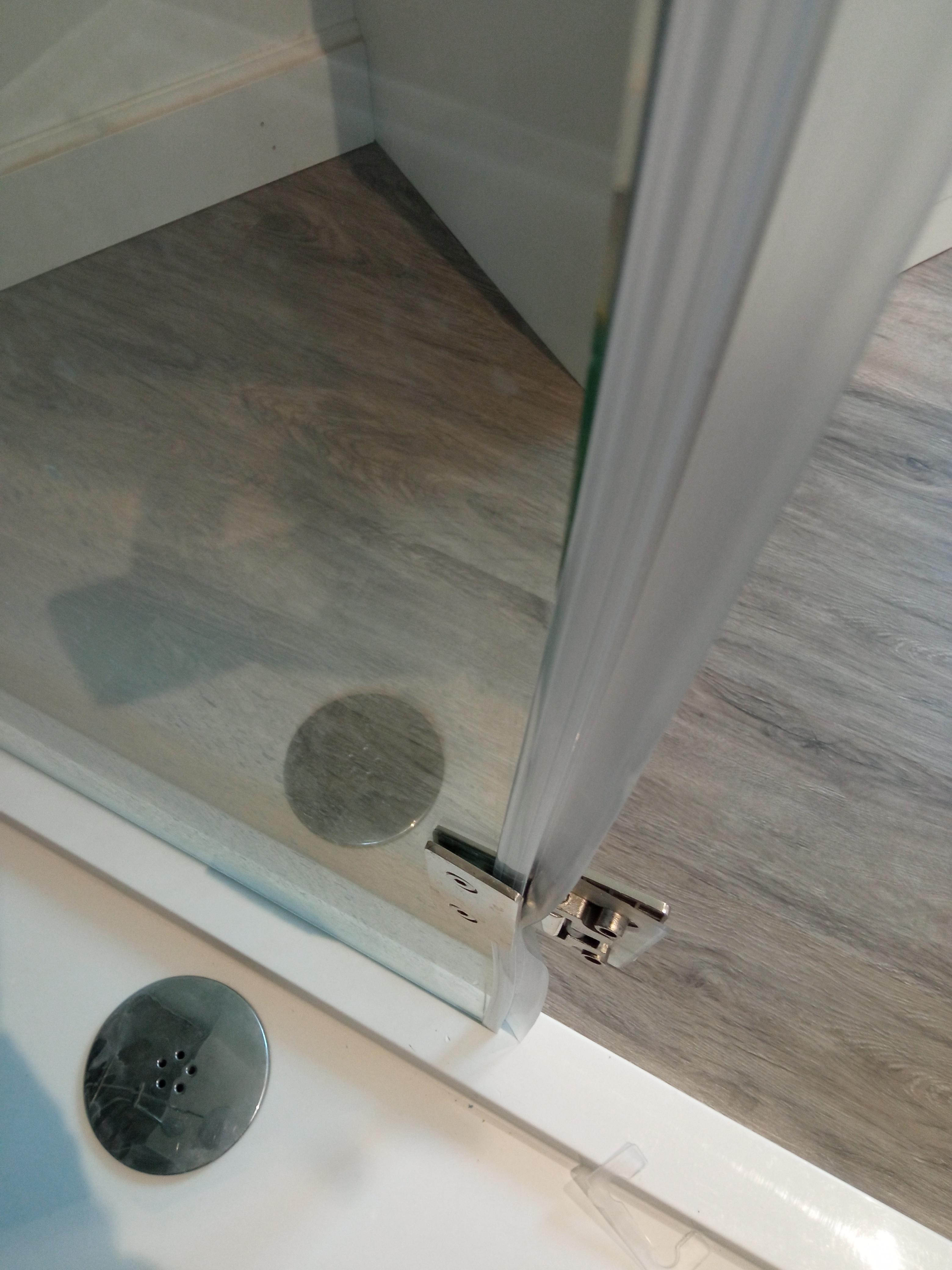

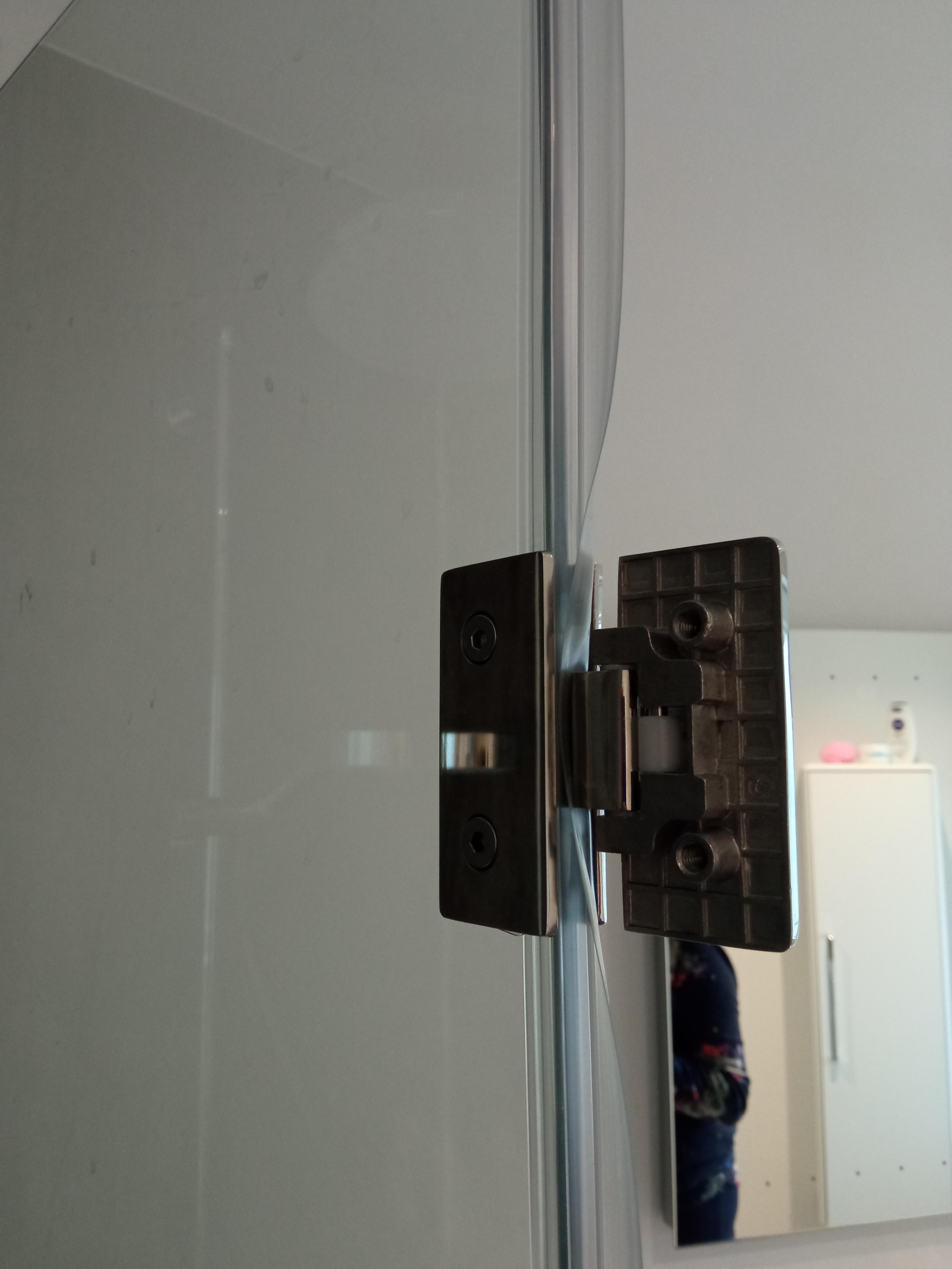

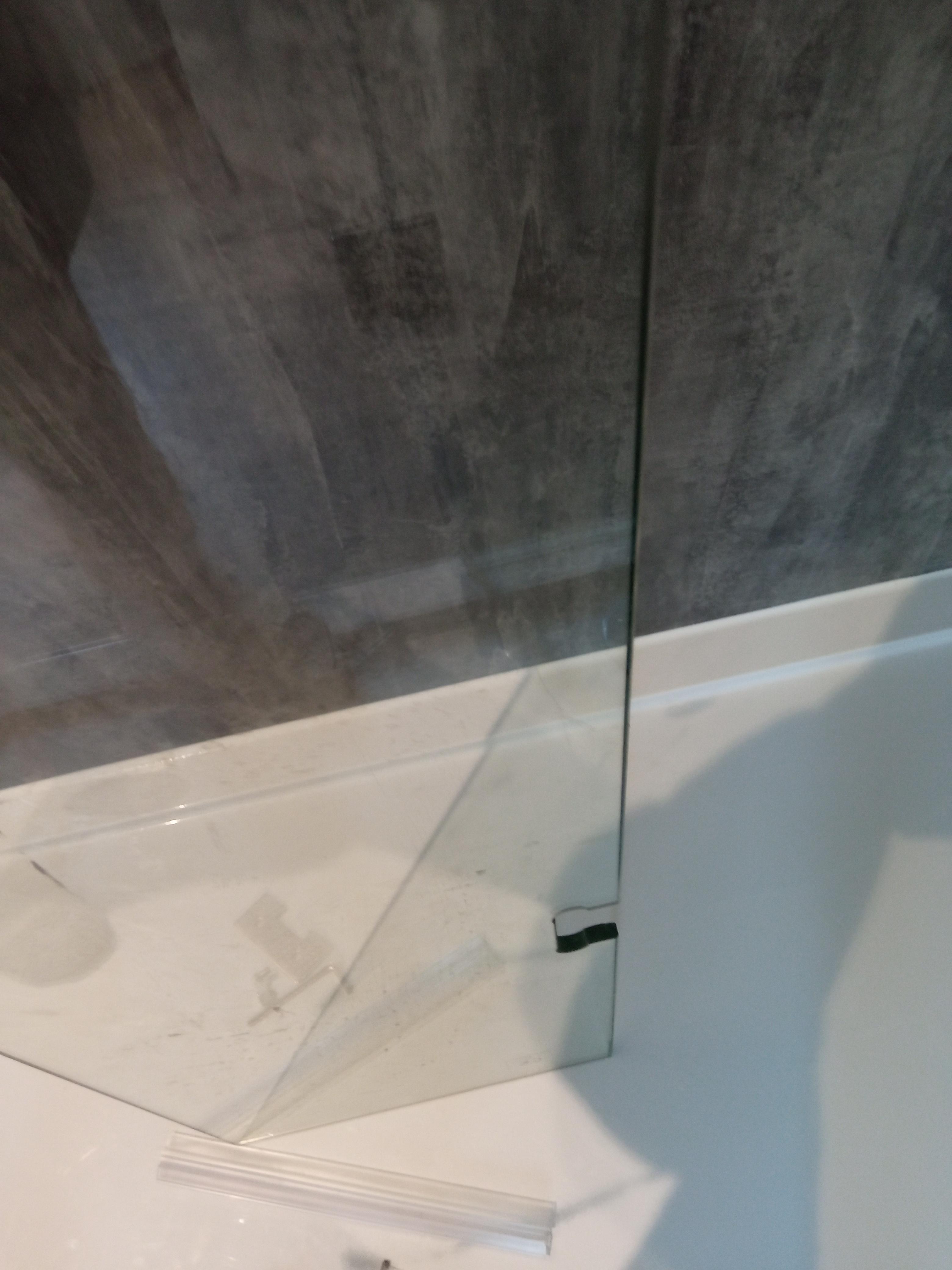

Quick question, just want to fit this flipper panel that the plumber didn't finish and as he had Covid. Can't find the instructions and just need to know what to plastic seal - are you supposed to cut a gap, fit the plastic under the hinges?? Is what he has done so far right or should he have cut a gap in the plastic seal?
