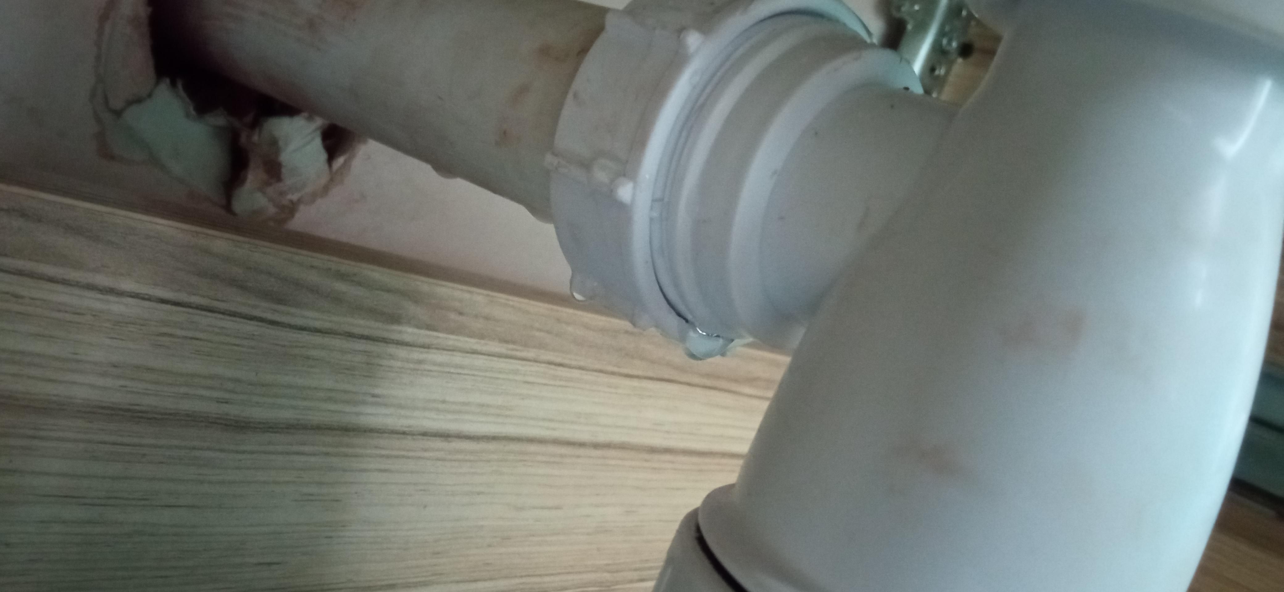

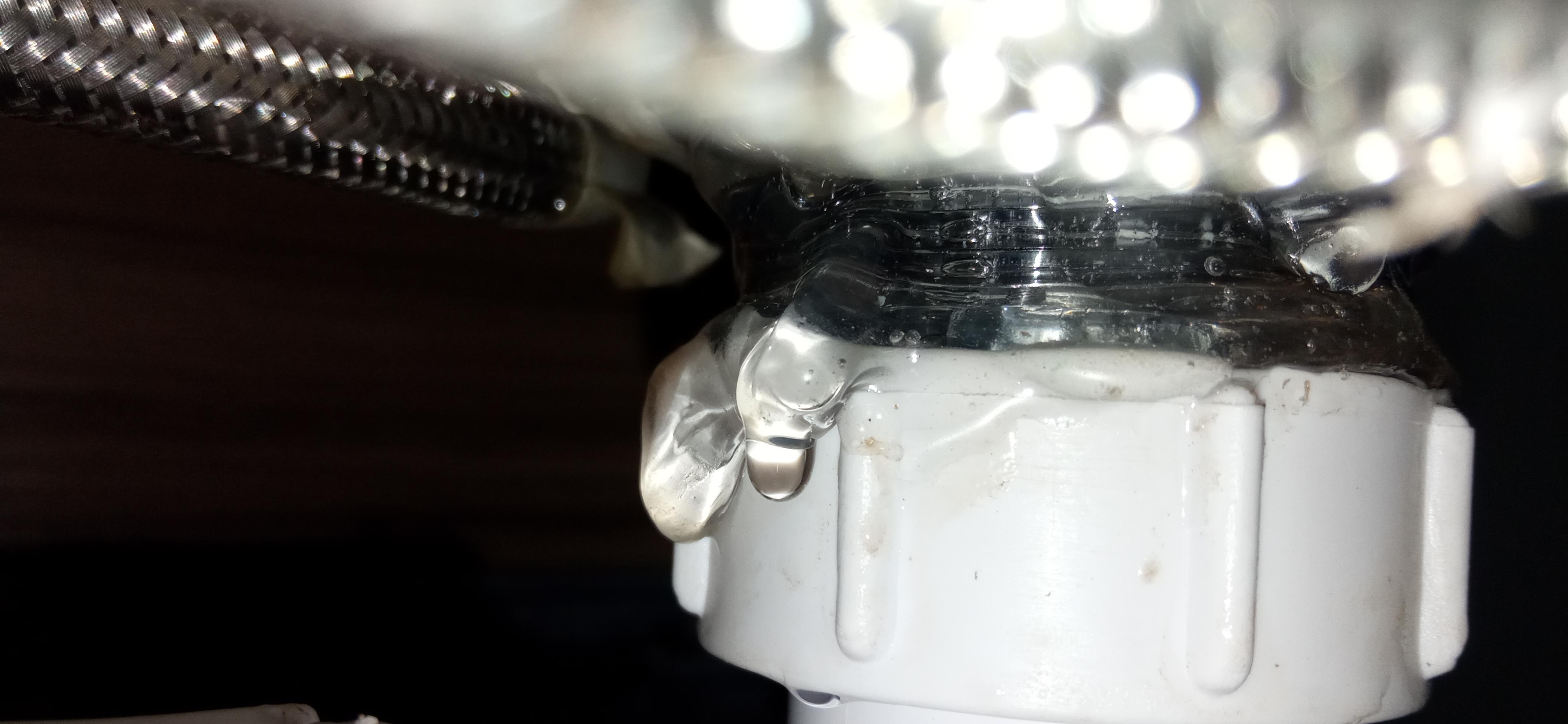

  2. Ok since the new plumber fixed the sink leak, he's been back twice. Once we noticed it dripping and he tightened everything again, fine for a week and then leaking again and he came today and he's replaced the whole trap, plug, checked the waste pipe and resealed it, less than 2 hours later it's leaking again. He seems completely perplexed and is returning again later today again for the third time. We have no idea why it keeps leaking. Does anyone have any clue? Pics and video attached after running water .... VID_20211014_135804.mp4

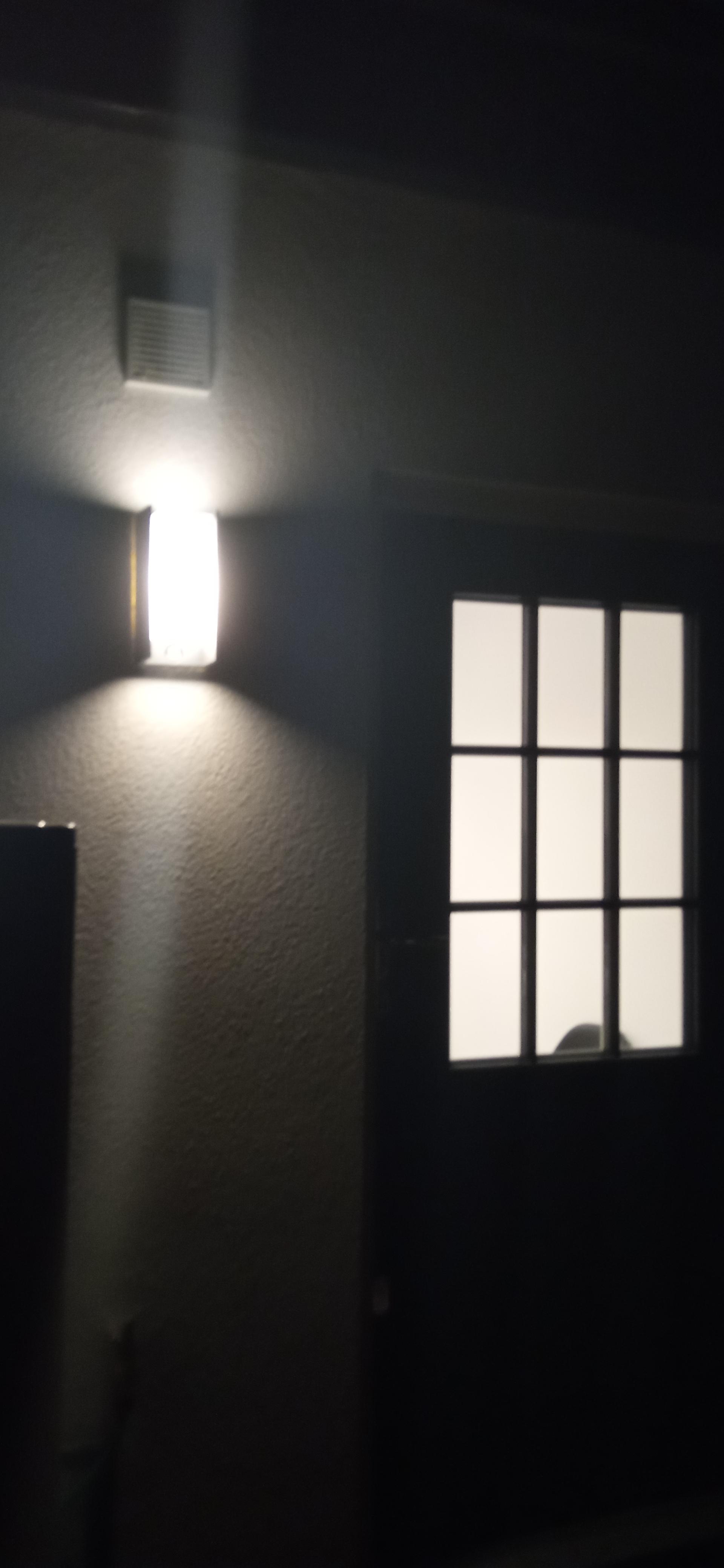

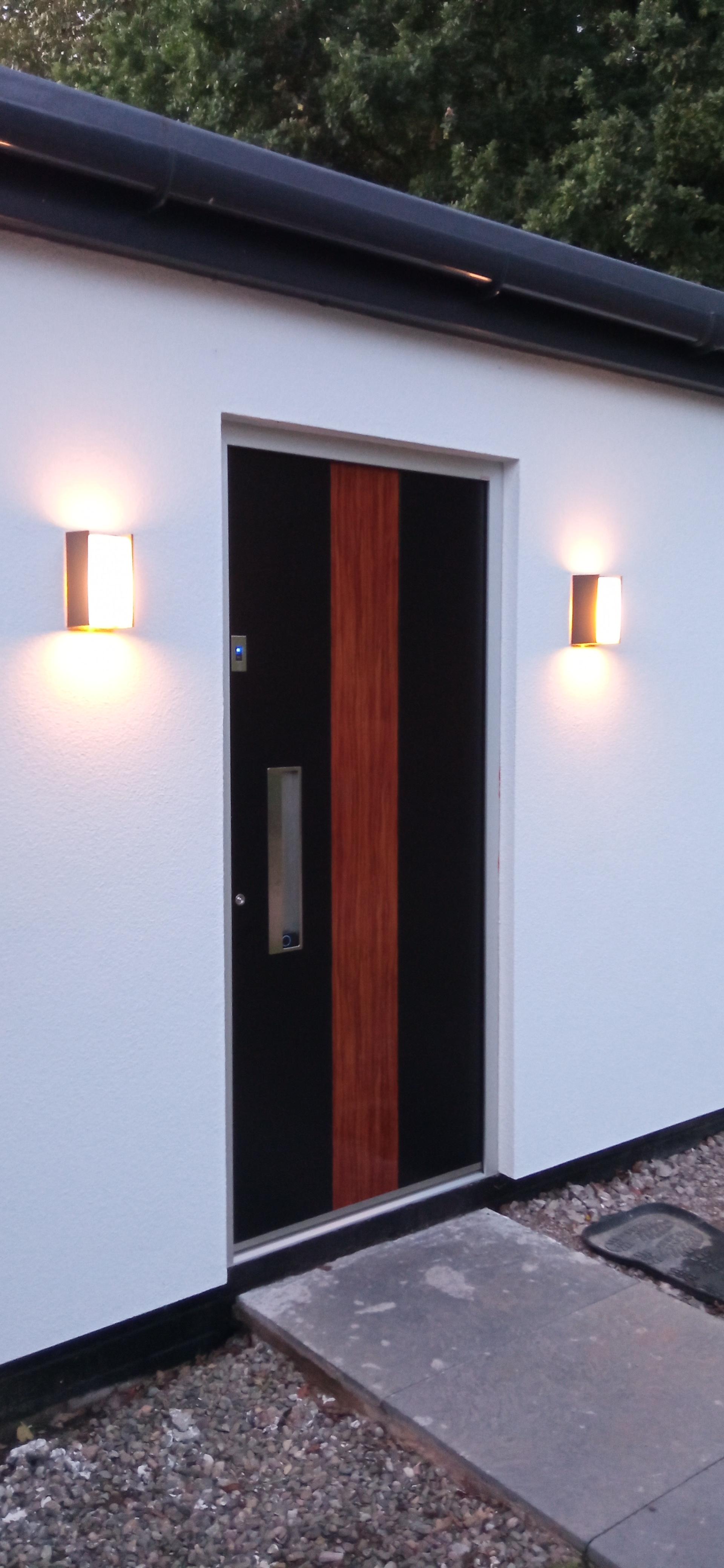

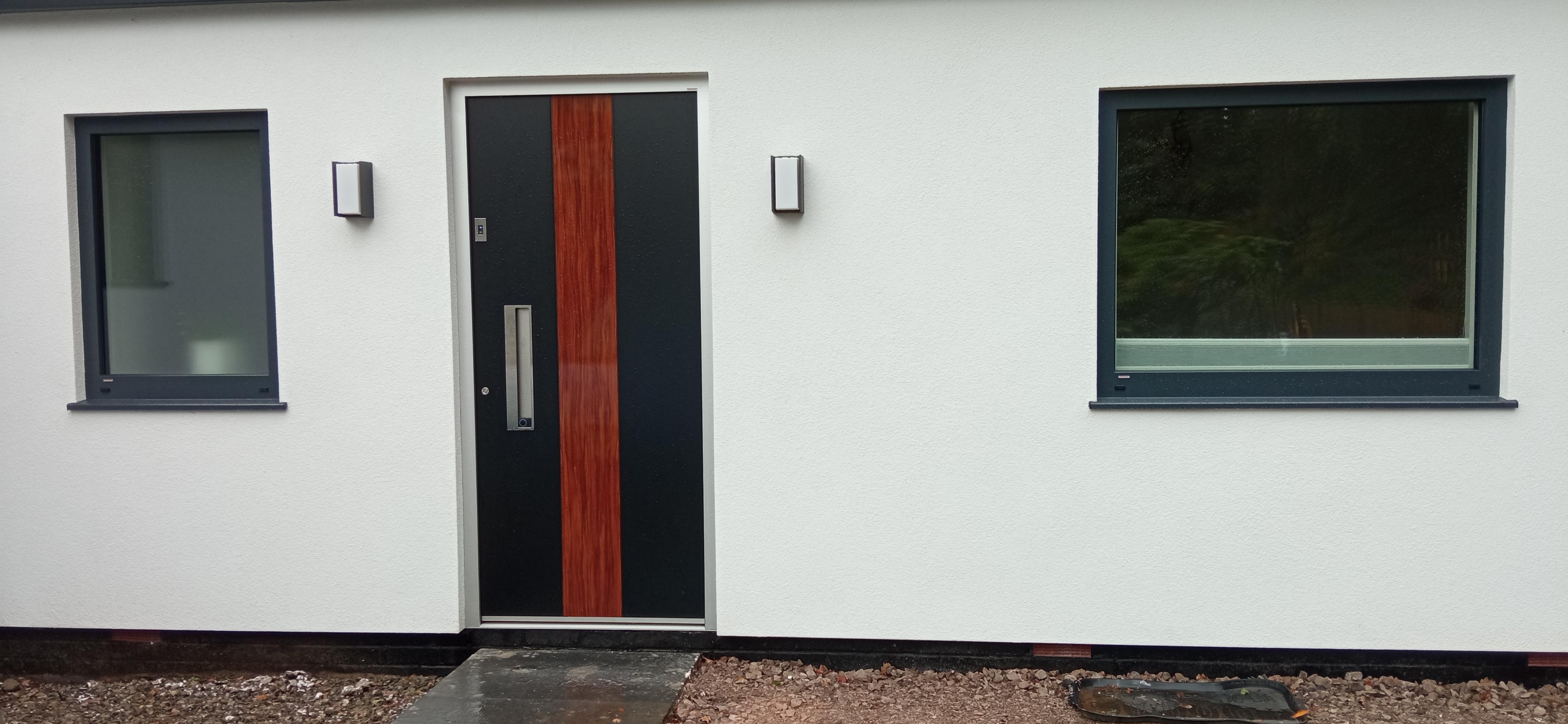

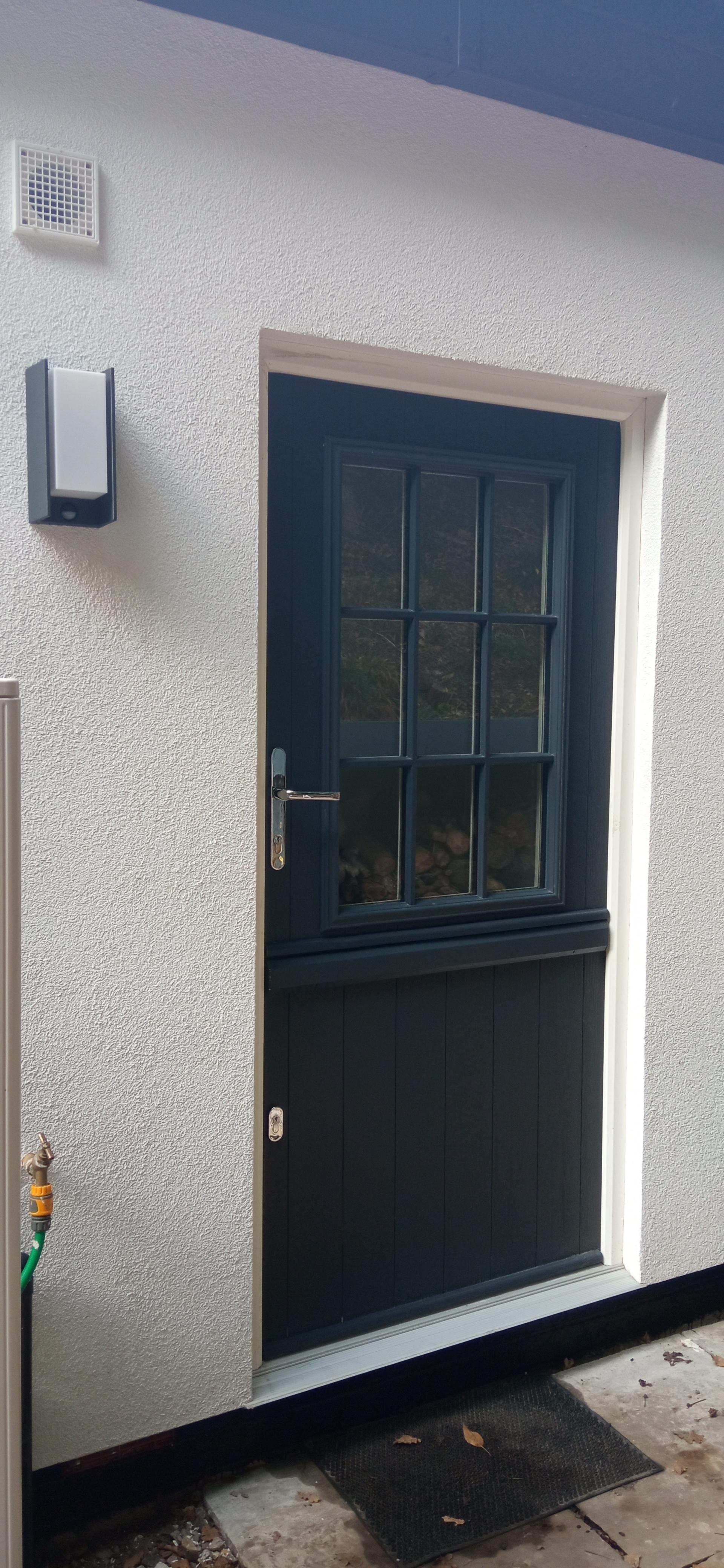

  3. Front door lights now up and look really smart.....

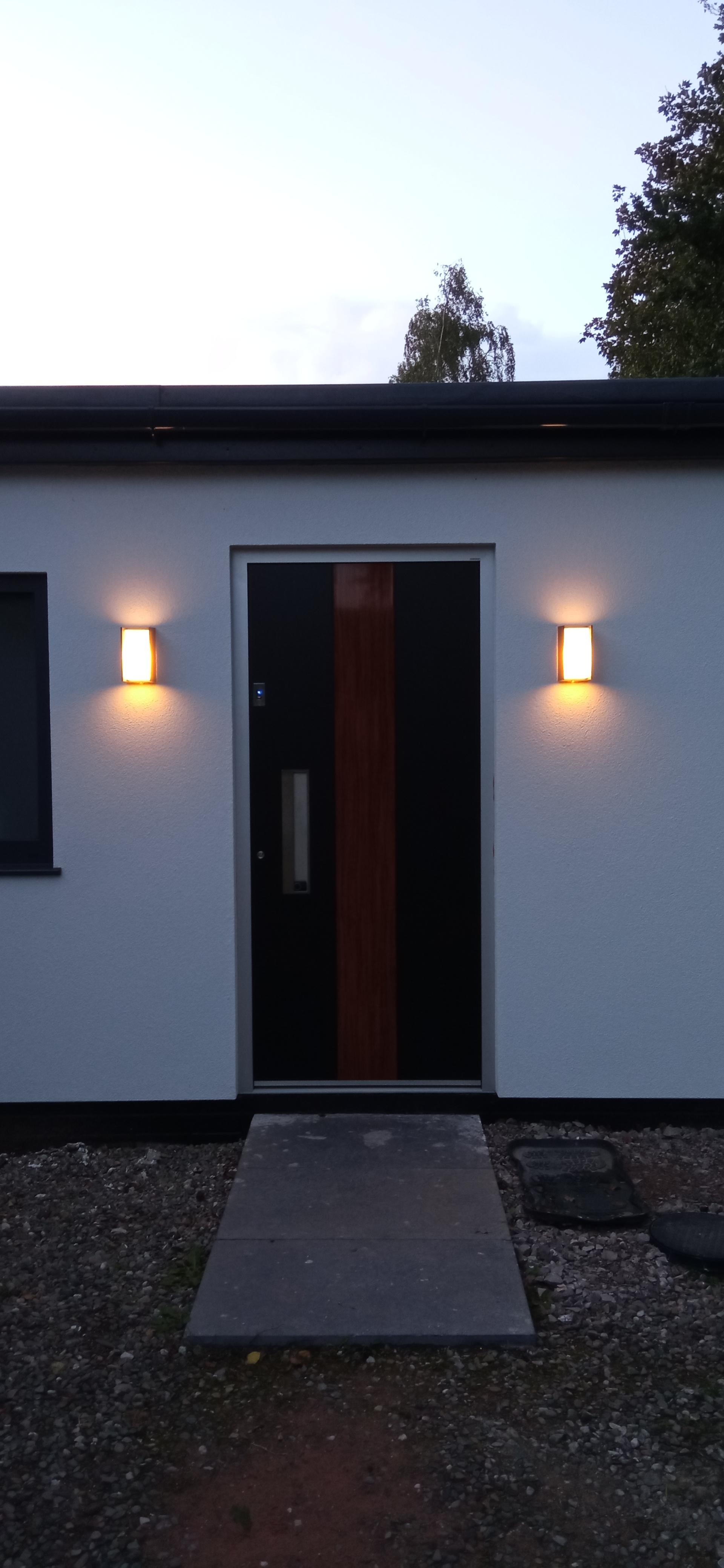

  4. We had a discount code (we ordered them a while ago) and got them from https://www.dmlights.co.uk/philips_mygarden_bridge_anthracite~04XGZ?gclid=Cj0KCQjwqKuKBhCxARIsACf4XuEK7eiH8utwpiu89_rL4VXlQAGKOnpgid3gU8KfqiBZX2qdMdRT4bIaAl0XEALw_wcB They were also on Amazon too which is where I had the sensor one from for else than this but their prices of late shot up. The bulb they come with is the old style E27 bulbs but we replaced them with LED ones. I believe Philips do a newer version called Arbour but these don't have the option to put in a bulb rather a sealed unit but we wanted to have a bulb as it gives us the option of using Hue type bulbs in them at a later date. I'll update when we have the other 5 fitted.

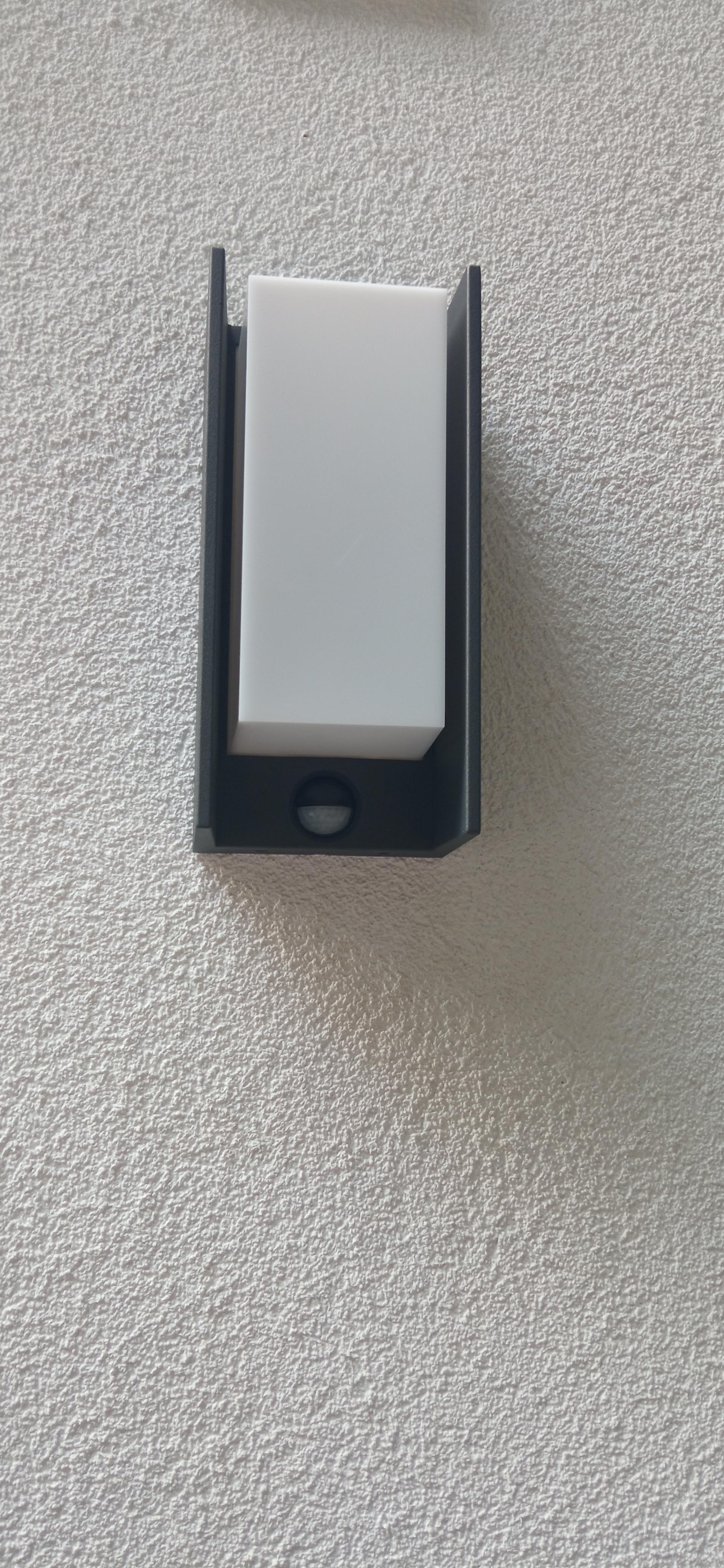

  5. One up! Really impressed with our anthracite Philips lights for outside IP44. This is the version with the built in PIR - the others to be fitted haven't got PIRs built in as they are switched internally. Each has a E27 bulb rather than built in LEDs (we purchased 40w LED ones).

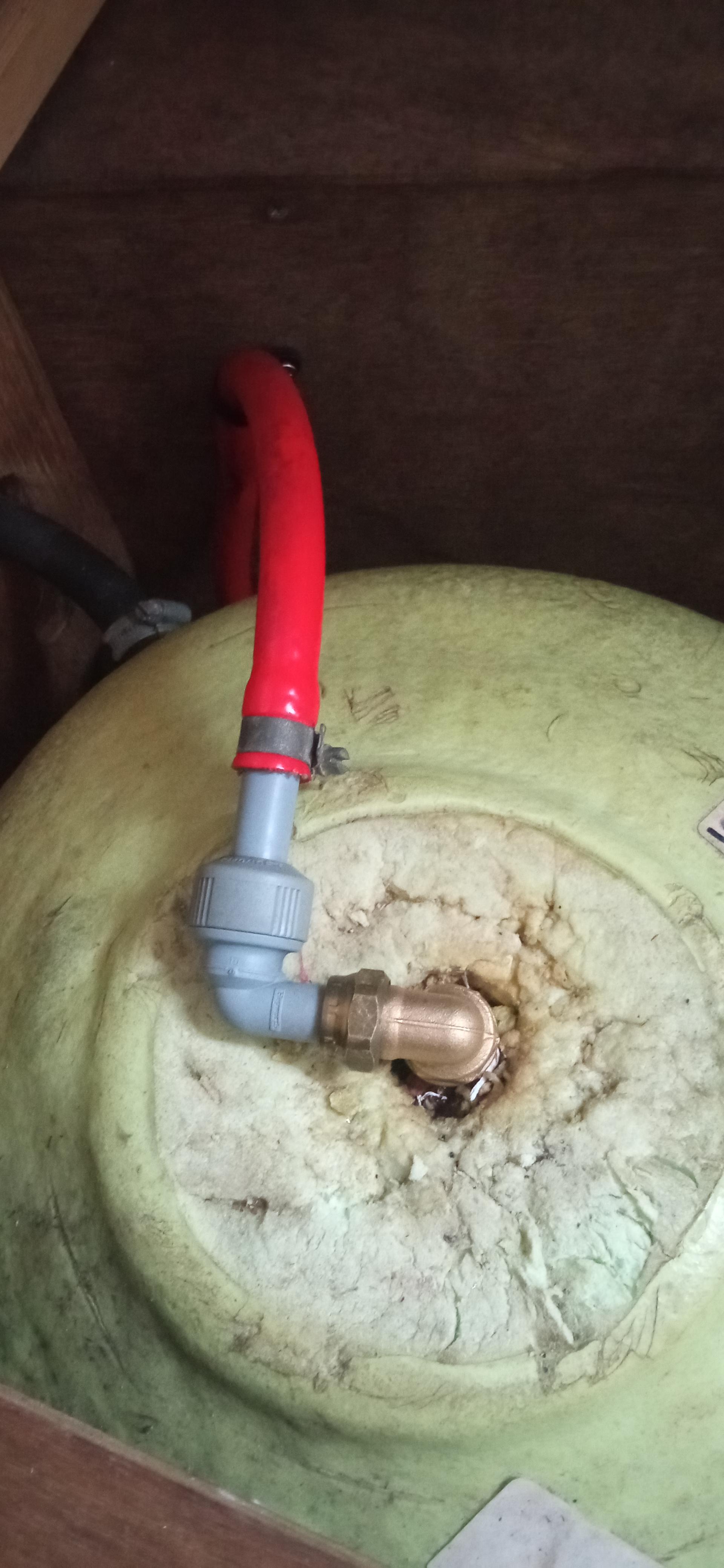

  15. Sorry idiot question but if I put a new 90 degree elbow on like the one you linked how do I take the grey thing further away? I think I understand you, you just mean turn the grey think when it's connected to that new 90 degree brass thing so it isn't sticking up

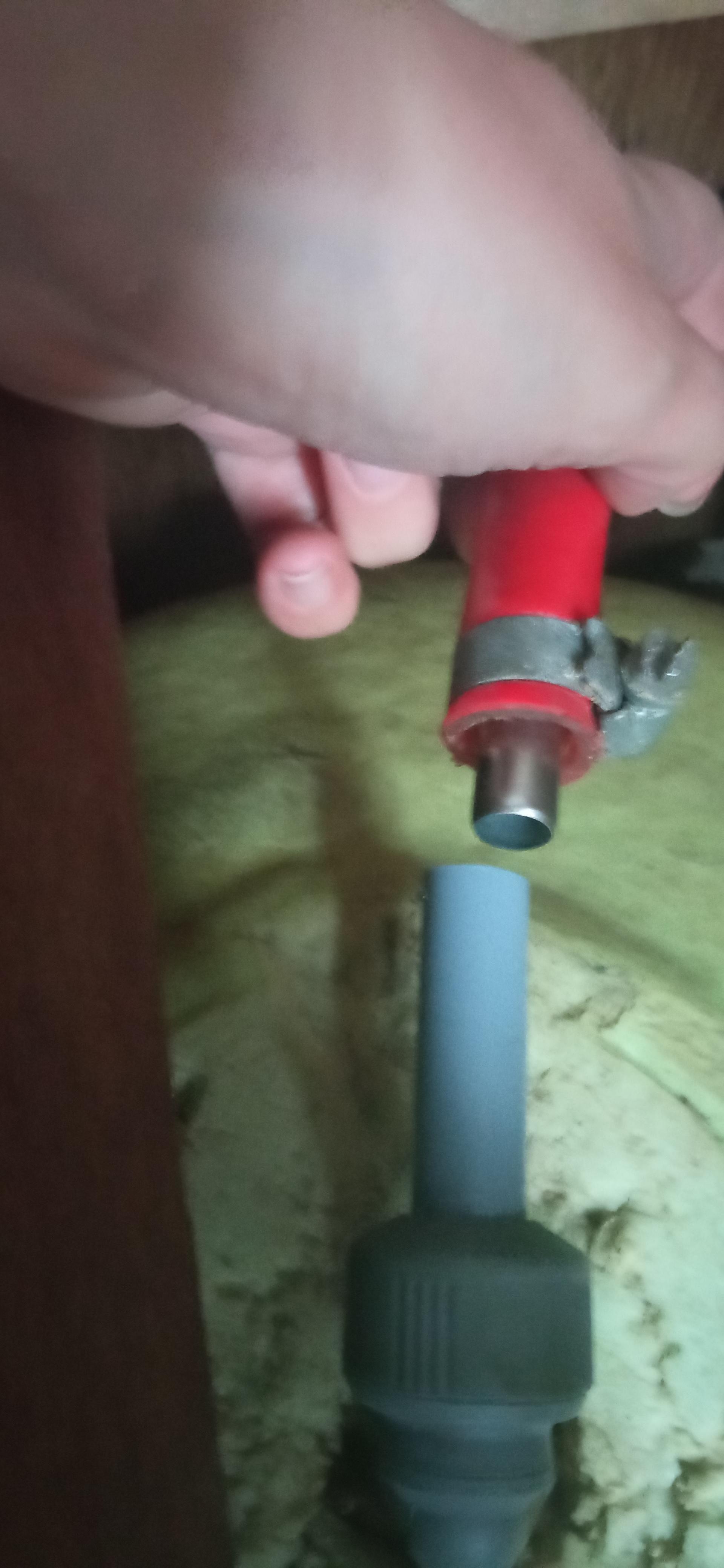

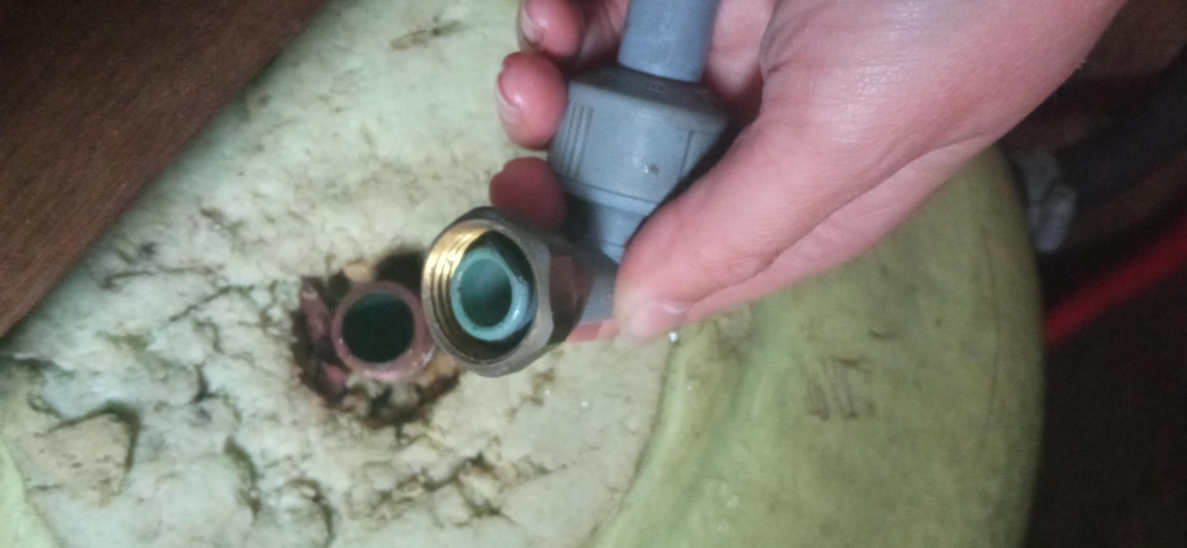

  16. Okey dokey. Here are some pics. The end of the red hose looks like this so I think has the inserts already. When removing the plastic pipe I can't get the brass bit off it as it has a bit of a lip on the plastic thing they fixes onto the tank and even cutting it I don't think would reduce the height much. So cutting it I think wouldn't work. Hmmm, not sure what to do.
  17. Oh no! Hope you feel OK. Thanks for the offer ?
  18. I'll double check tomorrow and see thanks ?
  19. Any idea where I can source these from? I think the best option is going to be cut down the plastic grey bit, new olive and refit and see if that's made it lower. Or alternatively if this doesn't give us the height we need do what @Nickfromwalessuggested and fit an new elbow and move the grey thing further down as well. We made it home safely either way for now so need to do a couple of jobs before our next trip.

  21. Here's a better picture.
  22. A lot of you will know we bought a narrowboat, though this is a plumbing question and hopefully someone can answer as it's not too dissimilar to what's on a property albeit smaller. We had a bit of an incident just now when we couldn't get water - pump working no water from taps. We soon discovered the problem and the red pipe had come off the tank filling up part of the bottom with water (now removed and there was quite a bit)! The jubilee clip was a bit loose but the issue seems to be that this is under the seat area which pulls out to be the bed and the bottom of the bed is almost rubbing along the top of the grey plastic/red pipe which I think has contributed to it coming loose. We ultimately need to make the pipe bit lower as without quite a bit of joinery work to higher the bed/batons though for now we have just tightened the jubilee clips and pushed the pipe on more. Any suggestions please?
