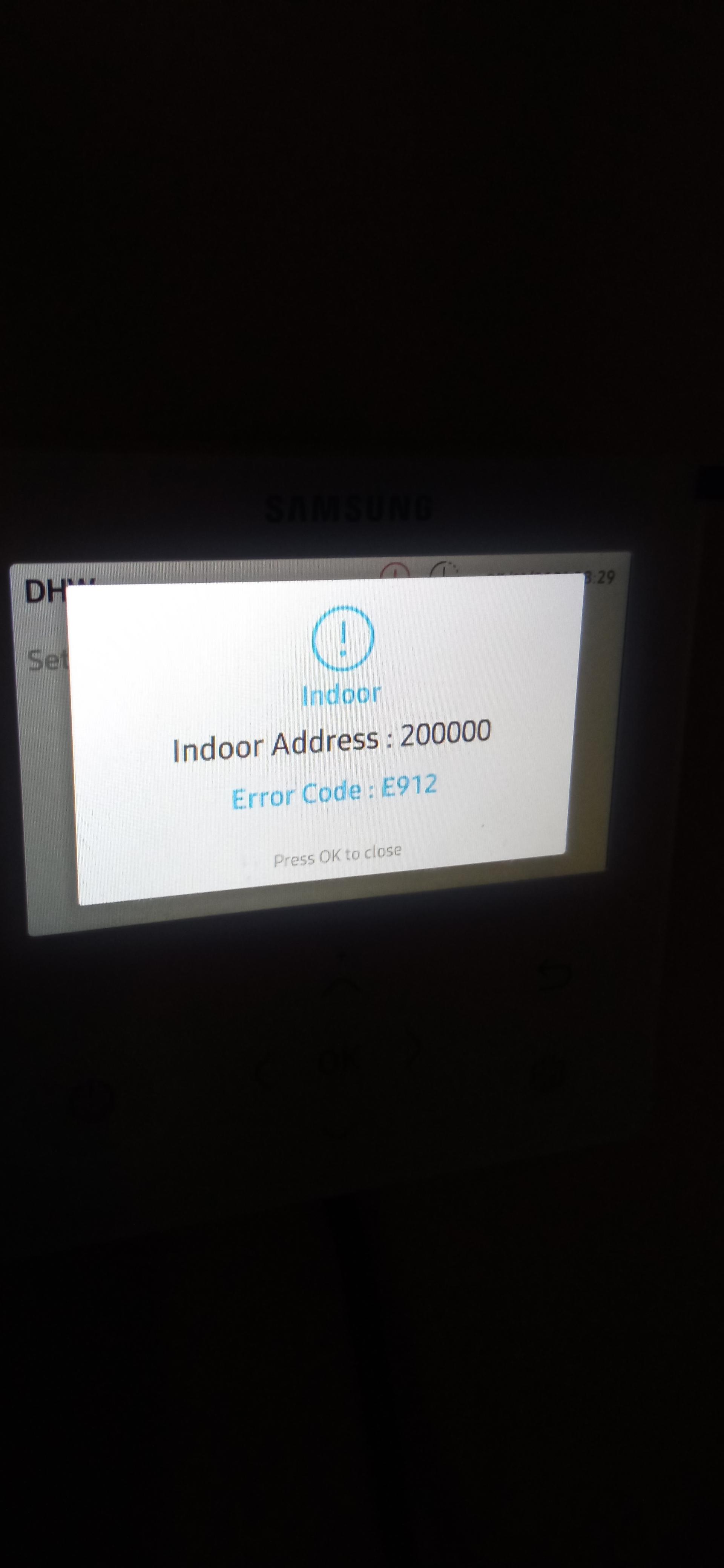

Error code Samsung ASHP
canalsiderenovation replied to canalsiderenovation's topic in Air Source Heat Pumps (ASHP)
Help! Any ideas? I think it's something to do with flow bur I can't work it out and everything seems to be off.
