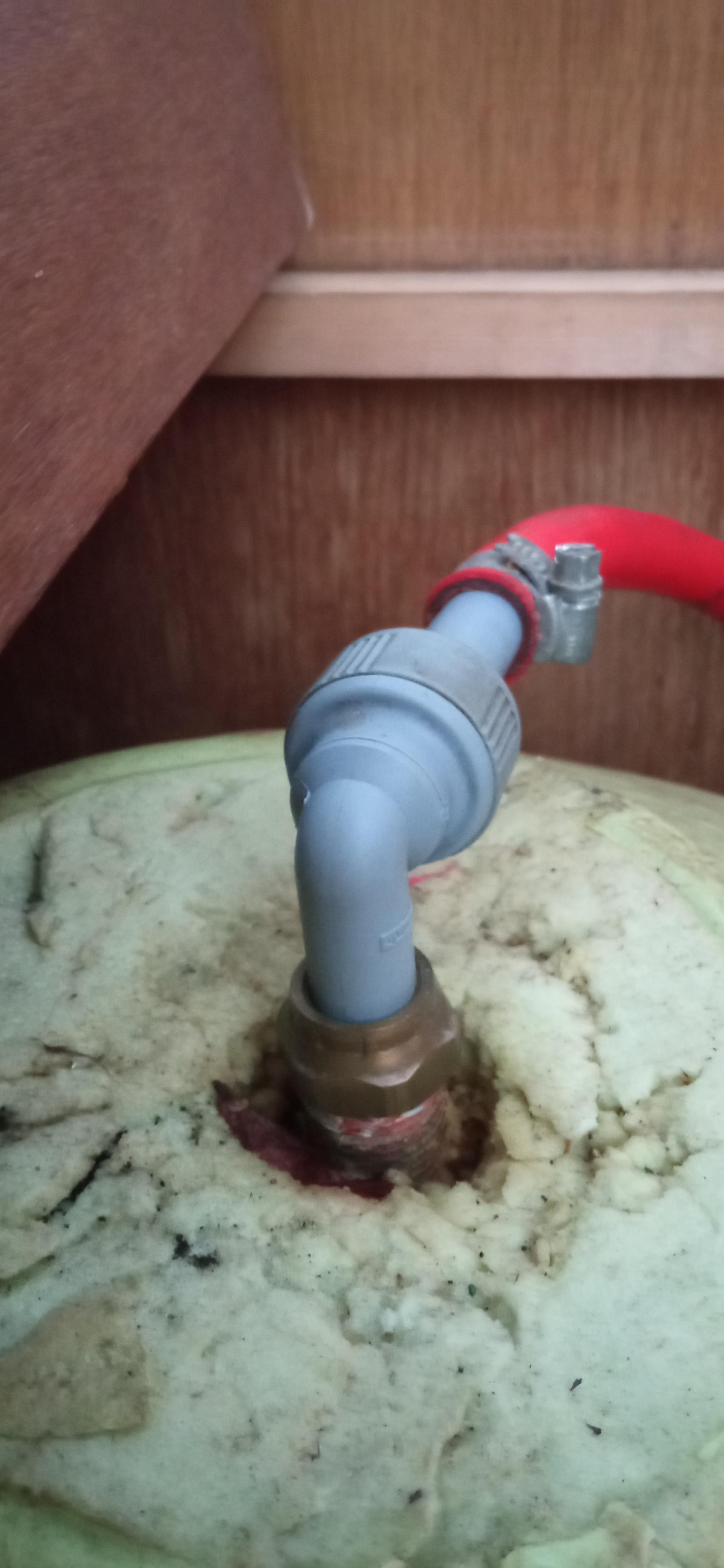

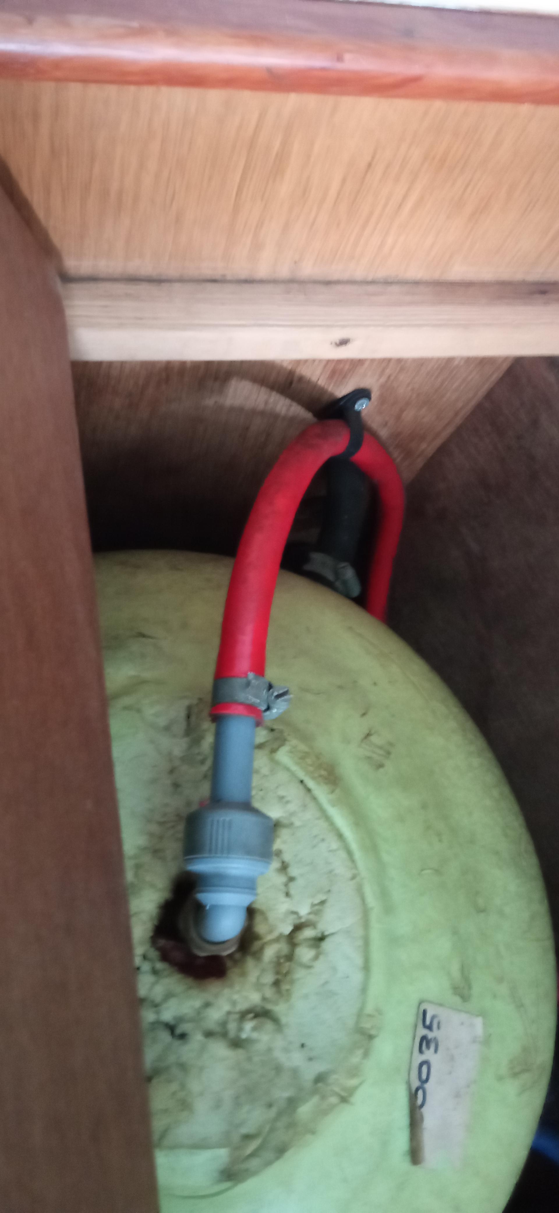

Pipe off hot water tank
canalsiderenovation replied to canalsiderenovation's topic in General Plumbing
A lot of you will know we bought a narrowboat, though this is a plumbing question and hopefully someone can answer as it's not too dissimilar to what's on a property albeit smaller. We had a bit of an incident just now when we couldn't get water - pump working no water from taps. We soon discovered the problem and the red pipe had come off the tank filling up part of the bottom with water (now removed and there was quite a bit)! The jubilee clip was a bit loose but the issue seems to be that this is under the seat area which pulls out to be the bed and the bottom of the bed is almost rubbing along the top of the grey plastic/red pipe which I think has contributed to it coming loose. We ultimately need to make the pipe bit lower as without quite a bit of joinery work to higher the bed/batons though for now we have just tightened the jubilee clips and pushed the pipe on more. Any suggestions please?
