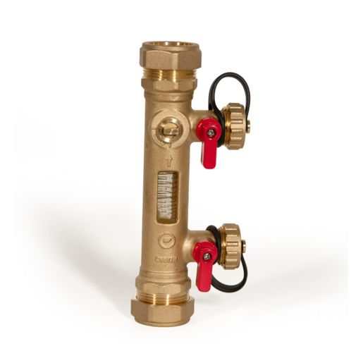

Is there an isolation valve(s) that was turned off during the building work? Sounds a bit like the heating circuit isn't able to dump enough heat and the HP is shutting down. If you could get a flow indicator fitted it would be helpful.
