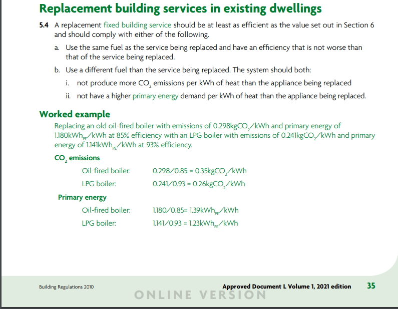

https://assets.publishing.service.gov.uk/government/uploads/system/uploads/attachment_data/file/1133079/Approved_Document_L__Conservation_of_fuel_and_power__Volume_1_Dwellings__2021_edition_incorporating_2023_amendments.pdf

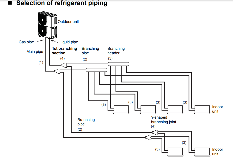

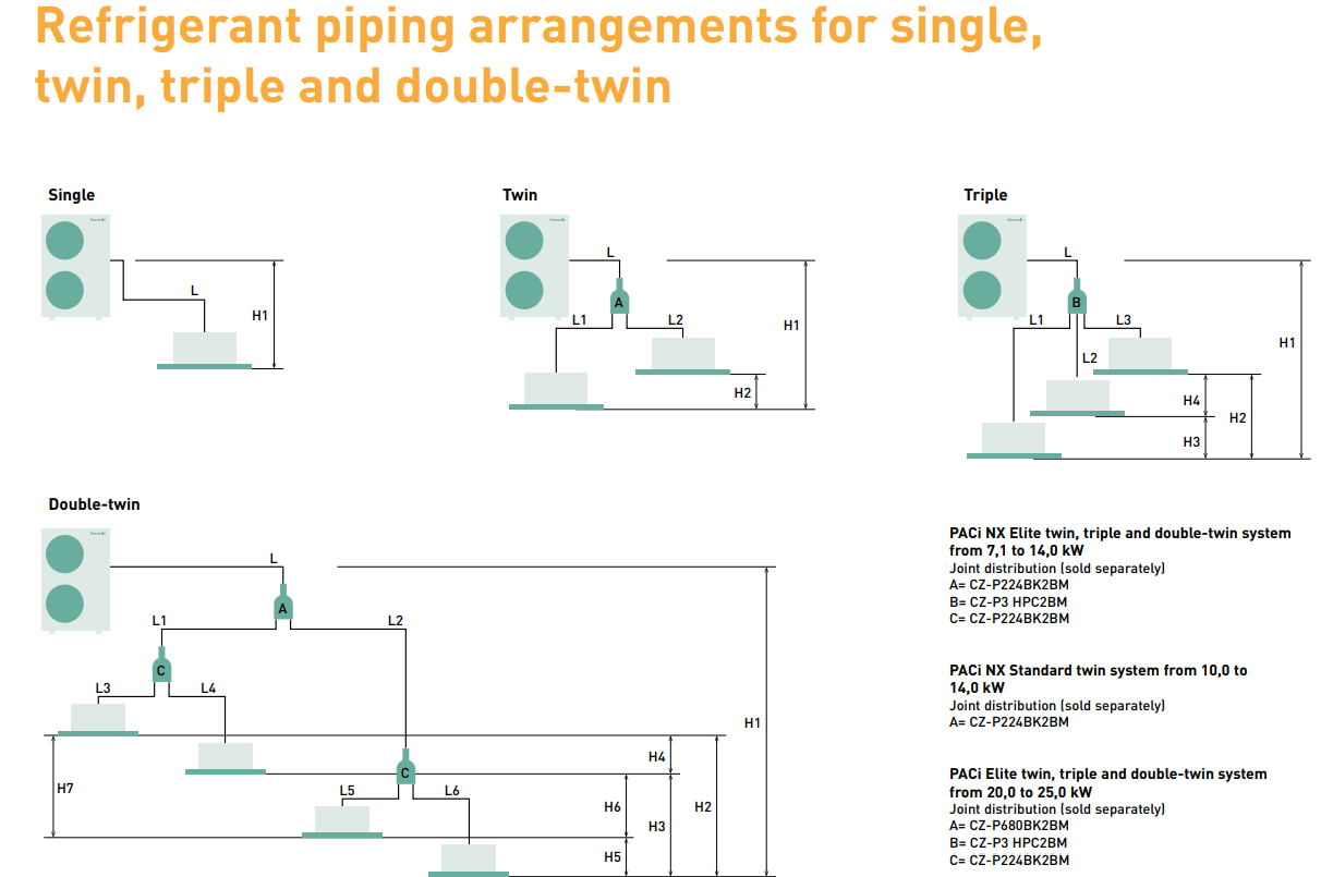

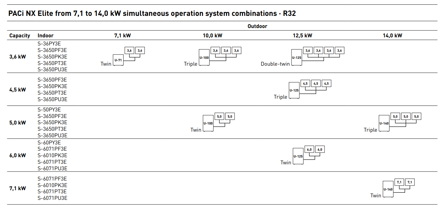

There's multisplit and then there's mini vrf mini vrf units.pdfmini vrf.pdf

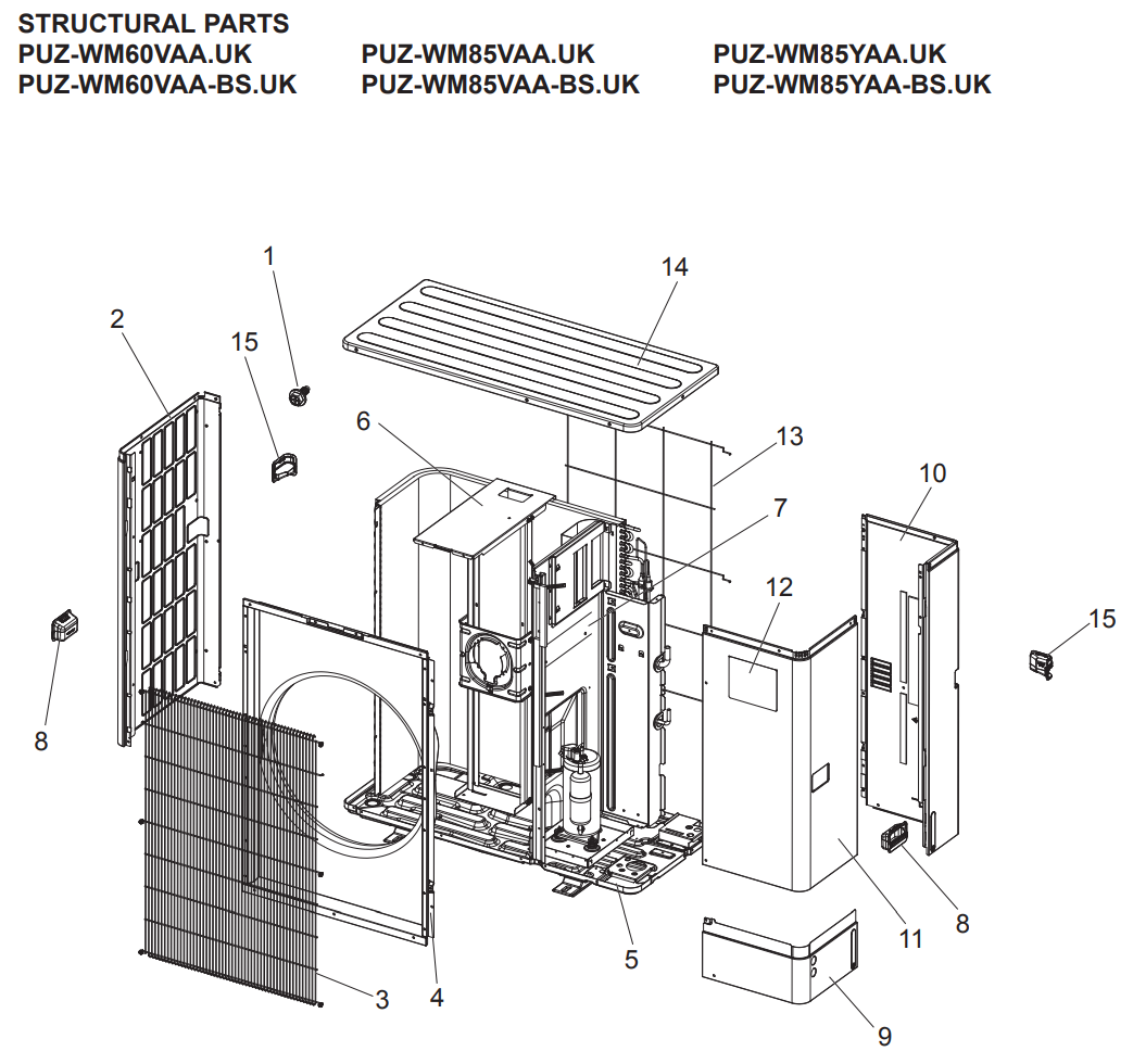

Taking apart an Mitsu Ecodan ASHP (to paint it)
DanDee replied to puntloos's topic in Air Source Heat Pumps (ASHP)
Arotherm Plus ASHP parallel heating?
DanDee replied to vlp2024's topic in Air Source Heat Pumps (ASHP)
I can tell you how to achieve this with any heat pump if: Why do you need this, what is in your mind? -

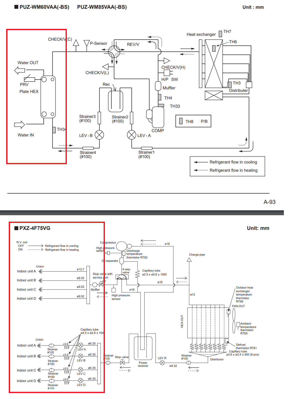

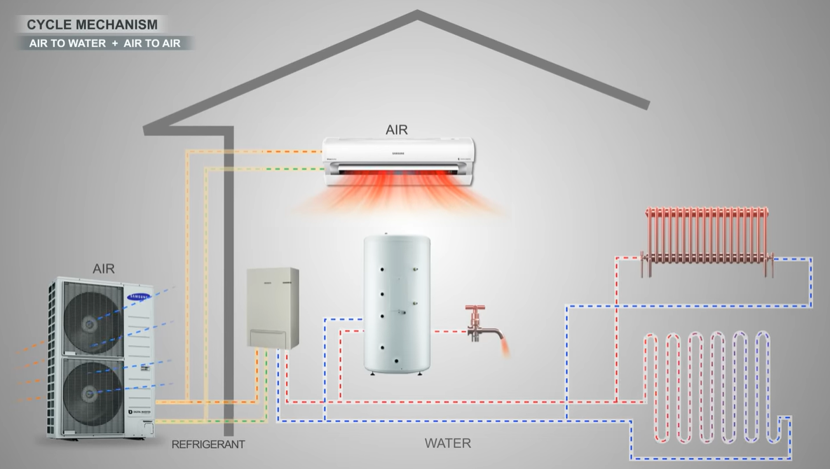

Slightly mad thought about split a2w system
DanDee replied to Beelbeebub's topic in Air Source Heat Pumps (ASHP)
The internal 3kW a/a runs the refrigerant at 35-40C vs 20C indoor air, so dT of 15-20C, the outdoor 3kW unit has a dT of 3-7C, thus the air flow difference between the two would make the indoor unable to harvest the heat. So we a need a split with everything inside with just the evaporator coil+fan outside, but the same coil and fan size like now just in a more compact case(without the compressor and HEX+bits). The GSHP already sits everything inside. https://www.ochsner.com/en/ochsner-products/air-source-heat-pump/ -

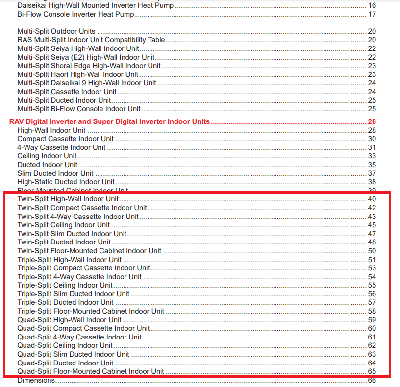

https://www.climamarket.bg/wp-content/uploads/TDB-EHS-TDM-Plus-for-Europe-R410A-50Hz-HP-Ver1.0_170313.pdf
I forgot about the commercial non vrf multi unit split. https://www.toshiba-aircon.co.uk/wp-content/uploads/2022/08/Toshiba-Retail-Price-List-2022-UK-effective-14-March.pdf
