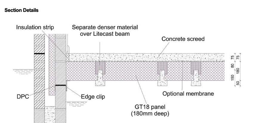

  8. I think that's my preference. My next questions is: would the structural concrete topping be OK to lay the actual floor on then? Do I still need some leveling screed on top? It'll be C30 with some fibres in. Buildup of the floor as provided by Litecast is below (it's a timber frame, so ignore the wall detail). That's 255mm from bottom beam edge, so adding another 50mm of PIR total will be 355mm (without any further leveling screed).
  9. Hello everyone! Due to ground make up, soil investigations, tree roots and cost, we've decided on an insulated block and beam foundation sitting on a concrete ring beam with piles. Litecast (specifically the GT variant) seems to be the best bang for buck, achieving 0.15 W/m²K. The EPS needs a structural concrete topping of 75mm. My question is should we look to run the wet UFH through this, or add another screed topping and have the pipes in that instead? We'll need some self leveling screed anyway to ensure a flat surface, but is there much difference in placing them in that first level?
