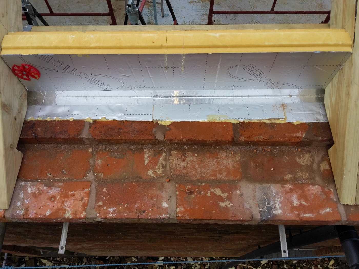

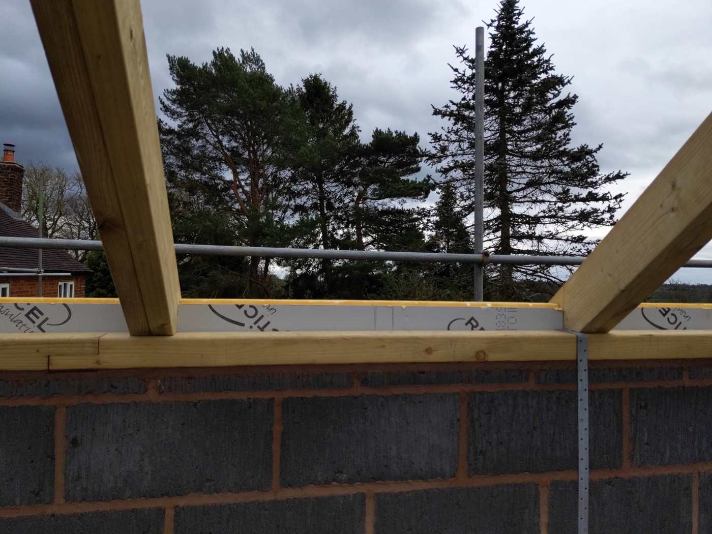

I've managed to get all of the eaves and rafters to play nice with each other. The plane of the battens either meets the edge of the brickwork, or steps in a little. This would work OK for the eaves and first course of plain tiles. A bit late in the game I thought to try and squeeze in an over fascia vent. The vent itself is 25mm tall and if it's fixed to a 19mm batten it creates quite a kick up. I haven't come up with a way to secure the vent to the brickwork without the timber. The gap in the image caused by the kick up looks huge - it's probably 12-15mm. How much kick up is too much?

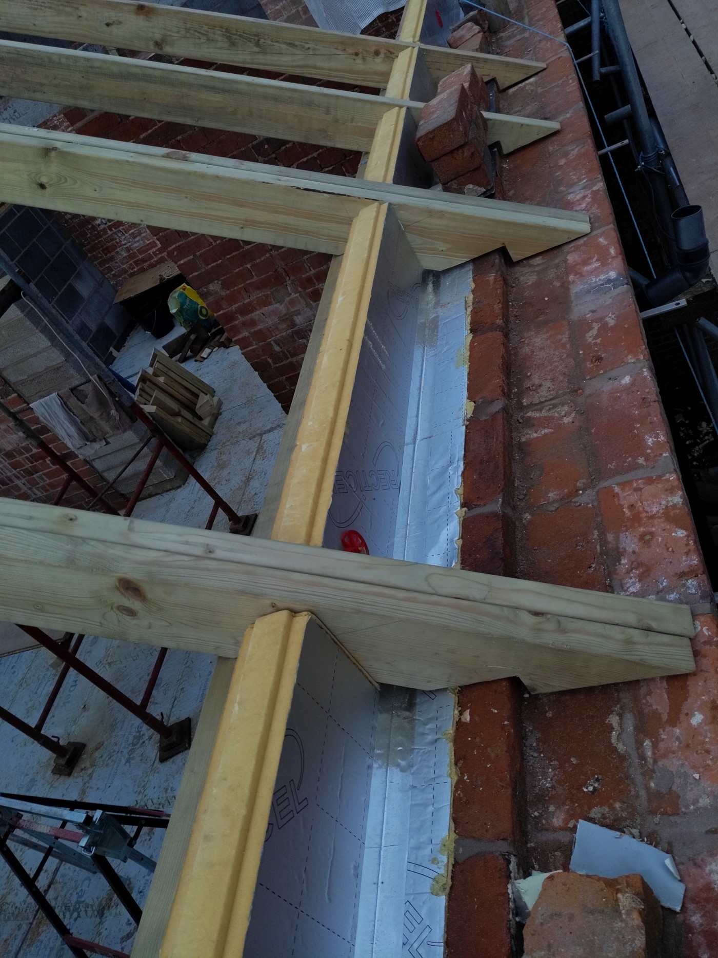

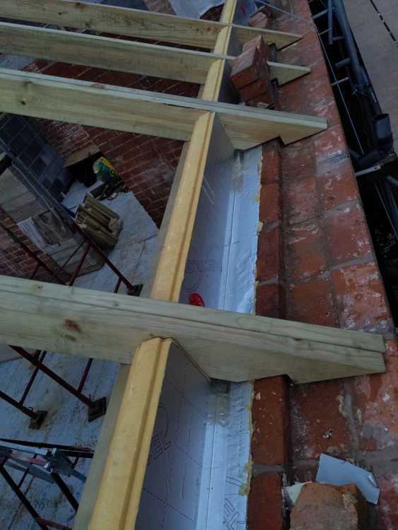

I spent a while experimenting with different things and I've opted for a lump of C16 under at least 2 rafters. A handful of stainless screws and once i've finished cutting the rafters and levelling i'll finally fix with cascamite and screws. The timber adjustment pieces get gradually thinner to follow the adjustment required. This gives me the same birdsmouth cut as the unadjusted rafters, so less mucking about marking and cutting.

Internal walls are in the way for an end to end measurement, but I measured the diagonals of the largest room. It's around 4.5m long and 4-ish-m wide. One diagonal was a good 5cm longer than the other. Argh, that's not how I roll. It would bug me for the rest of my days if I didn't try to level things out Which is preferred - glueing and fixing the shim to the rafter seat or glueing and fixing the shim to the wall plate?
I'm converting an old brick barn. The original walls are all over the place. I have built a new inner leaf following the best line I could. Everything is a work around By the time i've stuck insulation under the rafters I won't see any evidence of rafter adjustments. Would a shim cut from the C16 wall plate offcuts be sufficient? Just cut them to the width of the rafter and glue & nail underneath the seat? I'll check, but the odds are against square.
It's definitely the building being somewhat less than square. The wall plate hasn't budged at all. At the worst point the span is > 75mm less than the opposing side. You would keep the 60mm birds-mouth seat and shim the wall plate height for each affected rafter?

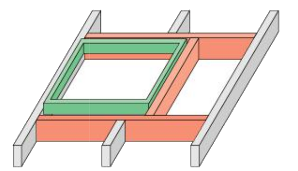

The typical roof window install is cut a rafter, double up the rafter either side of the opening and install double horizontal timbers to carry the cut rafter. Image from Fakro install doc attached. All of the installations I can find show installation in the middle of a roof. Our upper story has 1.6m walls. I want to install the window as low as possible, as close to the rafter wall plate as I can. Fitting the lower doubled up horizontal timbers right next to the wall plate takes up space which i'd like to avoid. Anyone installed a roof window low down in a roof, up against a wall plate? -

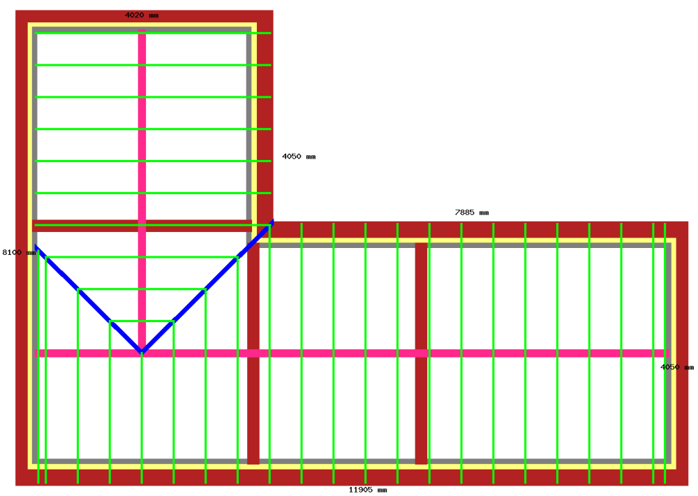

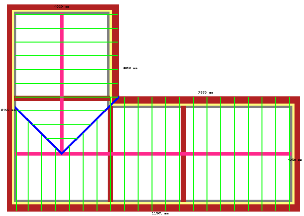

I'm working with timber span tables and using the ".75 but not more than 1kN/m2" column. 600mm spacings are acceptable for the span I have using 44x145 C24. I can get 453mm to work with equidistant spacing, but I still have the irregular valley jacks. We don't have any gable ladders. Just a lump of tile as undercloak and a wet verge. I'm thinking of using a kytun verge when it all goes back on, but with the same 50mm overhang.
I have three gables in my roof, and ridges run from them to a pair of valleys. I'm playing around with rafter spacing to see what fits. If I try a centre spacing of around 592mm and space off from the gable rafters toward the valley junction, I can get equidistant spacing, but the valley jacks are irregular. If I start from the valley junction and space outward from it, I get regular valley jacks but have additional gable rafters at the ends. Any thoughts/preferences? In the images grey = internal block, yellow = PIR, pink = ridge beams, blue = valley rafters and green is cut rafter. Gable outer walls and internal dividing walls are 9 inches thick, and corbelled eaves extend around 12.5 inches.

Building control need the structural engineer's paperwork and they already provide approved rafter span tables. If I where creating some exotic roof style, then it would be prudent to involve them at an early stage, but this is a simple change that results in better roof insulation. Our BC inspectors have so far been really helpful and very accommodating, especially when making improvements. -

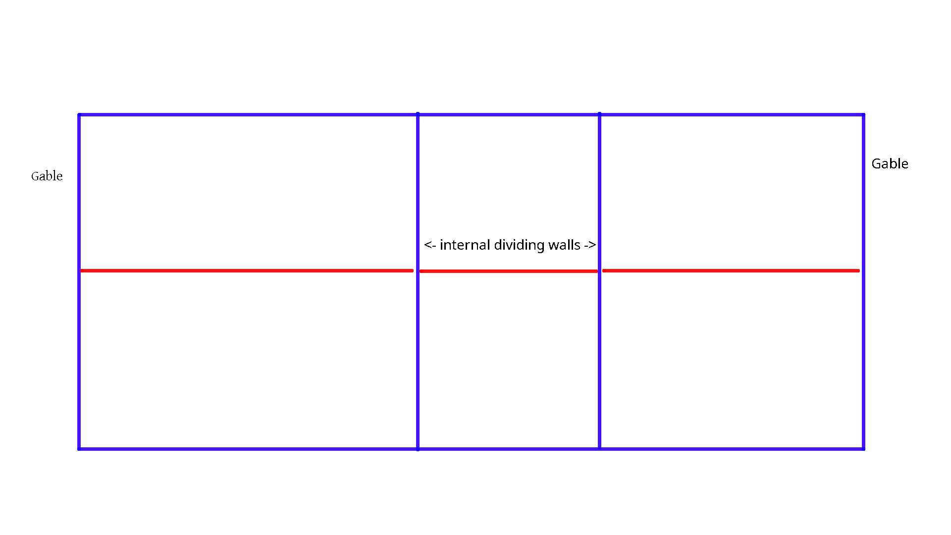

I'm still undecided about the insulation between the rafters. It will be either PIR or mineral wool. I don't mind having to trim odd shapes and sizes. It will be a pain, but in the scheme of things a small job. Roof detail in the plans states "existing", and existing is rather rotted and worm ridden. Took the opportunity to change the roof to ridge beam and vault the lot. Rafter tables suggest we can use any spacing up to 600mm. -
A rough layout of part of our roof is in the attached diagram. A gable at each end with internal dividing walls, with a separate ridge beam for each room. I'm aiming to place insulation between the rafters across the top of the dividing walls. There will be a service gap and counter battening with more insulation below, so rafter spacing doesn't have an effect on plasterboarding etc. I know that the end rafters need to be spaced from the gables with blocking and restraint straps, but i'm unsure what to do spacing wise around the dividing walls? Also, when starting fixing rafters is the best plan to place one at each gable and lay a string between those to get the best line? My plan is to start with an assumed 50mm birds mouth seat with the assumption that I can adjust in-out from 35mm minimum to 1/3 rafter depth maximum.
