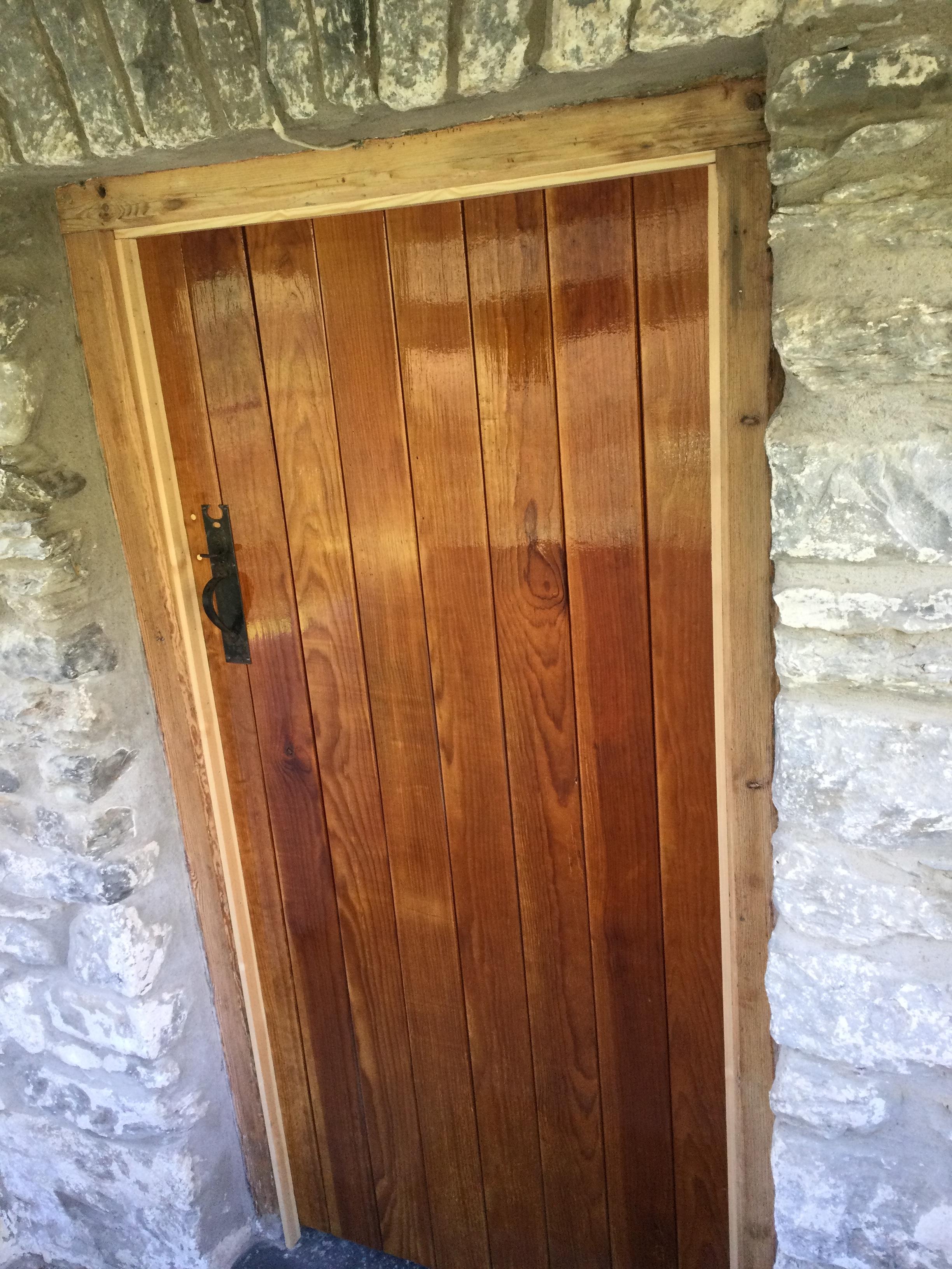

  4. Could someone help on this: the door itself (pic on pg 6) needs restoring, alot of wear marks to face. Its 1980's 25mm t&g, very hard pine. Is it the same idea IE white spirit & wire wool.. or sand the sod? or maybe wool & spirit, then sand? Oddly very little www info or YT clips. thanks zoot

  6. Well that's an idea Id not thought of.. isn't it normal though for front door latch/ knob to be LHS as you look at it? Actually fixing the hinges over on this squiffy side, might be a bloomin 'mare. I had thought of swizzling the door upside down, refitting the latch other side.. but then it wont hit the hinges Im just thinking. Joe do you know if oak plan-ons are a common thing to find in places-?

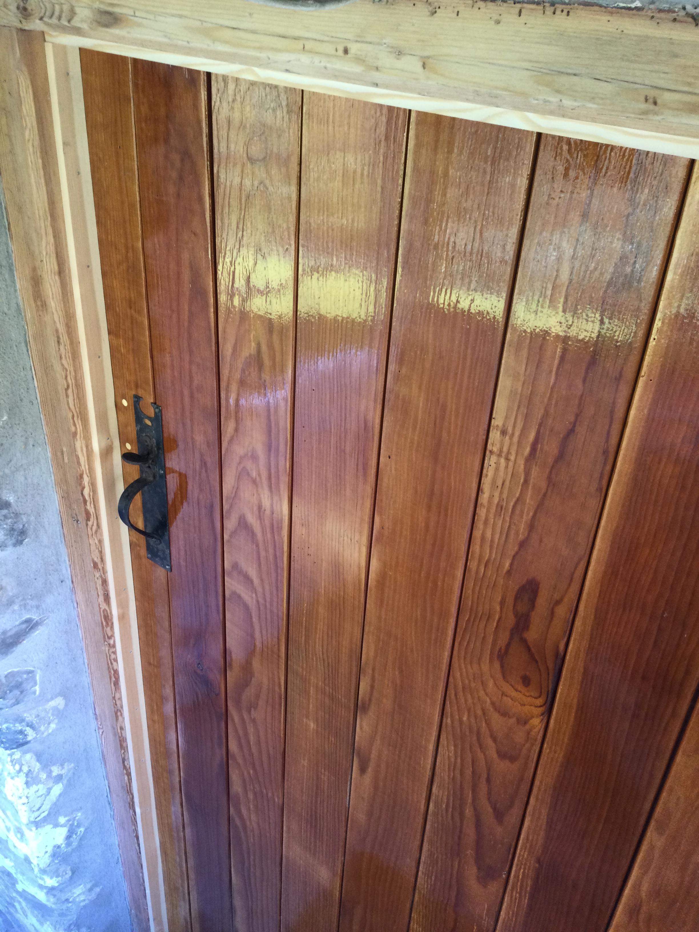

  11. I think Ive done as much as I can, & although flaws galore/ a hole top left, its rotted rhs edge 1 cm all the way down, plus rot at both bottoms of legs.. its just about passable. Well it'll have to be " very characterful".. ie a bit crappy. Shame to add new pse plant-ons on.. but any alternative I wonder? Meths was best. So now its all smooth & as clean as i can get it.. just leave as it is? Or is it worth 1 osmo oil coat? Or furniture polish? Only got enough for 1 osmo coat. thanks zooter.
  12. I recall Im sure we had one in family growing up.. real vintage character. Pitch pine- funny how its 1st time Ive heard of it (Chester Drawers.. a great comedy name too- cant recall where I heard it. fast show?). @Onoff I think the resin thing is ok, sunny porch/ front so might have dried. I do need to replace the plant-ons tho.. the usual pse pine will stick out & lower the standard I'm sure tho. Do you get hardwood maybe oak ones I wonder ?
  13. Well that again fits the bill.. esp being 1830. Tight grains too. I'd pretty much dismissed it as 'boring pine' until markc mentioned 'pitch pine'. I had it in mind to paint over again as I thought well if its just pine/ cannot be much of a looker. So I'll try harder now to get it natural, & hopefully, with a ton more elbow grease.. get it just about presentable 'natural'.
  14. Ok thanks markc got both so will find out. Pitch pine.. interesting, a new pine variety I'd not known of. It seems to fit the bill indeed googling it, seems almost hardwood strong/ I thought it was oak at 1st. shame it isn't. This old frame stands on 2 squares of slate 2" high.. never seen that before, I guess to keep the frame legs off any damp. Didn't work as the inch above has still mostly rotted mind you.
