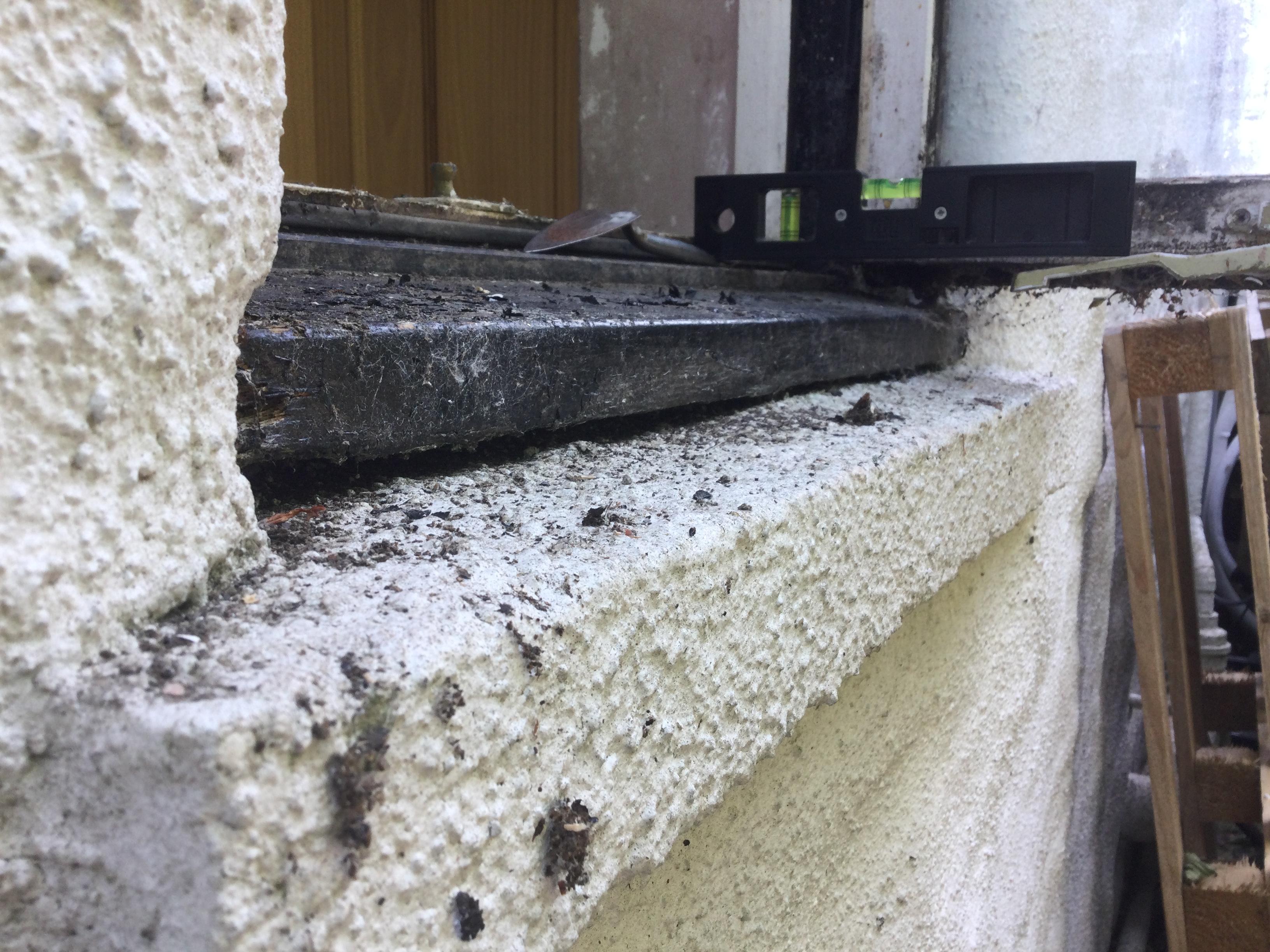

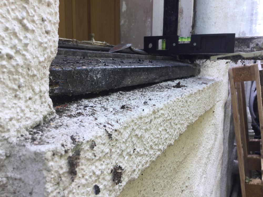

@dpmiller .. so, what Im trying to say is Id think the shape of the concrete sill, matches this example..... https://www.stonecrete-direct.co.uk/type1-stone-slip-window-sill.html?gclid=EAIaIQobChMI2OmTp9P28QIVXxkGAB2D0gkXEAQYAiABEgKPAfD_BwE
Ah ok. Yes there's a small gap just poke a screwdriver into.. so yes it seems the frame sits up, upon a level ridge, 43mm back from the frame sill edge. Frame sits up maybe 10mm up on this concrete level 'shelf'. Then a Good slope to concrete sill. Thx zh
I've dug away @ plaster & measured very accurately the existing frame, including to the underside of its timber sill. It hits bang on.. 47" x 24-1/4". So it seems made in inches, & as its so bang on these figs, unlikely to be a made-to-fit frame Id think.. would anyone concur? Not that it makes much difference, but perhaps the reason why its set so far into the inside plastered reveal.. 3/4" (lhs), and 3/8" (rhs). So to get my new upvc frame dims, 47-1/2" x 25" ?? (I'm sure Co happy with inch figs.. makes more sense to me this way). That equates into atrociousheathen mm's, to an additional: 10mm each side, & 6mm each top & btm. thx zh

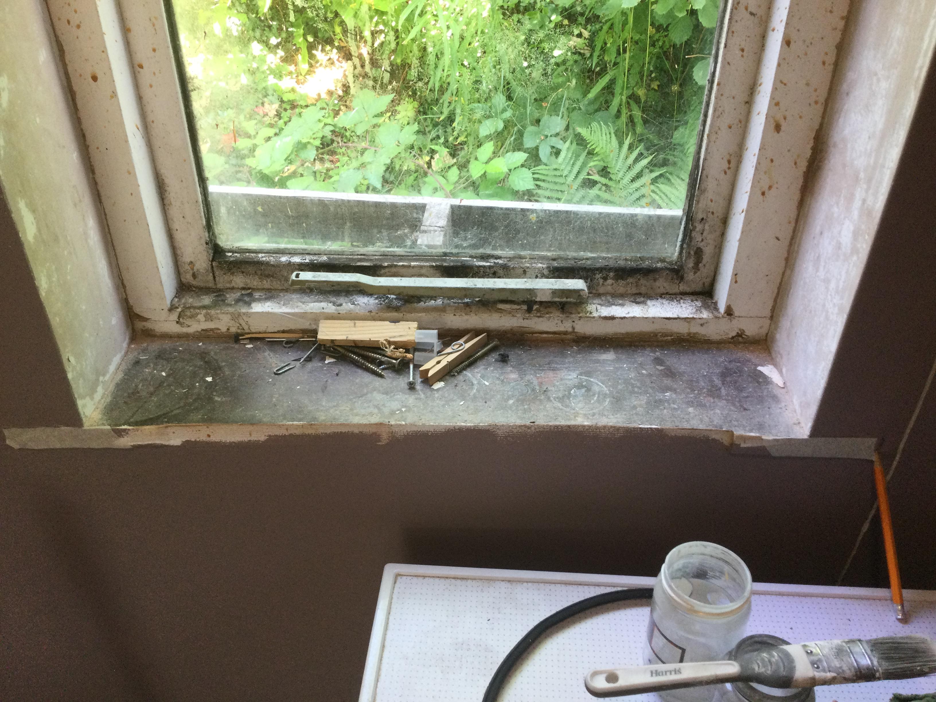

Hi dpm.. Ive googled upstand, but cant quite figure if I have or not.. not quite on board ( again!) but if it refers to inside: If this helps? I have a 1" softwood cill this side, I trimmed flush to the wall.. masking tape to id it. If this wall is tiled for eg (plan is simply a small basin in here, utility room, & a cheap worktop around it & covering the washing machine rhs of basin) then I sppose trying to keep this makes sense, if possible, few tiles ontop of it & reveals maybe..

Hi Joe.. right, got it yes. So my idea of using my timber door cill.. had no merit at all then, was pointless? Or would it still have merit, if it saved me money assuming I might be able to ask the Co if I could not have the upvc cill then. Or is this idea still pointless, because I either must have the upvc cill to do the job, &/ or it inherently fixes to the frame. I dont know Im still a bit lost tbh.
Hang about.. what does a new upvc window actually come with sill wise-? Might the sill be part of what I buy? If so Im stillnot on board with your info tho!
Hi Joe, I'm still not on board. The sill I was referring to, I think I put a pic up, was a door threshold/ sill I have left over ( builder put a slate one in, so this is redundant).. a hardwood type. I was wondering if this could be used, just cut down to a quarter its length or whatever it might be. So the holes thing.. Im not in board with. I think you said it could be used, if, the holes thing was suitable. As usual.. Im totally lost sorry. zh

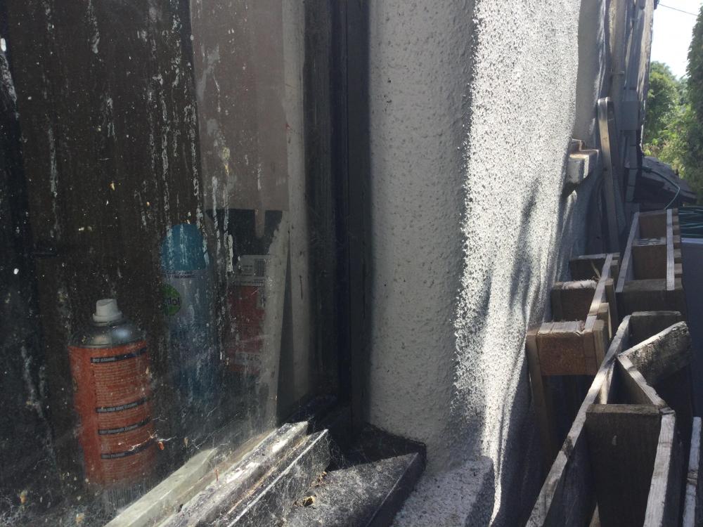

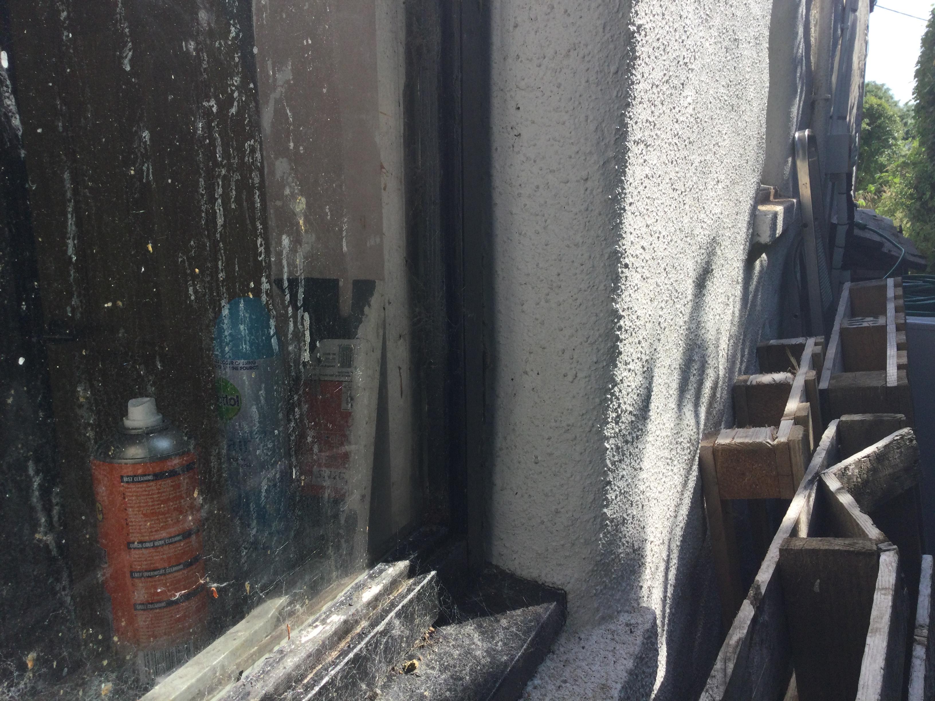

@joe90 you replied with the very info I needed as I was posting the reply above! Ok great.. at last I can move forward, so I'll get the damn thing out from the inside. Right so I'll redo my chip away to find the old frame width plaster side. All the consensus you see was saying its normal to be done form outside you see.. which meant I was stuck. As its only a utility roomthe plastering can be average standard, it's fine in my book. The sill thing though, ie whether my door sill could be cut down & used or not: I cant quite understand your rain run off point though, could you elaborate for me? thanks zoot.
@joe90 joe a few posts back, you said "I'd know which Id prefer to remove" ( referring to me asking whether the window is better replaced from the inside, or the outside: so you were referring specifically to the removal of either inside plaster, or outside render). But I don't know what your answer was. Im trying to figure out now if in lieu of what I mention in the post before this, replacing the window from the inside makes more sense. I just cannot figure this job plan out at all here. Were you thinking of the dust created by saying "..." this maybe? Thx zoot
Hi chaps, I'm really stuck on this. I'm back trying to get a plan on this damn window. But it's not straightforward. The reason: the deep position of my existing frame & the large ammount of render ontop; so to measuring what it is, isn't so easy.. let alone to remove all the render to dig it out, & then to replace it: a daunting prospect for me. This 80's extention replicates the old cottage reveals, by setting them in 5" in you see. If it was set in shallow, say 1" like Onoff's eg, I could chip away & easily find the old frame width, & not worry too much about replacing the render as it doesn't ammount to much. But, here my render's 3/4" deep, ontop of the frame all the way around. So alot of render was applied in this 'outside reveal' to achieve a contoured set-in, 'old' look. Thanks, zoot.

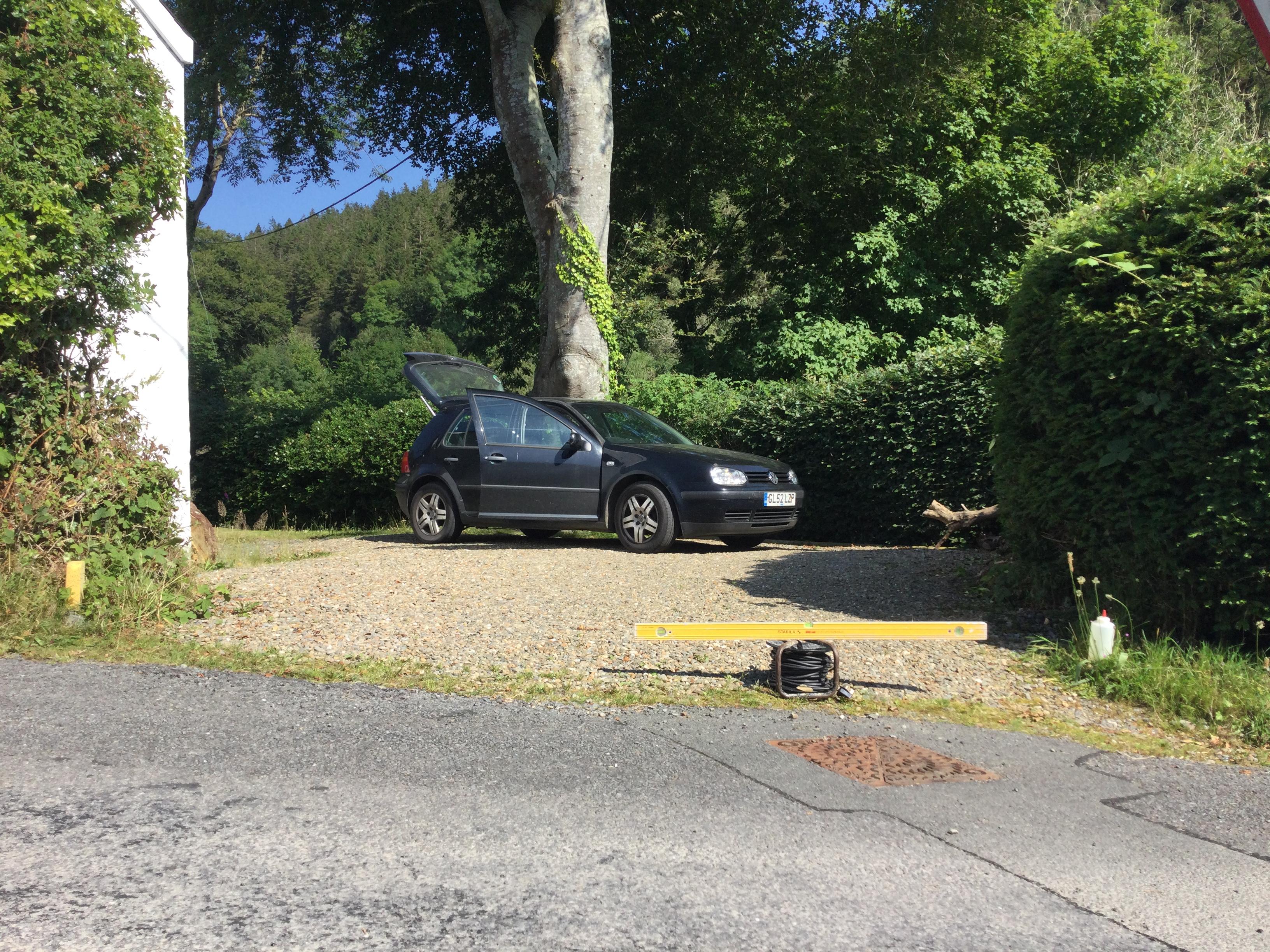

Front view. Between markers = 12 ft. So, Id lose 1 ft if I went 8 ft / 3 ft pair, (although I liked the " 25%" small gate idea like PeterW suggested). As I have to back-in, already often seems a bit tight between my two bushes for some reason on occasions.. constricting to 11 ft would cause problems. So I have no choice than go 6 ft / 6 ft I think. But do I have enough room to put my posts in I wonder?
Hi there joe.. thanks but you wouldn't believe the limited no. of shops we have out here, there wouldn't be one for 100 miles. No unfortunately I have only 1 place/ option here for timber gates, as they'll need to be delivered. Farm place. Ok just been/ they have 6ft gates.. & two will fit perfectly in fact. I think I'll just have to simplify this job by getting these, & hanging straight/ via normal hinges & put up with (or rejig the gates low side) the gap below, or over time maybe fettle the driveway flatter. The tilting hinges.. I just don't like Ive decided: they look too weirdto me. And if one is set 1 ft high anyway due to the lateral slope, then this one doesnt warrant odd hinges anyway. One gate rising weirdly, the other normal? Hmm.. I don't think so.

Hi markc. But how can I forget about the slope l to r? If I put a pair of standard gates in, I'll have a 1 ft gap below the lhs gate. And half a foot gap at the join. I cant see this as being correct. If one purpose of the gates is preventing cats strolling on.. I need them to be fairly decently placed relative to the ground. I mean a 4" gap perhaps. Is this just not possible then? Until I can get my head around this lateral slope, I can't think how a pair of standard gates can be used. Unless their shape is retrofitted, or something. I dont know. All the advice is relating to the slope running towards the gates, rather than perpendicular/ laterally, across the gates. I can understand the funny hinges negate a slope running towards the gates, (fairly simple to understand: & my slope this way isn't perhaps needing such hinges being fairly shallow, certainly not needied at all on the lhs gate post, if this gate is hanging a full 1 ft off the ground). But the lateral slope.. seems to be much more of a problem. thanks zh
