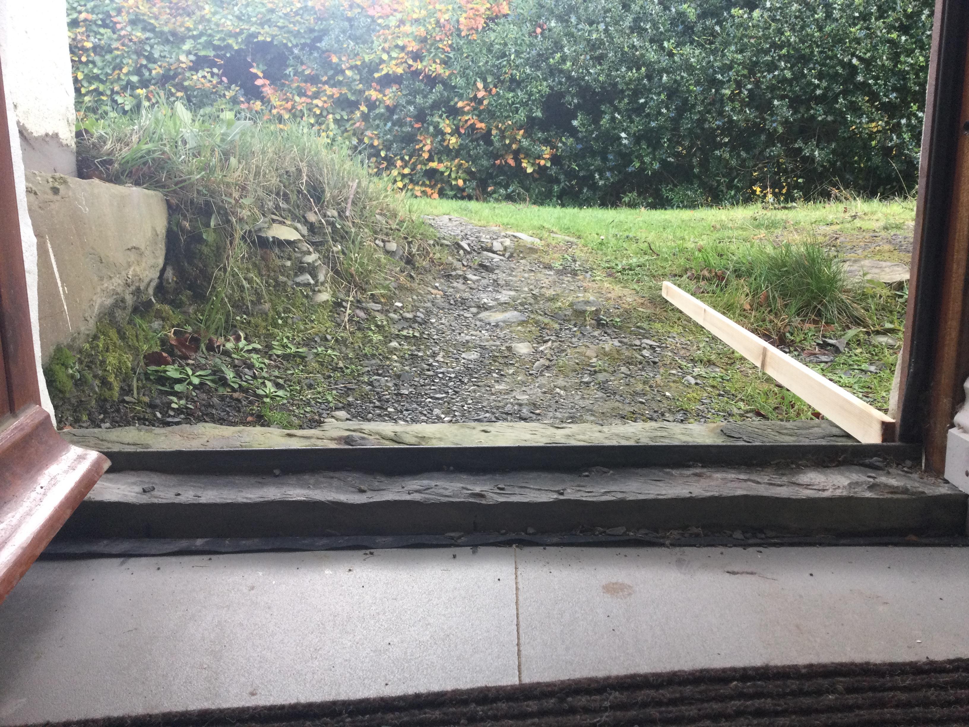

Aha ok great. Tbh i never knew a mortar could be this dry. But I guess the idea for choosing a dry mix here, is to prevent any 'slump' of the slabs, with as dry/ firm a mix as poss-? Basically the mortar acting like a sand bed, just with adhesion-? thx zh
Hi markc, just diving in to the job. How 'thick' can my mortar bed be max? I'm a fair bit short to get my 32mm slabs to the step height.. unless I put onto a thick 70mm mortar bed. Got to research dry mix too.. assuming you dont mean no water at all. Thanks zoot
Ok thanks markc.. was just off this minute to get soft sand! Would you have it level with my slate door sill bit? My floor inside is 1" below this, for reasons mentioned in #1. Or same level as floor? Zh

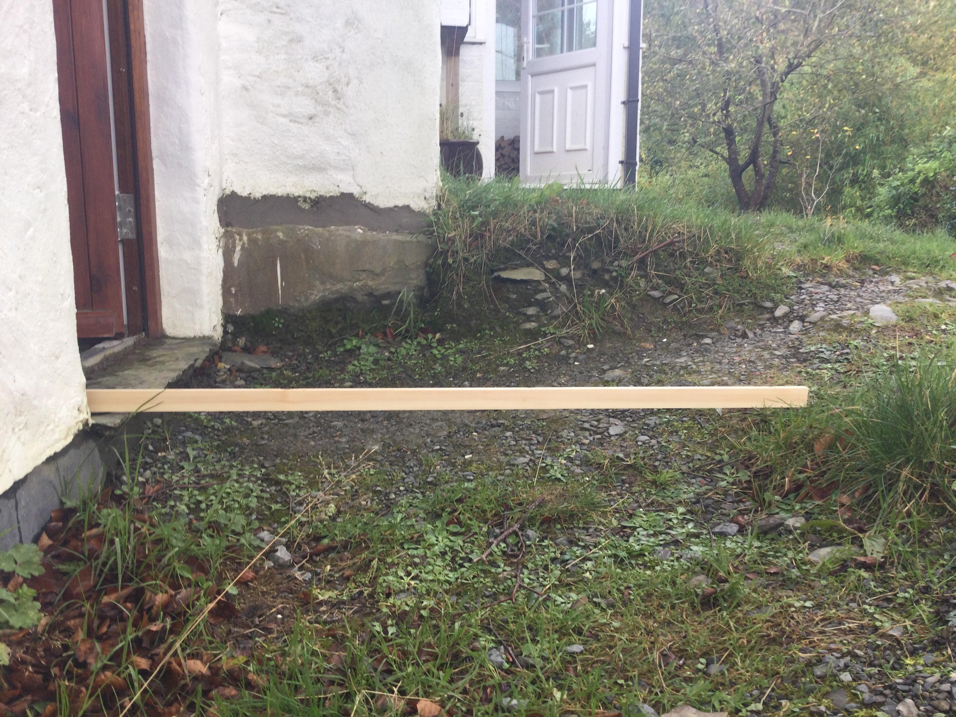

Ah good, ok will try this way then. 5:1 mix, straight onto clay ground ok? Thanks, zoot
Hi markc, thanks/ understood. So you mean compacting once some sort of sub base is put down? I had thought this job might be just roughly level off area, mortar, slabs.. adjust level with a rubber mallet. Is that completely wrong?
@joe90 if I'm pretty confident my ground is compacted enough, to get these above paving slabs down for my entrance walk bit, would I need to do layers of sub stuff, whacker plate? Seems alot more complicated than I anticipated. Maybe a simpler way? Thanks,, zoot
Basically 4 of these paving slabs maybe, spanning the doorway inc frame spot on. Then create a top step @ ground level. https://www.jewson.co.uk/p/ultipro-farndon-natural-utility-paving-450-x-450-x-32mm-LSMUF555
Hi John. Well it was just exposed by the builder/ but not disturbed. so it seems to be fairly well-compacted clay basically, additionally so with me walking on it, in/ out of the room for 2 years. thanks, Zooter
Hi chaps. I wonder of anyone could help on this. I've researched 'laying slabs' but all clips involve sub bases, whackerplates, sandy mortar mix bags... I don't think my level area warrants this, just my hunch. Could I just clear a level area of this compacted ground, whack down 40mm mortar, lay say 4x 18" patio slabs, mortar as grout afterwards? Thanks, zoot.
Hi chaps, I've a smallish job to build an "entry walk/ & step area" to my workshop (lower-room of new extention). As the room's 450mm below ground level (Grr.. shoulda been 200mm), Im walking down a slope, then up over sill > in. So maybe a level walk bit, then a step to form the top @ ground level? I don't really know/ ideas welcome. Room is an annoying 25mm below door sill too. Cable to help idea of slope. Wood for idea of walk flat bit. Ive also got an old cottage foundation coin here, rather alarmingly to me.. I wonder if I could hide while Im at it. I dont want a gap for rain to collect between it & my entry walk bit. Thanks for reading, zoot.
