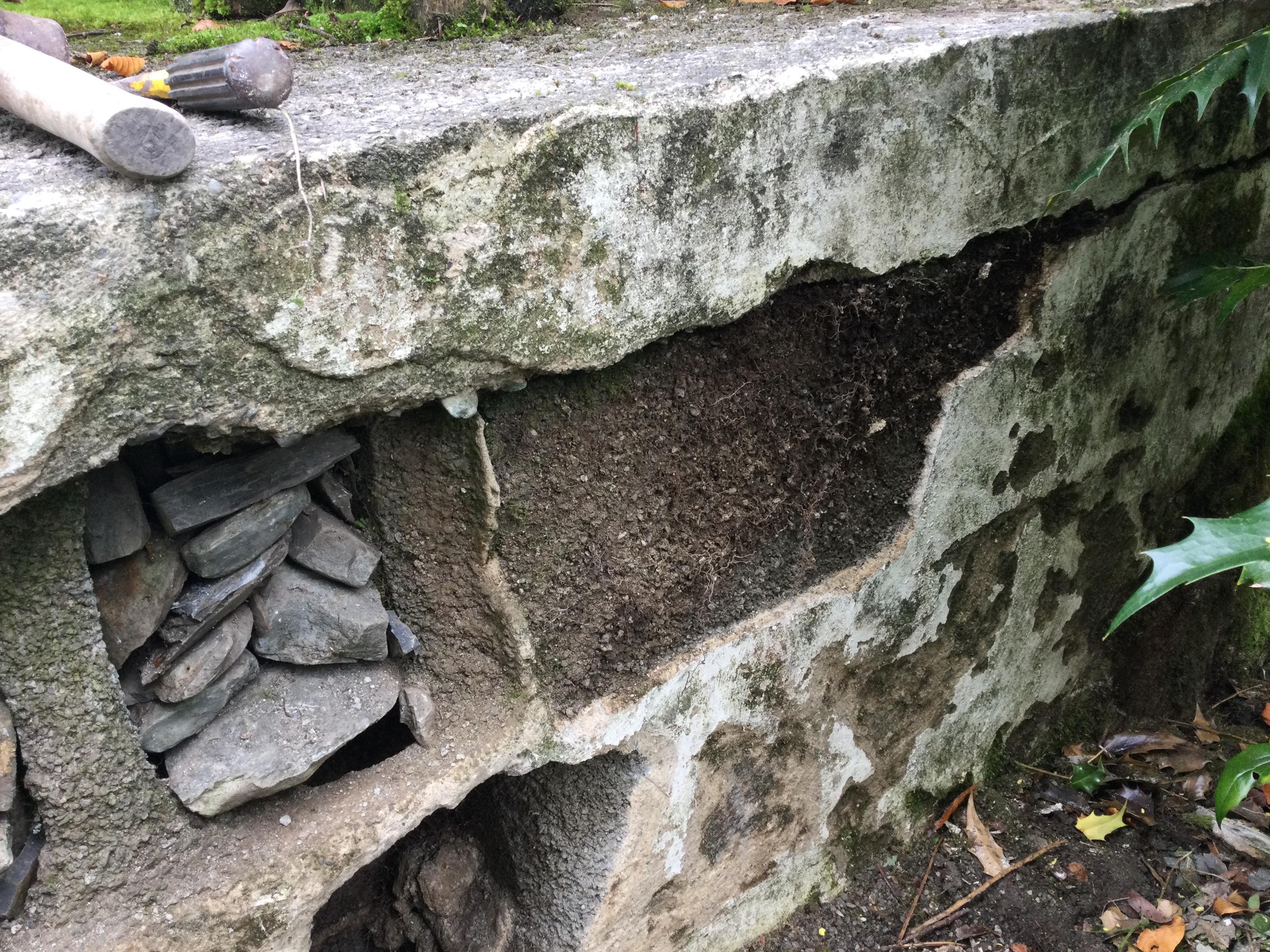

Hi markc, sorry it seems you're left to help me alone! but shouldn't be much longer/ not a big job i hope. So a 3:1 strong mix for the fixing/ sealing the face crumbles understood... & for firing into the stoned holes, say a 5:1 mix, built up in a few layers until maybe 1/2" from the outer render? ( is that a 'weak' mix?). Then maybe a different mix for this final render layer I'm not sure/ will ask then. Appreciated, zoot.
You can see the fallen brushed off stuff below/ may be able to see then just how brittle these faces are.
Hi markc, good ok I missed your strong mix suggestion here. 3:1 it is ( plus bit of frostproofer for plasticiser.. unless im off track). So this 1st strong mix.. sort of 1cm thick onto the krispies? & use the same mix to fire into/ stabilise my packed stoned cubbyholes? So much time & moisture got behind the popped render top, that the krispies have a layer of soil formed between. Plants grown etc ( close up photo in next post).
Ok that's a plan.. so what ratio mix, & what depth this 1st 'seal' layer? Even cloggging the holes with stones, I've still got many bits that go in 2" deepest in the crags between stones.. Ive hardly got a flat dry stone wall face in my little stoned cubby holes. Thanks zh
Hi Tony, no/ appreciate the thinking.. but theres just a top hatch, these side holes are 2 decades of very frost rotten concrete blocks .
Hi markc, Ive made a good start going with your fill holes with stones approach. One last hole to block tmrw/ will do a pic. The render has been severley water penetrated behind it, meaning the exposed damaged block crumbly walls can just be scraped & a layer easily falls away, like rice krispies hundreds of small bobbles of concrete. scraped the weakest off.. but faces still weak. Once ive hacked off all the popped render, I really need to 'fix' this block crumbly surface so its solid/ won't deteriorate & then can adhere some mortar/ render xyz on. Would this way be the right sort of idea? Thanks, zooter.

Understood markc thanks. I do have a heck of alot of cavity to fill. Hmm.. I'm wondering if Onoff's idea might be easier, just for me.. Hi Onoff. I can wire brush the sides I think to adequately ' jet wash'. Then the render that's left is mostly hollow, so Id think all needs removing. Then I can prep the crumbly block underneath. Would I need a strong 'sealer' then maybe to fix this 1st? The mesh idea.. I think might be easier way for me. Will look into ct1 & galv mesh. Thanks chaps, very helpful. Zoot

@markc ah I hadn't thought of that idea. Thing i did notice though, was the blocks seem to have hollow bases, so i heard a splosh far below when bit of rubble falls in these cavities. So filling each 'tower' of void up from say 5ft, will take a huge ammount of rubble won't it? Also rendering onto the crumbly block surface-?
Would the general idea be to actually remove, then replace these bigass blocks? Or to bridge the gaps maybe a mesh ( ? a guess ) & a thick layer of rendering ontop? Cant think how this idea would work. Block cavities..
Ok here she is cleaned up a bit. Another pic in next post. The reinforced concrete top seems solid thankfully. The blockwork, i think you can see into the cavity, is those bigass hollow concrete jobs. crumbles if I brush it. Then a layer of render it seems, all blown.. so I guess 1st job is hack this off? Thanks, Zoot Schmoot.
