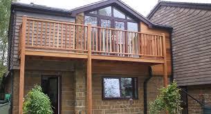

Hi Bitpipe. Yes all understood. I had in mind to copy my plans to the T too (the 1:50 fairly basic plans my architectural blahblah chap used for PP approval I got).. with the added balcony, so yes agreed I do need to to it properly & to scale etc. But just once a basic idea of how one is made 1st: this is the 1st step I'm asking for help on, just that for now. Then I'm off: I can follow up/ gather info, re-draw up design properly & add to the nma. NMA/ PP in wales I honestly think is a quite different to england.. much more likely to be approved, more easy-going, even opposition less likely (I had not -one- n'bor object, even them being utterly awful sods to me for 3 yrs). Thanks zoot -

Thanks ProDave- this concurs with my thoughts. So in your example, who designed it & basically how did you know what to do? are there any pages you found to follow as eg's you could pass on, or any tips for a basic design such as this one? I'd imagine you didn't employ anyone to design it, you just did it yourself. At the moment on my blank sheet, I've got 3 timber posts on concrete footings, metal 'shoe' bracket things connecting them. The posts will continue up past deck to form the frame for the guard rail. But that's all I've got.. I can't proceed onwards at the moment. I could just assume onwards: a horizontal beam attatched onto the extension, below Fr.windows? some opposite horizontal beams between the 3 posts > & span across with decking? but I'm bound to be wrong, or there's a simpler way, or not that's not the right basic idea at all zoot you flamin eejet! -

But Ive never suggested it wouldn't have a guard rail. I would never consider, nor would anyone, a balcony without one.. Ive suggested the opposite in fact by way of pic eg's: all have guard rails. I really don't understand this. I certainly don't expect anyone to design it, I've just asked for help to design just a basic 'sketch' plan at this stage so that I can add to a non material ammendment. Later, I'll need to design properly & put it in detail (as will the whole extention afaict) for the detailed B.Regs application. If I can't get a basic plan together like any of the simple eg's I put up.. I'll have to employ someone to do so, but reluctantly & frustratingly for such a simple construction that negates the very purpose of this whole forum in my view: to encourage, help, & all to do with self-building. [can anyone see the 4 photos in the 1st post? Ive no idea if they are visible to anyone bar myself] -

Peter, I can only think then that welsh PP then is different if Ive spoken to the PP officer himself & he's said, as I've explained. Can you just tell me you can see the images I posted in the OP?? if so.. Pic 1: if you were to narrow this (it looks approx 2m deep) to 1m, like pic 2, & add some simple steps up.. that's my basic design right there. Now that is not very complex: that's pretty much the very opposite I'd argue- very simple. Its far better to imagine a mash-up of pics 1 & 2.. rather than me sketch, or my describing it (I know I faff too much spiel: general apologies all! much appreciate your reading). thanks zoot schmootz -

Hi Peter- Ive never had the idea of a cantilevered balcony, but rather as per my pic eg's: three vertical posts > connect topgether with cross beams. An opposite beam aatched to the extension (or supported by vertical posts too). Then span across with a boardwalk/ decking boards = basic shell. Then ballistrades/ or basic railing yes. I cannot think of a simpler build tbh. Its not high at all.. the lower room's set down 2 ft & barely 6.5 ft high to its ceiling too. The balcony would be approx 6ft to the deck. Can you see the photo eg's I added in the 1st post? none have cantilevered balconies: all are simple wood constructions, the outer/ far sides supported by a few pillars that extend up as the ballistrades. No I haven't heard from builder, I re-sent my quote request a week+ ago & asked if he had rcvd & seen it/ yes. But I now expect to wait another month for a reply maybe two. I have no knowledge that this sort of 2-3 month wait for quotes timeframe isn't normal. -

500mm? but that's barely wide enough to walk/ use (so you did mean 18 inches?) not even enough to open the french doors out onto- I'm not quite sure I understand. I would've thought this was the ideal small build project, for such a self-build forum; a simple timber structure (like my pic eg's) added to the house, which I could take my time doing once the extention's built. I I explained to the Planning officer of the outline for this, & he said add it to the NMA. I even explained some steps up to it. I suspect that in wales its less strict or something to what you know in england, but, this is what I've been told to do by the officer who overseas & makes the PP decisions here. I just need help on a simple design/ just the bare basics of how any of the pic eg's I put up, is perhaps done. Just decent enough at this stage so I can add it to the NMA. -

G'day folks- I need to design a simple timber balcony, onto my 1st floor extention, so a pair of french windows can open onto. Steps up to it from ground. A cost-effective pretty simple approach is key (me to build it), functional but strong: smallish & decent looking for PP to approve (a non-material ammendment). Decking boards, softwood. Are there any timber minds out there? At the moment I've got some pic eg's as a rough guide. I have some woodwork skill, & Circ/ chopsaw etc.. but no idea of basic construction. Approx eg's. Steps up to the 1st pic, from the side/ perpendicular wall. 2nd pic good for depth & simplicity (~1.2m). 3rd pic good for width. Perhaps 45* braces for aesthetics (PP might like), like pic 4. Thanks, zoot
