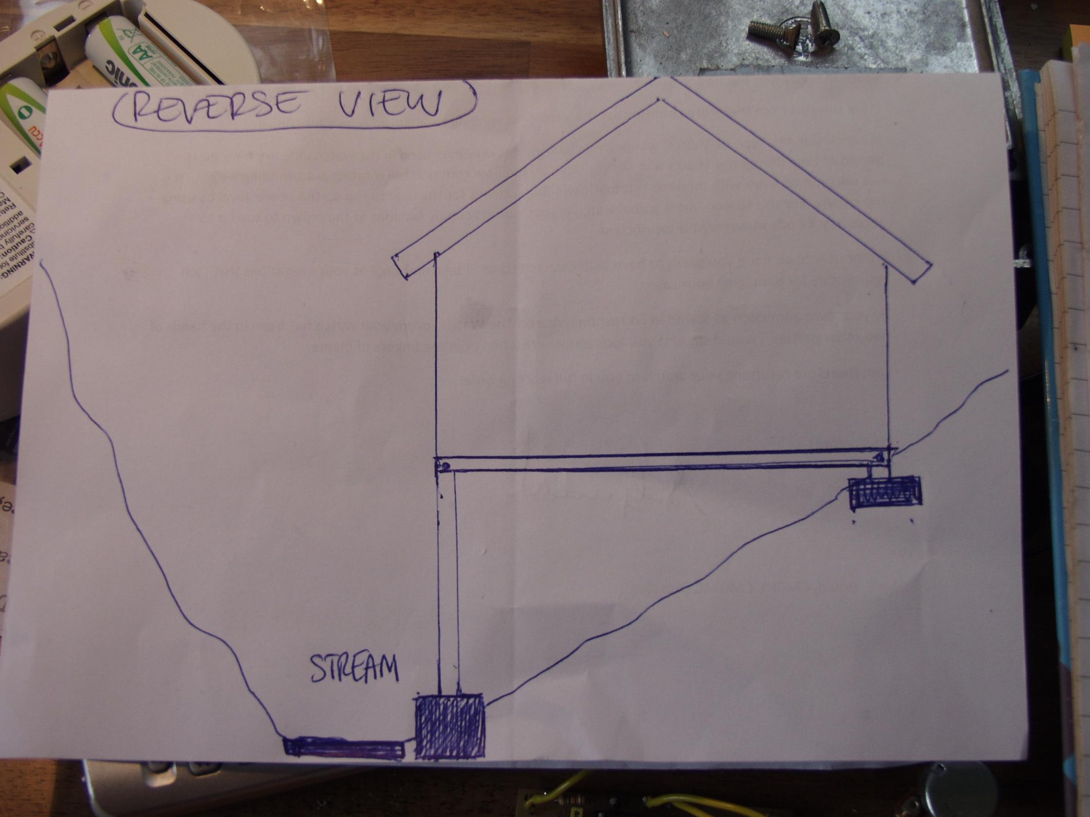

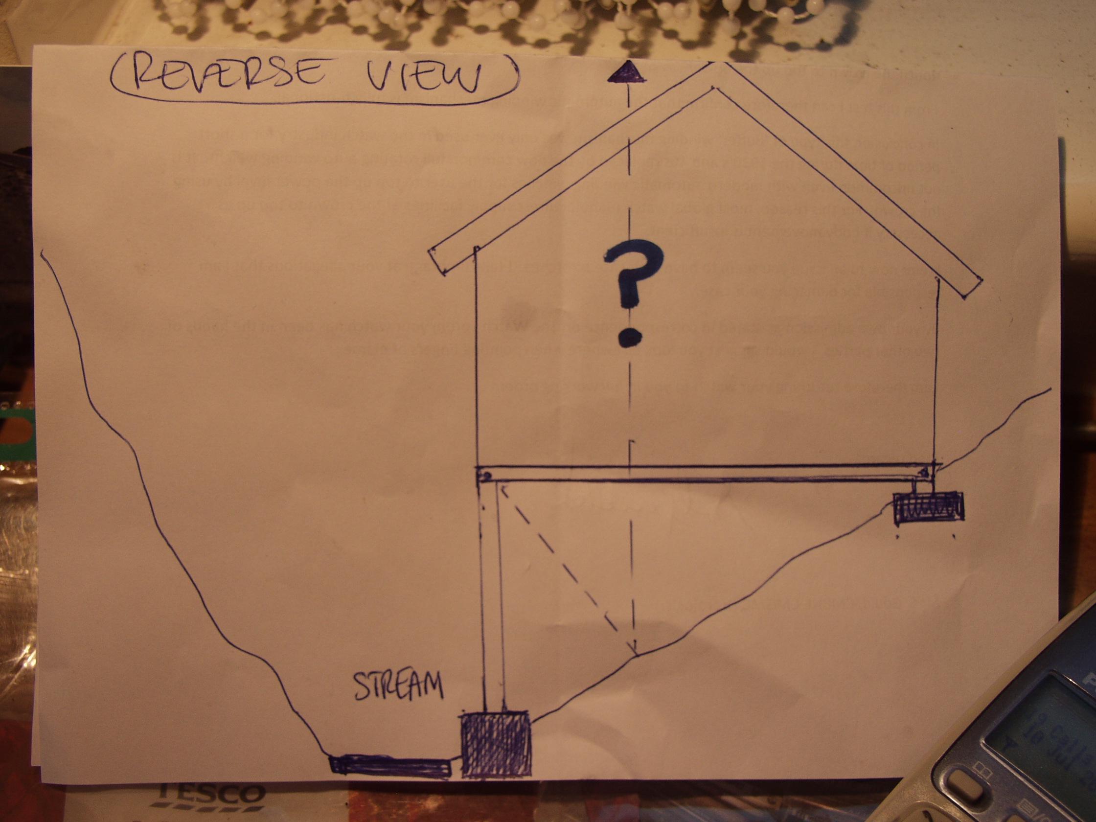

Platform.. thats the word I needed thanks Temp. I wonder then if I were to use the right guage beams, could I space both my side 3x footings to 5M total, my cabin 3M, to then shift cabin farthest back.. to free up a 2M area in front to form a veranda. Its the load of the cabin's front wall across, onto what this rests is the Q here. Talking to the chap at the time (the Co he works for http://www.elmwales.co.uk/ -the pic: Dyfi ospreys reserve) he mentioned 20% overhang can be safely used too. IE a bit of deck over the stream maybe.. could be a neat idea.. but I don't think quite enough area for a front veranda/ sit area etc. One possible concern, is the combined H of both base + cabin re. PP dept. If they were to deem it 'one structure' it'll be ~4.3m high. But if just the cabin.. 2.7m (IE no need for PP). With m sod n'bors itching to get at me they -will- enquire to PP dept just once Ive built it, if I just go ahead. Any ideas? maybe @PeterW might know?
I think you may be right, he gave me the impression that yes like you say below stream level to reach firm ground.. but this reached in only inches rather than anything dramatic. Anyway I've just measured up & I'm going for a 3M (or 3.5m) x 3m, new cabin. So now I can build footings on the exact periphery walls. In mind this one altho no thicker 45mm wall option or double glaze options.. sure would look purty & pitch of roof would compliment my house opposite end of gdn.. https://www.tuin.co.uk/Skov-Log-Cabin-3.5x3m.html
Good Q Joe. The only thing you're missing is just up onto the bank, say 1m away from stream.. the ground is poor/ very loose, & the gradient is suddenly steep so alot to excavate to get down to stream 'bedrock' which is where he wants to go up from, & where I'd be happy only for them to sit tbh so bad the ground is here. The ground topside is alot firmer: I'm happy to dig hole > concrete > paving slab etc footing here. I'm lucky in finding this guy- ideal guy for the job: I knew if the job wasn't sitting well with me, to not rush ahead but wait until the right plan fell into place (chap I found in this case). I think he mentioned a few re-inforcing rods rammed down into the earth prior to concrete filling too. Approx £350 to do these 3, not cheap, but I think sensible. Maybe £150 on the pillars/ deck base. Plus £2k on the cabin. cheers zoot

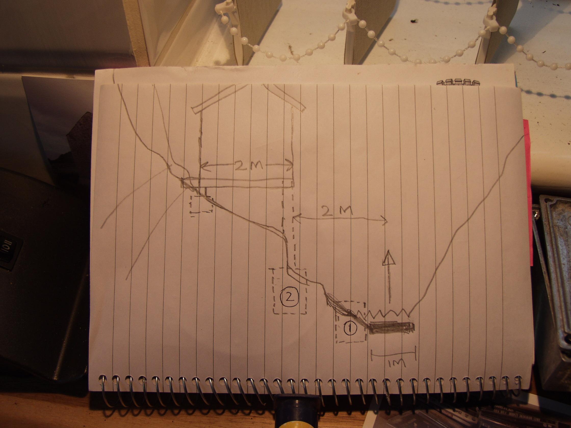

Yes I was wondering this too- good so I'll leave out the 3 centre ones he suggested (prob cos he's used to bigass hides etc without a suspended floor like log cabins). Actually its a toss up between the proper whole-hog route: a new 3x3m cabin @ £2k.. or.. Ive been offered a used 2x2m log cabin for £600. Tempting but the door askew/ to fix, window likewise, pain or two gone.. & I need to decontruct it. Saves me £1.4k tho. But the same thing applies: if I were to make the base 3x3, & say change my mind or run out of budget.. could I sit this 2x2m log cabin on it?

@ProDave yes that's what he suggested.. & going ahead any day. The thing is trawling log cabin base info, all suggestions are to make the base fit the 4 walls, as the load is peripheral/ only here (not the floor). With mine, bc the only place to site the far side 3 pillars, is right down near the stream. Then if the cabin side walls directly above this line of three (for ideal load bearing etc) the cabin will sit too far over twds stream. I want it shifted inwards from here ~0.5m min. Maybe 1m. So is this oversize base ok? if so do I have to re-inforce its flat top somehow to accomodate this shift inwards? or is it a definite no-no/ I must make the base same size as cabin to distribute its 4 wall's weight directly down onto the footing pillars.
@joe90 Hi there Joe!- I need to resurrect this thread! (& anyone else who might advise). I'm finally in a position to attempt this tricky base build on my near impossible slope-down-to-stream lower garden area. I couldn't attempt myself (hence stalling on idea) as the footings too tricky for me, & also no clear solution. So I chanced upon a pro, whose work I saw on a nature reserve (builds boardwalks, & big nature reserve cabins.. so this job pretty small fry for him). So his suggestion is build 3 big solid concrete footings, 2-3ft wide, concrete into big black tubing stuff. 3 next to stream. Then its up to me to do the rest, IE corresponding 3 footings opposite (on the high slope side), 3 in between (so he says the best idea).. & timber base onto these 9 etc. What I need to establish before he starts, is how & where the log cabin should sit ontop. The next-to-stream footings, forming a line of 3, is a good 1m away from where I want my cabin side to be. My Q is if my base is say 4m sq, can the cabin sit happily within it? IE a 3mx3m cabin, onto a 4mx4m base.. is this possible if I were to build the base top in some fashion to suit? thanks, zoot

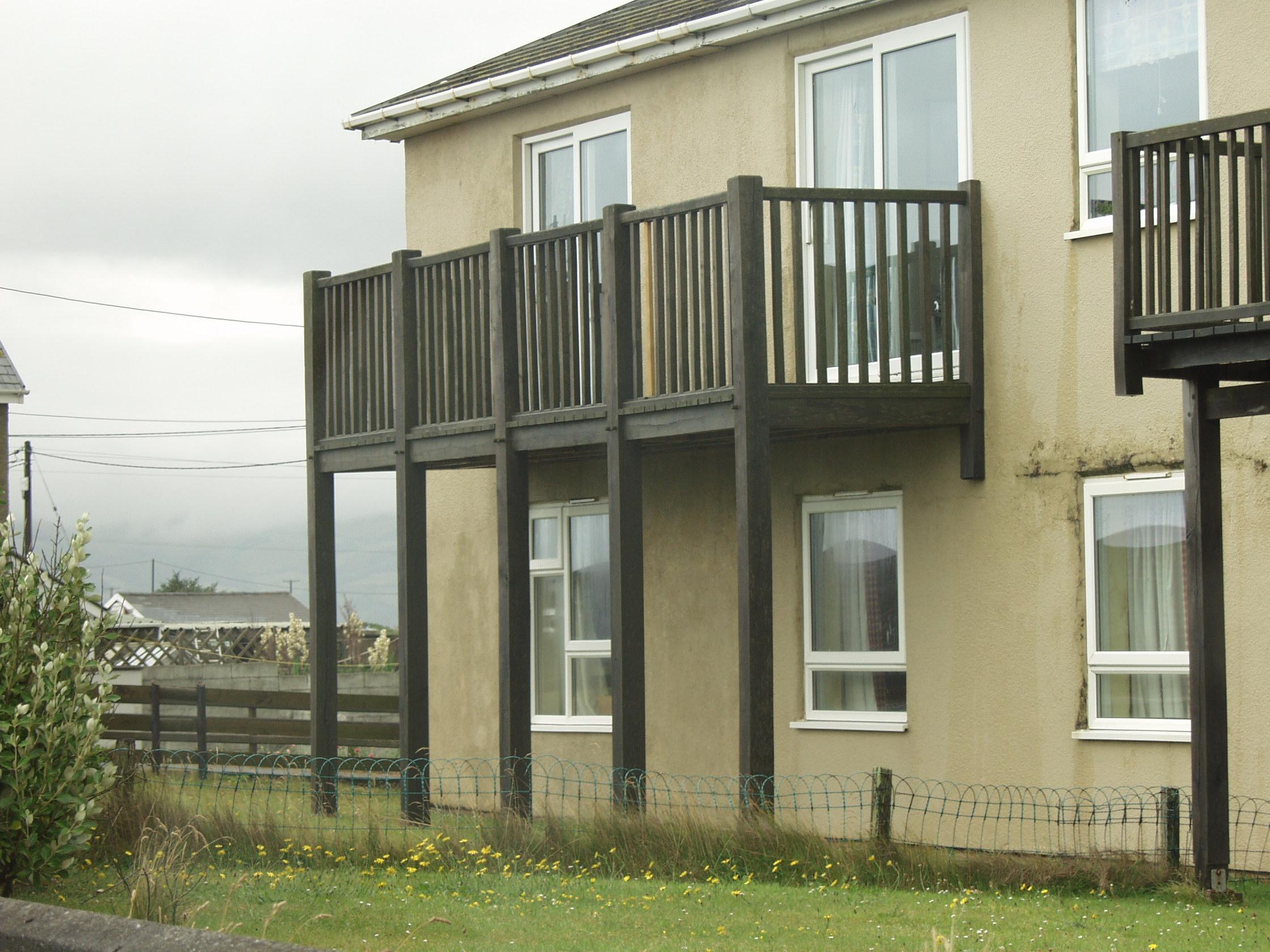

Hi Peter- Ive never had the idea of a cantilevered balcony, but rather as per my pic eg's: three vertical posts > connect topgether with cross beams. An opposite beam aatched to the extension (or supported by vertical posts too). Then span across with a boardwalk/ decking boards = basic shell. Then ballistrades/ or basic railing yes. I cannot think of a simpler build tbh. Its not high at all.. the lower room's set down 2 ft & barely 6.5 ft high to its ceiling too. The balcony would be approx 6ft to the deck. Can you see the photo eg's I added in the 1st post? none have cantilevered balconies: all are simple wood constructions, the outer/ far sides supported by a few pillars that extend up as the ballistrades. No I haven't heard from builder, I re-sent my quote request a week+ ago & asked if he had rcvd & seen it/ yes. But I now expect to wait another month for a reply maybe two. I have no knowledge that this sort of 2-3 month wait for quotes timeframe isn't normal. -

500mm? but that's barely wide enough to walk/ use (so you did mean 18 inches?) not even enough to open the french doors out onto- I'm not quite sure I understand. I would've thought this was the ideal small build project, for such a self-build forum; a simple timber structure (like my pic eg's) added to the house, which I could take my time doing once the extention's built. I I explained to the Planning officer of the outline for this, & he said add it to the NMA. I even explained some steps up to it. I suspect that in wales its less strict or something to what you know in england, but, this is what I've been told to do by the officer who overseas & makes the PP decisions here. I just need help on a simple design/ just the bare basics of how any of the pic eg's I put up, is perhaps done. Just decent enough at this stage so I can add it to the NMA. -

G'day folks- I need to design a simple timber balcony, onto my 1st floor extention, so a pair of french windows can open onto. Steps up to it from ground. A cost-effective pretty simple approach is key (me to build it), functional but strong: smallish & decent looking for PP to approve (a non-material ammendment). Decking boards, softwood. Are there any timber minds out there? At the moment I've got some pic eg's as a rough guide. I have some woodwork skill, & Circ/ chopsaw etc.. but no idea of basic construction. Approx eg's. Steps up to the 1st pic, from the side/ perpendicular wall. 2nd pic good for depth & simplicity (~1.2m). 3rd pic good for width. Perhaps 45* braces for aesthetics (PP might like), like pic 4. Thanks, zoot
